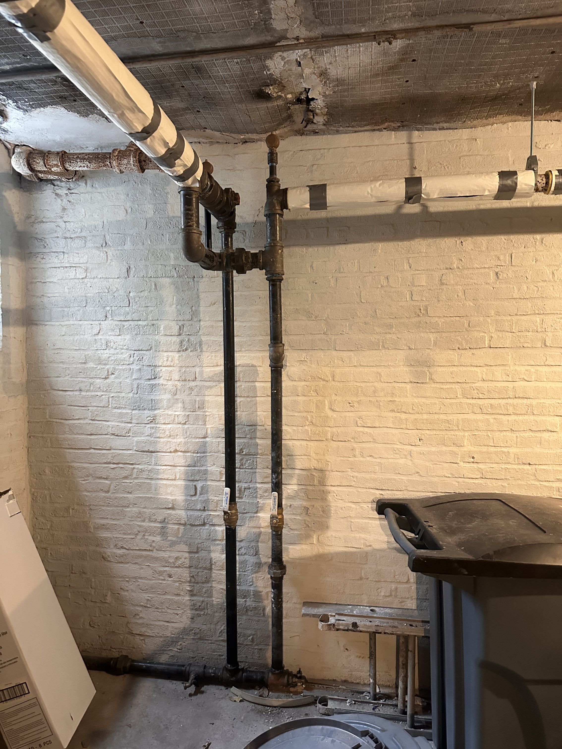

Once in a great while, among the insanity of running a business and dealing with the whole getting old thing, there are still times I find I'm actually proud of myself. So, here I am today. This worked out better than I could've anticipated.
We had a situation where a steam main was moved to accommodate the addition of some storage lockers in a Brooklyn multi-family basement. No one in the building remembers when the work was done but the current residents all said the heating system had "always made a ton of noise" during the heating season, especially on colder days when the system ran longer cycles. Half the main had been moved and back-pitched so there was good original parallel flow in one part of the building and then counterflow in the other. Both sides shared a return that was rendered undersized by the old piping alterations.

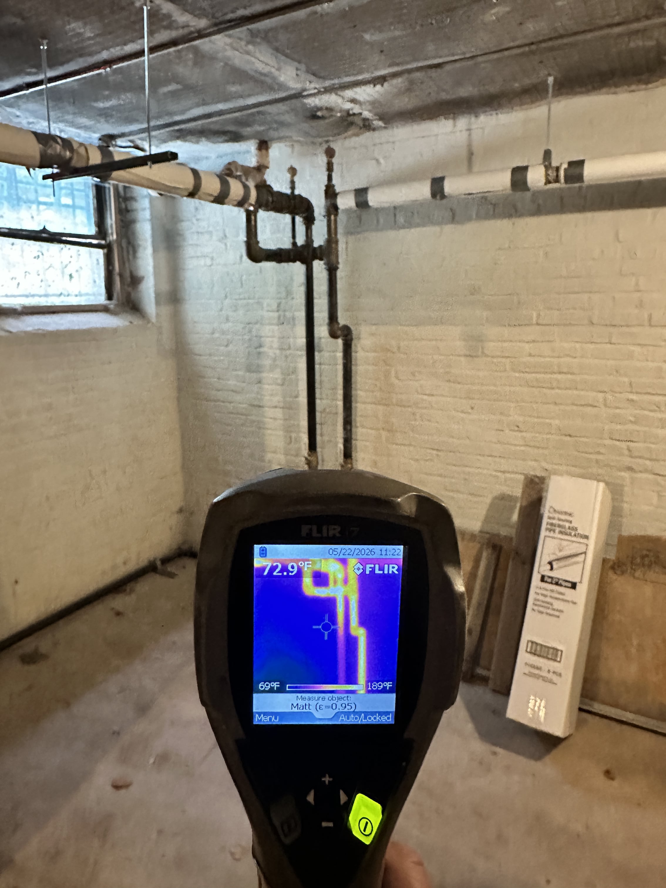

It's difficult to photograph but here was my solution. The left side comes from the boiler and the right side is a back-pitched main serving about half the building. There is no practical way to move the right side main, or at least, moving it would incur tremendous costs.
It now works silently and heat distribution is normalized.

    There you go..fixed!!! Mad Dog

    it really isn't that hard if yo think like steam. you need to keep the steam from going where it shouldn't and give the condensate somewhere to go.

    I probably would have teed up from the boiler main and up from the counterflow main and tied that together for the steam. Then dripped both mains the same way you did connecting them below the water line. That way the steam isn't fighting the condensate in the short riser.

    @Alan (California Radiant) Forbes and @mattmia2 I can only guess what piping was there before but I believe that one side (B) was a counterflow as a result of a repiping job long ago, and the other side (A) was a parallel flow and there was insufficient return so the condensate didn't get out fast enough. By adding a second return drop (D) and adding a drop from the riser into the second return (C) pipe there is more condensate going to return (D) and less going to return (F) so the problem of insufficient return for the condensate from Pipe (E) and (A) was eliminated.
    I think that is how I understood this fix. but it is only a guess. Great Job!

    @EdTheHeaterMan You got it right except that B gets its steam from A. So, you'd have to reverse your arrows on the B line. B still gets steam from A but it takes it from the 2" downfeed/drip-line C. As noted, my C line would probably have been better taken from the top of the A line but I didn't have the room for the fittings and an air vent which I felt would be critical in breaking any vacuum on the counterflow B line.

    So that makes more sense. The two mains don't start at the boiler and meet at this return location. B is a continuation of A and that is why there was so much noise after B was relocated for the storage lockers so many years ago. Where there is a will …

    If your supplying steam from the C pipe to the B pipe then that is where you are going to have banging. You are going to have all that steam supplying from below trying to fight the steam condensate falling on top of the steam. It's definitely not the preferred way. I would have rolled the tee up at a 45 degree angle off of the "A" pipe and supplied the "B" pipe from the top so it won't have to fight the condensate coming back horizontally and fighting the return condensate from the "B " pipe.
    also you create a lower "A" dimension at the "C" pipe. The horizontal also could be a cause of banging.

    i'm pretty sure that is set up more like a boiler header where different parts have pitch in different directions to make steam go one way and the condensate the other. a drip right at the bottom of the riser would be better but would also be more rework. the way it is now it dumps the condensate in to the wet return as soon as the existing runout to the riser ends.
