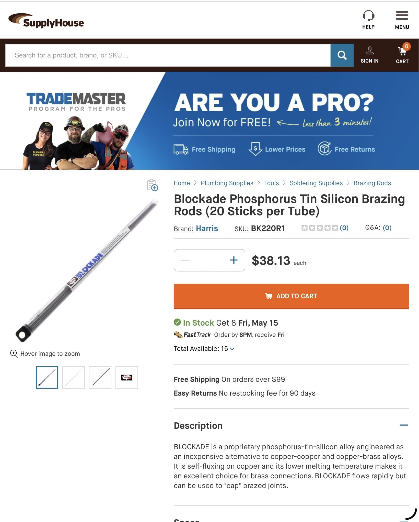

    on large sizes like that you can pre-tin the tube and fitting. Basically wiping solder around the pipe and fitting first, then assemble.
    If it is no too close to other fittings you could silver solder over the fitting.
    Blockade is a good rod for that use.

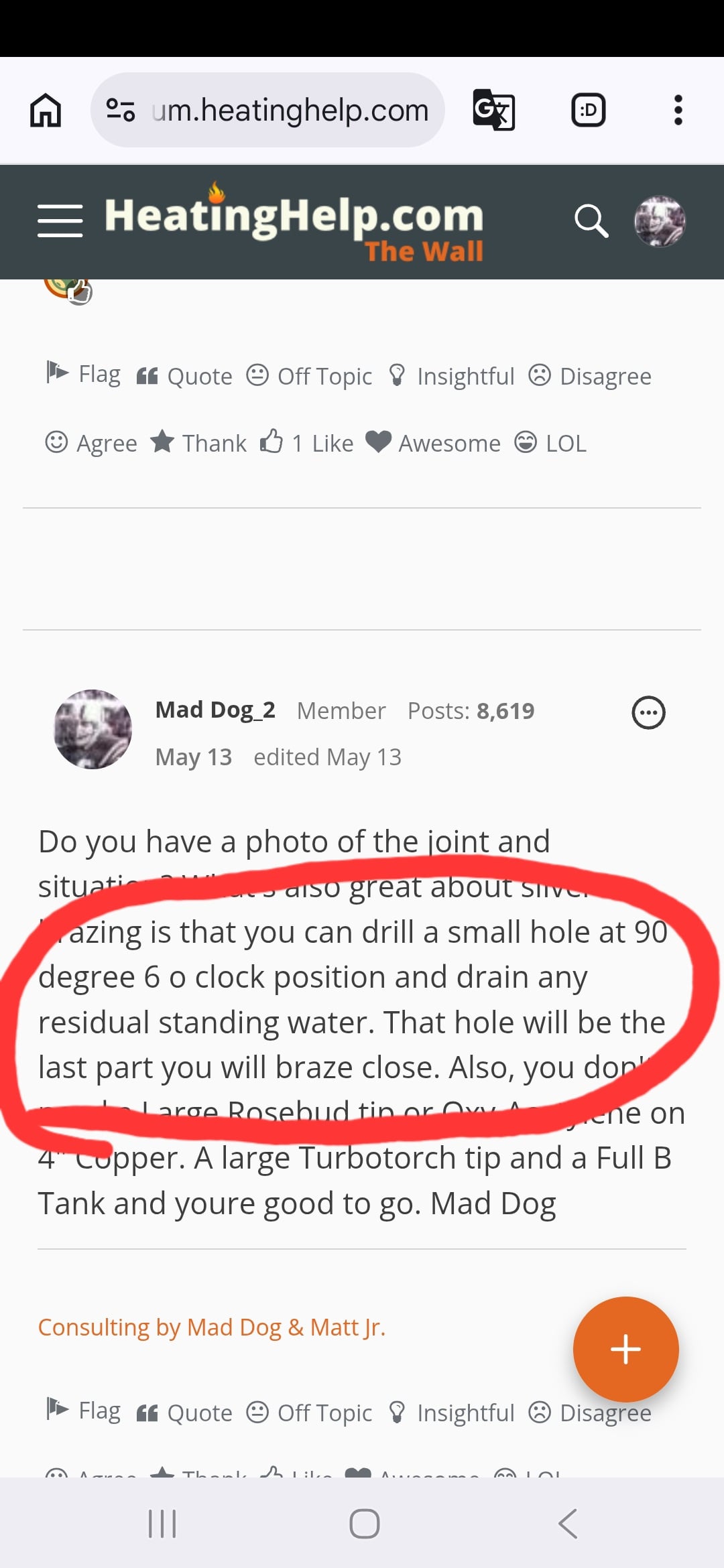

    Do you have a photo of the joint and situation? What's also great about silver brazing is that you can drill a small hole at 90 degree 6 o clock position and drain any residual standing water. That hole will be the last part you will braze close. Also, you don't need a Large Rosebud tip or Oxy-Acetylene on 4" Copper. A large Turbotorch tip and a Full B Tank and youre good to go. Mad Dog
