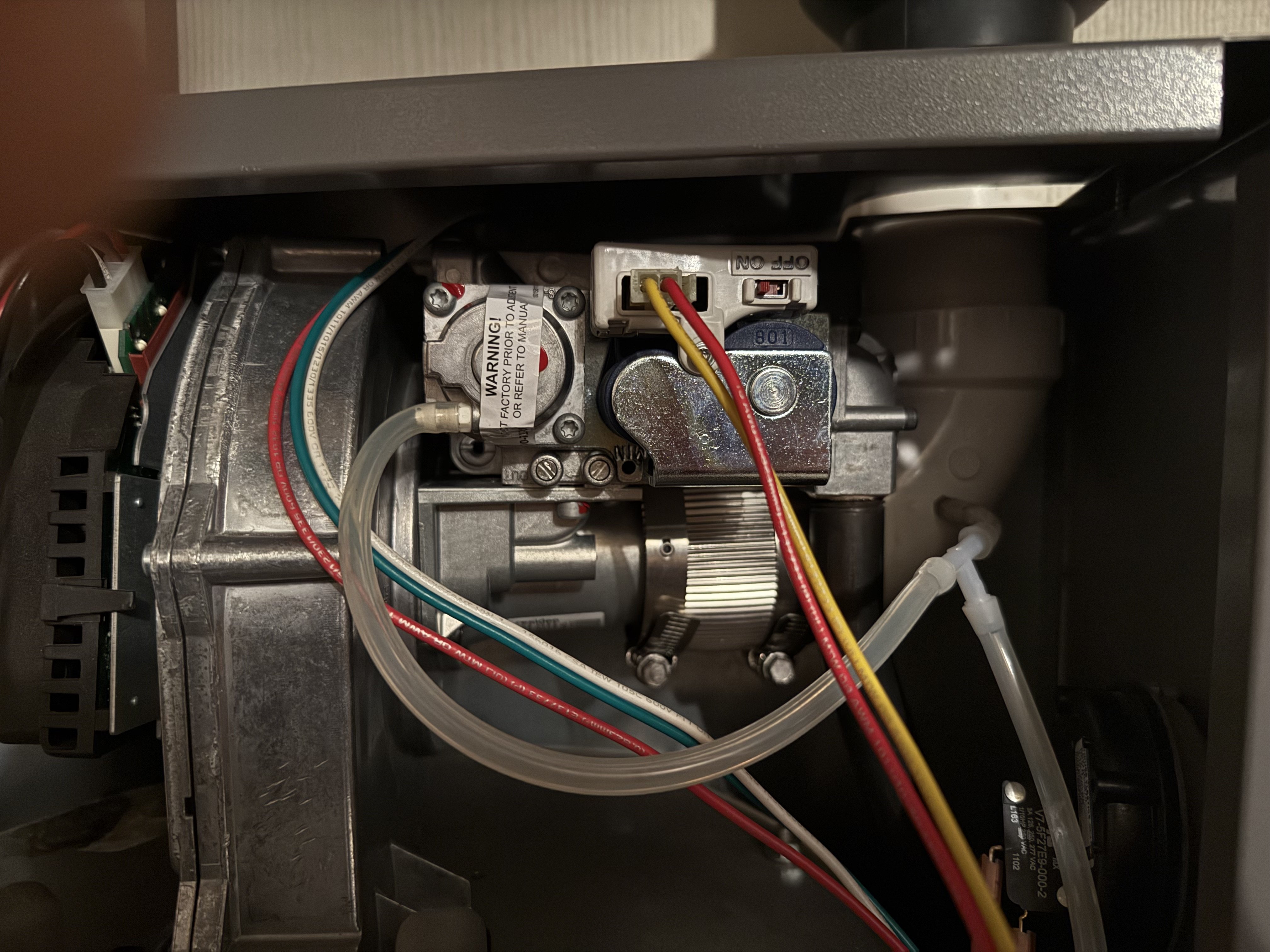

Hi! I've been struggling with this problem for a year or so.
I have a Lochinvar WHN199 that is giving a flame lockout error. It tries to light four times and goes into lockout. It is converted to propane, and only happens when the propane tank has been recently filled full, and starts working properly after the tank has been used for a week or so. The inlet propane pressure seems fine; 12.4". I tried replacing the gas valve assembly, but the problem still persists.
The boiler will light immediately if I remove the clear air hose attached to the gas valve assembly and lightly blow into it as the ignition is sparking. specifically, I can disconnect the hose at the three way split (see photo below), and lightly blow into it towards the gas valve. When it is in pre-purge, I don't feel any air coming out of the white air inlet pipe, but it is clear (no obstructions).
Any ideas?

    That li'l clear plastic tube is the vent for the gas valve regulator, it allows the gas valve to compensate for the pressure in the sealed combustion chamber. I'm having trouble seeing how the tank level and that would interact.
    Take the outlet pressure of the gas valve (same procedure, but use the other teat on the valve). Make sure to zero you manometer before the inducer starts, in fact zero it with no hoses use attached to it, then watch the pressure thought an entire cycle. It should start out zero with the furnace idle, drop slightly negative when the inducer starts, then jump up to high fire (should be on the nameplate, but not the natural gas number, which is 3.5 in wc). Edit: didn't realize it's a negative gas pressure regulator. Have to refer to mfgr's instructions to determine expected pressures.

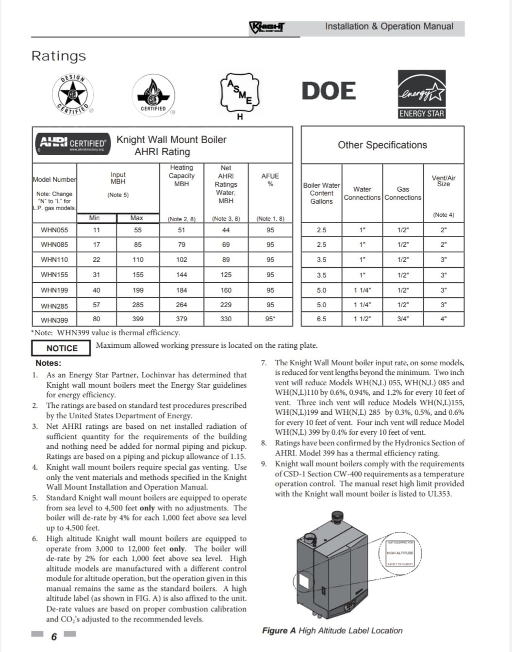

    Do you have the high altitude model?
    A combustion analyzer is needed any way you look at it.

    Okay, I did some more testing and recorded numbers:
    1. Manometer attached to the inlet gas tap (right nipple on the gas valve, opened 1 full turn):
      1. Initial reading: 31 mbar (12.45 in wc)
      2. Attempting to light: 28 mbar (11.25 in wc)
        So — it is dropping a little more than 1" of pressure drop when attempting to light. Maybe my second stage regulator is the problem…I could replace that and see if it fixes the issue. What do you all think?
    2. Manometer attached to the outlet gas tap (left nipple):
      1. Initially read 0 with the gas off and tube off. Turned the gas on, it went to 16 mbar in prepurge, drops to 5 mbar when attempting to light, then drops to 0.
        The manual just says it should be in negative pressure when in prepurge, and when the valve is energized a change in pressure should occur. So, that seems to be working correctly, and the remedy to fix this is to "replace the valve", which I already did, so I don't think the valve is the problem. The manual doesn't give specific numbers on what I should see here.
    I didn't do any tests when it actually fires…because it isn't firing unless I force it to (ie: pinch the clear tube or blow in it). I'm not sure a combustion analyzer would help, as I'm not even getting to that point of firing.
    RE piping size: it is 1" from the boiler and into the house, second stage reg is right outside the mechanical room wall; it drops to 3/4" not far from the boiler.
    RE other appliances off for a while: It doesn't seem to make a difference; we've got a gas stove, some other gas furnaces, and on demand gas water heater -all those things work fine.
    RE high altitude model: I'm pretty sure it is, but I'll re-verify (it's hard to see the left side as it is against a wall)
    The boiler is probably ~13 years old, and this problem started happening a few years ago, so "something failed or is failing" more recently. I did clean the boiler chamber a few years back when I had problems, and maybe I should do it again.
    I did email Lochinvar; they said to call their 800 number..I'll try talking to them monday.
    I'm currently suspecting the second stage regulator; for $100 that is a cheap test to try out.

    Is your boiler set up for high altitude? There should be a label on the left side of the boiler if its rated for over 4,500 ft. And you're at 6,600 ft. Is the new gas valve rated for high altitude? This isn't DIY.
    the valve needs to be adjusted with a combustion analyzer when it is installed. did it ever work with a full tank with the old valve? the pressure could dip more when the boiler tries to fire with a full tank and that could cause more problems with incorrectly set combustion

    HAVACNUT asked this - I said I think so, but I can't see the left side as it is right against a wall. The boiler was installed when the house was built, around 2008 or 2009. It ran fine until a few years ago, and then started to have this problem. I'd really be surprised if it wasn't a high altitude model.
    Is the gas valve rated for high altitude? According to Lochinvar, it is something programmed in the board, and not the gas valve, so that doesn't seem to make much a difference.

    Yes - I do regularly maintain the boiler, and a two days ago I did completely disassemble it to clean the mesh burner with compressed air. I also cleaned out the heat exchanger.
    1. Yes it is cleaned
    2. It is in a vacuum, and the valve is new, and exhibits the same problem as the old valve.
    3. Venturi looks good
    4. Yeah….other's have said that. I don't have a combustion tester, and they seem to be at least $500, but this seems to be the thing I have to do at this point.
    I did call Lochinvar, and they were stumped as to why a full tank would regularly cause this problem. The tech said "pinching the hose" is a trick they to do get a burner to light, and that I should do that and adjust the combustion.
