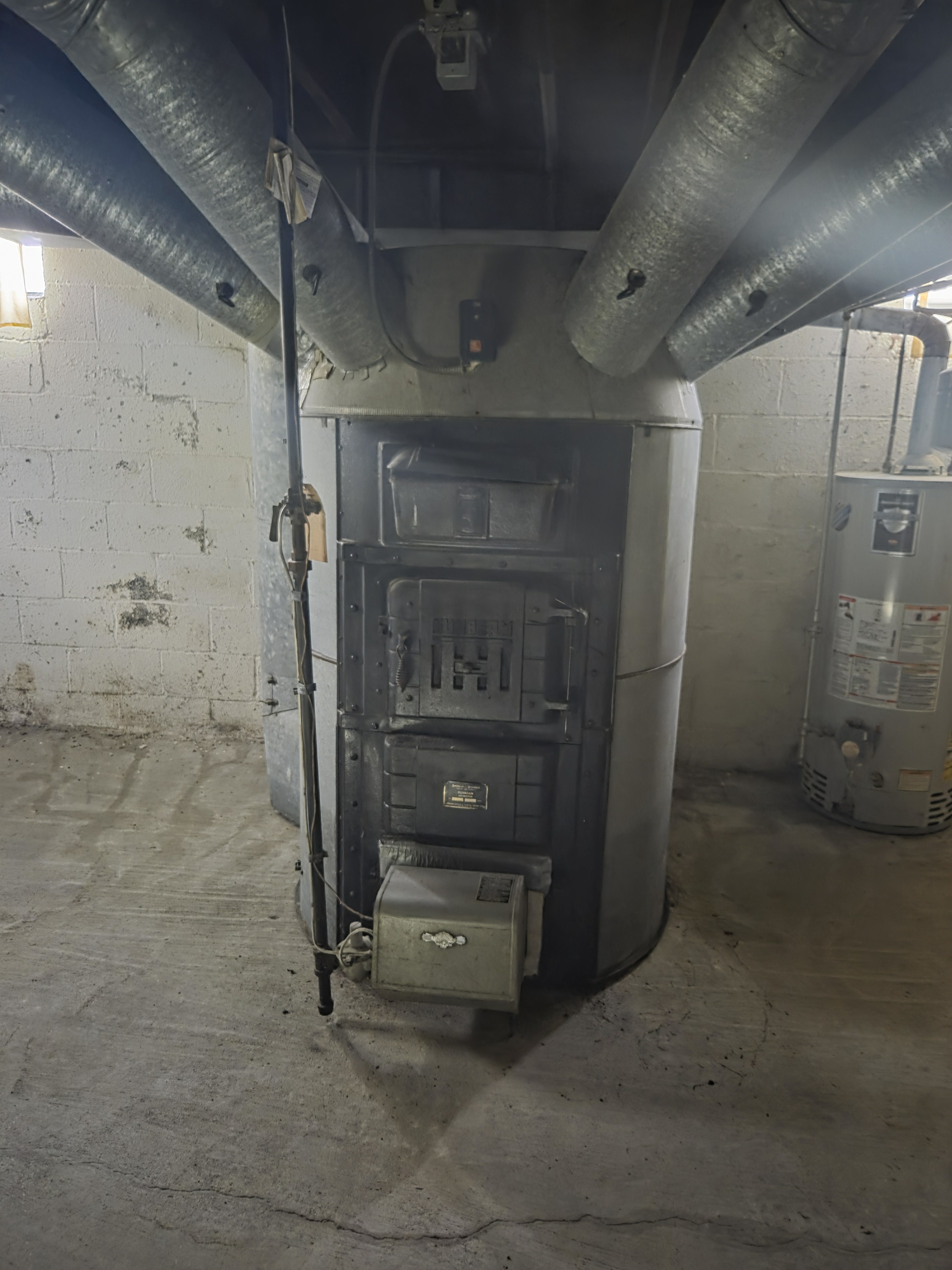

Hello,
Went to an estate sale down the street from me (actually my across the street neighbor’s late aunt) and to my surprise heating her house was still the original Williamson gravity furnace and massive ducts wrapped in asbestos. While other people were checking out the estate items not paying attention at all, I was geeking out at the furnace. 😂🤣. As I tend to do at these estate sales in old houses when I encounter original heating equipment. Figured I would share here where others get excited about this stuff. Not a speck of rust anywhere. The house had gorgeous unpainted woodwork and other original features.
My neighbor tells me his aunt kept this thing cranked at 80° in the house throughout winters.
Enjoy!

    Williamson. That name has been around for some time. the Willimson boilers and furnaces you can buy today are not from the same company. Marley is reusing the name pf a company that has gone out of business. And I think that William's son does not even care
    is that a coal bin in the corner to the left?
    was it always automatically fired? it is weird that one of the covers blanking off one of the fire access doors appears to be a factory made cover which makes me wonder if it was installed new with an early oil or gas burner in the 30's or 40's.
  • @mattmia2 I think what you are referring to is just a picnic basket someone left there. There was no coal bins. And that gas burner looks old but no idea when or if it was a convert. I was a total stranger in this house. I hope the new future owner keeps it around. The thing literally so simplistic and just works.

    that roberts-gordon conversion burner is probably from the 50's. That sheetmetal around it clearly is a later retrofit .
    this is what I thought looked like part of a coal bin
    The fact that this is a factory piece covering the coal grate access door is what makes me wonder if it was installed with a older conversion burner originally:
    i noticed, i had questions about what combustion problems it had making that necessary.

    I'm thinking that red circled panel is where the "humidifier" went. On my dad's coal fired Holland, behind that panel there was a place where you could put a pan of water.
    Dave in QCA
    Anyone notice the high limit set at 250?
    I can't imagine what 250-degree air is like.
    I bet the stack temp is like 1000 degrees. There is no danger of squirrels or birds coming down that chimney.
    And no worries about flue gas condensation.
    Luckly the house hasn't gone up in flames.
    Does it take house air for the return air or is it taking in outdoor air?
    I agree that that Roberts Gordon burner is probably 1950s Used to be thousands of them around.
    you can see a return duct in one of the pictures. i would think if the firing rate is anything reasonable it doesn't get anywhere near 250.
    @mattmia2 I agree it should never see 250 but it never should be set that high.

    I don't think it was a coal conversion .. If it was ,they did a over the top job..
    I think you are right . that circle door was for a optional humidifier. Cast iron tray that held water ..
    Steamhead Posts: 19,007
    That was definitely a coal conversion.
    The door with "Williamson" on it was originally for shoveling coal onto the grates. Gas-designed units don't have or need doors like that. The grates were removed when the conversion was done.
    The door on top was for cleaning the flueways. Again, gas-designed units don't have these.
    And by the time that burner was made, gas-designed furnasties had been available for years. You could still get gravity units, but most had blowers.
    If there is no iron coal door, it was either removed, or they probably delivered the coal through a basement window, as they did in my house. Yes, I still have the old coal bin.

    Still beautiful even though it has a gas burner. I wonder if the galvanized sheeting is covering asbestos mud?
    You can buy EFM and keystoker coal stokers with scorched air systems. Building and bending the hot air ducts and cool air returns in this case would take a little more time but it can be done as both of the coal stokers have a top hot air plenum exit point and a lower floor level cool air return through the air filter/blower box.
    looks like they fabricated a plate to support the conversion burner and control the excess air instead of just gobbing furnace cement around it, that plate looks like it is as old as the conversion burner. the only place i would expect to find asbestos inside besides the furnace cement you can see in the firebox door sealing up the vent in it is in between the sections of the cast iron heat exchanger.
    there was almost no fabrication involved in installing that duct work, it was factory made register boxes, factory made duct sections and factory made elbows cut in to the bonnet of the furnace.
    if you replaced it you would probably abate the asbestos, cut all the ducts at about the basement ceiling, run a trunk down the middle of the basement and join the old ducts with reducers and smaller duct sized to the load to the trunk.

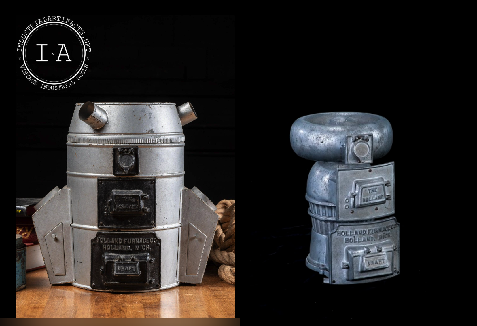

    I found this pristine unit last month

    It is definitely a converted hand fed coal fired octopus furnace and also thing of beauty.

    what's with the flex to the limit? is it line voltage? was it converted to oil before it was converted to gas?

    There were several popular furnaces made in a similar way. In the greater Philadelphia area I found lots of Holland Furnaces. I even remember seeing a working scale model of a Holand Furnace some time ago. The Holand Salesmen would use them to demonstrate how the furnace operated ins your home using tobacco as coal so you could see the smoke come out the flue and no smoke came out the ducts to your home. "See how safe this is"
    Yoiu could take off the outer metal cover to reveal the heat exchanger so a customer could see how it works. I remember taking those apart when a new Gas furnace would be installed
    are those filter holders on the side or just bins to catch the heaviest of debris?

    did the working model have a little mouthpiece so once the salesmen closed the deal he could take a few puffs?
    Holland Furnace.
    I think they were involved in some type of scam.
    In the picture it looks like a transformer (maybe ) mounted above the limit control
    It seems like the scam was more post wwii but basically their salespeople were telling people their furnace was unsafe and had to be replaced and in many cases were actually damaging it.
    where have i heard this before…

    why are there doors in the side of the return transitions?
    LOL for cleaning out all the dirt leaves and grass pulled in through the OA
