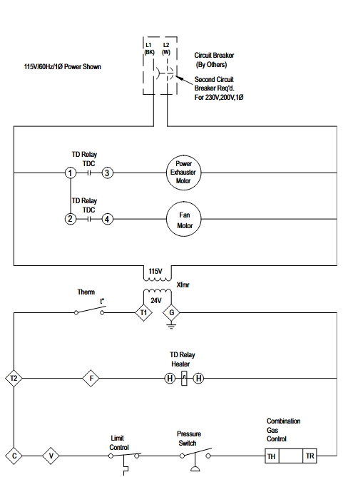

    There's only a few line-voltage things on that, the xfrmr that feeds the control board (might be integrated on the board), the blower motor, & the relay that controls the blower (might be integrated as well). The blower motor is a good choice for the first thing to look at.

    You did not provide the model number, so I am just going with this as an example (PDP150). Looks like most everything is off until the thermostat calls for heat. Then everything is turned on one stage at a time, via the time delay relay and the pressure switch. Do both motors spin freely ? Does the Power Exhauster motor spin up ? Close observation of what stage the breaker trips at will probably lead you to the issue.
    Its probably a motor issue (or possibly a wiring issue depending on what was touched), the 24 VAC transformer may let the smoke out before it ever trips a circuit breaker. And since the thermostat works, probably not the transformer and / or devices powered by the transformer.
