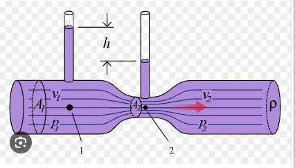

    If your question is, "why is it prohibited" and not, "is it possible"? The answer is a contamination concern. On a water main, underground, a pin hole is what the backflow people call aspiration. Aspiration on a pipe can cause the venturi affect and with flow changes, turn a pinhole into a suction port (very basic description) and draw ground water into domestic main causing contamination. For a long time soldering underground at all was prohibited (not so anymore I believe) and brazing was supposed to be inspected (dont think so anymore either). With flare unions and water service locking compression fittings, its literally never necessary. I have had to braze repairs on soft copper that supplied gas lamps, but thats fuel code, not plumbing, dont think its at all addressed in the mechanical code.

    I think you would need an actual venturi for any flow to be pulled into a pipe or tube under pressure?
    The venturi creates a low pressure zone, this is how a carburetor works, the soap nozzle on your pressure washer, or your aquarium vacuum.
    Backflow or backsiphonage would be need to create a negative pressure to pull water in. Which could be possible with a broken main or large fire hydrant draw up stream.

    Exactly right...sort of. All you need is restriction and flow and the venturi effect can occur, so imagine a rock fell on the water main as the backfill was occurring (no hole, just a dink in the pipe), then a poorly solder joint is directly downstream. Picture a tiny hole where the hand drwn image is labeled vacuum tube. With the high velocity through the restriction a LOWER pressure zone is created. The hole would then become a vacuum port and draw ground water in. None of this is at all likely, just possible which is why backflow preventers are a huge industry. (Can you tell I am a certified backflow preventer tester?) Im sure at least a few people on here have the certification as well.

    One more thing, "venturi" is an effect, not a thing. We call venturi tees venturis because of the effect, not the other way around. So we dont need a venturi to produce a venturi. We can purposely create the effect by using a tee designed to produce the effect, but it can occur without our intervention...like a hole in a pipe underground.

    The Italian company I work for manufactures venturis. AKA venturi tubes. Venturis are what make a measurable balance valve possible. You take a pressure reading across the venturi to translate into a flow number.
    It’s fitting since the Italian physicist Giovanni Venturi discovered the principle in the 1700’s
    Venturi (noun) is a device.
    Venturi Effect is the concept or principle, and it can be as simple as a restriction in a pipe or tube. The cone, orifice, or restriction disc in the diverter tee is the venturi, that creates the Venturi Effect

    except in a diverter tee it isn't really a venturi, it is splitting the flow between the branch and the run, the partition splits the flow, it doesn't force all of the flow down in to a smaller passage. if the venturi effect were the main operating principal it wouldn't be a disaster if you put one in backwards.
