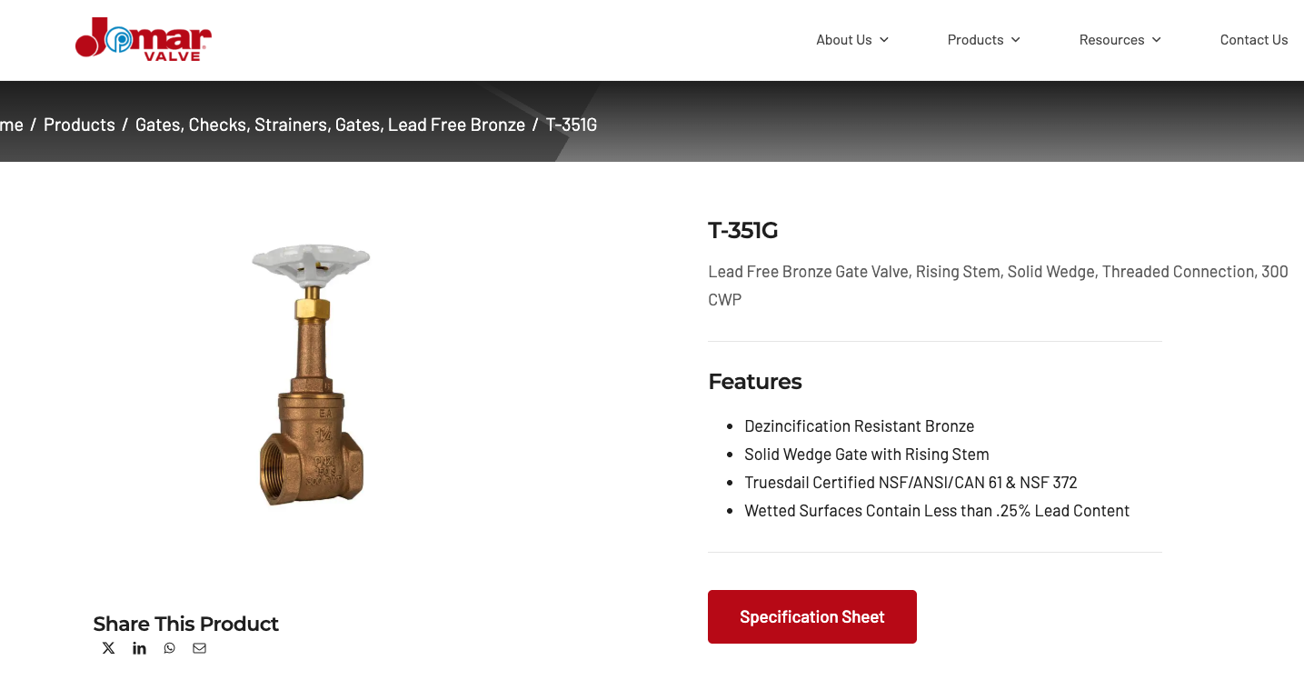

    Maybe a globe or gate valve is a better option. They are less prone to sticking. Exercise it a few times a year.
    Quality valves are easy to spot, thicker forging, packing nut. Apollo Watts, Nibco still build some better valves in the US.
    Jomar has a quality Italian valve line.

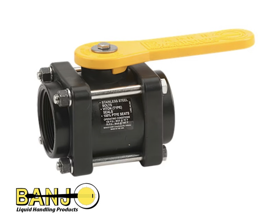

    hot_rod Posts: 28,585
    Another option. This is fiberglass reinforced plastic, super easy to disassemble and
    clean.
