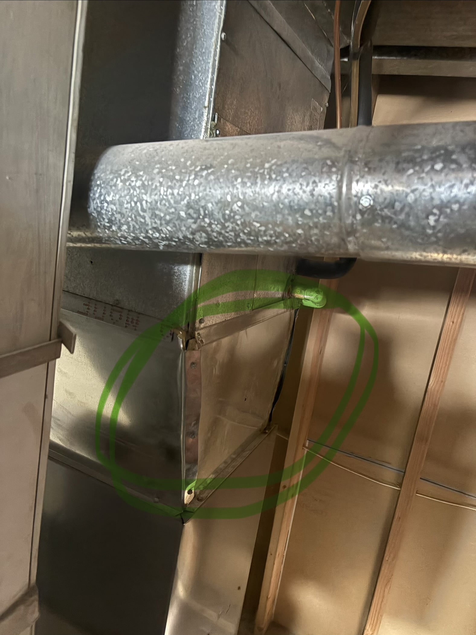

    What is that a picture of? I see a crack, but that doesn't look like a heat exchanger.
    What make and model furnace? What's the approximate square ft of the heated space? How did the tech prove the heat exchanger was cracked?

    i had the same question, i wanted the bigger view. it could be the fire side of a hx but it doesn't really look like a piece of metal that has been exposed to the heat of the products of combustion.(and even if it is, I don't think it would cause enough of a change in pressure to affect the combustion to cause short cycling)
  • he showed me that photo and said “that’s your heat exchanger and it’s cracked” 2,000 to 2,400 square feet.
    HVACNUT Posts: 7,784
    I can't say for sure if it is or isn't. It doesn't even look like metal.
    If its an upflow furnace, and that looks like the blower fan on the right. Did the tech open the supply duct or remove the AC evaporator coil to get a down shot pic like that? Any other tests done? Draft? CO in the supply?

    I don't know what the picture is showing but if it is the HX it does look like a crack and not some kind of factory seam.
    10 years old any warranty on the HX????
    My gut tells me if he spent 90 min looking for the problem and found that I would tend to think he is right.
    Someone out to sell you a furnace wouldn't take that long to condemn it.
    But need more info to tell.

    Absolutely true. But I'd need a little more verification than a picture I can't even tell what it is. There are actual tests. And if the furnace is continuously short cycling on high limit, then that could contribute to a cracked heat exchanger. But a cracked heat exchanger isn't the cause of short cycling.

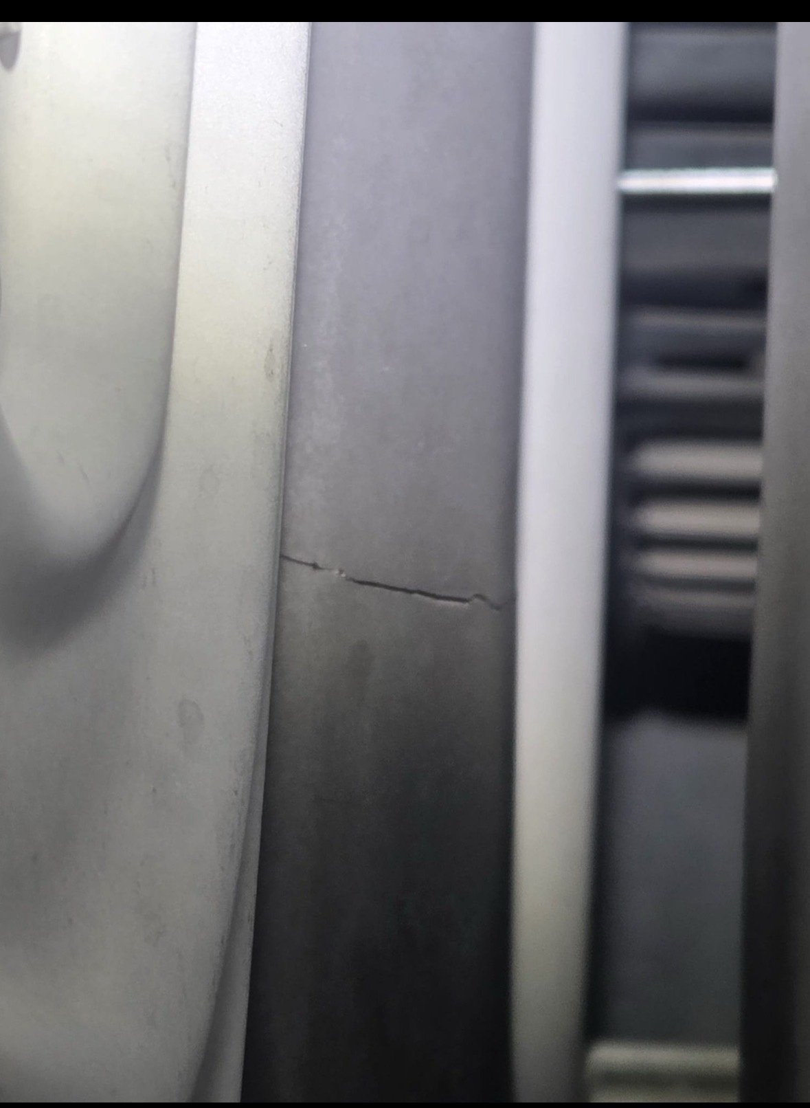

    Circled part was removed and he told me to look down into it to see the cracked HX.
    edited March 9
    did someone make that transition with a pair of channelocks?

    if there is a crack you would see it looking in after removing the side of that transition. if whatever that picture is of is a crack in the hx i wouldn't expect a detectable amount of co to get through it. if the burner is burning right the co concentration in the undiluted exhaust is <~50 ppm and that thing in the picture is tony so you are adding a tiny amount of 50 ppm gas to a much larger volume of gas and most instruments start detecting co in the 5-10 ppm range.
    but without a bigger picture of where that even is, i'm inclined to think that is some of the sheet metal or insulation around the hx, not the hx itself.
