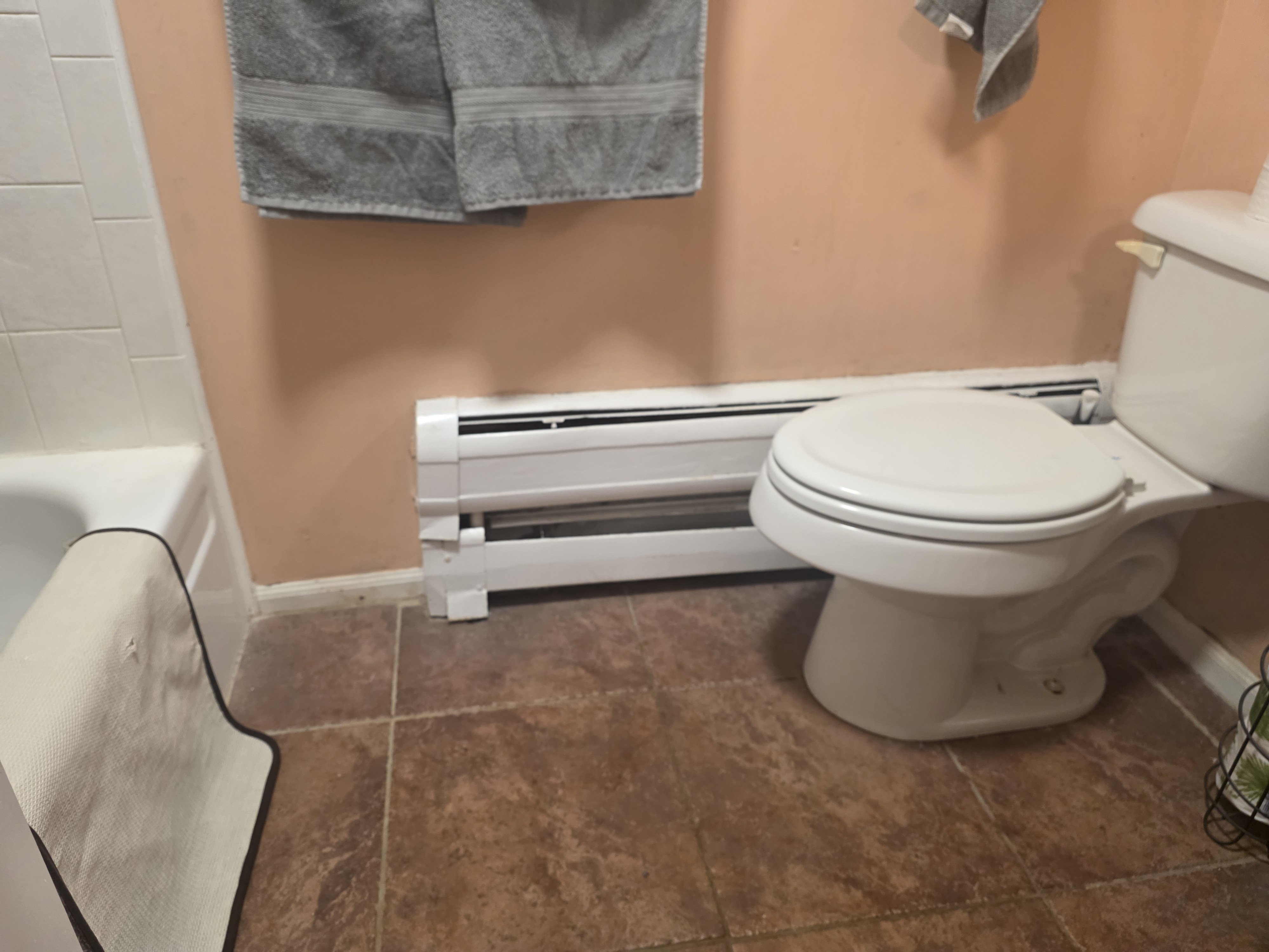

Hey...bathroom is warm...mission accomplished! Mad Dog
A different kind of "upper decker" 😈
3 -
All well and good but did they use the Haydon 750P for corrosion resistance in that location?
I always thought that adding the Letter P to the 750 model number was a significant statement for that brand of baseboard. Lets you know exactly why you should use it in the bathroom!

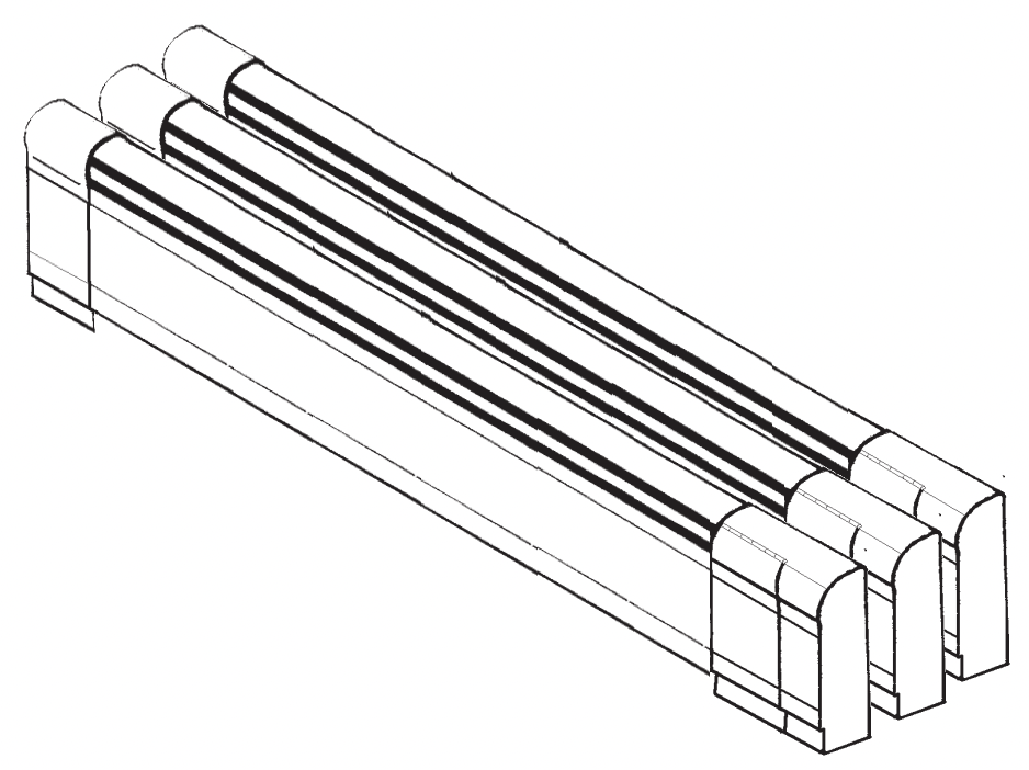

i did that for like 5' at the end in my shop in the basement because the heat loss said i needed that much more that I had wall. what I didn't know at that time was that the higher entering temp lowers the output of the upper section. so i guess i needed to continue it another 5' around the corner…
1 -
Next time do it this way…. same air inlet temperature so the same output.
You can tell that I have nothing better to do with this last illustration.

Looks like Sterling Kompak on top the bottom one looks like a different brand, so they are all mangled up Not only did they double it up he piped the fin tube without checking how the covers fit.
