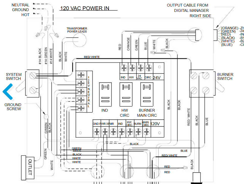

    My querry was specific for System2000 ,where the system manager has a "Service Outlet"
    Can I hook up a line from a portable generator into the outlet to power up the system?
    edited January 25
    no. that is an outlet not an inlet.
    and it isn't interlocked with the mains source

  • Robertw
    Robertw Posts: 95
    I would add, if you look closely at the wiring diagram provided, the outlet is wired to the hot side of the switch . Therefore, it will be live all the time unless the breaker or another switch up stream is thrown.
    Robert W.
    Energy Kinetics
    My point exactly. unbales that diagram is wonky (it's a little hard to read as reproduced here) plugging the generator into the service plug will energize the entire rest of the building electrics.
    JUST DON'T DO IT

    @bdd (if you're still reading this!), the power outlet is directly connected to the incoming power wiring. If you forgot to flip the breaker and plug/unplug in the right order, Bad Things would happen to the line crew, your generator, or both. A better idea would be the generator switch @JaymeHart mentioned, or something like this: https://www.geninterlock.com/ (no association with them, just a google result) which would provide backup for your entire house. I use this style myself. It's safe for the repair crews and, as others mentioned, one of the few legal ways to do it.
    I understand that some people have cordsets on their boilers so they can be unplugged from the wall and simply plugged in to a generator, but there is some question whether this is allowed by the electric code in general, and is subject to interpretation by your local electrical inspector/building dept in any case.

    you have 2 threads mixed together here. @Expenses1188 has their boiler cord and plug connected and it unplugging the cord to plug in to the generator which is completely fine(other than maybe some minor code violations about is the appliance listed to be cord and plug connected and mc isn't a flexible cord so not sure about putting a plug on it).
    @bdd seems to want to use the completely illegal backfeeding without an interlock method.
    I've heard it said, too, @ratio . Doesn't make it correct. I neglected above, by the way, that an easily accessible emergency shutoff switch is also required…
    It occurs to me, by the way, that if our OP does unplug his unit and plugs his generator in to the service outlet, then the unplugged cord (it's a male plug, no?) becomes powered. Aaargh…
