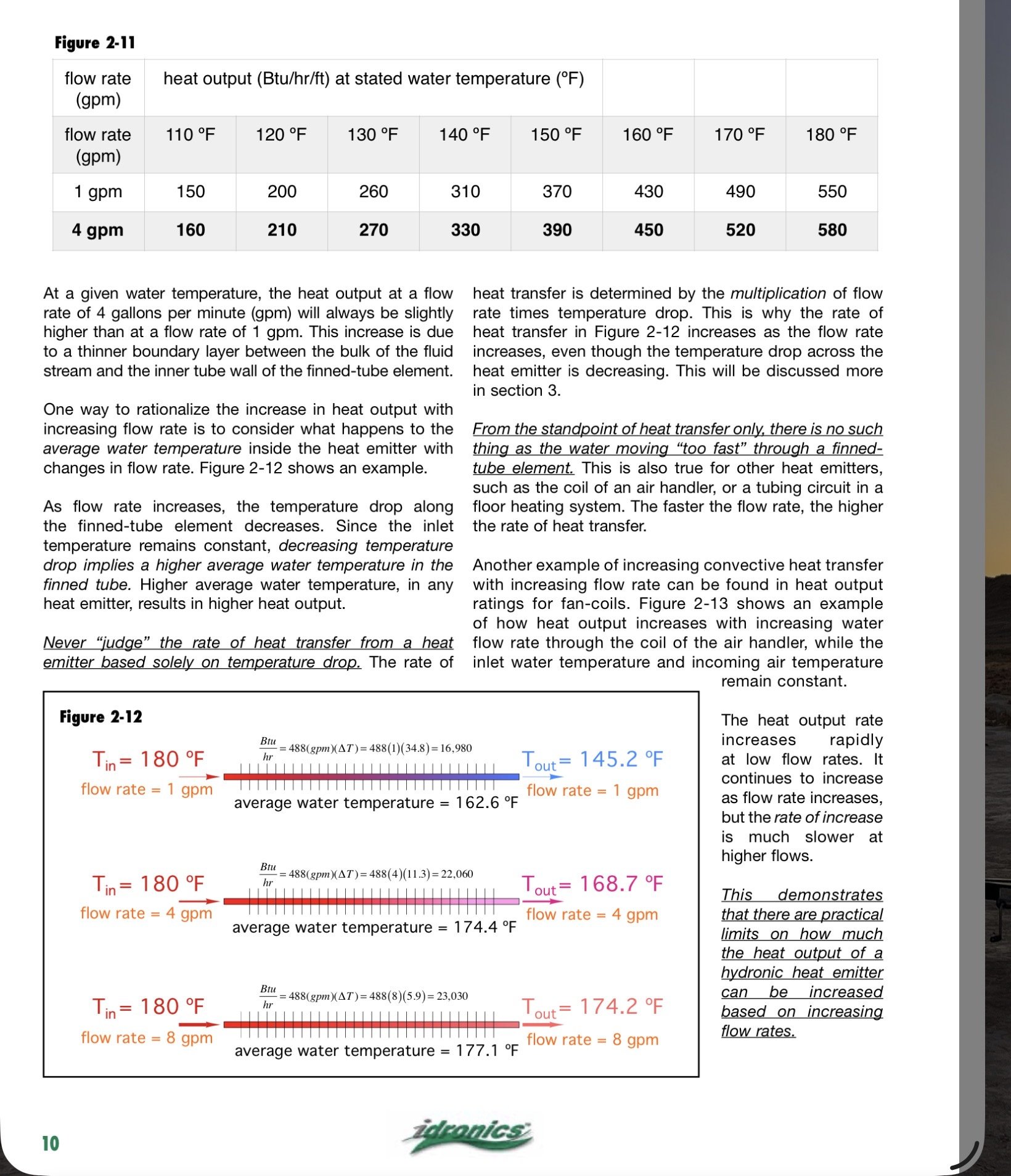

    assuming the same supply temperature is maintained, then increasing the flow will give you more heat output
    The math is 488 x flow rate x delta T (488 is the factor for water at 180 degrees)
    At the top of this page is a fin tube output chart. You notice the output / ft. goes up at 4 gpm vs 1 gpm
    The limitation is the tube size and acceptable flow. 4 gpm in 3/4 tube is about as much as you want to flow. Excessive flow leads to noise and tube and fitting erosion.
    Which is probably why the manufacturer used 4 gpm
    The lower graph shows output increase as flow increases also. It goes from 16,980 btu/ hr to 23,030 on the lowest example.
    It takes flow out to 8 gpm, that would be excessive for 3/4 fin tube, but doable if you had 1” fin tube
    At some point the extra pumping power required may not be worth the small % increase in heat output

    I believe although this seems natural (give the water time to transfer its heat), in fact this isn't a valid reason—faster flow always gives more heat transfer

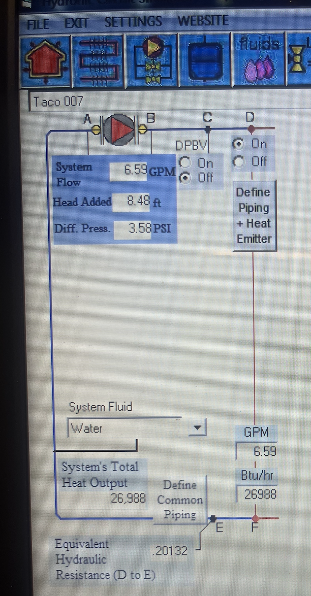

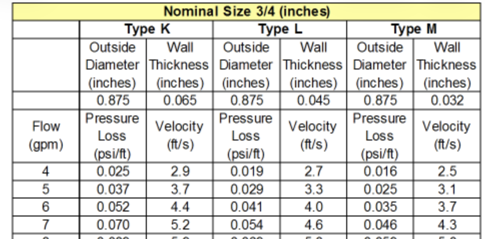

    If someone want to push a 3/4 fin tube circuit to the limit, here is what it could look like.
    I put 60' of fin tube, 40' of 3/4 tube for a total of a 100' loop. Plain water at 170°, about 450 btu/ ft at 170AWT
    With a 007 it looks like this.
    6.5 gpm keeps you right at the 4 fps velocity in type M copper
    Screenshot 2026-01-23 at 8.51.49 AM.png Screenshot 2026-01-23 at 8.10.03 AM.png
