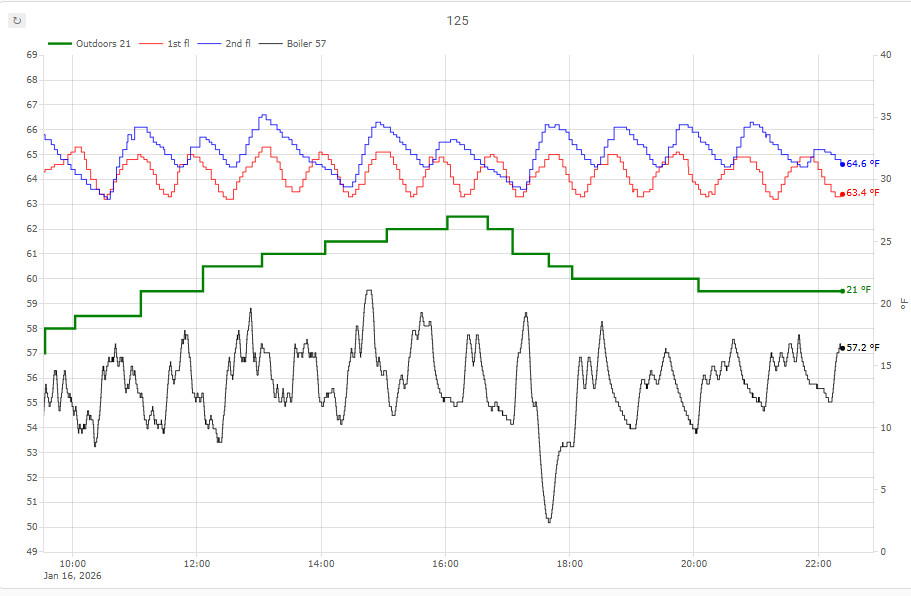

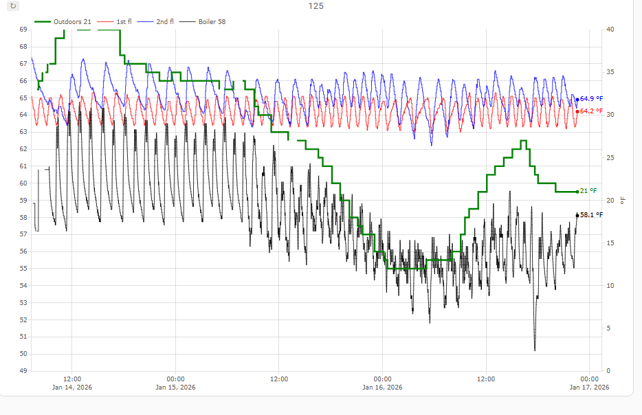

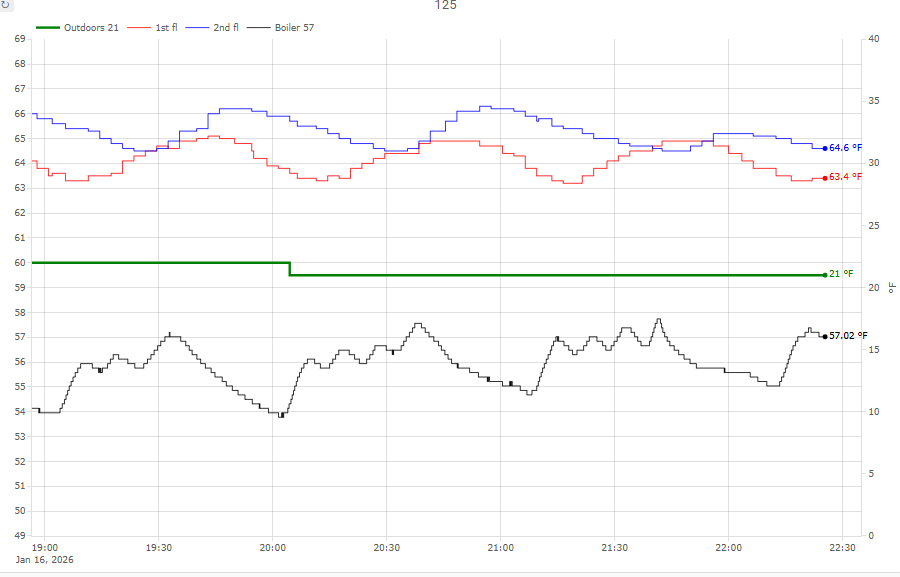

I am hoping someone could help analyze the data below.
This home is in Sullivan County, NY, where today's temp started in the low teens and rose to low 20's, F.
The 2 story house uses an oil fired, 20 year hot water boiler, baseboards, with each floor its own zone.
Until this afternoon, the copper pipes in the unconditioned, uninsulated basement were exposed to the basement air (which is indeed affected by the outdoor temperature). To be clear, the heating pipes were uninsulated.
This afternoon I installed foam insulation on the heating pipes from the boiler to where they go upstairs.
I monitor and collect data as much as possible.

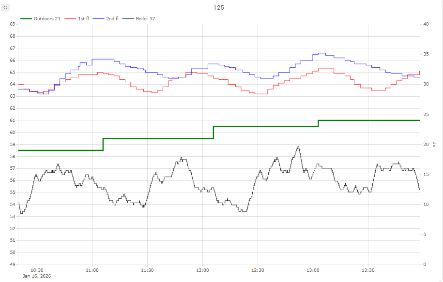

The sensor I use for monitoring the boiler is a simple temperature sensor hanging an inch next to the exhaust vent pipe. At best, the readings can be considered realiable across time, but the values are definitely not useful for their absolute values.
I have attached the full day's graph, as well as zoomed in periods before and after the insulating of the pipes (disregard the boiler pipe heating from 2 to 7).
The shape has definitely changed, but I don't know what to make of that change.
Does anyone have any insights about what the shape of the data says about anything?
Thank you!
Here are the graphs:

    Could the 'noiser' pre-insulation versus the post-insulation, be wind / draft related in the boiler room and just coincidental ? There seems to be a ripple there either way, maybe gas line pressure variances changing the boiler's output a slight bit.
    " (disregard the boiler pipe heating from 2 to 7). "
    Have no idea what this means, 2 to 7 what ? AM, PM (14:00 to 19:00) or something else ?
    I would think insulating the pipes in the basement would just lower the average temperature in the basement during the winter heating season. Shorter boiler run time to heat the desired space. May save some fuel too.

    I'm not sure you'll be able to gain much info from this to conclude difference between before and after insulating pipes.
    If you could measure how much fuel you burned before and after….on exact weather days, that could tell you something. In general, I see about 8 thermostat cycles in 12 hrs (blue line) when is 5F outside. What is the 99% design temp? It looks like you could turn the supply water temperature down to smoooth out some of the peaks/valleys in red and blue lines.

    @109A_5 It certainly is possible that there is (or was) a draft that affected the flame. I'll have to take a look to see if there is some regularity to the flame variation that would point against that.
    I meant 2:00pm-7:00pm (1400-1900), sorry. The insulation was being installed, and then I better insulated around the basement door to fill the gaps. I hadn't thought about a draft or wind, but only maintaining the temp.
    It sure indeed look like it lowered the temp in the basement.
    @bjohnhy I wish I had a direct way to measure fuel consumption. I tried a tank gauge that ultrasonically measures oil height and sends the data to the cloud, but I don't believe the data for a second. I've come to use an inferential measurement of time_firing * nozzle size for a rough idea (and day to day comparison).

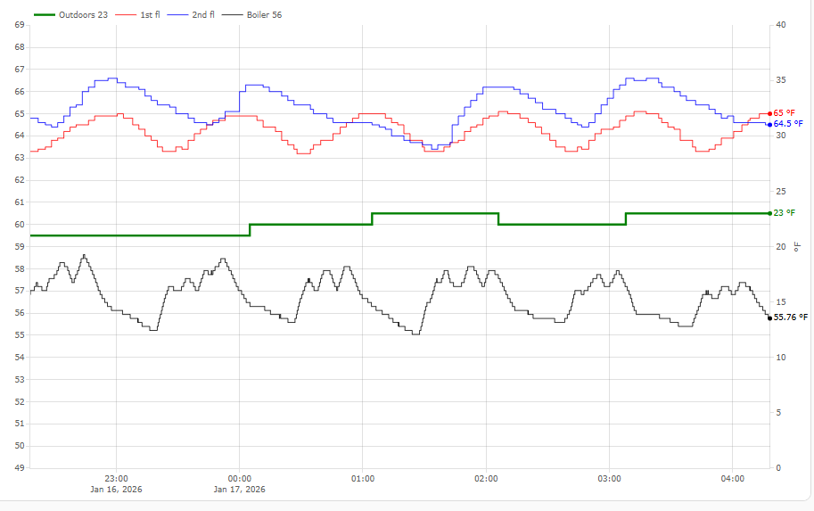

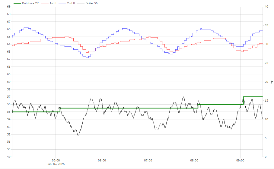

    Here's the overnight graph. The heating cycles are interestingly similarly shaped.
  • josephny
    josephny Member Posts: 428
    • 1) It looks to me that the boiler-off times (the amount of time between firings) increased almost double, from 25-30 minutes to almost 50 minutes after installing the insulation. The boiler is cycling less frequently.
    2) The boiler temp tops are flatter.
    3) The basement temp is roughly the same, so the underground nature compared with the improved basement sealing from the outside is do its job. But, the rate of drop of temp is slower.

    However, doesn't the substantially extended interval between running (firing) time in conjunction with the same temp inside the zones indicate that the btu saved by insulating the pipes is indeed substantial?
    I think it's reasonable to say that the above statement means that substantially less fuel is needed to keep the zones comfortable.

    @josephny I don't think you're interpreting your data correctly. Before insulating, your boiler was running about once per hour. After insulating, your boiler was running…once per hour. Look at the actual room temperature lines (blue and red). They follow the same 1-hour periods before and after.
    Trust me, I've done the same kind of temperature monitoring/graphing/boiler run time analysis on our building, and it's easy to fool yourself into thinking some tweak you made is suddenly saving you a lot of energy.
    The best possible data "collector" you can get is an ecobee smart thermostat that records boiler run times. Using the beestat.io interface on the web, you can collect detailed stats on daily, weekly, and monthly boiler run times. Because your oil-fired boilers run at a fixed input rate, you can calculate exactly how many gallons of oil you burned based on the ecobee's run time data. In our case, each boiler burns 1.2 gallons per hour of run time. I check our ecobee data from the beestat.io website at the end of each week, and I log the weekly run time totals. I now have 1.5 years of weekly run time data, plus 10+ years of oil consumption records.

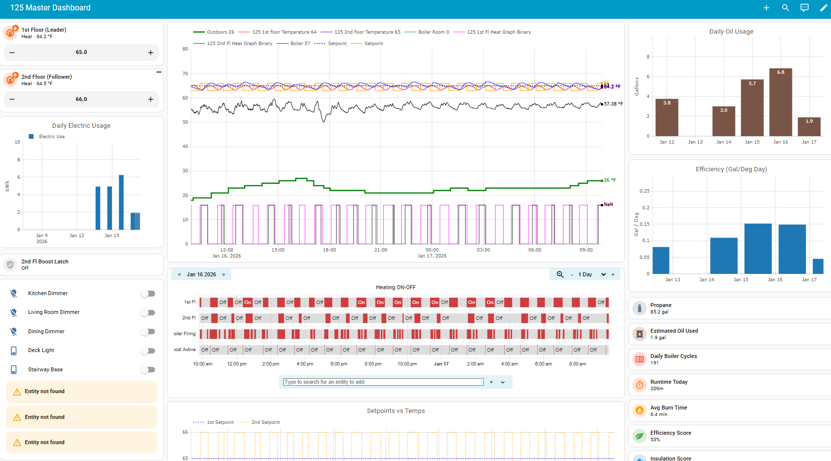

    Funny you should mention Ecobee. That is what I use here (one for each zone) and many other locations.
    I don't use beestat because I have my own data gathering system through Home Assistant.
    Below is part of the dashboard for this location.
    I use separate temperature sensors outside the Ecobee system to fill in where the Ecobee cannot. In this case, for example, the sensor measure the heat near the boiler's exhaust. That tells me when the boiler is firing, whereas the Ecobee does not (it only tells me when the Ecobee is calling for heat).

    Great, you have all the data you need. But you still need to interpret it correctly. The boiler is still firing about once per hour, according to the boiler temp sensor. So insulating the basement pipes didn't change anything measurable in that data set, and I wouldn't expect it to. At most you might see a few percent savings at the end of the year, and then you'll have to decide how much of that percent change was due to HDD's variation, how much was due to wind variation, and how much (if any) was due to whatever insulation/airsealing/etc you did before or during the heating season.

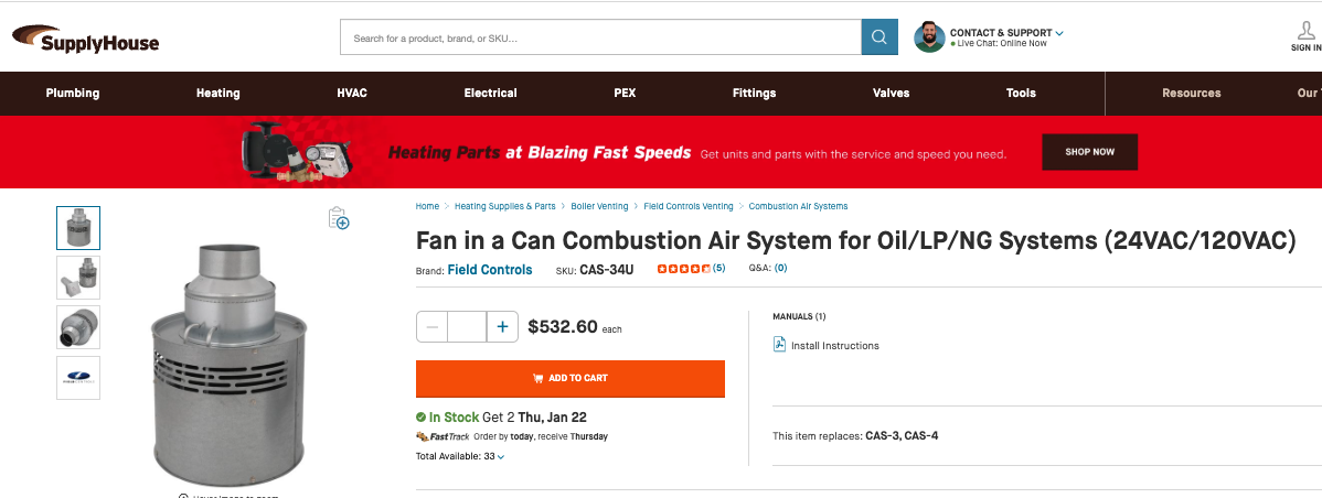

    Don't cut off your combustion air supply to the boiler. Flue gasses exit the the boiler and then exit the building, fresh air has to get to the boiler somehow.
    jesmed1ethicalpaul
    ethicalpaul Member Posts: 8,928
    Yeah this casual comment about insulating a door really concerned me too.

    Thank you all for the important reminder about ensuring enough fresh air. The house is 100 years old and the basement is not finished. I know that statement in and by itself tell us nothing definitive about the amount of infiltrating (correct word?) fresh air.
    Is there a simple way to determine if there is sufficient air?

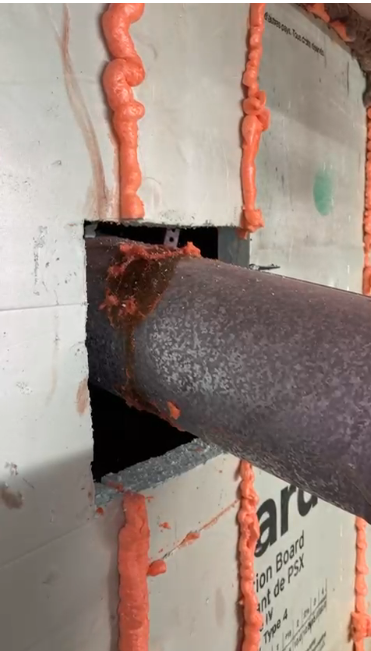

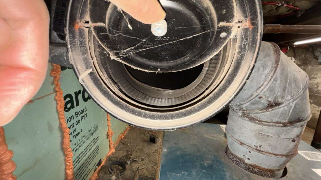

    I'm not too worried because I still haven't done anything about sealing around the exhaust pipe, on recommendation here:
    Which, thanks to you all, now looks like this:
    Good idea to seal this up?
  • bjohnhy
    bjohnhy Member Posts: 210
    Is that double wall (B vent) or is that single wall vent?
  • josephny
    I don't know.
    Do either of these show which one:
    pecmsg Member Posts: 7,270
    That's single wall.
    In the earlier picture you can see where the foam melted.
    Get that foam board further away also.
  • josephny
    Got it — thank you.
    Roughly how many inches?
    What should I use to seal the gap between pipe and foam board to prevent drafts? How's concrete board (like hardiboard or durock?

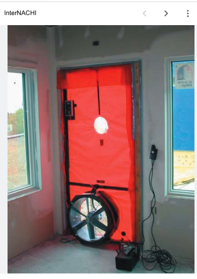

    hot_rod Member Posts: 27,806
    To determine air leakage you can have a blower door test performed. It would be good to know what the air leakage number is in the home.
    Also the test can usually identify where the leaks are, around doors and windows, framing to foundation, etc. Then you can seal areas increase comfort and lower heating and cooling costs.
    There are mechanical ways to direct air to the boiler if the basement gets sealed tightly.
    foam is give 12” above.
    You could use concrete board or any other fireproof material. Is it worth the expense? Personally I don’t think so. That opening is peanuts compared with all the other leaks you gave.

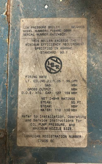

    what size is that boiler, and how many feet of fin tube do you have, total?

  • bburd
    bburd Member Posts: 1,318
    The way that vent pipe looks, it may be corroded to the thickness of paper. I've seen it happen. Might be wise to check it for soft spots and replace if you find any.
    Bburd

    This is the plate on the boiler:

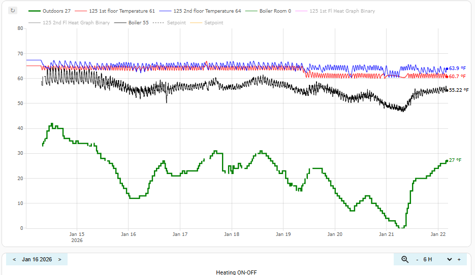

  • bjohnhy

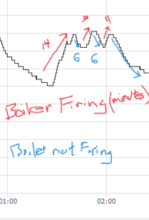

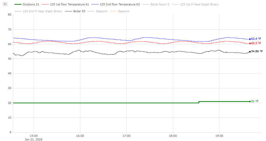

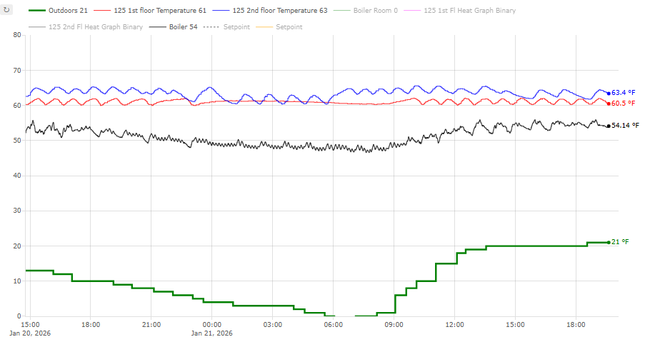

    The ripples that you reference, I believe this is the boiler cycling on and off.
    The thermostat cycles about once every hour. But the boiler firing on and off is more frequent. When thermostat calls, Boiler fires ~15 minutes, off 6 minutes, on 7 minutes, off 6 minutes, on 4 minutes (Thermostat call met), boiler off ~30 minutes, thermostat calls again. This is with outside temp 23F. @josephny mentioned this sensor was near boiler exhaust.
    @hot_rod mentioned concern for short cycling based on exhaust vent corrosion. Could these ripples be a sign of short cycling, one could argue it is. @josephny would have to confirm with onsite eval.

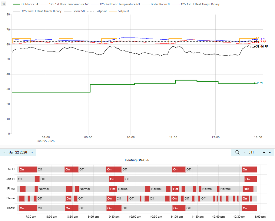

    This is interesting (to me), and I hope I'm not getting too caught up in semantics.
    In my journey through understanding this, I'm at a point where I prefer to differentiate between different kinds of boiler "cycles:" (1) The rythmic, almost repeatable heating/non-heating, (2) the calls for heats, and (3) the actual firing or burning of fuel.
    I've come to realize that a boiler doesn't necessarily fire when it is told me, often because safety controls don't let it.
    In this particular situation, the rythmic cycling includes very short periods of non-firing. I've been attributing those to safety controls preventing the boiler from firing. But, I still consider it part of the ON portion of the cycle because (1) the tstat is still calling for heat and (2) because the boiler is still hot and, in some way, "producing" heat.
    I make a distinction because I think calling the ripples "cycling on and off" doesn't tell the full story.
    As you allude, however, when the outside temp drops (or, at least I think that is the connection), the ripples go away — presumably because the boiler gets to work harder and still not hit the safety limits.
    That would, I think, disprove the idea that the ripples are caused by a failing exhaust.
    I'm not certain or even moderately confident of any of this, so if I'm off the wall, please let me know.

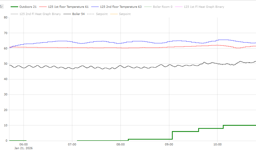

    Here's some more graphs.
    Zoomed in:

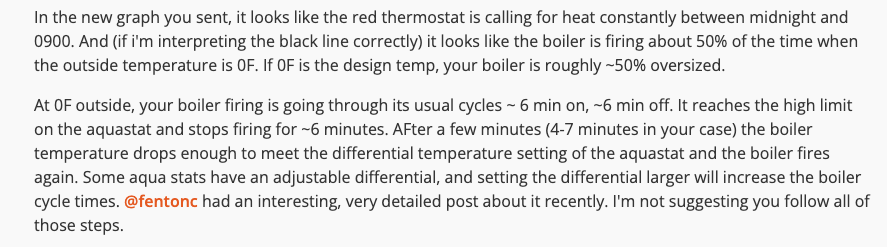

  • bjohnhy
    edited January 22
    I'm not suggesting that a failing exhaust is causing the variations in the black line.
    In the new graph you sent, it looks like the red thermostat is calling for heat constantly between midnight and 0900. And (if i'm interpreting the black line correctly) it looks like the boiler is firing about 50% of the time when the outside temperature is 0F. If 0F is the design temp, your boiler is roughly ~50% oversized.
    At 0F outside, your boiler firing is going through its usual cycles ~ 6 min on, ~6 min off. It reaches the high limit on the aquastat and stops firing for ~6 minutes. AFter a few minutes (4-7 minutes in your case) the boiler temperature drops enough to meet the differential temperature setting of the aquastat and the boiler fires again. Some aqua stats have an adjustable differential, and setting the differential larger will increase the boiler cycle times. @fentonc had an interesting, very detailed post about it recently. I'm not suggesting you follow all of those steps.

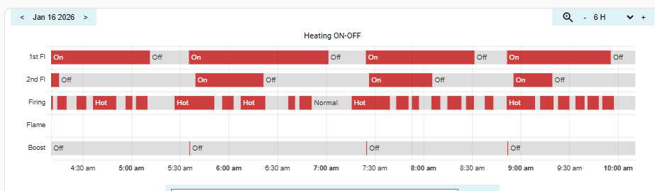

  • bjohnhy

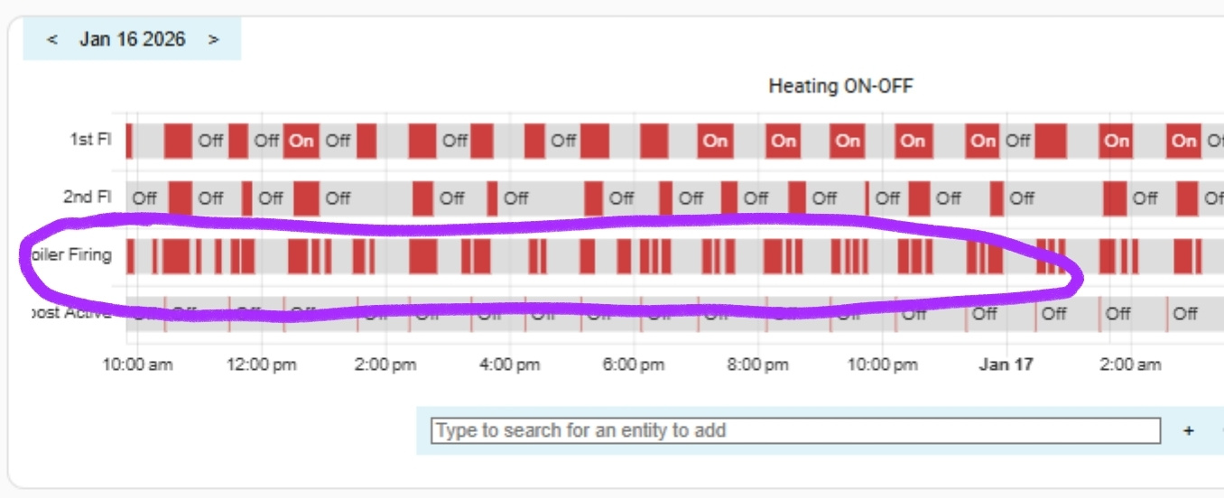

    I just noticed this data line in your log. What do you use to capture this boiler firing data?
    Can you post your log (screenshot) for "boiler firing" for that same time frame with 0F outside, maybe zoomed to just 2 hour frame ~0600 to 0800.
  • DCContrarian
    DCContrarian Member Posts: 1,507
    Here's my analysis: the temperature of the basement doesn't seem to have changed much after the pipe insulation was put on, it seems to still be in the high 50's. As such, there's no reason to believe that the whole house heat loss has changed at all, so I wouldn't expect any impact on comfort or fuel usage.

  • josephny
    Good catch on the heating history timelines .

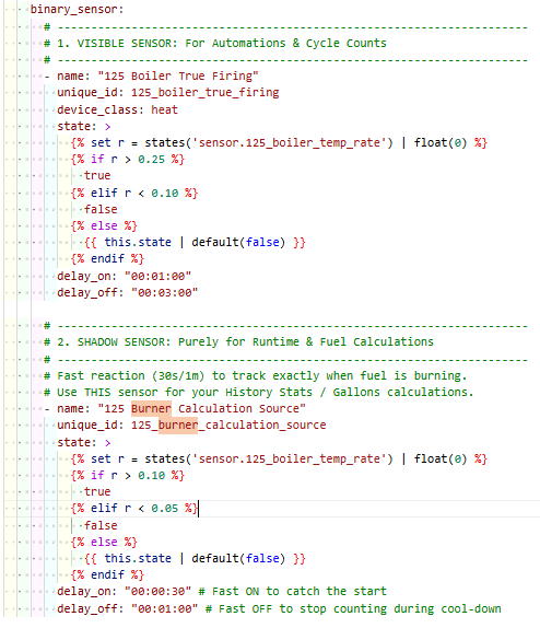

    The 1st fl and 2nd fl lines (the first 2 lines) show the times when the tstat calls for heat (based simply on whether the temp in the zone is below the setpoint, subject to the swing setting).

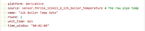

    The Boiler Firing line (third line) is based on the rate of change of the temp sensor, as follows:
    When the rate of change (over a rolling 2 minute window) is:
    1. greater than 0.25 (rising at a rate of .25*/min or more) consider the boiler firing; or
    2. less than 0.10 (rising at a rate of .1*/min or less) consider the boiler not firing.
    The deadzone between rising >.25*/min and rising <.1*/min is to prevent the ripple or chatter.
    Here is a very zoomed out view that shows the general temp variation in the basement:

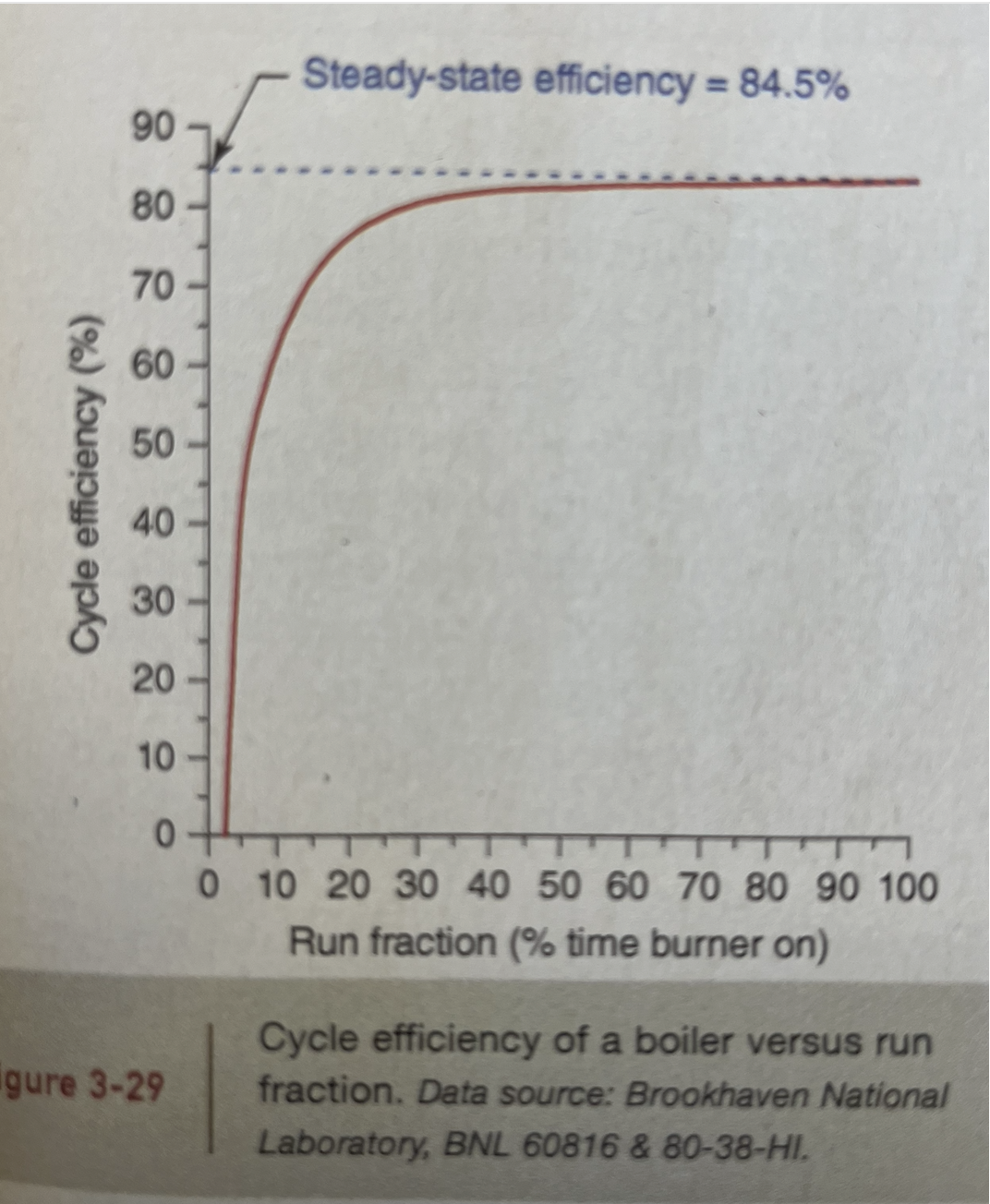

    If this is accurate?
    Run Cycle 6+6= 12
    6 ÷12= .5 or 5%
    5% on the bottom axis of this chart, run straight up to where it intersects the curve, cycle efficiency to the left axis. So at 6 minutes on 6 minutes off at 0°? 30- 40% boiler efficiency.
    Generally you want the boiler to run 10 minutes every time it lights off. This helps assure the combustion chamber and all the flue up to the roof drys out, gets above condensing (dew point) temperature. If not you start to see corrosion around the parts of the combustion area and flue piping. The joints in the flue pipe is where you can see moisture has been working on the metal.
    So a few undesirable things are at play with an over-sized boiler.
    The problem is I am not clear on what "ON" means, for the purposes on efficiency/duty-cycle.
    I don't think it means 'tstat calling for heat', but does it mean actual flame or does it include both flame and coasting?
    Here's a 6 hours graph. Not the differences between tstats calling for heat, firing that includes some coasting, and strict flame on. (Ignore "Boost".) The latter 2 are derived or inferred from the relative temp of the exhaust pipe.
    ^^^ let's all remember this when people talk about how much savings one will get from insulating their mains
    burner on, since that is what is using the gas or oil.
    A data logger on the electric supply would show electrical consumption, which is some of the cost of heating.
