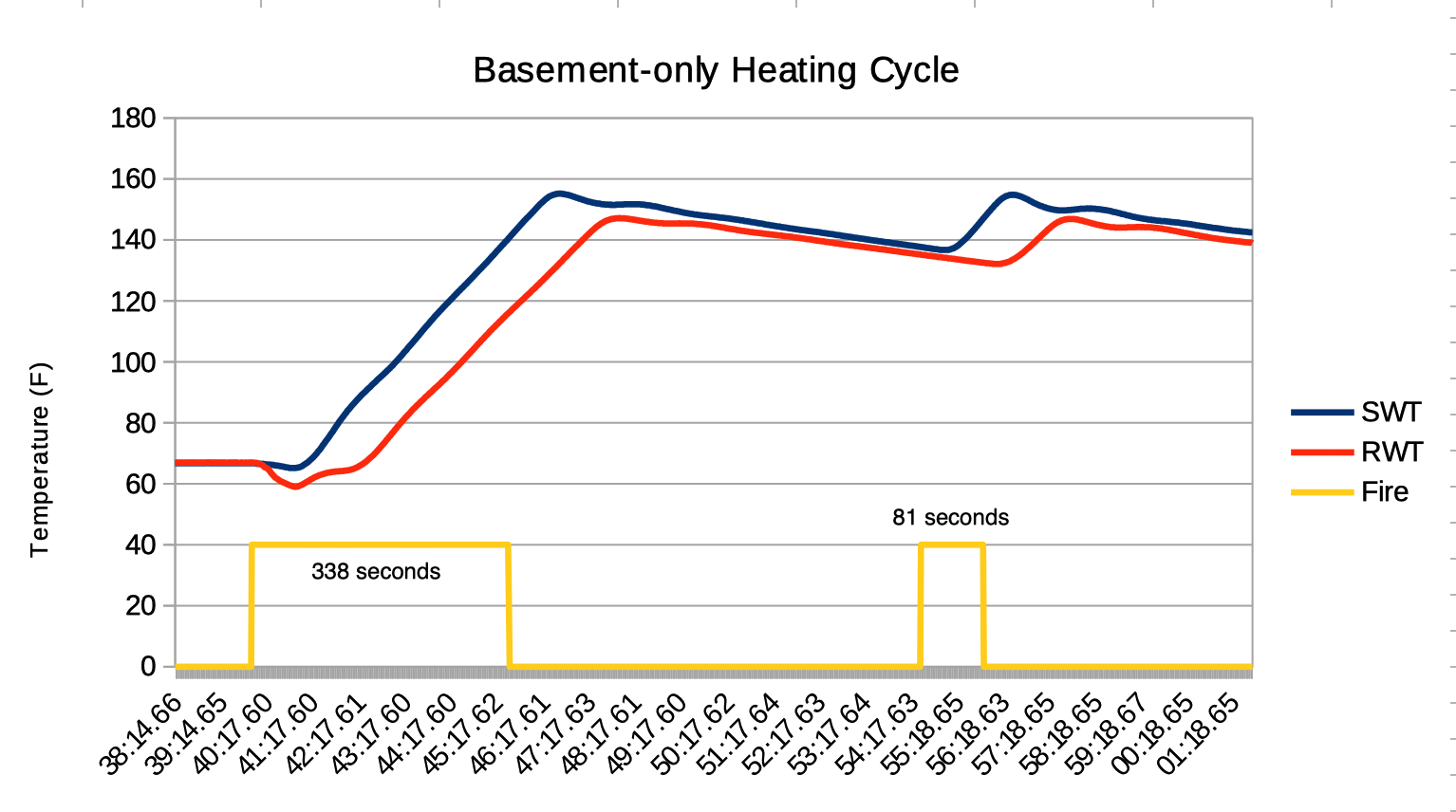

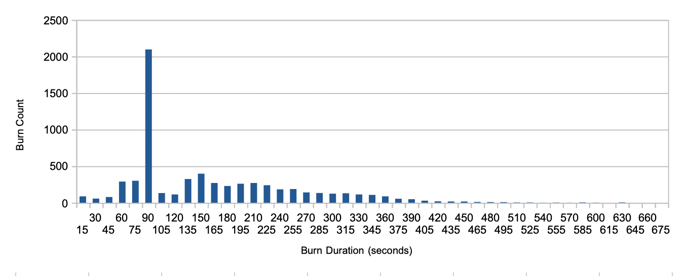

This is what a single cycle on the smallest zone looks like (with that 80 second burn pattern repeating until the thermostat is satisfied.

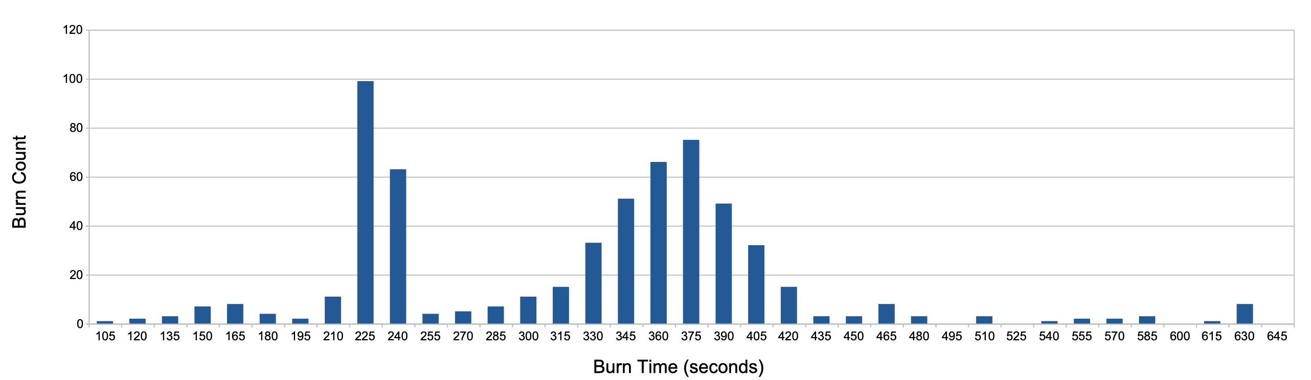

And this is what the distribution of burns looked like over the entire heating season, with those sub-90-second burns dominating:

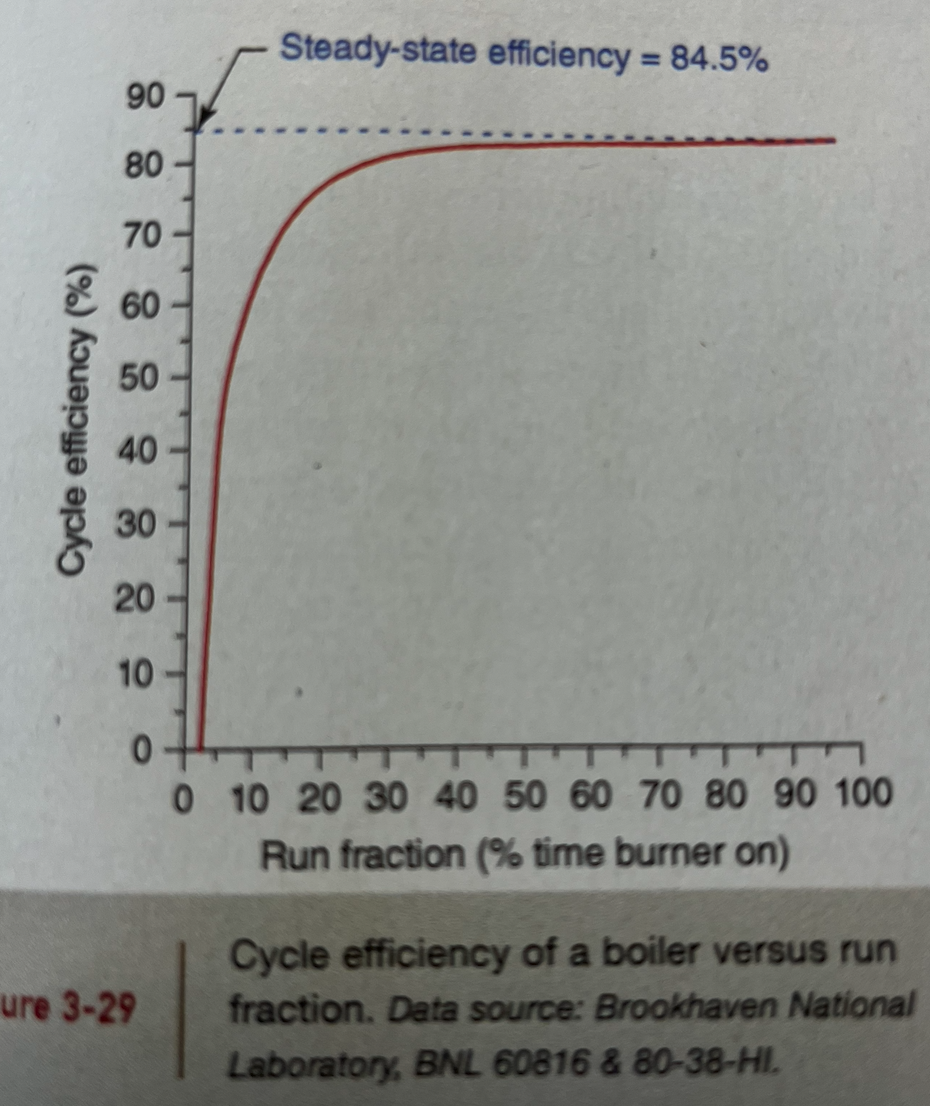

  • Efficiency: This is related to short-cycling. There are many ideas and opinions about what exactly 'efficiency' means, but I will define it for my purposes as the fraction of BTUs from the burned gas that make it into the conditioned parts of the house. A boiler placed in a shed outside that maintained the water temperature all winter, but never circulated it inside, would have 0% efficiency with this definition. An open gas flame in an otherwise sealed house would be terrible for air quality, but would have 100% efficiency. When your radiators don't have a lot of thermal mass associated with them, and your boiler is in an uninsulated part of your basement, and your oversized setup can very quickly satisfy calls for heat, a lot of BTUs might go into heating up the boiler itself and then leak away into the uninsulated mechanical room without ever making it into the conditioned parts of your house.

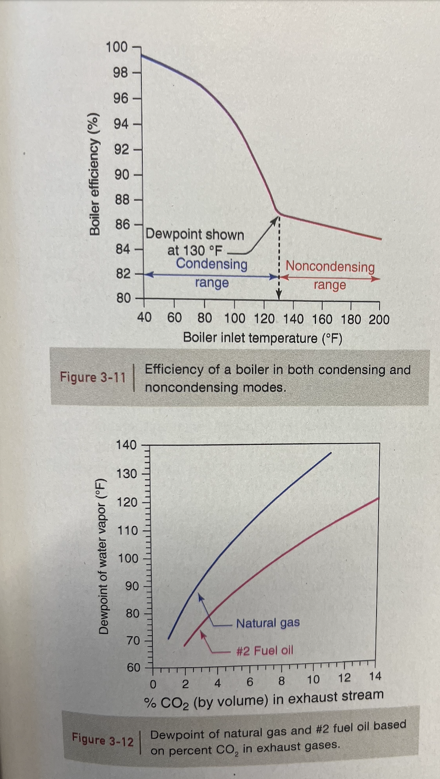

Here is an excellent chart showing 'cycle efficiency vs run fraction':

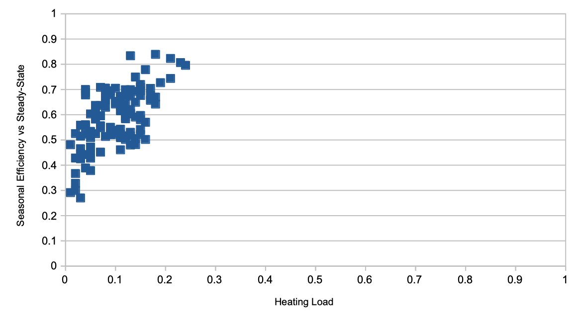

My system, being ~5x oversized, operated nearly all season in the extremely inefficient part of this chart:

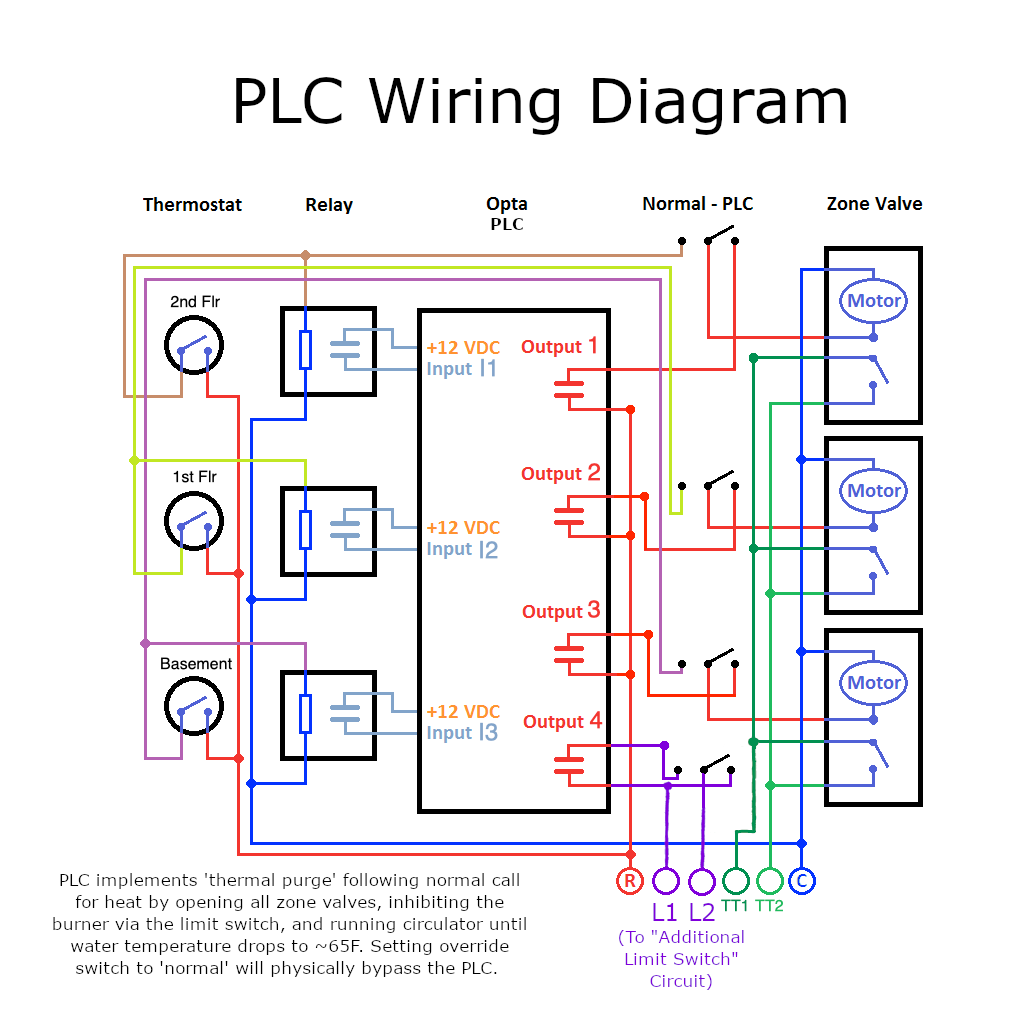

    To address the short-cycling, I effectively wound up modifying the aquastat (using an additional PLC controller with a strap-on temperature sensor and an extra relay to inhibit the burner) to use a 60F differential, rather than the default 20F. This lowers the average water temperature in the baseboards, but they could actually meet the heat loss at the design temperature with 120F SWT. With my PLC, the aquastat high limit remains at 180F, but now waits until it falls to 120F before firing again. This obviously triples the run time for 'short' burns, but it also lowers the average heat output during a call for heat and allows for more overlap between the different zones calling for heat. The cycling is drastically reduced.

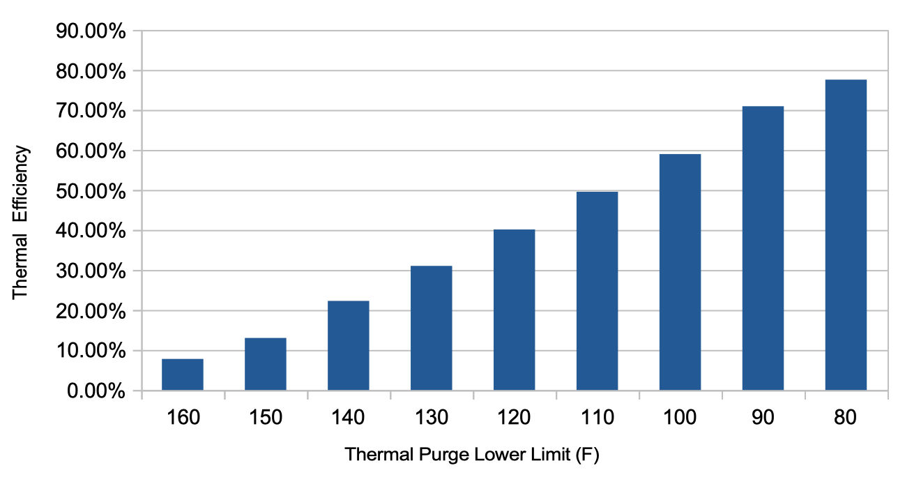

    The best graph came from a series of isolated experiments where I just tracked delivered BTUs vs the temperature when I stopped purging:
    BTUs escape much easier from radiators than the boiler itself, so it's extremely effective to just keep the circulator running. Looking at the daily results from when I started tracking all of this vs now shows that there is almost no dependency on estimated efficiency vs runtime:

  • @fentonc I'd like to see more details on your plc setup.

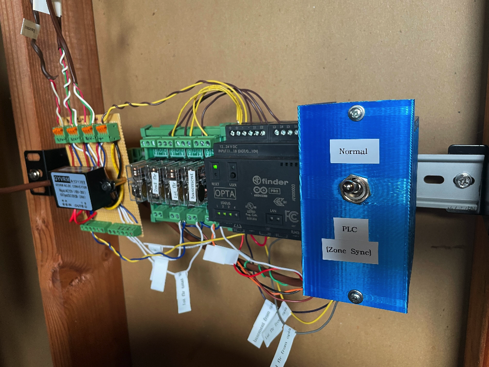

    @Forge_Fixer88 - it's an Arduino Opta I mounted next to my boiler. Here's the schematic for the setup (there is an additional analog input that's not shown that connects to a temperature sensor strapped to the supply pipe right as it exits the boiler):
    This PLC implements the post-call thermal purging as well as the 'aquastat override', and isn't networked to the outside world at all, but it has a serial port output that goes to a separate 'monitoring' microcontroller. The monitoring setup has sensors for the supply/return temperatures for all 3 zones (to estimate average temperature of that zone) and the 'circulate' and 'burn' LEDs on the boiler, and reports back to a logging script on my computer once a second.

    Here is what the setup looks like (from when it was initially implemented zone synchronization):

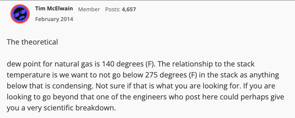

    I'm not sure about your condensing temperatures? It has to do with dew point of the fuel and % of CO2 in the flue gas measurement. 130°F is the number I see most boiler manufacturers suggest for NG fueled boilers.
    Do you have the combustion analyzer printout showing temperatures and CO2 readings? Reading are only useful if taken at steady state operating conditions.
    If you are running low CO2, be sure to look at CO numbers
    Steady State being when the supply and return temperatures stabilize, the heat emitters absorbing all the boiler can produce. SWT no longer rising, RWT stabilized.

    I had found a chart of %O2 vs Dewpoint temp that I was using, but it seems to match your %CO2 vs Dewpoint temp chart above - 6.5% CO2 & 9.4% O2 == Dewpoint temp of about 117F.
