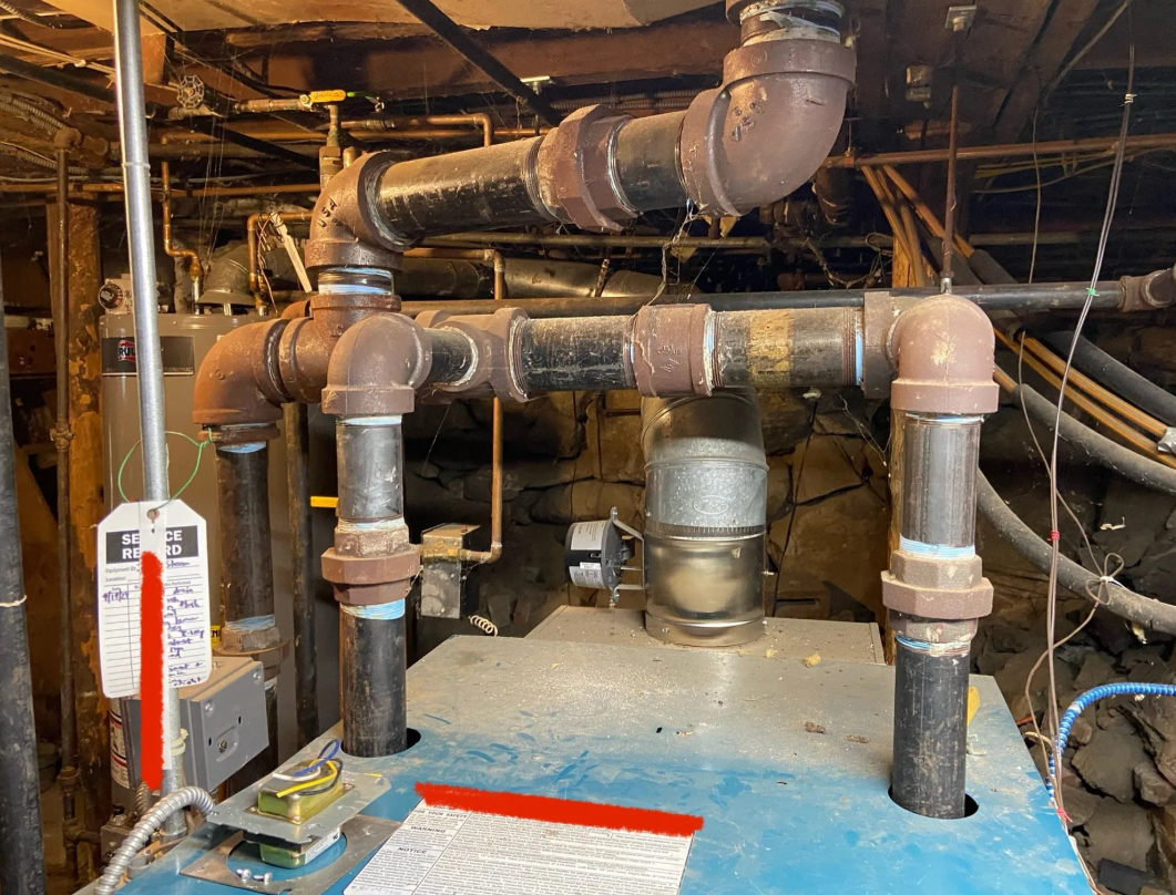

That's why we always say the installer is more important than the boiler (except for the Burnham independence line). Near boiler piping is a critical aspect of the install and is stressed over and over again by the gentlemen on this site. You mess up the near boiler piping and you will pay the price for it.

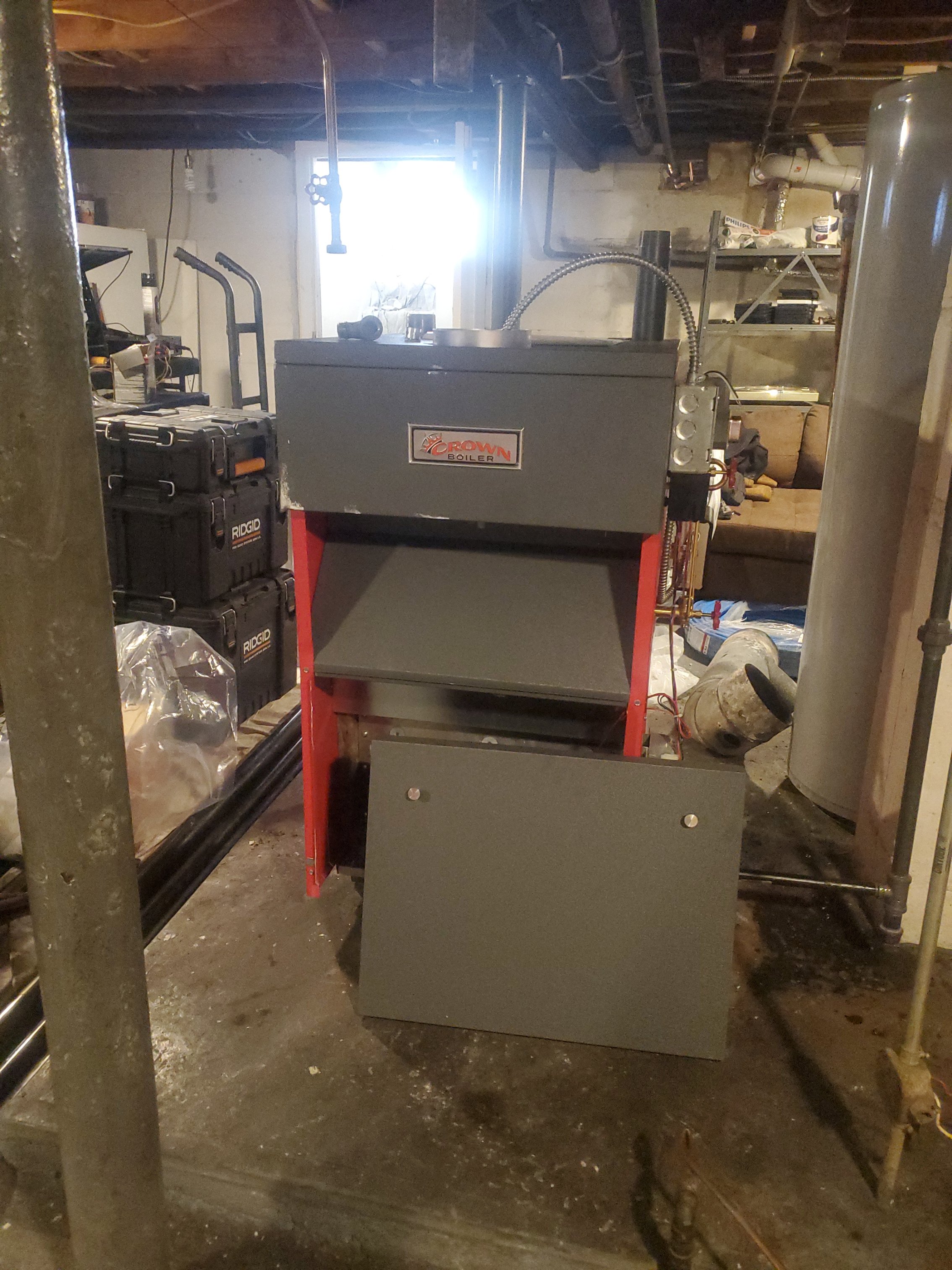

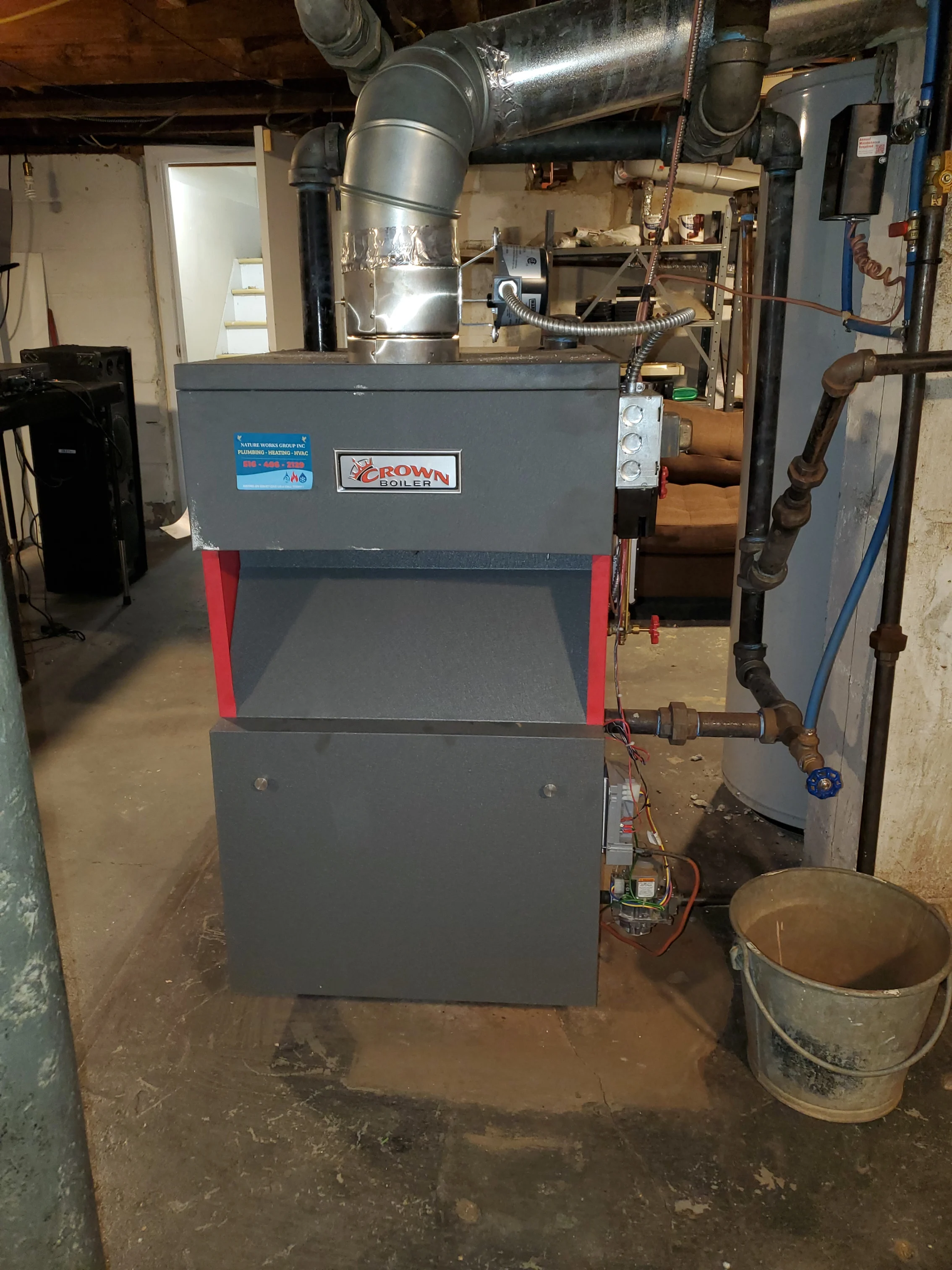

They did not bother to set the steamer on concrete blocks either so that is one more issue with this poor installation.
You feel trying to piss people off that are in the process of trying to fix their mistake and make things right is a good idea?
I think that's terrible advice.
Blocks are optional and would greatly depend on the situation. I didn't put mine under blocks either.
It is on a raised slab.
Sorry, I missed that 😔
If they did it not follow the boiler builder's instructions for the correct installation I would be pissed off so no worries there. How are they supposed to skim the boiler with that installation? Using the drawing 7.2 that Ed provided it would have made more sense to turn the boiler 90 degrees clockwise to expose it enough to have a skim port.
As far as the boiler mount/placement, I missed the raised slab which is why I commented as the concrete color between the floor slab and the raised slab were identical so that is on me.

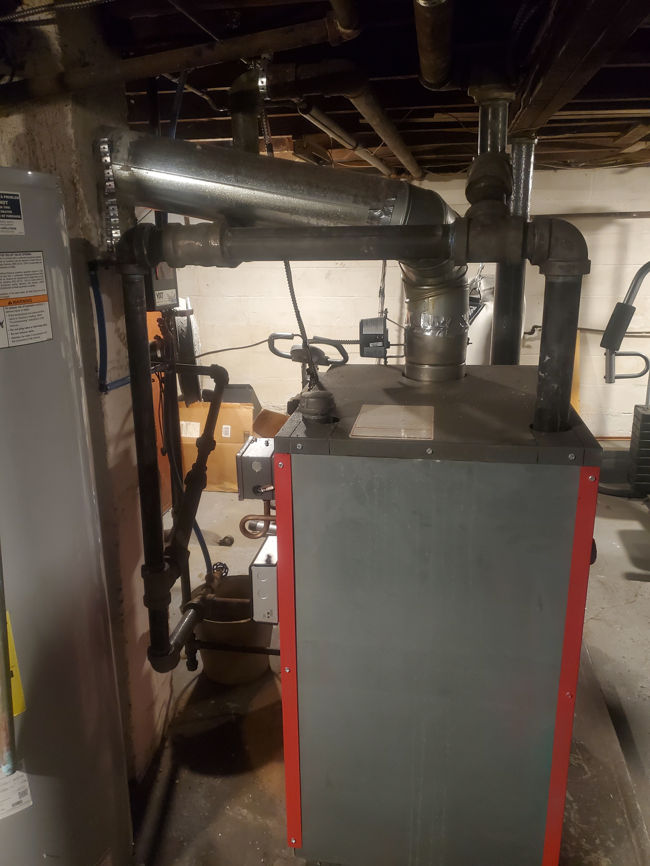

Also, quick update.. Here is the back of the boiler. I only showed the front previously. Looks like I'm missing the connection on the left according to the pic below
1 -
That is a horrible instal and it’s a shame you paid good money and didn’t get a quality job. I’m a plumber in NYC and can’t say I’ve ever heard of That company. What area of Long Island are you in?

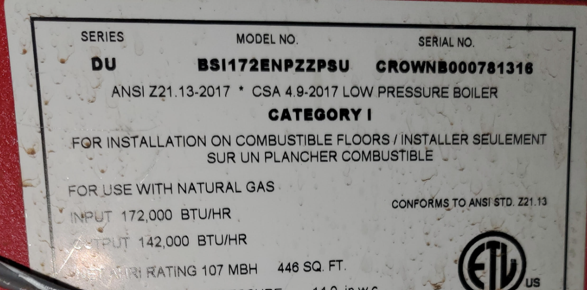

Not only are the radiators almost always grossly oversized, but we have boilers that are no less than 33% oversized and often 50-100% oversized. On a rare occasion you'll find the radiators properly sized but it's rare.

The first step in assessing whether your gas bill is "too high" is having a good understanding of your building's actual heat loss. I grew up on Long Island in a 100+ year old house that burned oil, and I'm having trouble believing that you heated an average-sized (?) house of similar vintage on Long Island with little more than 1 gallon of oil per day (from your statement that you would typically get a delivery of 60-80 gallons every other month, which works out to 30-40 gallons per month, or 1 to 1.3 gallons per day.)
To put that in perspective, I maintain our 4-unit 100-year-old condo building (built just like a house but with 4 units) in the Boston area, so slightly colder than Long Island. We have upgraded windows, 10" of cellulose in the attic, but no insulation in the walls. Even so, our heat loss isn't bad. In a 4800 sq ft building, in the coldest months of January and February, we average just under 300 gallons per month, using 82% combustion efficient Weil McLain WGO-5's. On a design day with outside air temps at zero degrees, we burn on average 0.6 gal/hr, for a gross input rate of about 84,000 BTU/hr, or about 17 BTU/hr/sq ft, which is reasonable for an older house in our zone.
So if you have a similar 100+ year old house on Long Island, we should be in the same ballpark per square foot heat loss. We use just under 300 gal/month for 4800 sq ft, so about 0.06 gal/sq ft in the coldest 2 months. So if your house is, say, 1500 sq ft, for a similar heat loss, you'd be at 0.06 x 1500 = 90 gal/mo. Our oil costs about $3.50/gal, so that would be $315/mo for you in Jan/Feb. That sounds reasonable, and I guarantee you many, and perhaps even most, houses on Long Island are spending more than that in heating costs per month.
But you say you were using less than half that in oil? 30-40/gal/month? In January and February, in a 100+ year old house on Long Island? I could believe that if your house is, say, only 750 square feet, or if your 1500 sq ft house was built 10 years ago with 2x6 double-insulated walls and triple-pane windows. Something isn't adding up, unless your house is much smaller than average or much better insulated and air sealed than the average 100-year-old house on Long Island.
1 -
So the snowman boiler at 60% efficiency costs less to operate than the Crown Gas boiler rated at 82%. Your Oil Dealer must have had great service technicians that knew how to make old coal conversions operate as much higher efficiencies. Perhaps it was operating at 75% efficiency and not 60%.
There is a major problem with the way this was specified and installed. I believe that a good professional with steam experience will be able to help you.
Even if the snowman was operating at 82% combustion efficiency like our WGO-5's, an oil consumption rate of 1 gal per day for an old house on Long Island heated to 74 F in January is miraculously low…
Put another way, 1 gal/day burned at 100% efficiency would average 5800 BTU/hr, which is about the heat output of one 1500 watt space heater. So the OP has been heating his entire 100-year-old house on Long Island to 74 F in January with the equivalent of one 1500 watt space heater? Hmmm…🧐
