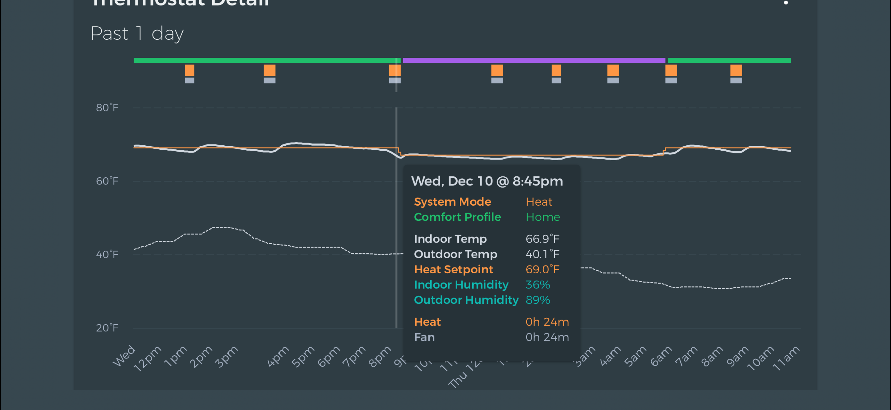

I have a Ecobee premium thermostat with it configured and knowing I have a steam boiler, with it set with a 1 degree temp differential. I have it set to 69 degrees during the day (and I have 5 remote temp sensors (1 in each room) on 1st floor). At night, I have it set to 67, and I have 3 remote temp sensors (1 in each bedroom) on the 2nd floor).

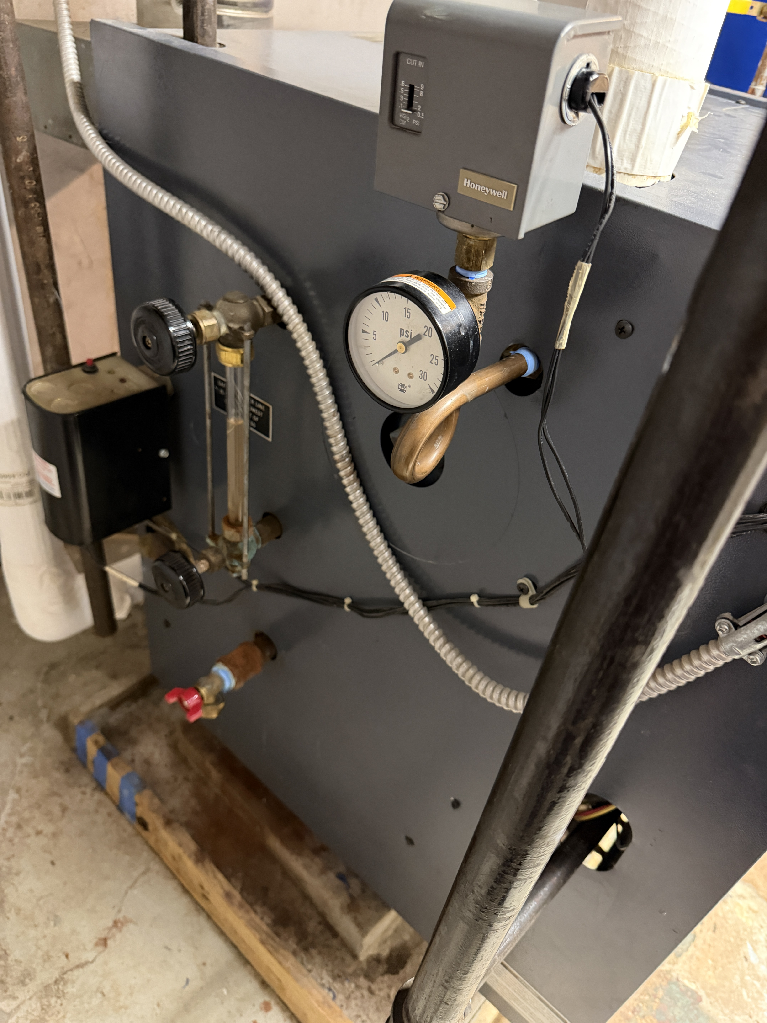

    post a picture of your pressuretrol
  • neilc
    neilc Member Posts: 3,183

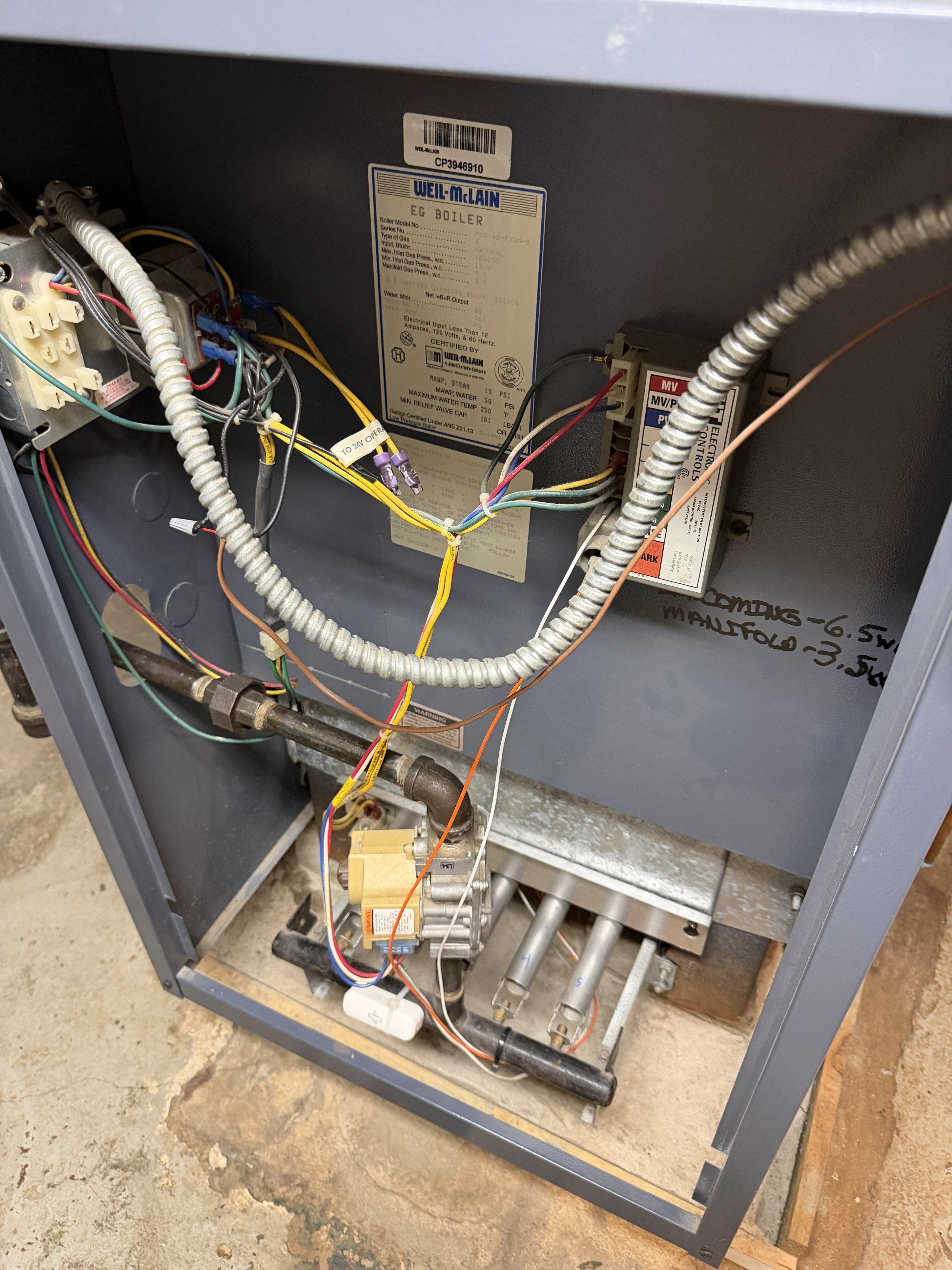

    is the pigtail serviced?

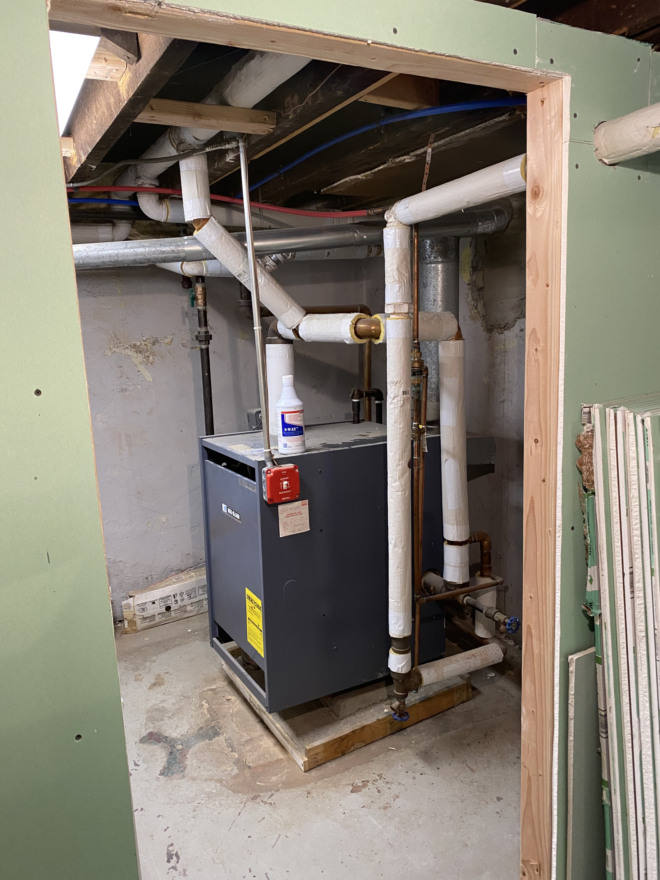

    can we see one picture of the controls side of the boiler, all in one
    known to beat dead horses
  • n1976jmk
    n1976jmk Member Posts: 22
    yes, it was checked and cleaned in Sept and November actually. Here is the control side (I believe this is what you are asking for).
  • neilc

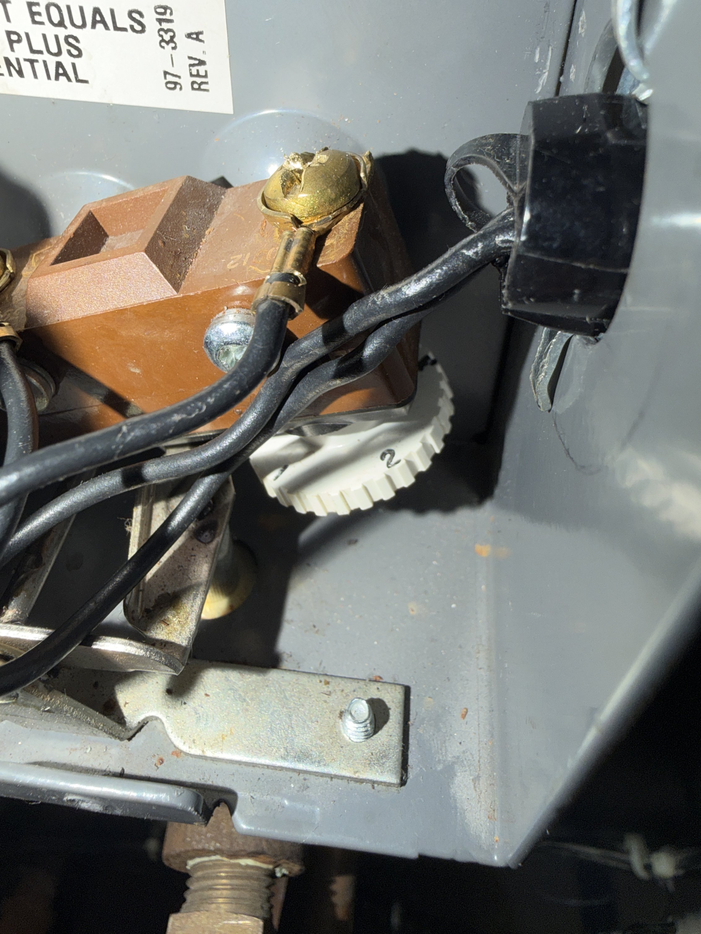

    no, we wanna see the Ptrol, siteglass, gage while running, LWCO, all in one,
    what pressure do you see when you're making steam?
  • n1976jmk
    Sorry, here is that picture, I need to look, I have no paid attention to see what pressure shows when boiler makes steam. The next time it runs, I will check and advise. thanks!
    Here's the right pic.

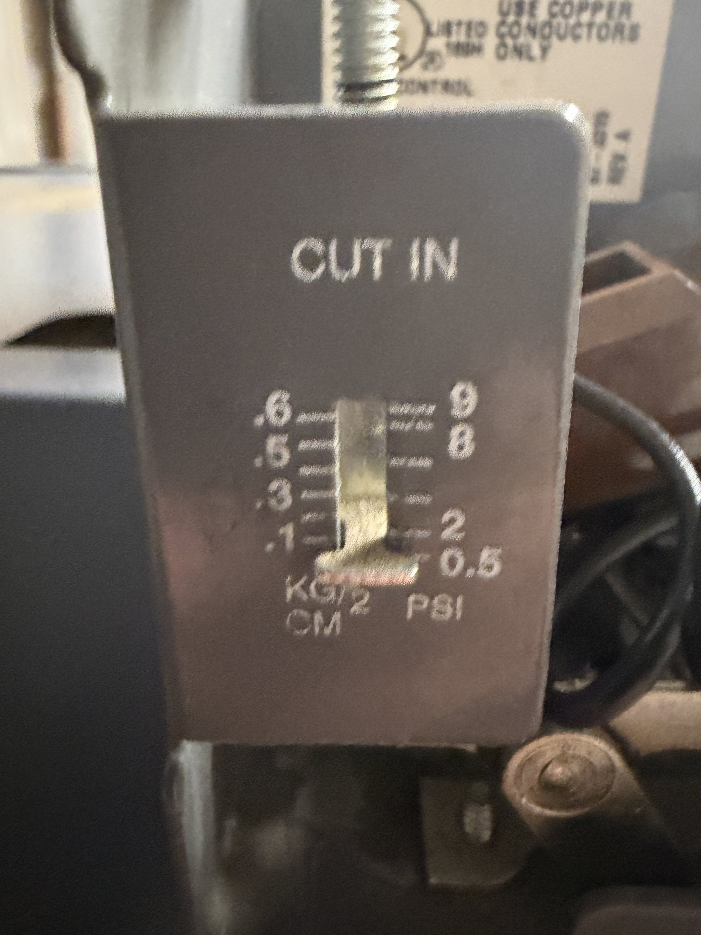

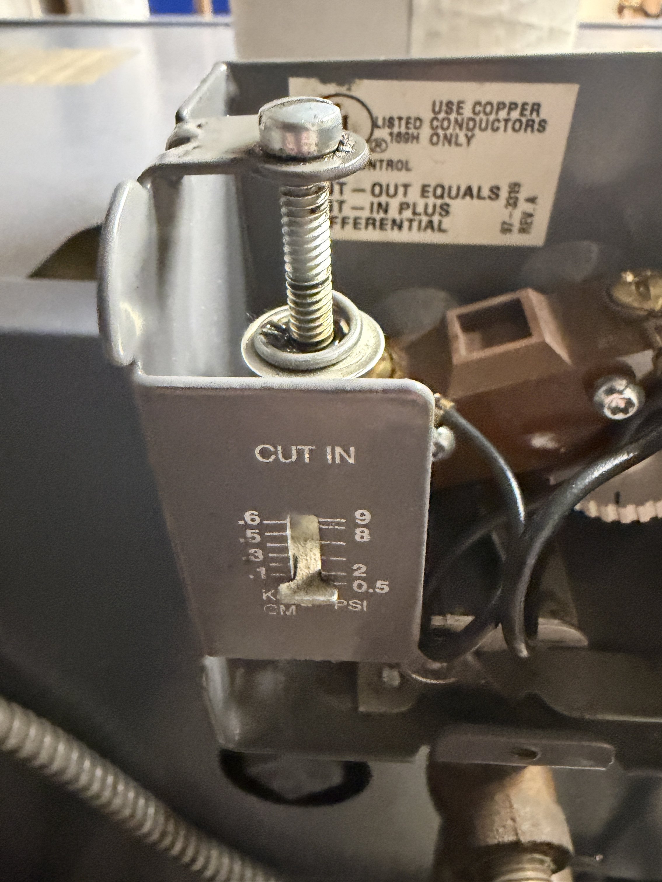

  • bburd
    bburd Member Posts: 1,303
    It looks like the differential on that pressure trol (the white wheel inside) is set too high. "1" should face the front.
    Bburd
  • n1976jmk
    What does the 2 mean versus the 1?, only curious.
    just fyi, it was the way the last boiler tech set it that way in September when he was here.

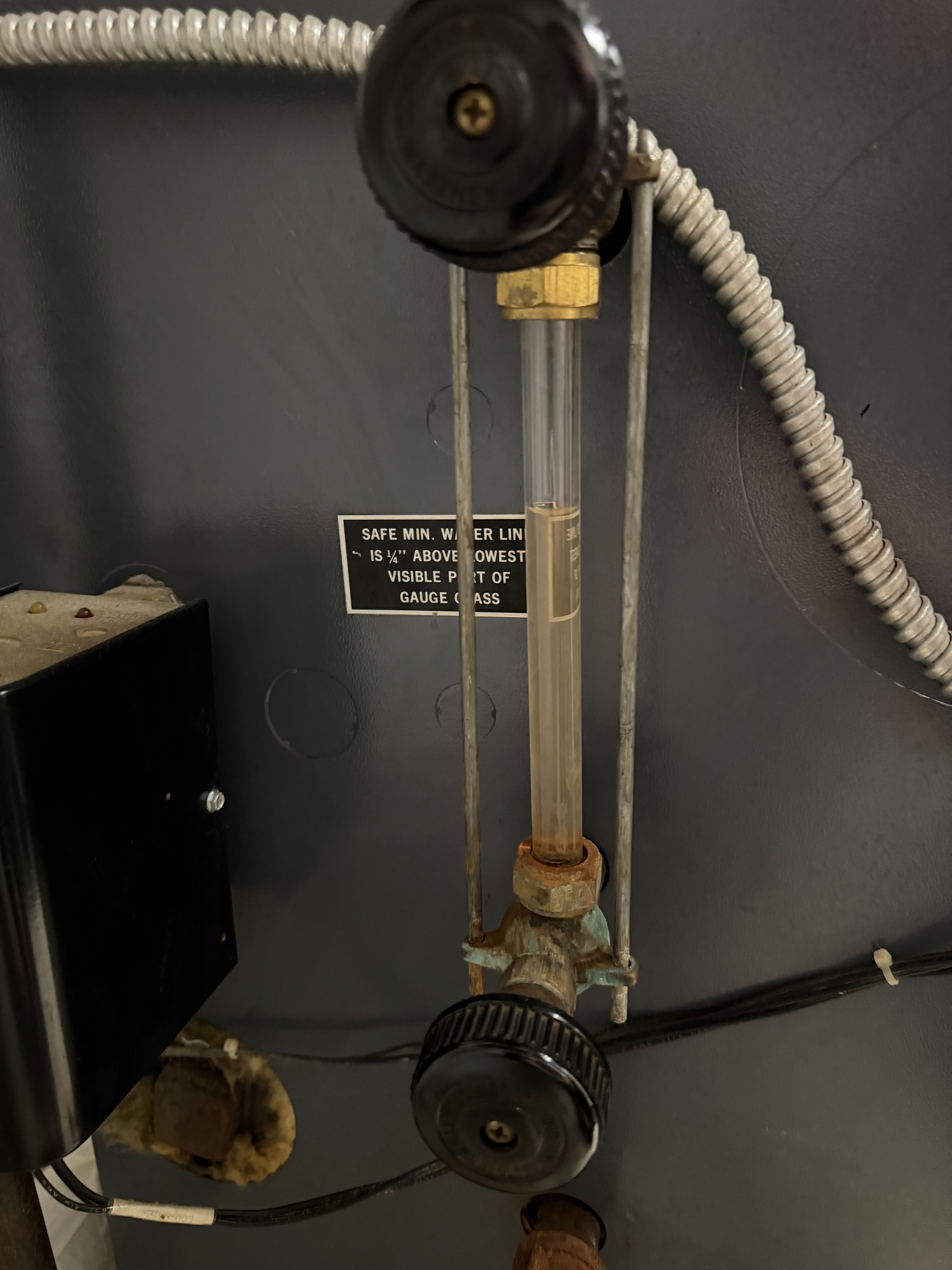

  • neilc

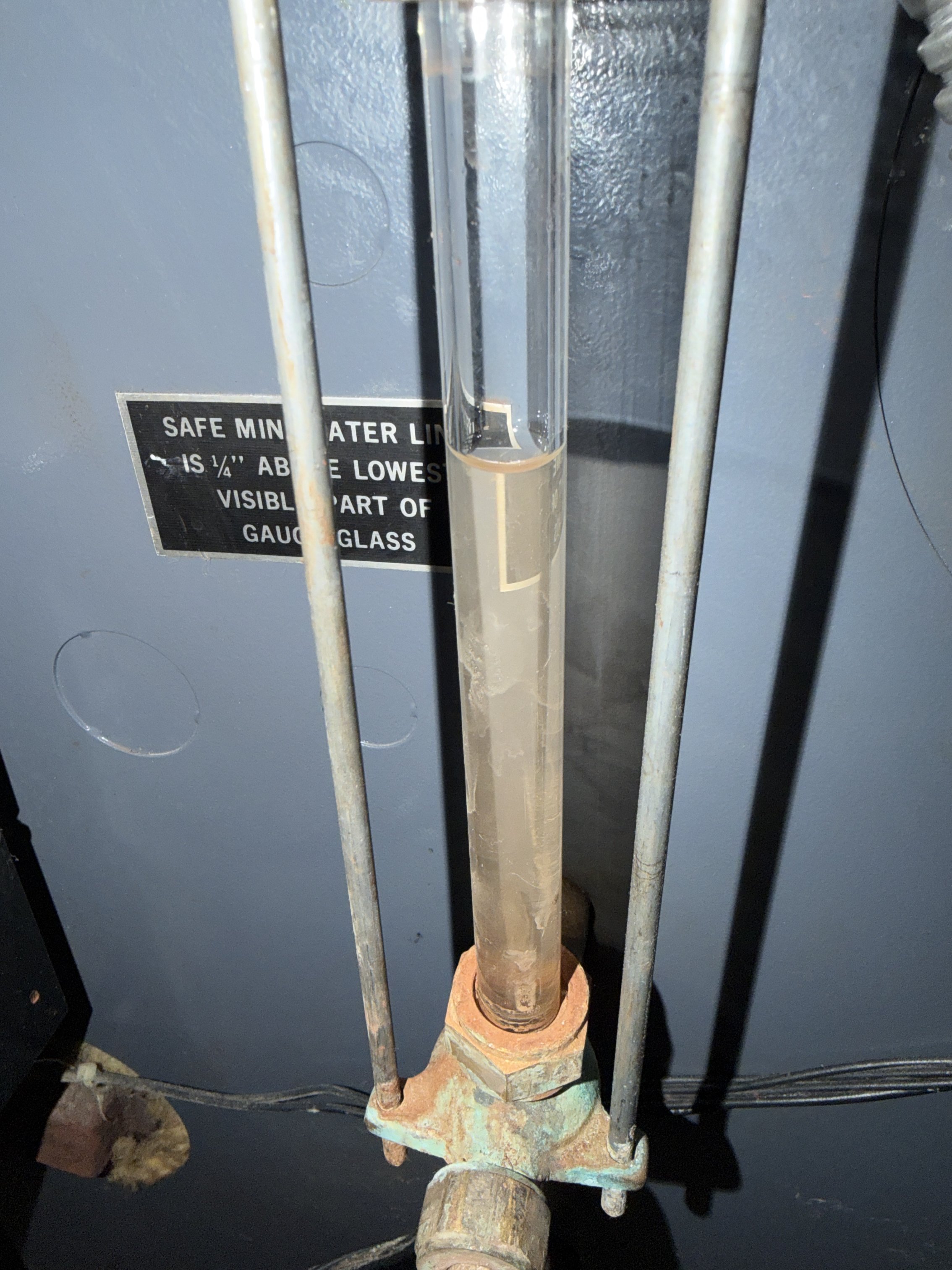

    I was gonna ask for a closeup on the siteglass, but I see that above, and the 8way also, @ethicalpaul may correct me, but that isn't your best treatment, and may be adding to your wet steam, consider draining the treated water, and refilling with fresh water only,
    hard to tell but still looks like you have an oily top of glass, and I don't see that your skim port has been unplugged, nippled, and skimmed, how about a head on close up of that siteglass,
  • bburd
    The umbrrs measure the differential between burner cut out and burner cut in in pounds per square inch of steam pressure. For that type of control on an ordinary low pressure steam heating system, the differential should generally be set to 1 and the main scale on the outside set to achieve a maximum cut out pressure of 1.5 psi.

    n1976jmk
  • n1976jmk
    Sorry, that is an old overall picture of boiler, I have not put any treatment in there for 4-5 years. Only fresh water. Here is 2 close up photos of site glass. No oily top that I can see.
    and I did drain some of the water out of the boiler last weekend until the LWCO kicked on, then filled with fresh water.
    thanks!

  • n1976jmk
    thanks i can change it and turn it down to 1. Just curious only, what’s the difference to the boiler and the steam going to the radiators to heat them up? I’m still totally learning and want to understand, it very much interests me.

  • n1976jmk
    Hi, I did order the book because I definitely want to continue to learn more. But in the meantime, would you please be so kind to explain what are benefits/ differences of changing that wheel from 2 down to 1? Thank you very much for all your time and wisdom so far! -Jonathan

    The pressuretrol setting with 0.5psi curing and differential wheel set to 1psi theoretically will tell the boiler to turn off if pressure reaches 1.5psi and turn back on after it falls to 0.5psi. If the wheel were at 2psi with the same setting on the slider scale those numbers would be 2.5 and 2.0 respectively. This normally only comes in play if you run a long enough cycle to 100% fill the radiators and it is nice if you are controlling so you don't have to do that much. As pressure rises you are using energy just compressing steam which can be called inefficient. Should be able to run the boiler most of the time less than 0.5psi. If you want to see what your real pressures are add a 0-3psi or 0-5 and make sure your pigtail is clean.
