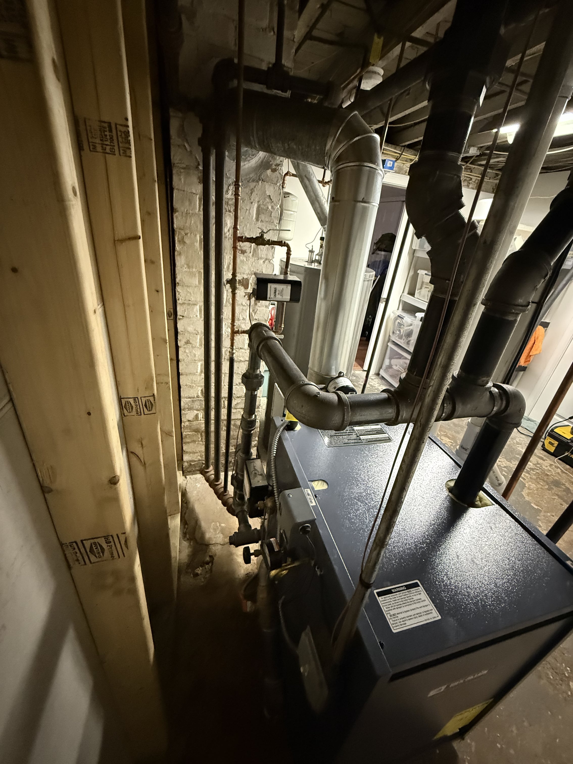

Hi Dan,

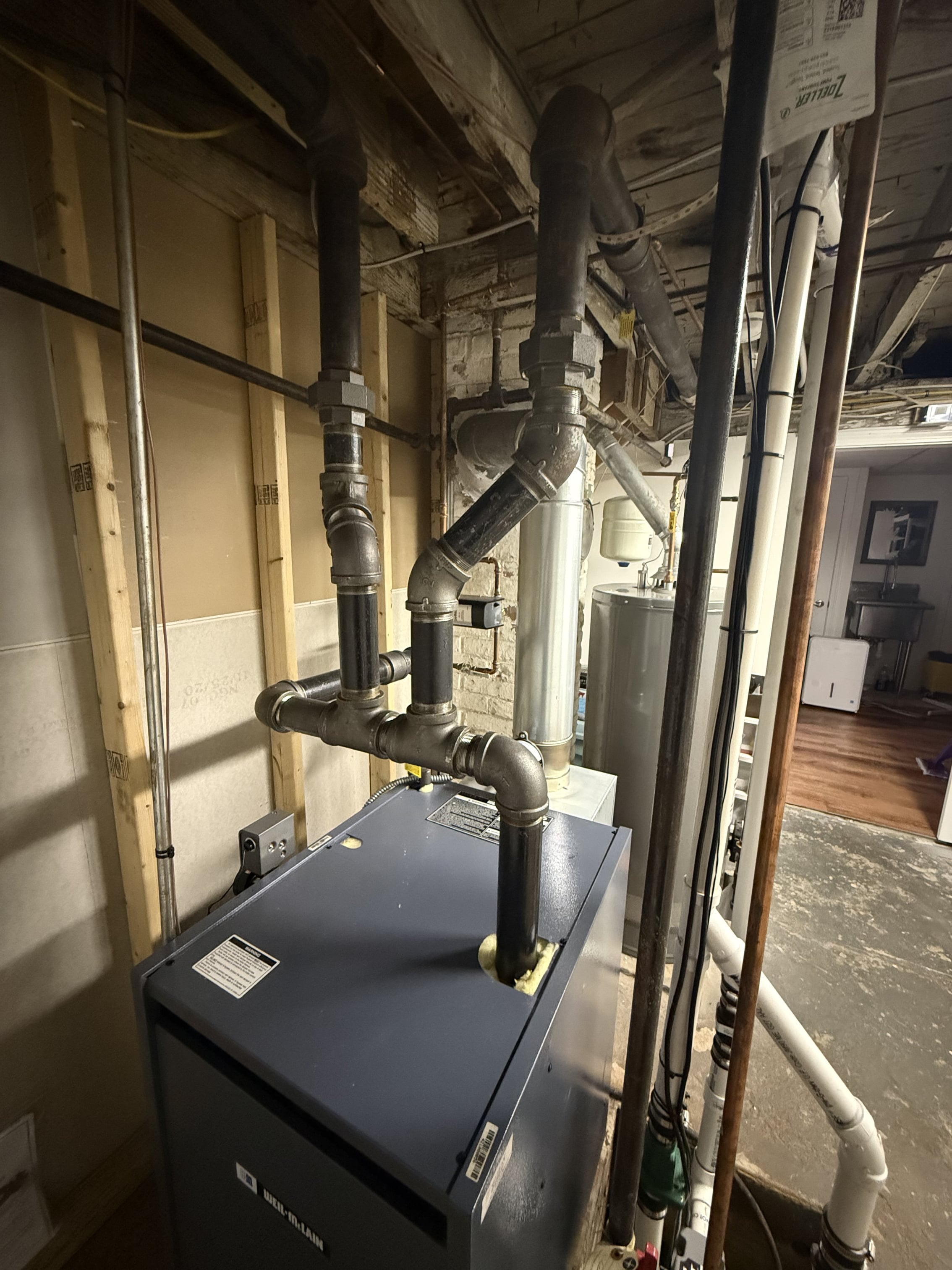

I saw your YouTube video on near boiler piping and wanted to know what you think of my current setup for my new boiler installed 3 months ago to replace a very old one. Both units Weil McLain.
    mattmia2 Member Posts: 17,902

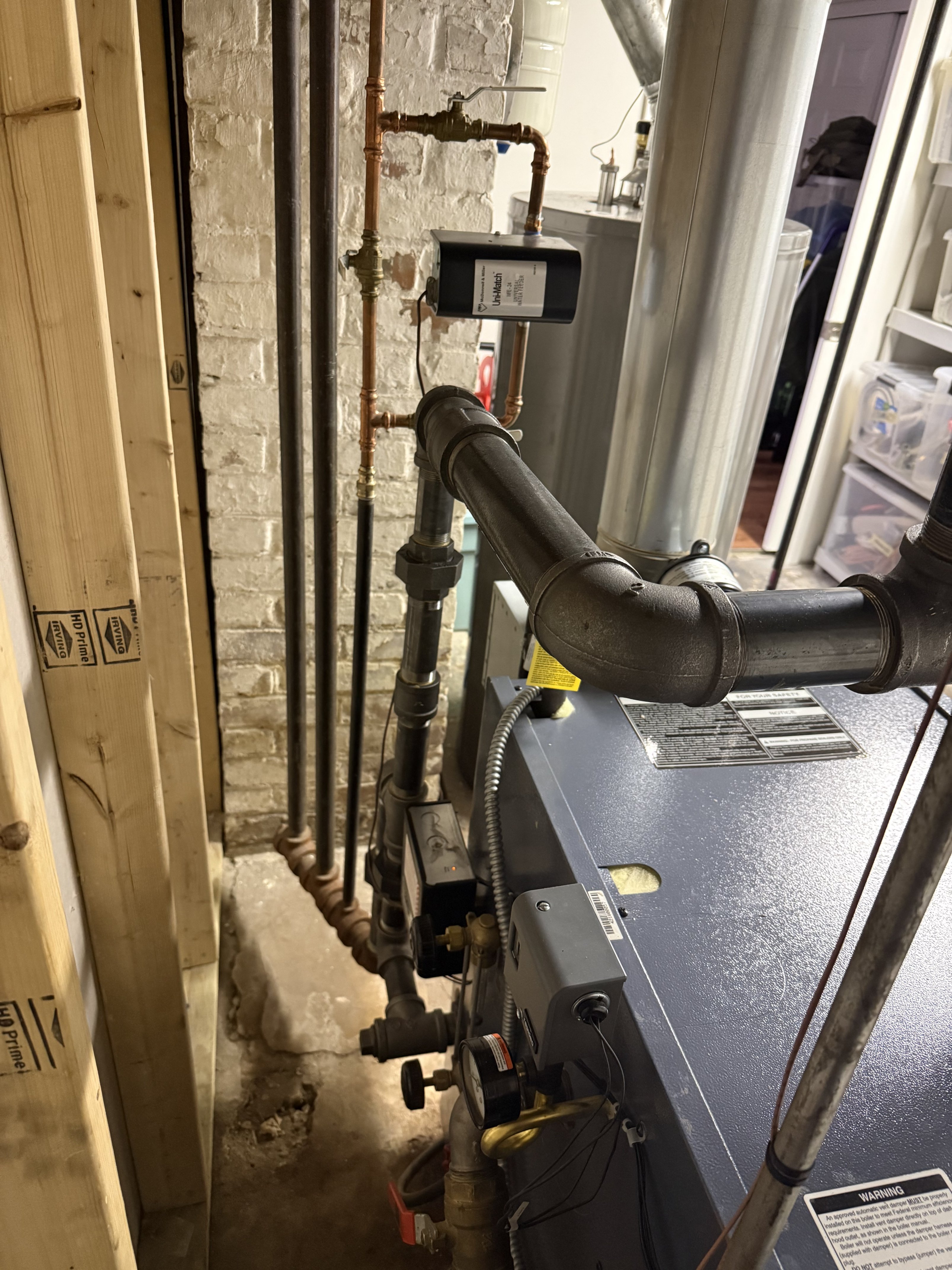

    Check the diagram in the manual for the pipe sizes. The header may be too small. The part we can see looks good if the mains are parallel flow(have separate returns from the far end of the mains) but we need to see the part wedged between the wall and the boiler. It will be a pain to service, they should have slid it out some or turned it 90 degrees or both but unless that was specified it would be hard to argue that it is a problem.

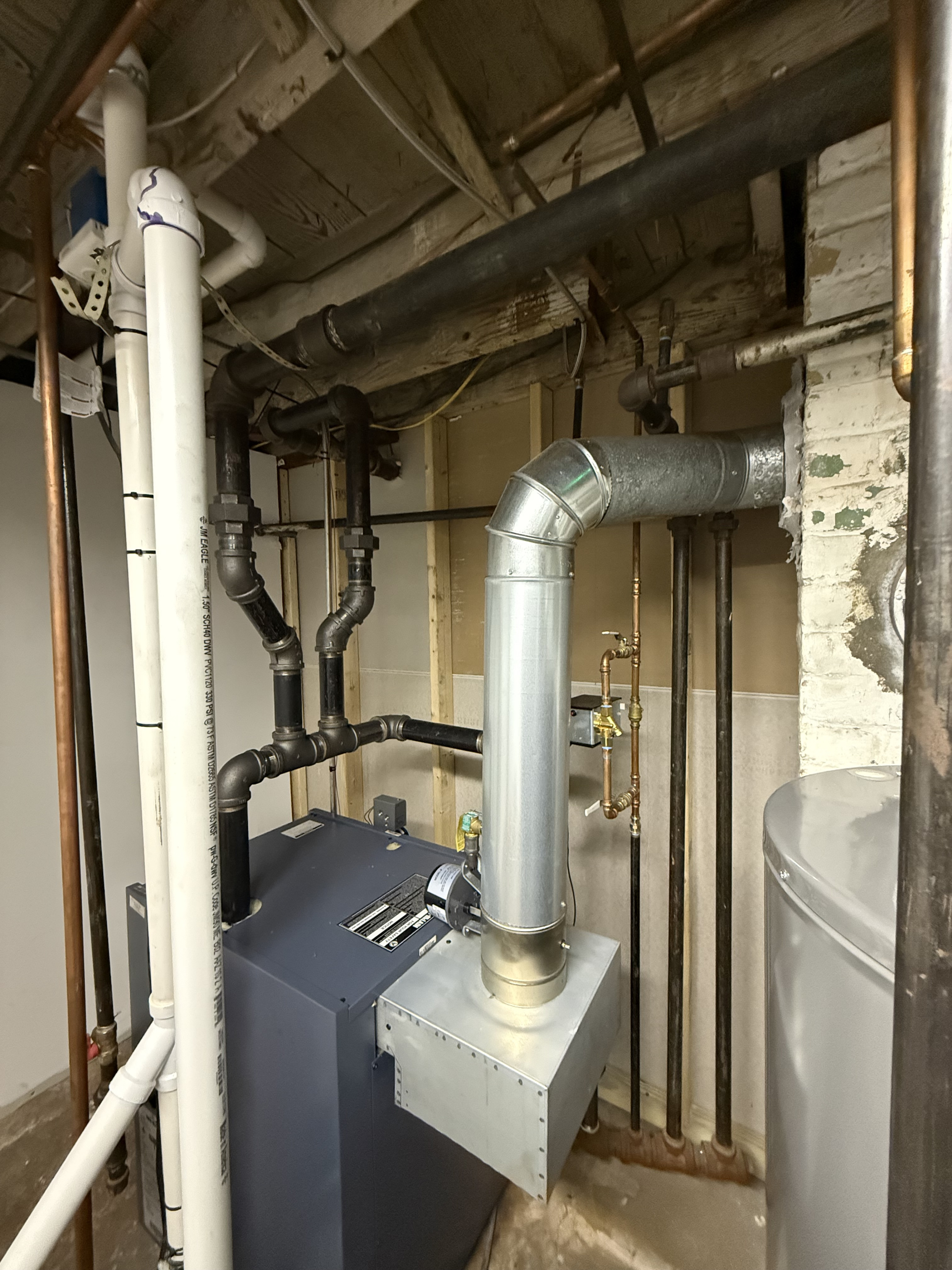

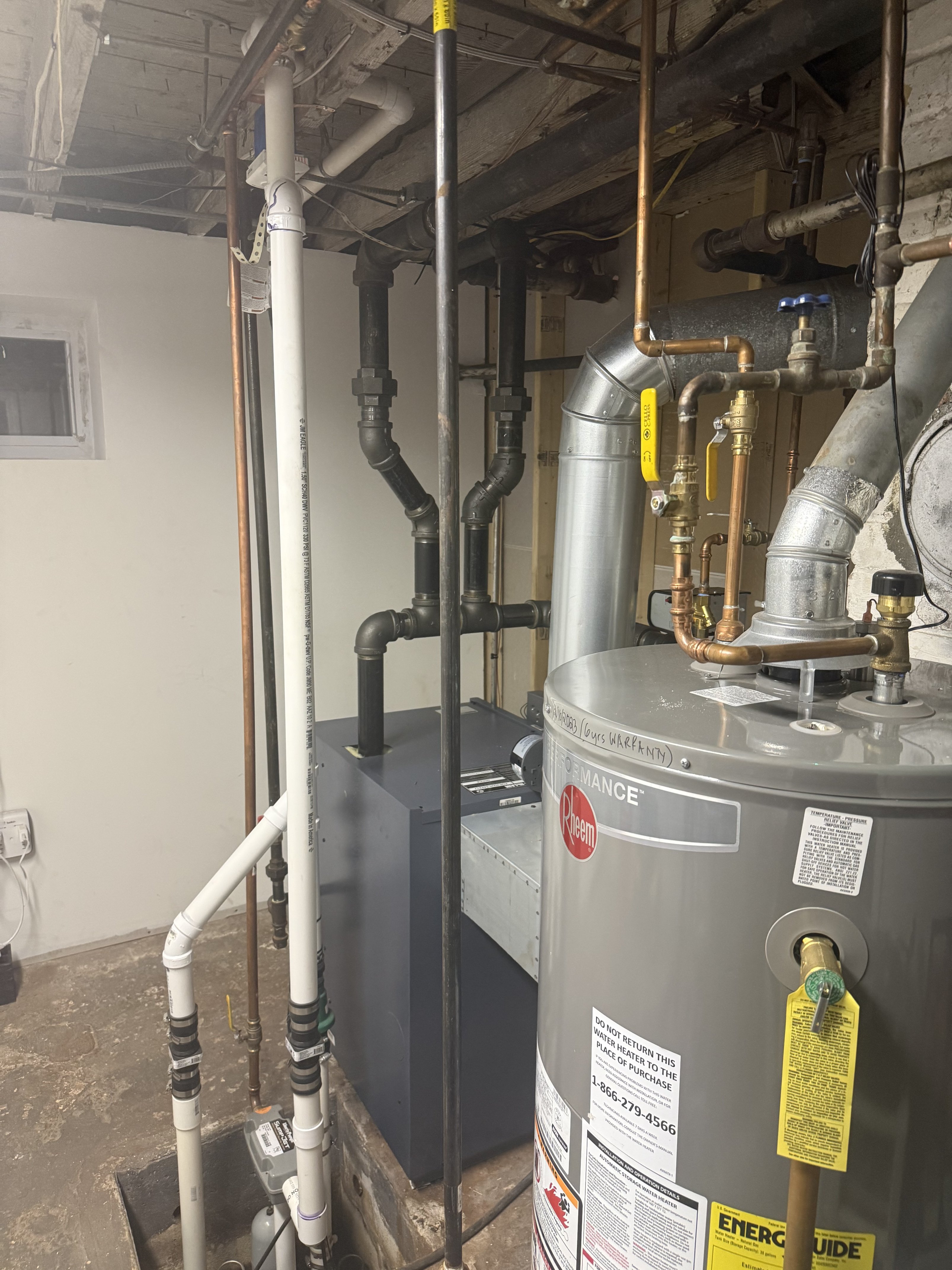

    The manual says the EG 40 ( model I have ) needs a 2.5” riser and header pipe. Here are pics of what’s between the wall and the boiler
    ok so it is parallel flow and the dry returns connect below the water line like they are supposed to. it looks good.

    make sure the pipe is 2.5". i think it is but i'm not good at judging pipe sizes in pictures.
    Measure the diameter of the pipe, the risers. I am guessing they are 2" which will be undersized. The outside diameter of 2" pipe is 2 3/8"
    2 1/2" pipe is 2 7/8" OD.
    measure the OD not the circumference
    mattmia2Mad Dog_2
    i think i see a "2" cast in to one of the 45's

    It definitely has a “2” cast on the ell.

    To bad he faced the service side towards the wall ,possibly should have spun it 90 degrees hopefully the next service tech is not large . I usually try to make the sight glass and lwco on a side that has access but ya cant always get what you want or need .Piping looks fine as for the size its about what 99 % do cause no one is really checking usually and steam is quite forgiving and most of the time it no noticeable difference not everyone wants eye candy they just want it to work . i would gather that larger risers and header would have increased the price somewhat and when your bidding against others you bid what they do unless ya dont mind loosing most of the jobs ya look cause your more money and usually higher priced bids end in the waste paper basket .Its always easier to let the home owner make the decision over using a doom and gloom pressure to get the job that's never been my angle .

    the circumference of the riser and header pipes is approximately 7.75” . So dividing that by 3.1416, the diameter comes out to 2.42 inches.
  • dfavoriten
    dfavoriten Member Posts: 19
    so what is the negative impact of having a 2 inch pipe instead of the required 2.5 inch pipe ?
    neilc
    The boiler generates a given amount of steam. If the pipes are too small the velocity of the steam (think miles/hour) is moving faster than it should be. This can cause the steam to pull water out of the boiler and create an unstable water line.
    Check the boiler manual and show it to the installer. The manufacturer of the boiler tests the boiler and specifies what size pipe to use. For good operation the mGS instructions need to be followed.
    Would you want to drive a 1 ton pick up truck with Volkswagen tires on it?

    Most contractors don’t have the equipment to thread anything above 2”, so that’s the maximum size you get.

    With that boiler if they ran two 2" risers fairly high, I'd bet a 2" header would perform fine.

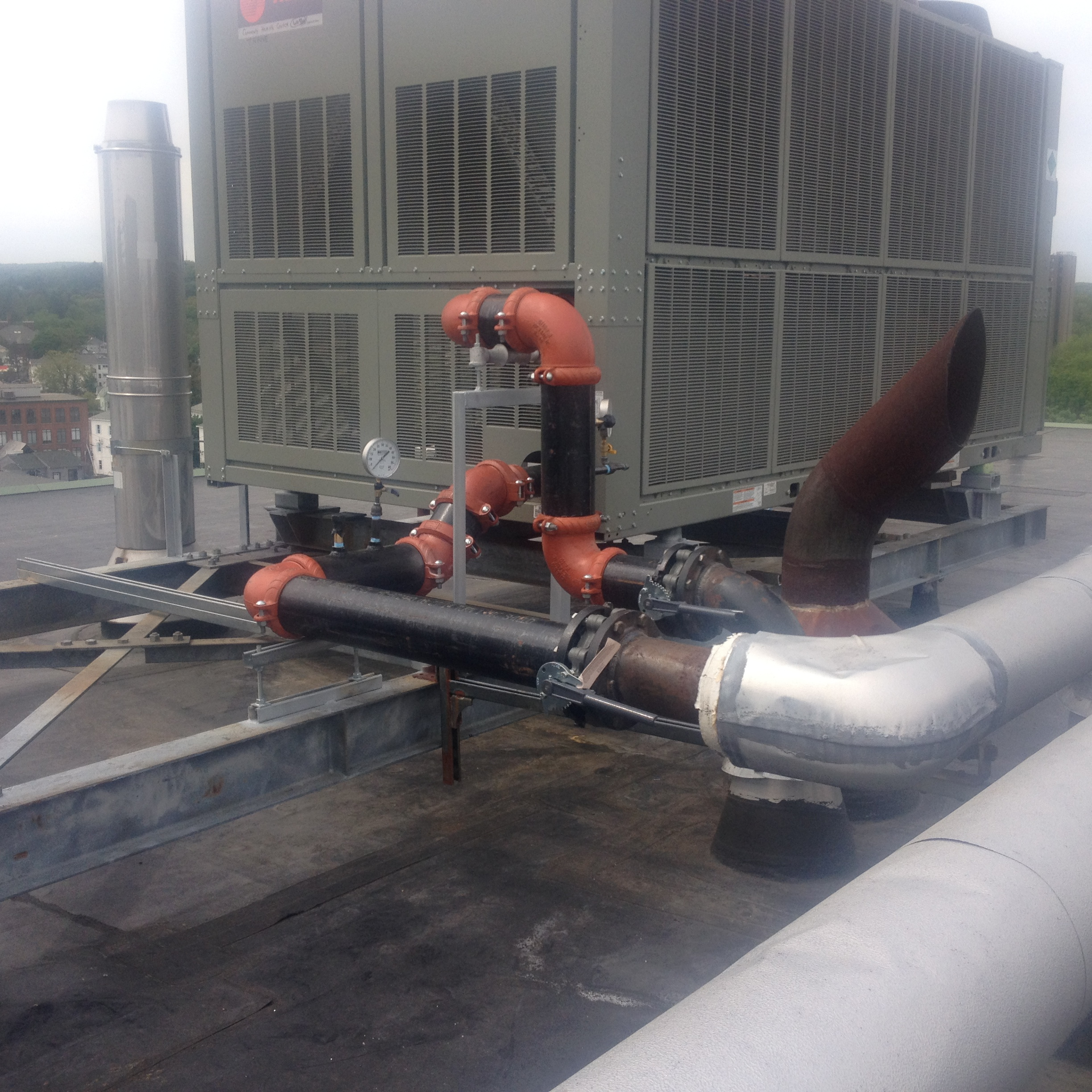

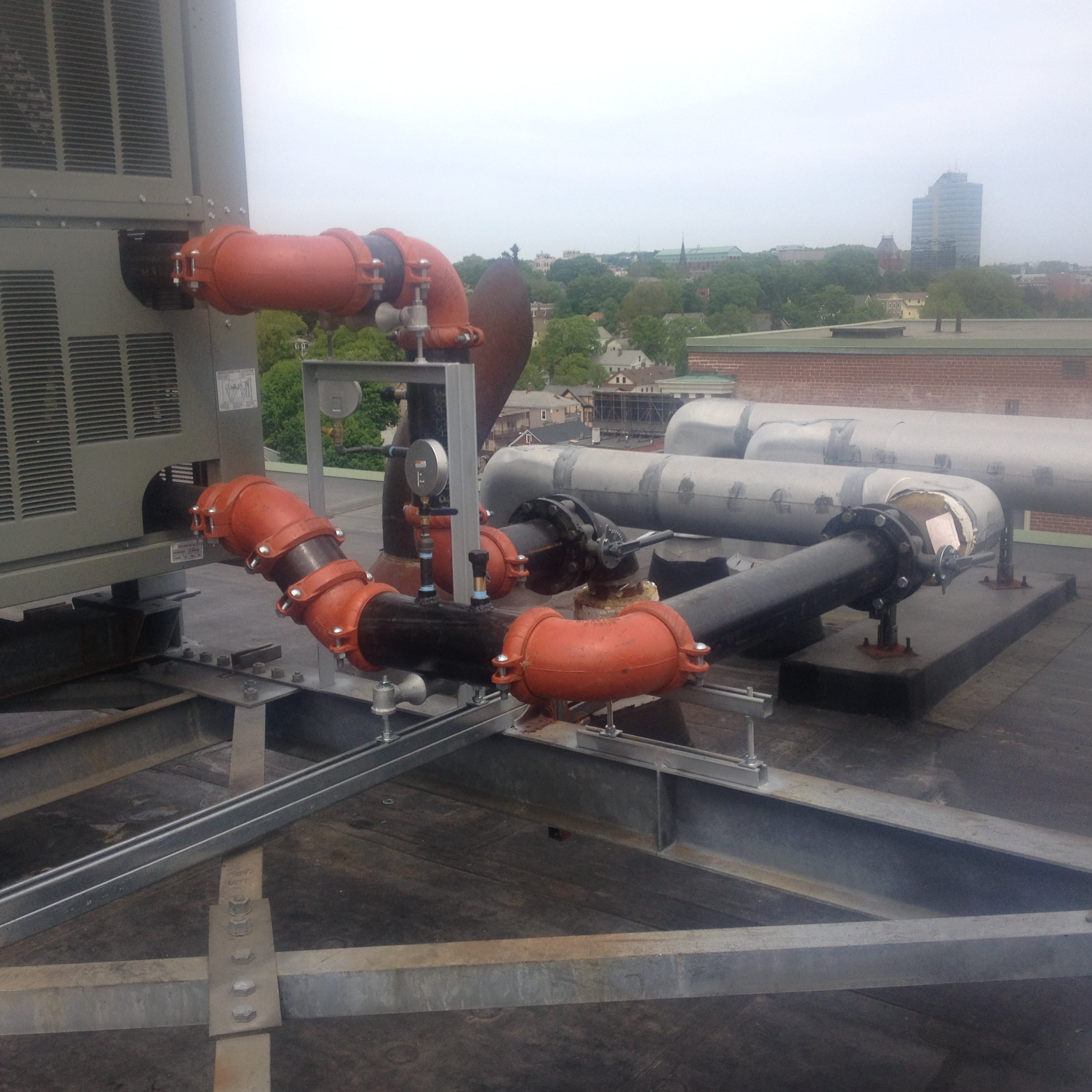

    Here is a chiller I did about 10 years ago. I was about 62 at that time. We cut back the supply and return 6" pipe and welded on 2 flanges. Ran 6" vic into the chiller.
    Picture going to a job 1 1/2 hours from the shop lugging a groover and something to cut 6" pipe with all the pipe and fittings. You not lugging those tools to the roof so you would be up and down the ships ladder all day. No fun. Even with two guys it would suck.
    So I spent 2 hours measuring it up and ordering the fittings. Turned my sketch in to the shop and had the pipe cut and grooved there. there.
    Loaded it into my truck and went back myself. Pulled it all up to the roof with a rope myself and piped it. That's why I am a mess now.
    I had the welder build the angle Iron support the same day we put the flanges on.
    Its all about knowing how to measure.

    the manual says the minimum recommended riser and header pipe diameters is 2.5 inches. Would it be better if we went to 3 inches instead ?
    If you want to spend the $$$ go for it.
    I have yet to hear of a boiler piped to the MFG minimum that doesn't work right. And I keep asking.

    the boiler tapings are probably 2.5" so it would be complicated to do it to the risers. if i were to upsize anything i'd only do it for the header itself
    No, it would not be better.

    If the header is 2.5” , does the supply main pipe also need to be the same diameter ?
    What does the manual say? We could go look up the manual for your model and find out for you, but you should try it, it's a good learning exercise.

    I can’t find any mention of any recommended supply main pipe size in my EG 40 Series 6 manual.
    I only see recommended riser, header, and equalizer pipe sizes.

    Oh Sorry I misread what you were asking. Yeah, the boiler manual won't say what your main should be, it's not their responsibility, and you might have multiple mains. Usually the main was designed back when the house was built or when steam was added to it and is probably fine. The piping problems we see here are usually the near-boiler piping that was re-done by some rando installer when the previous boiler failed.
    I'm sure Dan's book The Lost Art of Steam Heating tells what size main is appropriate for a given amount of radiation that it supports.
    mains are sized when the system itself is designed. your risers from the header to the main generally can be the same size as the main it connects to, just make sure you arrange any size reductions such that they can't trap condensate.
    the larger header size is to slow the steam down in the header and make it easier for any water entrained in the steam to drop out. after the header it doesn't need to be slower.
