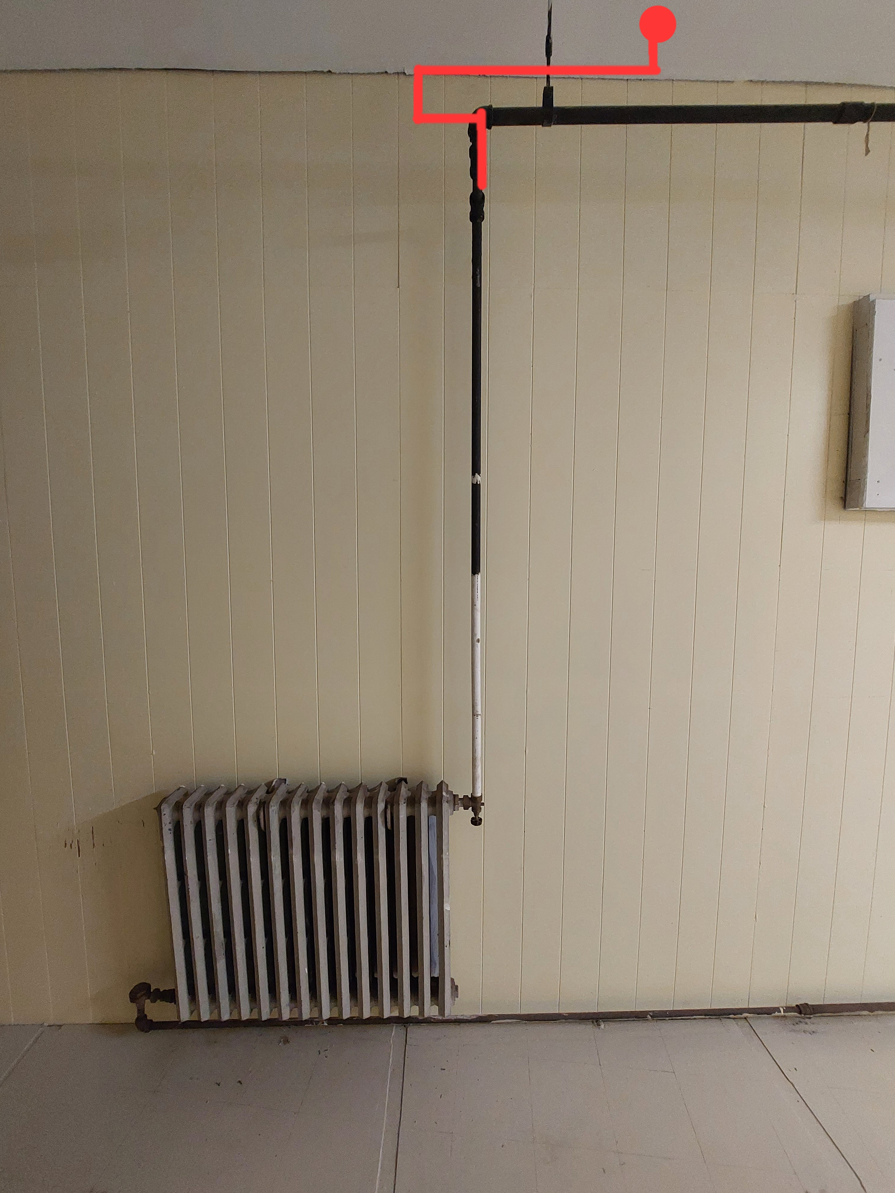

Hello folks, I've got a bunch of mains that need venting and I'll be using B&J big mouths. I understand that it's recommended they be installed 12" before the end of main to protect them from water hammer. Several locations look basically like the photo below I'm wondering if I'd be ok doing it this way:
This I can do myself without paying someone to cut and thread in a Tee in the existing pipe. With the number of lines I have, this is significant savings. I should add that I don't have any water hammer, the boiler is operating at 1.5psi and the pipe will all be insulated.

    That works,,, provided all the "horiozntal" segments can slope to drain back into the main.

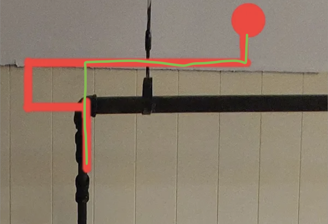

    I'd run it like this. You will get the appropriate pitch for free if you do it this way, and it's plenty to protect you from the commonly overstated risk (in my view) of "damage from water"
    Also note that Big Mouth vents provide a LOT of venting and may be overkill. They require quite a bit of steam to get heated enough to close compared to Gorton, for example, due to their rather massive…mass.

    Thanks Jamie, I appreciate the sanity check. I'll be sure to keep things pitched for drainage.
  • Gateacre
    Gateacre Posts: 118
    This is the end of a 270ft main that starts as 2.5". I like your layout, it's. even easier, thanks

    @Gateacre I would pipe the vent as @ethicalpaul said but I like raising the vents up in the air as high as possible.
    I would bust the elbow off and put a tee in its place. Come off the tee pointing up as Paul showed the pipe will be crooked due to the pitch of the main pitching down. Put a short nipple on the tee then a 45—-nipple——45 then a long riser pipe—-big mouth vent.
    Raising the vent gives it more distance from the water hammer….maybe

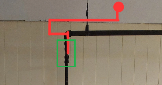

    Inside the Green box are those 45s or 90s ? If 90s the vent could be Teed into the one closer to the wall. Which is maybe what you meant with the Red path but the camera angle does not show it well.
    If that radiator return pipe is always flooded I'd put the new vent on the return side of the radiator, as long as that existing trap is not actually flooded. That way the radiator actually gets vented. Or just have two vents one for the main and one for the radiator.

    That's 1" on the horizontal with a 3/4" bushing in the outlet of the downward 90. The 3/4" drops about a foot before a short dog leg back toward the wall then down to the valve. I'd like to vent off the 1" in case I need to add more vents than 3/4" can handle, the main is ~270ft long.
    The wide lens and bowed floor make the return look super flat but it does have pitch. It could stand to have more but it does drain.

    Ed, unfortunately I don't have the height for that. The white you see is the ceiling. I'm going to swap the 90 for a Tee, come up with a 4" nipple then 90 back towards the boiler for 18". Finally I'll 90 up to a Tee for 2 big mouths since this is such a long main. I've never experienced any hammer on this line.
    109A_5 Posts: 4,759
    OK, I see your point venting the main via the 1" part. I just thought the smaller pipe may be easier to work with.
