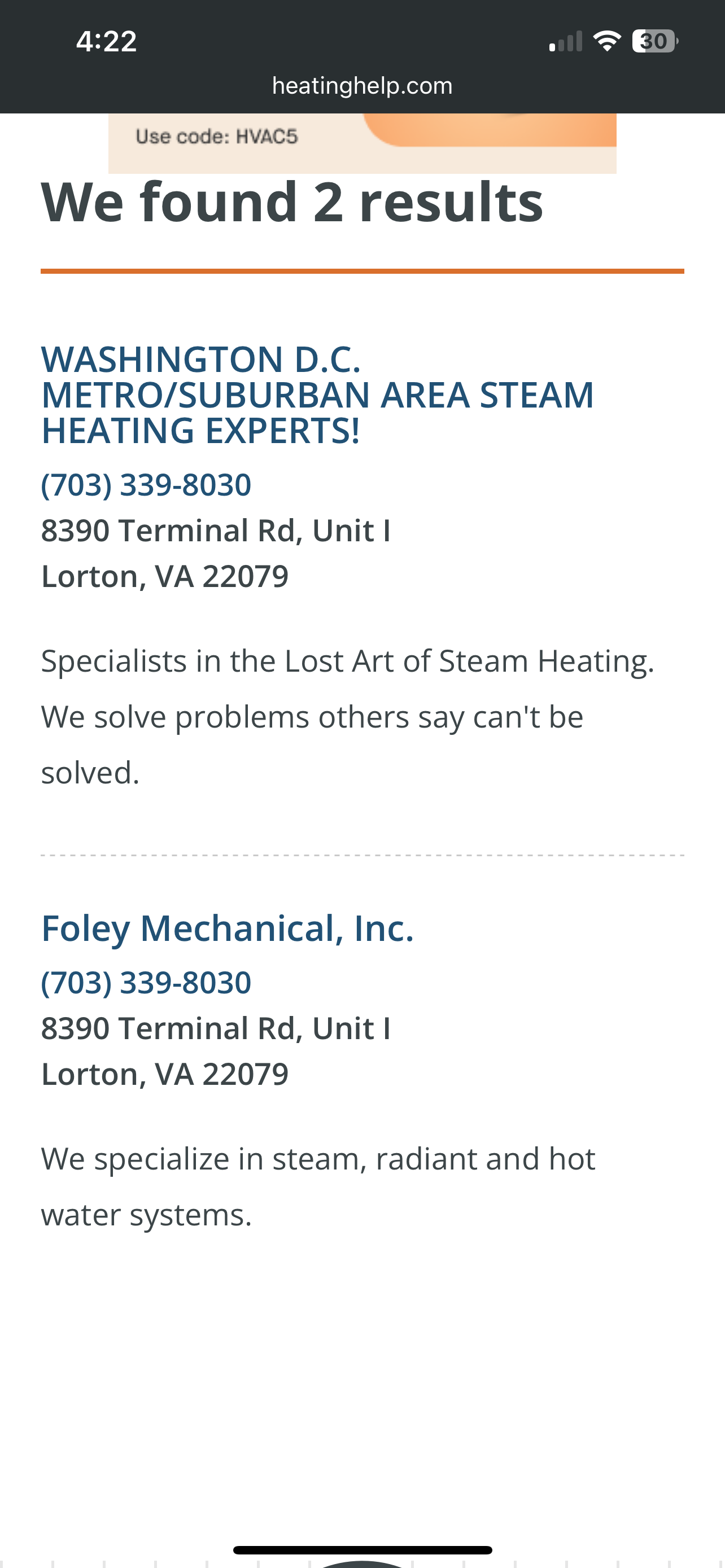

    pecmsg Member Posts: 7,442
  • HM389
    HM389 Member Posts: 15
    Unfortunately I have looked them up, they are 4-1/2 hours away. I don’t think they would be willing to travel that far. I’m in Bassett VA
    mattmia2 Member Posts: 17,906
    @Dan Foley definitely knows his stuff.
    It will not hurt to call them.
    If it is too far for them to travel, they may know someone in your area.
    You could also check with any local plumbing and heating supply houses they may know of someone that does steam.

    It would behoove you to reach out to the great, Dan Foley of Foley Mechanical. Hopefully, he can consult with you on it, give you a drawing and a plan of action that a good, local licensed plumber or heating guy can follow. I do this for distant clients on a regular basis with no issues. Zoom works too. Good Luck and keep us posted. Mad Dog

  • HM389
    Good morning! Some very good ideas have been mentioned! I will reach out to Dan and let you know. Thanks everyone for such great ideas!
