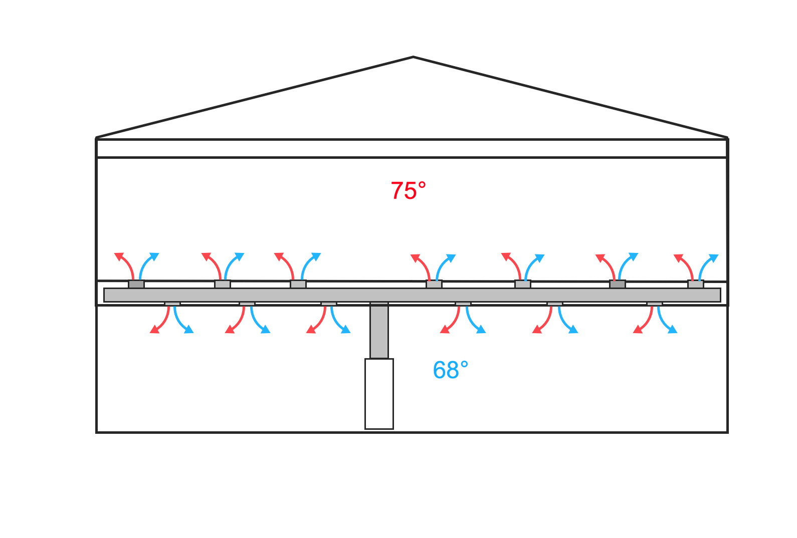

    Easier said than done. Some economy minded track home developers choose HVAC contractors based on cost, regardless of how well the system works or the comfort of the home.
    Here is a low cost heating and cooling duct design that causes large difference in upper floor and lower floor temperatures.
    The homeowner is supposed to open and close registers as each season changes leading to noisy operation when air blows thru all the closed registers. Many homeowners don't know to do that, and sometimes the air flow with several registers closed cause coil freezing or HX overheating as a result of the reduced air flow.
    EdTheHeaterMan Member Posts: 12,224
    Depending on where you are in the home. If you want the temperature upstairs to be 68° in the winter and there is no one downstairs to complain, then the thermostat set to 60° at night will make the second floor 68°. In the morning when everyone goes downstairs you can set the thermostat to 68° and if no one is upstairs to complain, then you can have an automatic thermostat to make you comfortable. Now if you forget to change the thermostat before you go upstairs to bed, and you have your phone with you, a smart thermostat can be adjusted without taking a trip downstairs.
    I can see it in my minds eye. Smart thermostat will fix this person's problem without ripping out the sheetrock and re-ducting the entire home. This homeowner did not know they were purchasing a duct system problem, when they looked at the home, they discovered it at the change of seasons the first year they were already living there. This will not reduce the fuel usage but will make the living conditions more comfortable.
    It is all in the way you look at it. Maybe some day the homeowner can purchase a second floor duct system and put it in the hot attic in order to air condition the second floor, and the first floor thermostat set at 75° might operate the first floor air conditioner about 3 hours for the entire summer. Perhaps swapping the old furnace and air conditioner with a smaller one that will accommodate the first floor only and blocking off all the second floor registers will solve the problem better, but that costs more that a thermostat.
