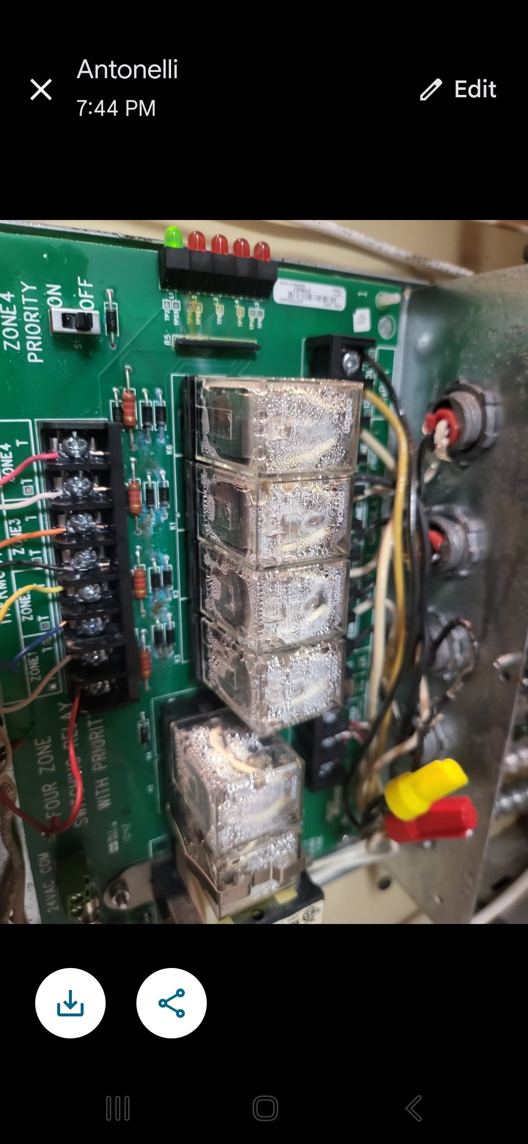

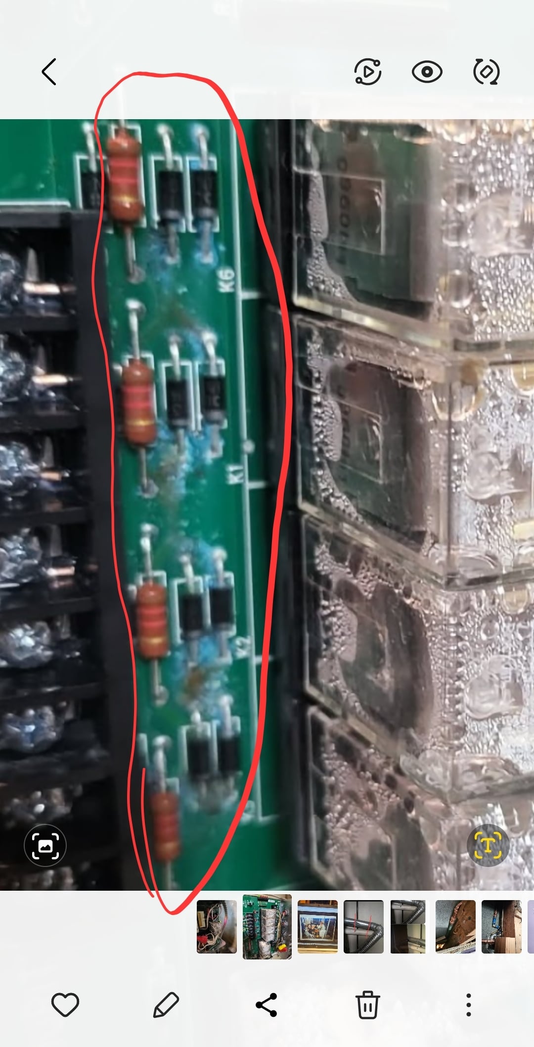

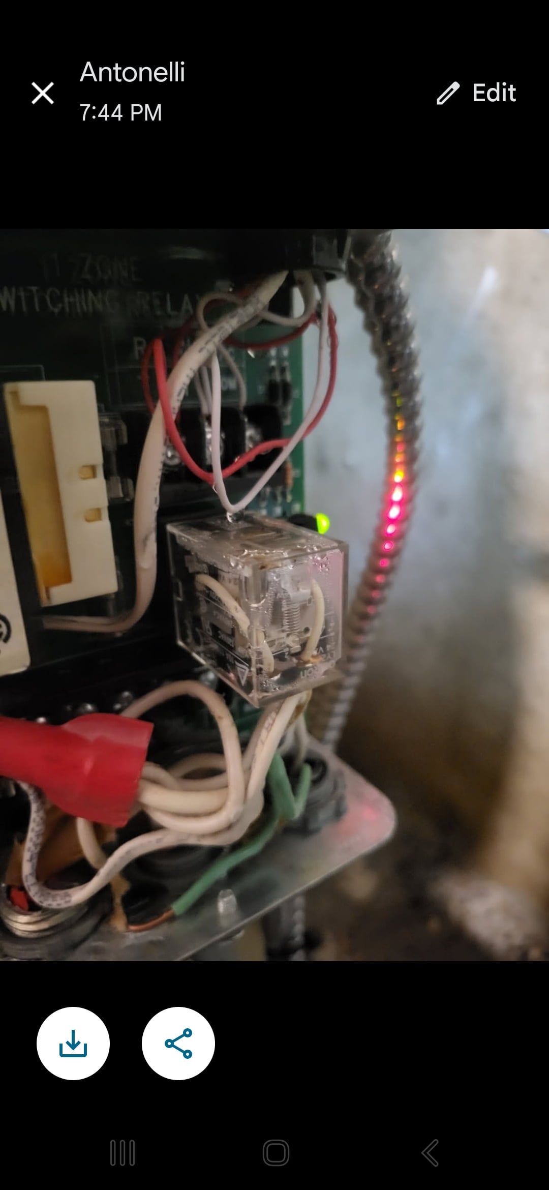

I have a customer who had water sprayed on his boiler. Two of his taco control boards had water condensation inside the "ice cube relays" as can be seen from the pictures taken about a month ago. he let it dry a month and asked me to inspect. There is no more condensation and completely dry.. I tried all the zones and all respond properly. one of the boards shows some physical water damage to the board, but all functions properly.
Would you make him replace it or see if eventually starts to malfunction. do you think its a fire hazard.
(ps. There is another board that fried from the water which im replacing because its clearly not functioning properly)
Thanks
Joe

    Since the best practice to 'Save' the water contaminated / damaged equipment was not implemented at the time when the damage happened, I would recommend that it should be replaced.
    Simply just letting it dry out is (was) not a good plan.
    The present problem is where is the corrosion hiding and what issues will it cause in the future ?
    It certainly could be cleaned up and the relays replaced (if needed), but it is probably not worth the cost (Vs. replacement) to have it professionally repaired. If the homeowner wants to assume the liability, get it in writing.

    Usually, what I would do is wait and see. It's hard to gauge what is wrong until something shows that it is wrong/performing or not.
    Your pictures show a lot of water in and on the controls. You will have to decide what the best action to take is on a case-by-case basis.

    I would try the same recommendation people give when a phone falls in the water. Do not power it on, bury it in rice for a day or 2. If there are covers, batteries, fuses anything reasonably meant to be removed from the device detach it and put it separately in the rice.
    hot_rod Posts: 28,705
    ask the relay manufacturer what they recommend.
    Prices are going up, replace them now.
    Did water run in the flex also? Into the wire nuts? Fresh water? Boiler water? Sea water?
    Mad Dog_2
    Those relays will fail — the question is, when? If the equipment is properly fused and safetied, I doubt that there is a fire hazard, but check and make sure that the controlled equipment is properly safetied, as one of the failure modes is to lock something on which shouldn't be.
    Me, I'd replace the stuff.
    The rice trick is one what to handle electronics which have gotten wet. Another is freeze drying. Niether will help much if the water was salty or otherwise grundgy, not if the exposure was more than just a dunking.

    Water damage to electrical controls can lead to corrosion, short circuits, and electrical failures, posing safety hazards and reducing functionality. Water is a conductor of electricity, and its presence in electronic devices can create unintended electrical connections and damage components, especially if the device is powered on during contact.
    As others have suggested, I would replace any components with said water damage.

    as mentioned above, i'd be more concerned with water that got in the 120v wiring than the board. the board itself is unlikely to be a hazard, the relays are likely to have problems. Since it isn't a safety control if it gets stuck you either get no heat or a heat call that won't end. If it were a primary control or gas ignition control or valve or part of the safety chain i would say you have to replace it.
    I wouldn't be super concerned about the mineral stains around the diodes for the relays, you can wipe it off, it isn't going to conduct unless it gets wet again. I would probably replace the relays if I can find an inexpensive source, otherwise I'd replace the whole control. I think the relays with the line voltage are the only place something might burn up as it fails. Electronic components are designed to be washed as part of the assembly process but those relays clearly got more than that.
    The way to try to salvage electronics that got wet is to rinse them out with fresh or ideally deionized or distilled water then let them dry completely, usually a few weeks, before energizing them. Even then it can sometimes go wrong.
