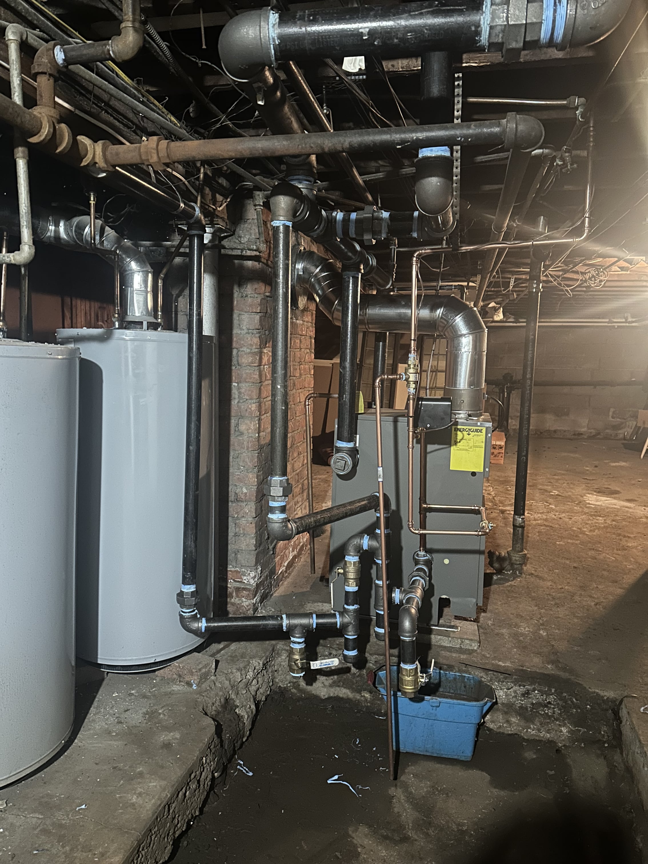

I'm posting this hoping to get some advice from you all as I'm working with a local company after they installed a new steam boiler at my rental property. I've had nothing but issues over the last week and my frustrating is building.
My rental property is 4 units, 20 radiators in total. Combined square footage of all of the units is 4,400 square feet.
My old steam boiler had the heat exchanger fail, so the company replaced it with a Lennox GSB8-225E Gas-Fired Steam Boiler (225000 Btu). The Btus match the previous steam boiler that was over 30 years old.
Now that the new boiler has been installed the following has happened:
1.) Extreme water hammer initially, to the point where I was worried about pipe damage throughout the building. The company came back and skimmed the boiler. This helped but the tenants noticed that the water hammer returns around 4am every night. It's been cold in my area overnight, between 10 to 20 degrees.
2.) 4 days later the company returned and re-piped the black pipe around the boiler including the Hartford loop. Skimmed the boiler again. Still waiting to see if there will be a difference but I've attached a picture of the piping install for your review - is anything off?

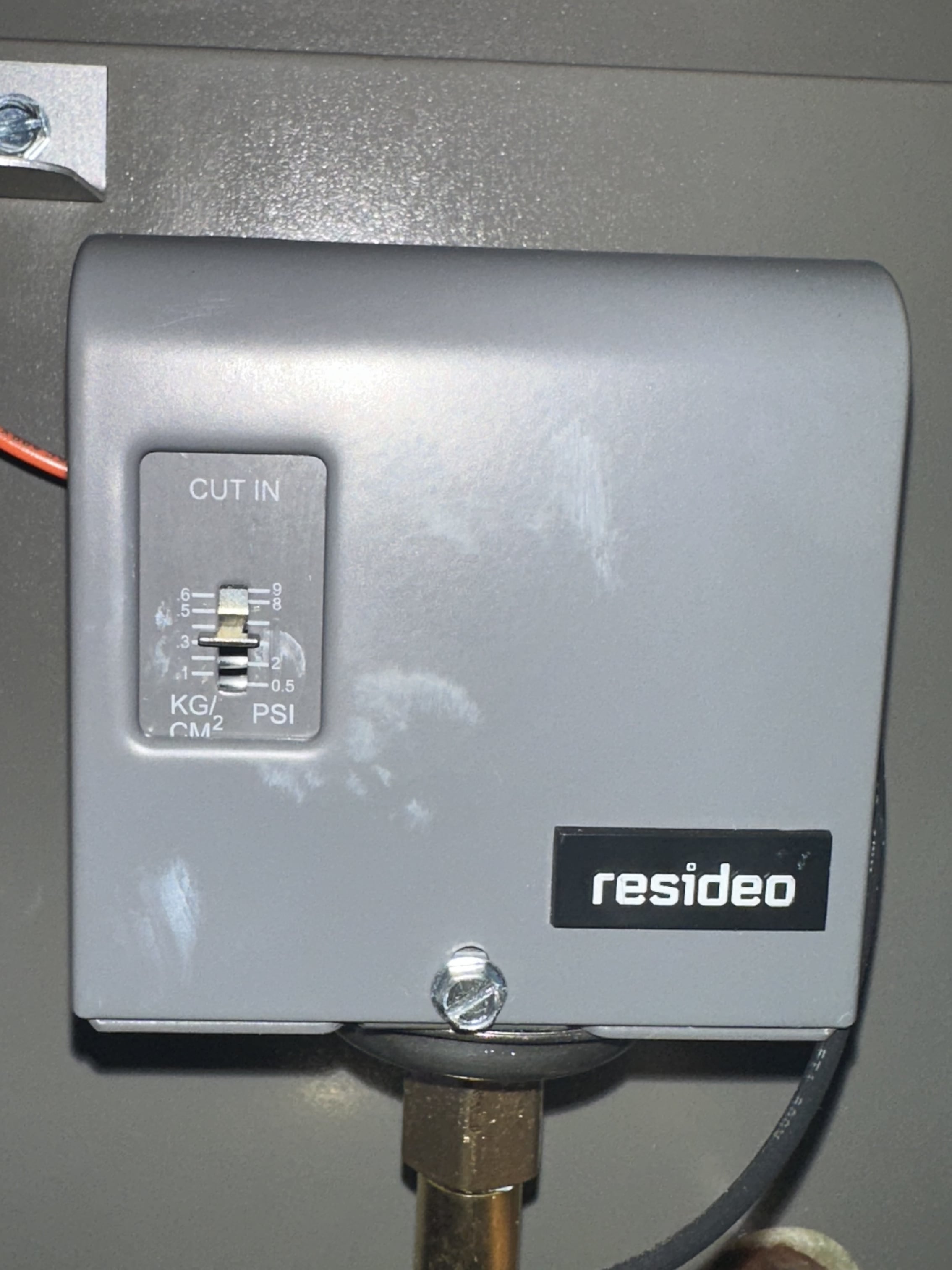

3.) The cut in was initially set to 8psi with a differential of 1, I believe this is the factory setting of the pressuretrol and should be adjusted by the installer. At full operation of the boiler, the pressure gauge read around 3.5 psi which I thought was high but nothing was done about it even when I mentioned it to the install company. After reading online and speaking to an HVAC friend I lowered the cut in to the lowest setting but the boiler would continue to short cycle and not increase heat in the building. I raised the cut in to 4psi which where it is currently, picture attached.
4.) Now the boiler does heat the property but it will stop firing 1 degree below the thermostat's request. For example, if the thermostat requests 72 and it's 68 inside, the boiler operates properly until 71 and then acts as if it's not being called for heat. The app on my phone which is paired with the thermostat clearly shows it's still calling for heat. If I raise the heat to 73, the boiler will turn back on.
Is there anything off about the install or are there any settings I should adjust knowing this is for a 4 unit building with 20 radiators at 4,400 square feet?

    What Ed says above. And I'll bet there's still lots of cleaning and skimming that has to be done to that boiler and piping.
    ethicalpaulMad Dog_2
    109A_5 Posts: 4,617
    Since you are building a lot of pressure it sound like they did not bother to size the boiler correctly.
    May need more skimming.
    Are the mains pitched correctly ? Are the main vents adequate ?
    Pressuretrol should be at 0.5 Cut-In and the Differential set at 1, for a Cut-Out of 1.5 PSI.
    No swing joints.

    The purpose of the right angle swing joints circled above in red by 109A_5 is to allow expansion and contraction of the boiler. If bridled by a header without the ability to expand and contract, the sections can pry apart, causing leaks and premature boiler failure.
    This is why the manufacturer recommends swing joints on the header.

    One other item on the piping — which looks minor but may not be. The steam takeoff to the mains exits from the side, not the top, of the header. Nope. That is almost guaranteed to get water up into the steam mains which will cause water hammer — even if all else is good.
    The temperature difference with the thermostat is a bit odd. If you app is still showing a call for heat, you need to find out what is causing the boiler to shut off. Something is…

  • The manufacturer states the following relating to swing joints:
    "Headers must be fitted with header offsets or swing joints, or be equipped with expansion joints, so that thermal expansion and contraction of the header will not damage the boiler. Headers shall not be welded."
    Before I reach back out to the installation company, can you confirm that I do not have header offsets or expansion joints? I really appreciate your help on this, it's truly eye opening.
    I can take more pictures tomorrow if it will help.

    There are no header offsets, swing joints or expansion joints shown in the photo of the boiler piping.

    the side outlet boiler is going to be more sensitive to surging from oil on the water. adding some tsp and running it for a few hours before skimming might help get the oil out.
    if it won't heat at basically 0 pressure you have venting problems. the reason it sort of heats at high pressure like 3 psig is because it is compressing the air that can't vent out which lets some steam in to the radiators

    the pressure needed for it to heat is venting. pressure can cause hammer in some system designs but from what i can see of yours I don't think you have those things going on but there could be things i can't see.
    the building of pressure could be venting or that the boiler is too big. you won't know until you measure the size and type of the radiators and figure the area of equivalent direct radiation in the system and compare it to the output of the boiler.
    the hammer is probably boiler water quality or pitch that got changed with the new boiler install. that pipe to the main on the right needs to slope toward the header or it will hold condensate and hammer.
    the boiler needs swing joints as mentioned to protect it from the expansion of the piping with temp.

    Steam boilers should be sized to match their load, the radiators. The contractor should have measured all the radiators, calculated the total EDR (Equivalent Direct Radiation). Then sized the new boiler by picking the boiler that best matches the total system EDR to the boiler's Square Foot rating. Oversized boilers typically build unneeded pressure and cost more, neither helps you.
    They probably should have inspected the whole system for any deficiencies like poor main venting. With poor main venting it takes longer to fill the steam mains than it needs to. So you may be burning fuel fighting a restriction that does not need to be there. Also filling the mains as fast as possible helps more evenly heat the structure.
    When they were done with your system, if it worked better than it did with the old boiler you would probably be happy. Instead you are not happy and for good reason.

    2.) Considering the pressuretrol is currently set to a cut in of 4 and a differential of 1, do I need to turn the system off and let the pressure that's in the system neutralize to 0 before setting the pressuretrol to a cut in of .5? Otherwise wouldn't the pressuretrol maintain a pressure of 1.5 as it descends from 4?

    Poor piping practices that equalizer piping is something to behold . Zero swing joints ,sorry to say there ain't nothing there that someone some experience installing steam boiler would have done in such a manner. The side take off main is not helping a thing . Being you have 2 dry returns they should have been separated and each had a main vent added ad then dropped into the wet return . The lack of swing joints as other have said is a real deal breaker being anyone who has read the instructions and has any mech aptitude surely should no better. Over time it shall surely shorten the boilers block and stress it out .
    You have a two pipe system so each and every trap should be check to ensure they are working properly ,i believe that any steam system that is 2 pipe when the boiler is being replaced that the customer should be advised that there traps may need new elements or new traps being nothing last forever and this way you aint doing them for free.
    From the looks of the piping they did not a vast amount of experience or knowledge on proper steam piping nor following instruction . I guess now they should come back and install properly and do everything that a real steam installer would do like figure the edr of the radiators before just putting the same as was there and hoping the last guy was right ,not the smartest practice or one i would dare practice.
    I really hate to say but i have rarely seen hvac companies do steam correctly maybe a few instances but at large i wish they would stick to the tin and leave the steel piping to those who have experience and knowledge being not every job is easy and brings money to the bank at least not when there issues and return visits . These type of mis piped job never happen w those who know exactly what they are doing and usually never by owner /operator 1 man companies being we cannot make mistakes at least not on something like piping a steam boiler correctly it truly is not hard not a giant brain required . This happens when there's only braves and no chiefs and by those who are more about $ then really doing top end quality work and as seen they cannot have to much steam smarts being there plenty of low hanging fruit that either they where un knowelable of but still got the job and did not do correctly .
    If it was price shopping well you may have gotten a bargain but your left w a steam system which does not operate correctly and unless they come back and correct you have pooh and most likely have to find some one else to correct . I would not release a final payment for sure .

    2. No. You may have an incorrect idea about what the pressuretrol does. It can only shut off the boiler when a certain pressure is reached, then allow the boiler to turn on again when a lower pressure has been reached. It doesn't set or hold the pressure. When you stop making steam, the pressure drops to and even below "0" (equal to your atmospheric pressure) within seconds.

    3.) The cut in has been set to .5 with a differential of 1. I've kept an eye on this today and the temperature in the property has remained steady at 70 until the temperate outside started dropping. It's now slowly dropping 1 degree inside every 3 hours or so depending on how fast the temperature is dropping outside. This could be related to the thermostat as per my next bullet point.

    If the old boiler (before it failed) basically heated the building sufficiently, the new one of the same size should work relatively the same. However if it (the new boiler) is surging or other dysfunction because of poor piping and water quality and needs further attention the steam may not be getting to the radiators properly. If the steam can't get to the radiators properly they can't dissipate the heat properly and the pressure will rise.
    If the venting is inadequate and the steam can't properly push the air out of the system so the steam can get to the radiators to dissipate its heat into the living space the pressure will rise.
    I suspect there is multiple issues going on here. The new boiler install just kind of aggravated things to the point that you noticed.

    Or both air and condensate pass through a F&T trap to the dry return.
    I like that loop seal idea. Simple. Wonder why it's not more common.
    EBEBRATT-Ed Posts: 21,169
    @superdave17
    Make it easy on yourself no need to go through the calculations.
    Just add up the EDR for all the radiation. When you get that right. Compare it to your boiler rating in Sq feet of steam. Your boiler is rated for 571 square feet. That already includes the PU factor. No need to convert to BTUs and back and forth its just more confusion.
    EDR=Sq feet of steam
  • jesmed1
    jesmed1 Posts: 1,614
    @superdave17 said:
    You all make me feel stupid but better financially.
    Speaking as a fellow non-heating-pro, don't feel bad. I came here about 2 years ago knowing nothing about the hot water heating system in our 4-unit condo building, and the terrific people here spent a good deal of time teaching me from their wealth of knowledge. The stuff these guys know, and give away for free, is priceless.
    What truly shocks me is how life-long professionals can offer $20k+ job selling $5,000 boilers + parts not knowing a single thing about physics or simple mathematics. I feel like a fool and I should have known better.
    Again, don't feel bad. You are in the same boat as the millions of other homeowners who naturally assumed that the experienced heating pro with the license and the nice truck knew what he was doing. Unfortunately, your experience is a too-common occurrence. I've only been reading posts here for 2 years, and I'm amazed at the number of homeowners who post about problems with their new steam boilers, piped (or sized) totally wrong because the contractor didn't count up the radiator EDR or even read the manual. It is indeed unfortunate that there's isn't some "steam license" that HVAC contractors have to earn by proving that they can (1) add up radiator EDR and (2) read and follow a manual.
    LRCCBJethicalpaul
    mattmia2 Posts: 18,233
    I just thought of something here, if the mains deal with the condensate in the mains themselves by being counterflow, by letting the liquid water run in the main back to the boiler, if these sections don't all slope toward the header and the equalizer, water is going to sit in these sections and cause water hammer especially during long cycles where the mains have produced enough condensate to pool up.
    Jamie Hall Posts: 27,906
    Not only that, but if they are counterflow, they really need to have drips to the wet return before they reach the header!
    @mattmia2
    For a given EDR counterflow mains are sized larger than parallel mains. In addition to being sized larger they are supposed to be pitched twice what parallel mains are pitched and are supposed to be dripped near the boiler so no condensate runs back into the header.
    Long Beach Ed
  • Long Beach Ed
    Long Beach Ed Posts: 1,848
    edited February 2025
    Now that you've learned about boiler salesmen ethics, just imagine what medical doctors can sell you.
    jesmed1LRCCBJ
    this is 2 pipe
    ideally there should be drips but I don't think just the condensate from the main and runnouts is going to cause a problem if everything else is working right
