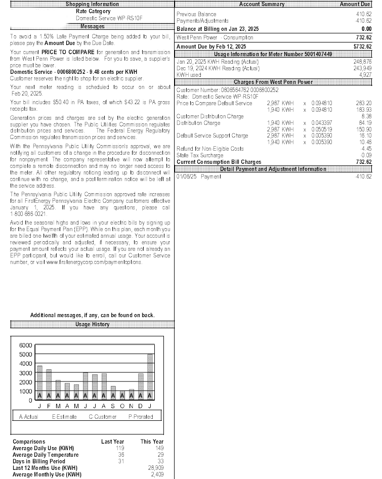

  • here is the recent power bill, and prior usage
    its brick outside walls, layer of particle board then, 2x4 walls, pink insulation with a plastic layer, then real plaster finish interior, 1.5 stories,, half basement,, half crawl space encapsulated . the electric radiant heat does a really good job at heating, its very comfortable heat as well its just very expensive to operate, all appliances and heating systems are electric . and yes it was built with the radiant heat cables in the ceiling , as the original owner was an executive at the power company

  • @HighElectricBills I've examined your usage, thanks for providing that! You have nice and cheap electric rates.
    I personally wouldn't have installed electric radiant + ductless heat pumps, for the reasons you understand now. I myself have a ducted heat pump that does great without any resistance help. That said, this is what your home has.
    You've used 29,000 kwh over the last 12 months. I would guess 6000 went to cooling and 1000/month was base consumption (electric water heater?). That leaves roughly 11000kwh for heating. That's about $1650 per year for heating. So as rough as this calculation is, $1650 is your maximum savings. Assuming gas is around $1/therm variable cost, you'll looking at around $750 for gas, so $900/year of savings. I personally think installing hydronics to save $900/year would be a bad investment, I think you'd be looking at least a 2-3 decade payback.
    Ideally, we could build a time machine and add ductwork at construction. Then you'd be able to add a ducted heat pump + furnace and save big. Unfortunately, we haven't figured that out yet.

  • thanks for doing the calculations and giving a through analyst!!!!, very helpful, appreciate your time and hope u have a good day , thanks again
