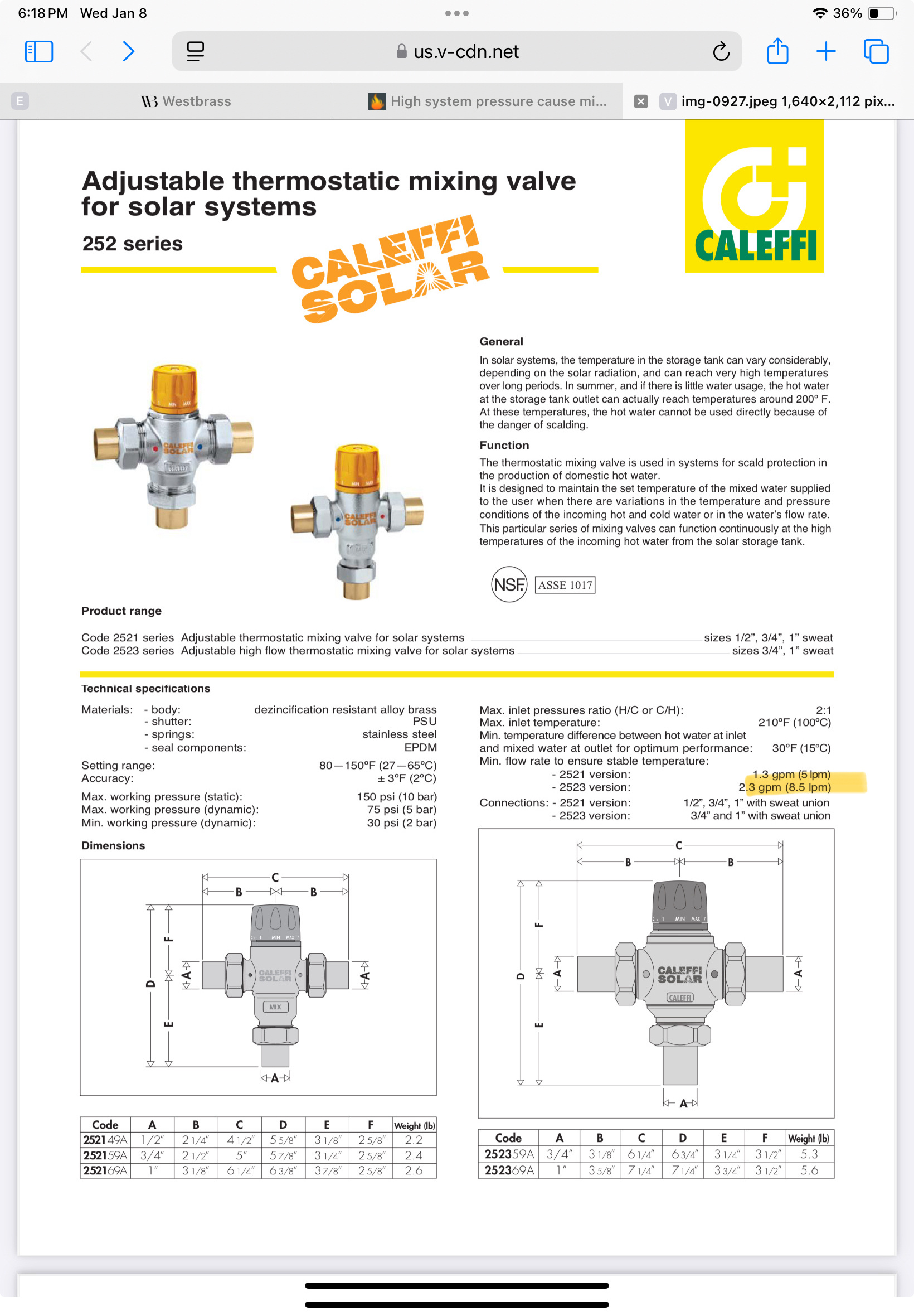

    Most valves are rated to 195F, 150 static pressure , 75 psi dynamic operating pressure.
    High pressure, hard water, high operating temperature, excessive chlorine or chloramines, add stress to the valves.
    Unequal pressure between hot and cold will cause them to shut down. That can happen if the coil is badly scaled, the hot pressure drops, as you start flowing.
    Most valves have a 2:1 pressure ratio, if you have 60 psi incoming and the hot drops to 30, that will be an issue

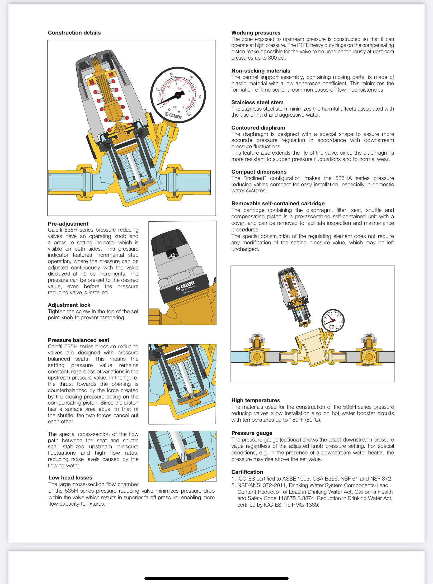

    excellent PRV, easy to service, high flow rate

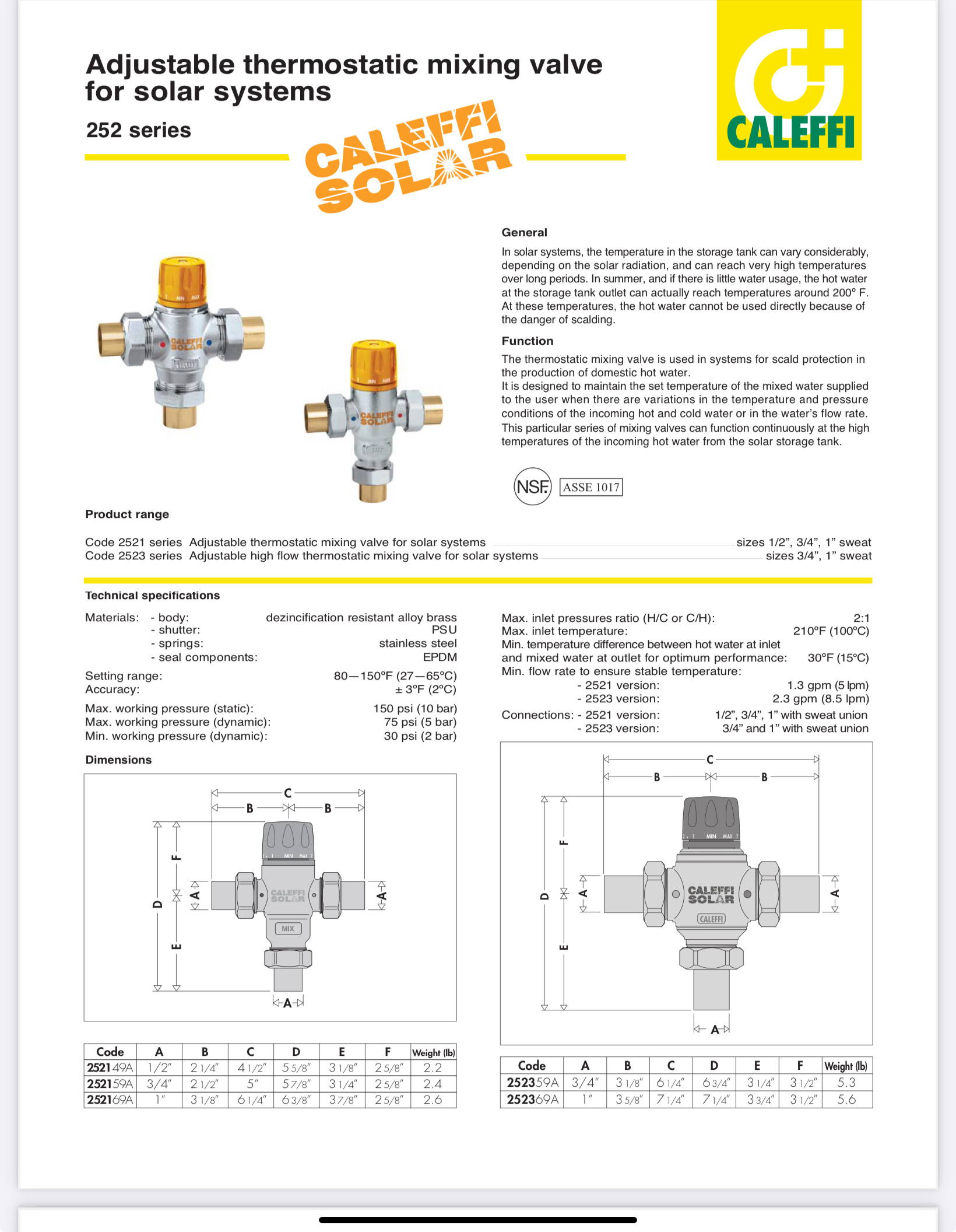

    Also when next you replace the mixer we still offer a solar version, higher temperature rating rating. It has different polymers inside for extreme temperature use. Although limit the hot temperature as much as you can.

    Notice two important numbers, on the two valves maximum temperature, and the minimum flow required
    If you use a lot of low flow faucets, or shower heads, the 520 is a better valve. But your high temperatures 195 plus are concerning
    The solar valve handles the temperature better, but needs more flow to be stable. With a small sink draw less than 1 gpm, the temperature will vary as the valve “hunts”

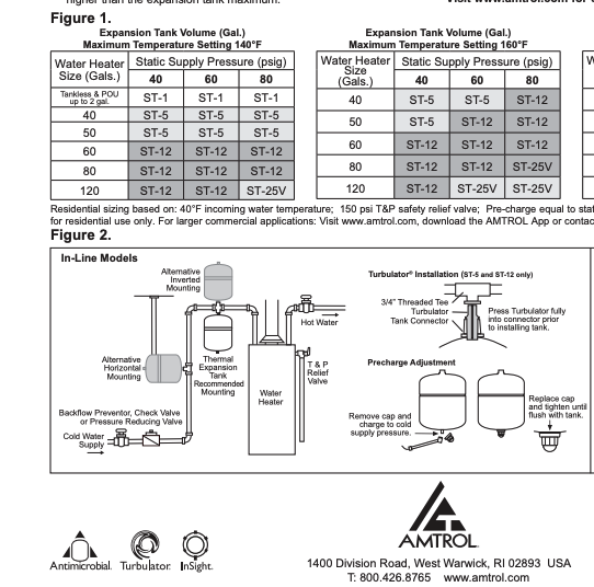

    If you installed a pressure reducing valve on the main water, that is acting as a backflow device also. So you do need a thermal expansion tank expansion tank. Actually plumbing codes require a thermal expansion device.
    When you install it like this it will act as a hammer arrester for H&C. Sizing info also.

    Yah, that makes sense about the PRV acting as backflow prevention, so should I MOVE my expansion tank from the cold side to the hot side, or add an ADDITIONAL arrestor or expansion tank to the hot side?
    hot_rod Member Posts: 28,010
    if you don’t have a recirculating pump, I would remove the checks. H&C will be the same pressure and the exp tank can see the entire system

    I removed the check valves and no more banging! Thanks!
