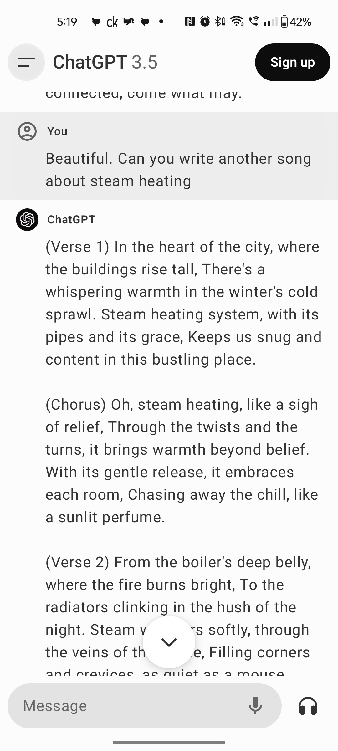

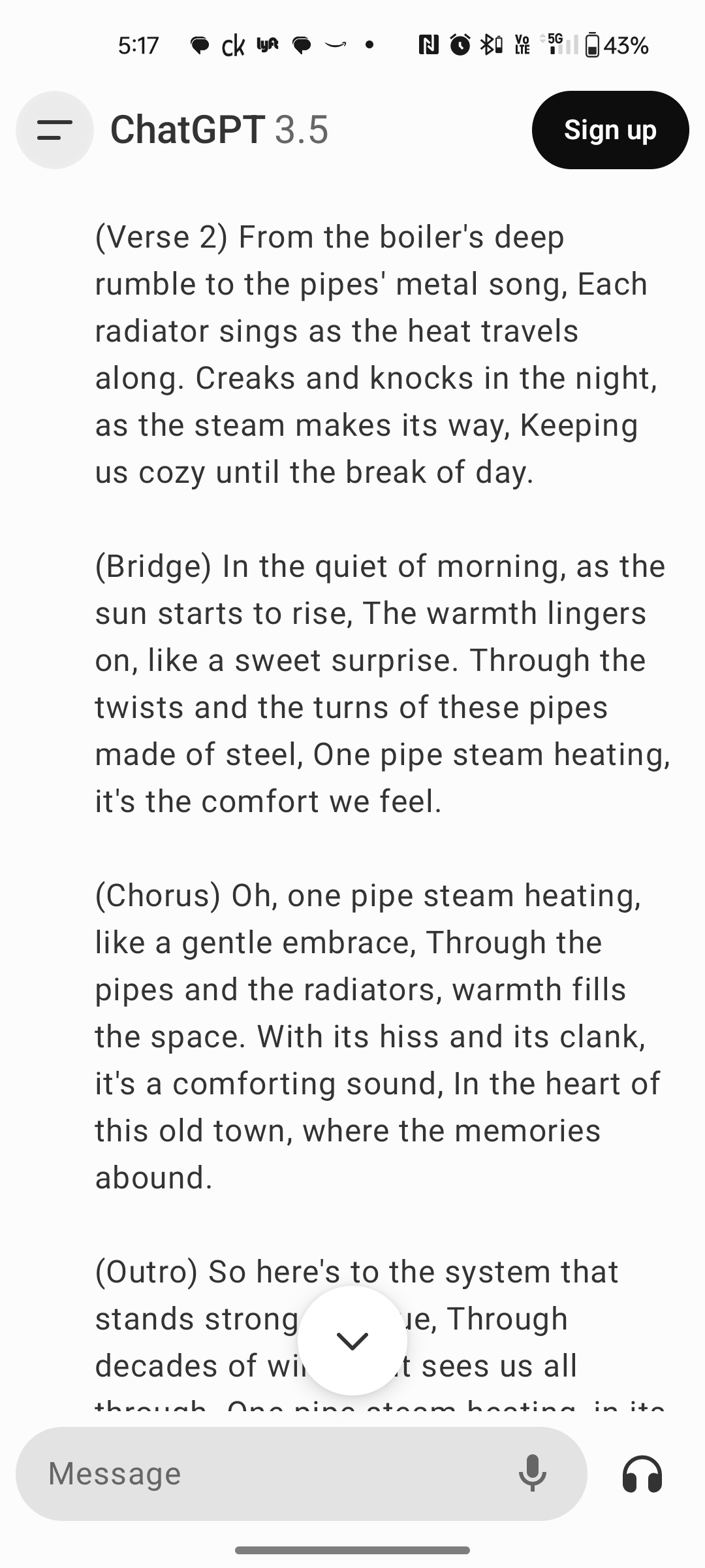

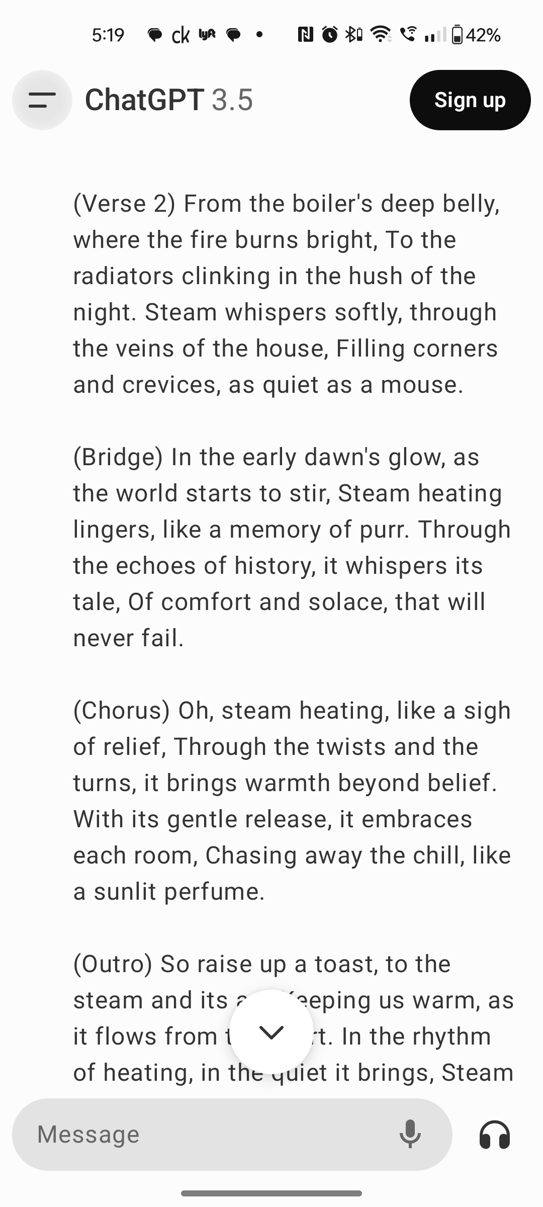

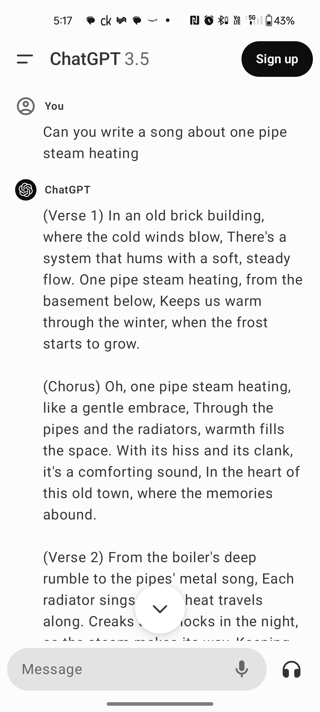

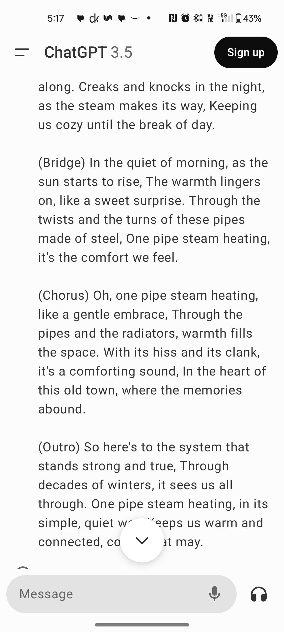

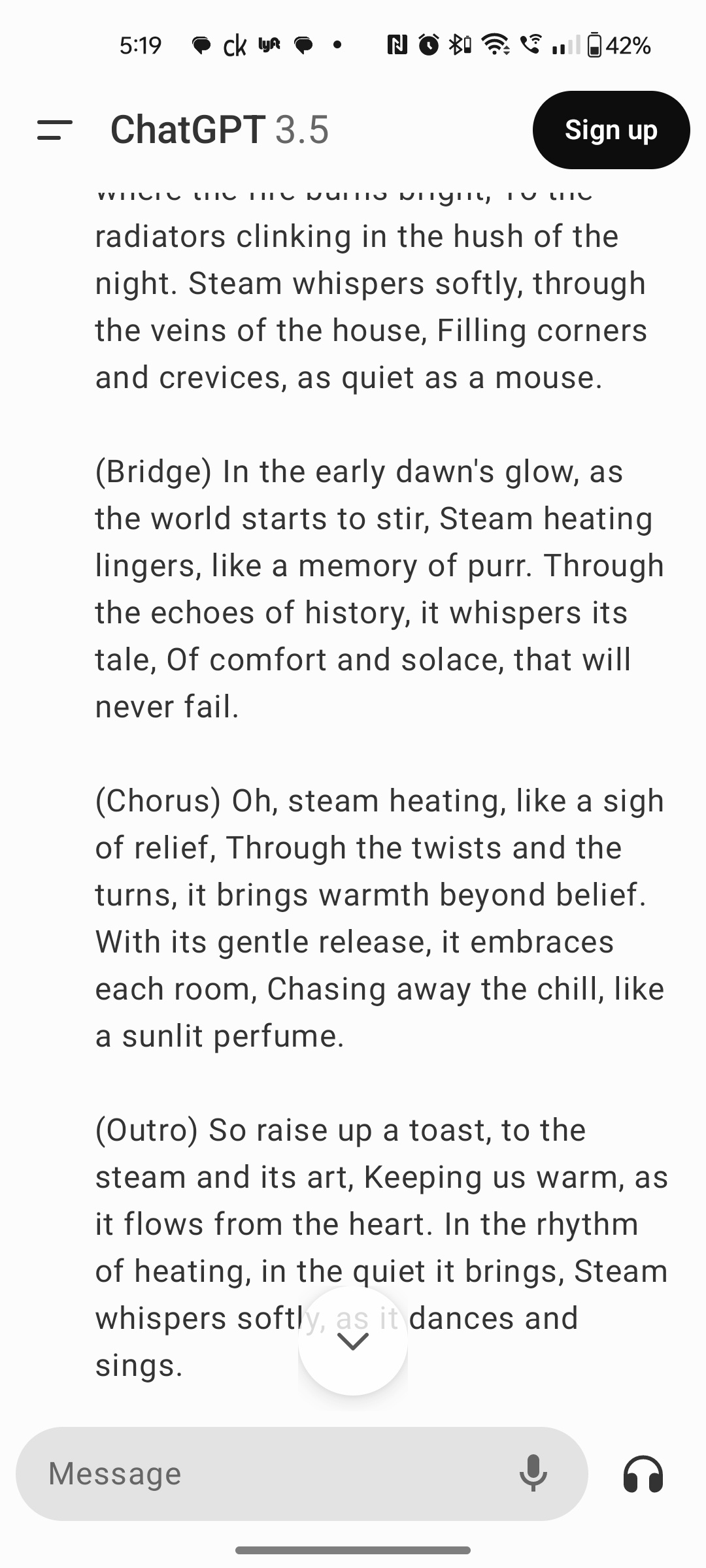

  • STEAM DOCTOR
    STEAM DOCTOR Member Posts: 2,625
    I did ask them to write a song about steam heating. Came out pretty nice. And when I asked for the best website for steam heating info, Heating Help was on the top of the list
