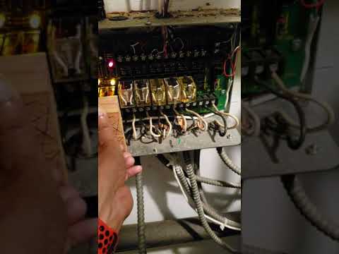

This is a weird one. After some time during the course of the day, the controller just stops working.
Turning it off and back on sometimes it's it working again, but pushing in the two contacts on the left also gets it working. I recently replaced the two relays on the left and it's still the same issue. I replaced both of them last night, everything worked fine. We had hot water. This morning, no hot water again. https://imgur.com/a/Jt5lU9f

If you jump the aquastat terminals does it run?
How is the voltage?"If you can't explain it simply, you don't understand it well enough"
Albert Einstein0 -
The aquastat is calling for heat. I jumped the blue and green wires for the priority thermostat (that's the one coming off the aquastat) and it didn't do anything.

IDK what you mean by "pushing in two contacts". There are no open contacts in the control.

Sorry my brain short-circuited on me. I meant the two relays on the left.Ironman said:IDK what you mean by "pushing in two contacts". There are no open contacts in the control.

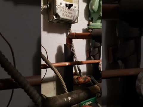

Here's a video of the relay board:
https://www.youtube.com/watch?v=tc_ziR71EGk
in the second video, around the end, it finally stayed on last night for it to heat the water in the tank. but this morning no hot water again. so i probably have to repeat the poking again, lol.
https://www.youtube.com/watch?v=hc1sUEySbVA 0
