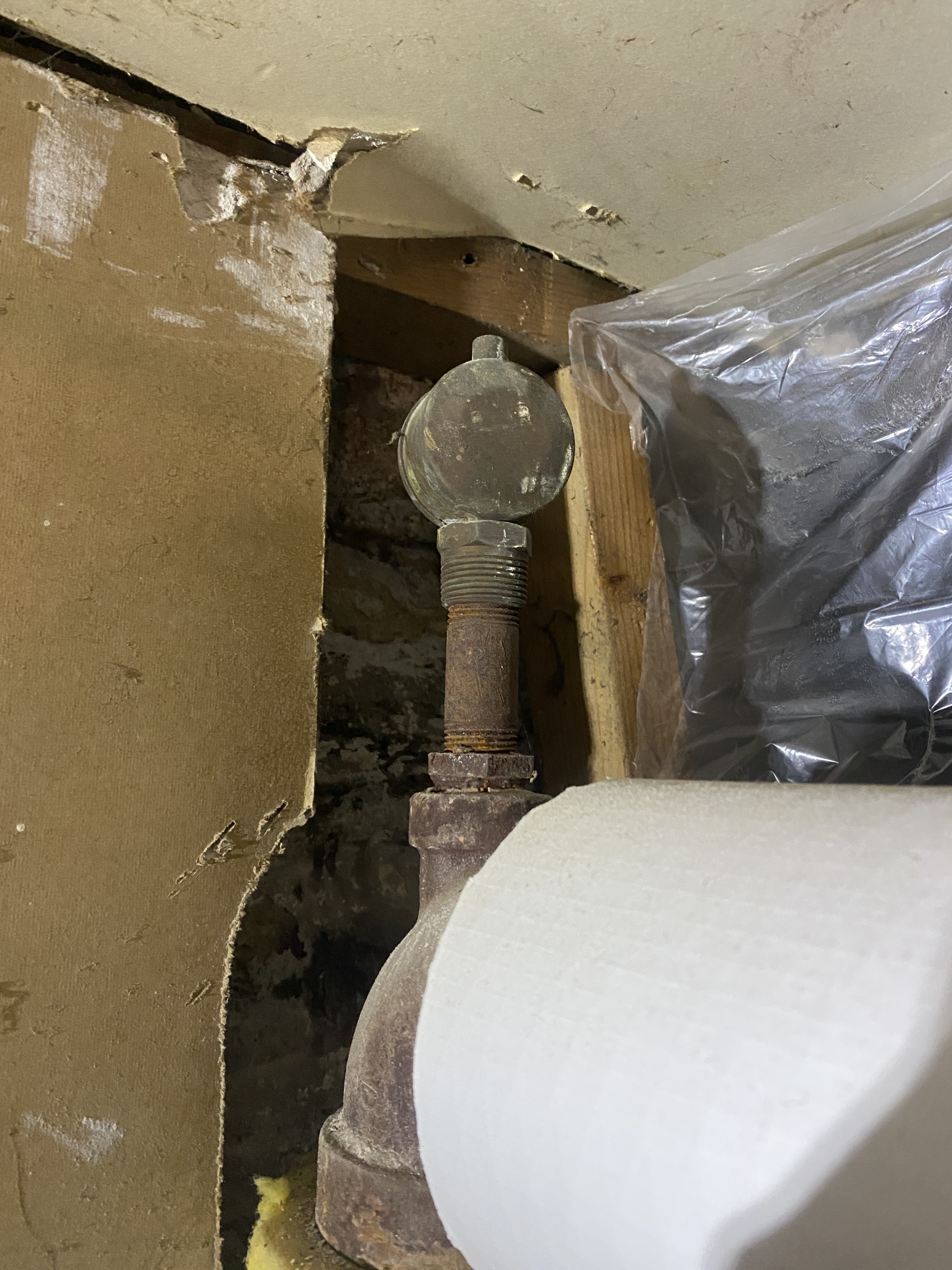

I found 2 locations for air vents on my steam system basement piping. One has an air vent, the other does not.
What size of air vent's should I buy? I didn't want to pull them off without having replacements in hand.
Also pulling them off - as simple as PB Blaster and plumbing wrench? Or are they likely to be "steam welded" on like other steam fittings?
Thanks.

    Diameter is 2".
    The 90 with the vent on it is 55-60 ft from the boiler.
    The 90 without the vent (just a plug) is 10-15 ft from the boiler.

    You will probably need a lot more venting on the 60 ft main. I would try putting that Gorton #1 on the 15 ft main and then a B&J BigMouth on the long main. Getting the plug out of that one main is likely to be a real chore.

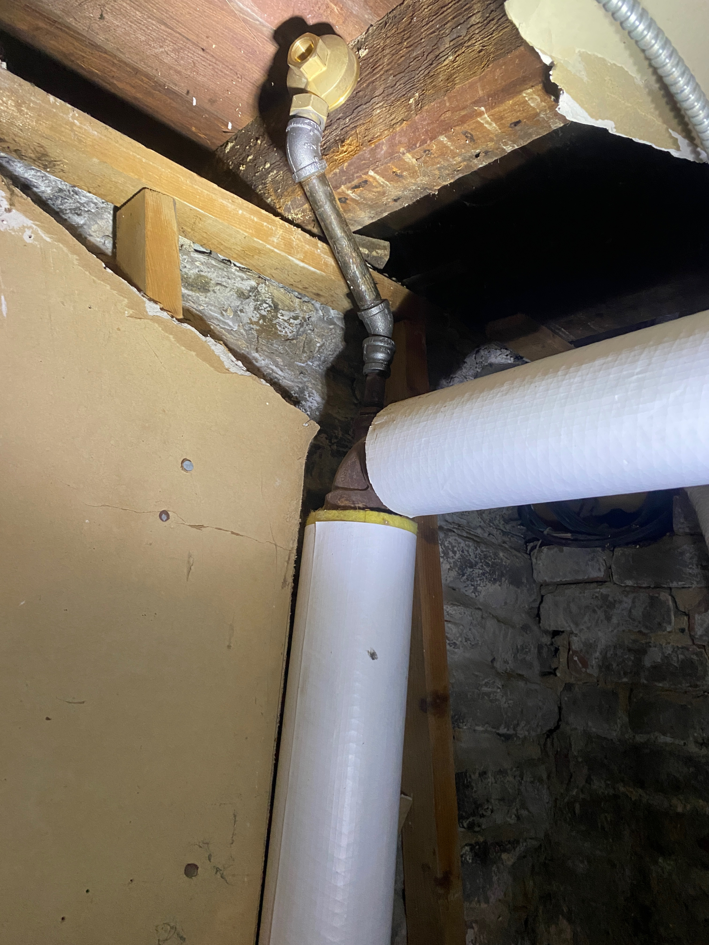

    Thanks Bob. The B&J big mouth is $84 vs $28 for the Gorton #1 at supplyhouse.com. Worth the extra money?

    You would need 5 of your $28 G1's to equal one B&J BM vent.

    YES! Will pay for itself in no time.

    B&J big mouth it is. Hopefully that plug on the main will come out with an impact wrench and square bit. If I can even fit it in there. Thx

    I know this is an old thread, but I'm finally getting around to get these main vents on. The plug on the 90 won't budge. I tried heating it with MApp gas (60 seconds) and loosening with a large crescent wrench with a cheater bar). I smacked the plug with hammer, tried tightening it, and repeated heating. Nothing. I don't want to risk any damage to the system b/c its freezing outsise.
    I tried loosening the little vent on the far (60ft) vent. Didn't budge. Can I heat the black nipple with mapp gas to get it off? PB Blaster?
    Plan is to upsize to 3/4 (reducer), put a 90 el + nipple +90 el + nipple then Big mouth vent to get it away from the condensate.

    Got it installed. Not an ideal location as it's b/w the joist bays.
    On the first boiler cycle, I saw a little steam and a gurgle of water come out of the Big Mouth vent. Next cycle I saw just a bit of steam.

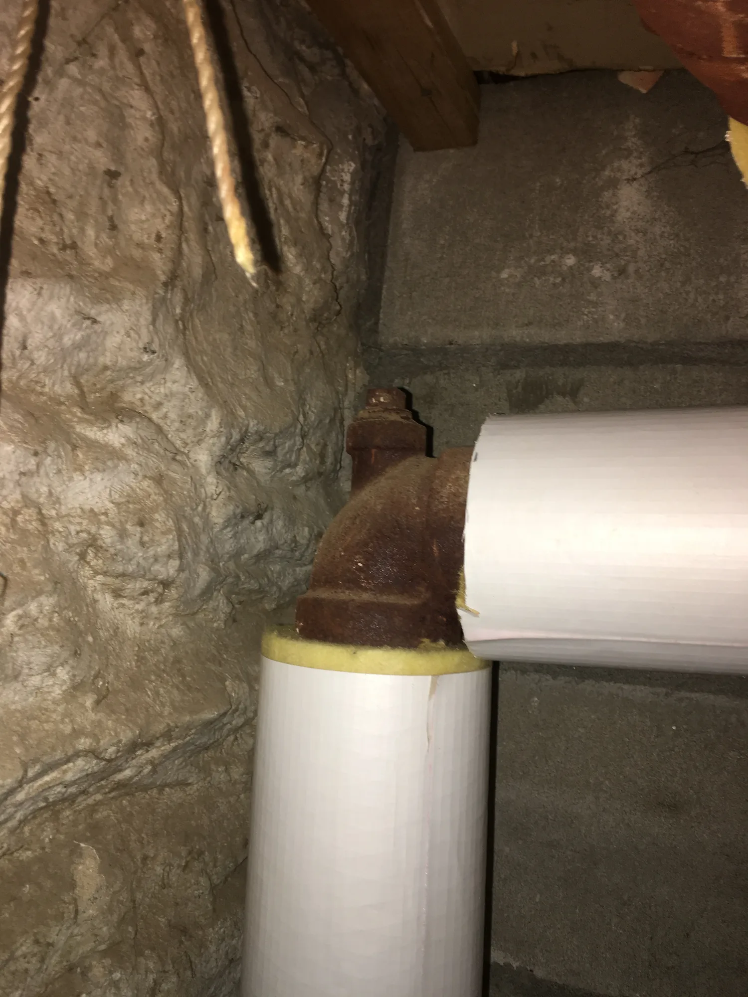

    Next step is to remove the 3/4 plug off the steam main vent location closer to the boiler. Will try more mapp gas on the 90el and use a pipe wrench plus cheater bar. I have a Gorton #1 on hand.

    I've been heating this 90 el vent port with Mapp gas, allowing it to cool for 5 minutes, and spraying PB Blaster on the plug. I've done this 2x a day since Monday. Am I just spinning my wheels here? Will patience win over this plug? I am not in a rush. I'm willing to do this for another week if it will help.
    FYI: monday i tried removing the plug with a pipe wrench and a cheater bar, with a backup wrench on the pipe. No luck.

    Please expand on "no luck"
    What happened with the big wrench on it?
    I personally don't think PBBlaster can get in there. How hot did you get it? Did it glow? I'd try the wrench while it's still hot.
    Did you try tightening in addition to loosening?

    "No luck" - I gave it a good push with a 4' cheater and it didn't budge. I'm afraid of breaking something. I had a cheater on the backup wrench so it was an awkward position. Maybe I'll phone a friend to hold the backup wrench. Again, I'm in no rush to get this done.
    In terms of heat, I heat it for 2 minutes at a time. So - no where near glowing. Again I'm afraid of damaging that 90 el. Can I get it glowing without compromising the fitting?
    Am I being too cautious?
    I have tried the tighten trick. Maybe i'll give that another shot.
    ethicalpaul Posts: 9,076
    I think you're being too cautious, but it's not my house in cold weather so I completely understand. I have helped friends remove stuff sometimes who aren't so familiar with pipes and they are much physically stronger than I am but they can't do it (or they think they can't). It's about knowing (with at least some certainty) how much force stuff can take and needs to take.
    You can put the wrench on so that the force is in line with the main and then you need less or no counter on it. It's difficult in a corner like that, I completely understand what you mean about awkward.
    I've never had to heat anything to remove it, but I hear people say it should be glowing. Heat the tee not just the plug, if you heat the plug it will enlarge it (I don't honestly know how much that matters). People say the idea is by heating it you kind of crystalize the oxidation so it can be crushed by applying the wrench on it.
    It doesn't hurt to wait until it's warmer, for sure

    You won't overheat that metal unless you are using an oxy/acetylene torch! Get it as hot as you can and give the plug some good hits with a hammer. Repeat the heating and hammering multiple times.
    Putting PB Blaster on while super hot is beneficial (aside from the smoke). It boils and really wicks its way into the threads. If a penetrant is going to help in this situation, heating first will give it a chance.
    And try remove the plug when it is as hot as can be.
