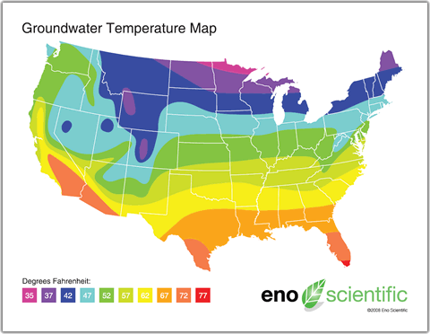

    I think I want approximately 4 GPM.
    I did a little research and planning on my DHW needs. All of my shower heads are <= 2 GPM. I'd like to be able to run 2 showers simultaneously. We typically wash our clothes with cold water, and we can control when we run the dishwasher.
    So a 40 Gallon indirect tank would supply at least 10 minutes of 2x showers. I think the output temps are usually 125F and would run the shower at 104F, so technically only using ~85% hot water, so the 10 minutes becomes 12 minutes. That should be more than enough.
    Next question is recovery time and/or sustaining hot water.
    I found a <a href="https://us.v-cdn.net/5021738/uploads/editor/v1/ycrbhbygrbnk.png">source that says my incoming water is 42F.
    My tank water would be 125F or would I have it higher for input into the indirect water heater?
    I found this calculation for Tankless systems (I assume boilers are the same):
    System Delivered BTU = 500 x GPM x System Water Temperature Change
    GPM = 4 System Water Temperature Change = 125 - 42 = 83 BTU = 500 x 4 x 83 = 166K
    I don't know if I need to account for efficiencies to account for.
