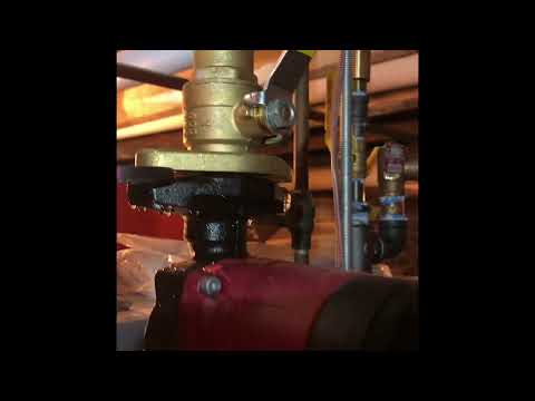

  • GW
    GW Posts: 5,299
    Leak😀
    https://youtu.be/wFEAH0akrts
    Yes the wiring is lame, electrician is coming

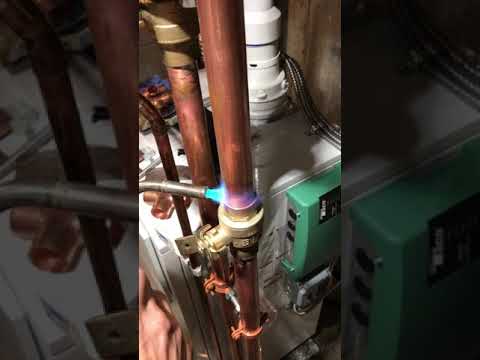

    Did you just reheat that leaking joint ? For me as just an occasional user I find the silverbrite (sp) is very easy to use .. so I stick with it. Use the map gas. From what I remember reading a while ago it makes a strong joint. I have some 50/50 for use with copper roofing/ gutter work (my house is slate) .. I have trouble using it.
    How do you like the Viessmann indirects. I have two of the white ones going in my new project ... not turned on yet. I forget if they are 40 or 42g
  • GW
    GW Posts: 5,299
    edited December 2021
    Tag yes I fluxed and nuked and the solder did its job. At times (rare) I’ll band saw or sawzall the middle of the fitting, heat the pieces off and start over. I hate couplings 😫 just my personal OCD. If the day is super long (evening) I MAY use a coupling if I can’t drain the water
