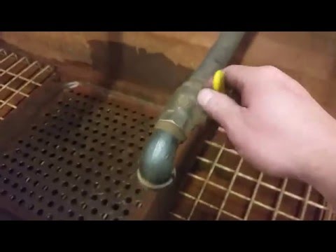

    Ok here's the update. We debated just machining an O-Ring groove into the plug but that proved more difficult to align in the vent body. So I machined an O-Ring groove into the actual body and eliminated the brass seating surface. The vent now seals without any leaking, drips and stays sealed.
    we tested this new design against the one that many of you had bought and the difference is noticeable at 6PSIG. At low pressure this should be almost unnoticeable but it is now a gasket seal.
    I think the best solution is for me to make up a bunch of these new vents and send them to anyone who bought them. I'll enclose a UPS return label for you to send the obsolete vents back. I should have all your shipping info and quantities from Amazon and will ship as soon as I can.
    I apologize if anyone is put out by this and appreciate your understanding.
    https://www.youtube.com/watch?v=OWoAReeOutg

  • Sailah
    Sailah Member Posts: 826
    Thanks for the nice words Bob. Shipping is on me. My head machinist was not pleased when I dropped this project on him.
    Although to be fair, I did all the prototype machining on the lathe, ground the tool for the trepan operation, tested etc. He just has to repeat it 100 times lol.

    Ok so here's where I am at.
    I machined 50 of the bodies for O-rings. They seal up perfectly under steam. Our steam testing rack has a cold water injection pump so we can rapidly cool down the traps after testing. When I blasted cold water through the Big Mouth, it dislodged the O ring which then caught in the seat and the vent blew by.
    So I bought some polypaks which are O ring backed seals like a square o ring. I machined a body for one of these and tested. It sealed up perfectly but again when I blasted water through it, dislodged the oring from the seal. Same problem.
    In single pipe would that testing scenario ever happen in your systems? Water blasting through the vent? Not water gently filling it or getting to it, but a full throttle open faucet type event?
    I feel like I'm worrying unnecessarily about the O ring because what I'm subjecting the vent to would never happen in real life. But that's why I'm asking the question.
    So as it stands here are the options we have.
    We can leave the Big Mouth as delivered with a brass to brass seal. I see the only downside as it might leak a drop or 2 but I can't see this being a big deal, maybe it is? It would certainly be the most reliable version.
    I can supply it with a silicone O ring. This would eliminate the 1 or 2 drips because of the positive seal. But retaining the O ring in the groove under severe water turbulence has proven troublesome. I'd like your feedback if this is even an issue. I feel this is the best version but if you guys get a lot of water hammer, I'm not going forward with it as once the oring gets moved it is totally non functional.
    I am trying square and X profile O rings today with the hope that they are retained better.
    From left to right. Silicone O ring, 5/8" ID polypack, 3/4" ID Polypak
    The polypak after I knocked it loose with water.

  • Sailah
    The Oring groove is machined oversized by 0.020" so the O ring is a slight stretch to fit and it is snug. It would never come out under any circumstance other than what I described. In fact while writing this post I took the vent with the O ring and slammed it with O ring down on my desk repeatedly enough to make my coffee cup jump. Didn't move an iota. I think the blast of water I send through the vent is hydraulicking the O ring out.
    Good points on the RTV. I have a tube of Loctite Black Silicone and just made one up. Takes 24 hours to cure. I think it will also fill the gap so water can't get behind it.
    So, no O ring can't come out during shipping not a chance.
    And I'm also hearing that a big slug of water would never make it into the vent during normal operation?
    Thanks Gents

  • Sailah
    Double D said:
    I would prefer a couple drops of water to totally non functional. At worst a system may have lazy returns and water may stack in the return up to the vents but there won't be or shouldn't be full city pressure.
    That's what my preference is too. A couple drops of water on a basement floor is no big deal. Hell my basement (1815) is dirt anyways.
    The brass to brass seal gets better over time as the parts mate with each other. We don't worry about it in a trap as there is a drain.
    By making the vent airtight, I've eliminated the potential for a drip, but I've now built in a fail mechanism, that while remote, in my opinion doesn't offset the gains.
    But I want the opinion of you guys since you're the customer.
    My rack is testing at 6PSI and the vent seals with authority. I run 50PSI of water through the testing rack to cool traps.
    I'll shoot a video of it and it should show how it seals

    In my opinion,
    This is kind of like testing a truck rated for 2000 lbs by dropping 10,000 pounds into the back from 50 feet up. :)
    Some RTV would probably seal the deal (pun intended) but I bet they would work without it. 1 to 2 PSI tops and little to no water under normal conditions.

  • KC_Jones
    KC_Jones Member Posts: 5,936
    From what I saw on the limited testing I did of the first generation I would prefer the o-ring seal over the brass to brass seal. On mine I was seeing what I consider a fair amount of steam passing through with the brass to brass seal. If someone sees water blowing by like your test (on a one pipe vent application) they have MUCH bigger problems to worry about than an o-ring. I will put it this way, if you use the o-ring I would buy it, without it i doubt I buy one....just to put it bluntly.

  • gerry gill
    gerry gill Member Posts: 3,084
    I'm leaning toward the oring as no water should ever be there.

  • KC_Jones
    Paul48 said:
    @KC_Jones
    There may be information that @Sailah could use from your testing. If no one else witnessed what you saw, what is different about your application. You may have an application that might prove problematic, and he needs to know that.
    I have been in contact with him privately about this and sent him videos. I had one of the pre production test units.
