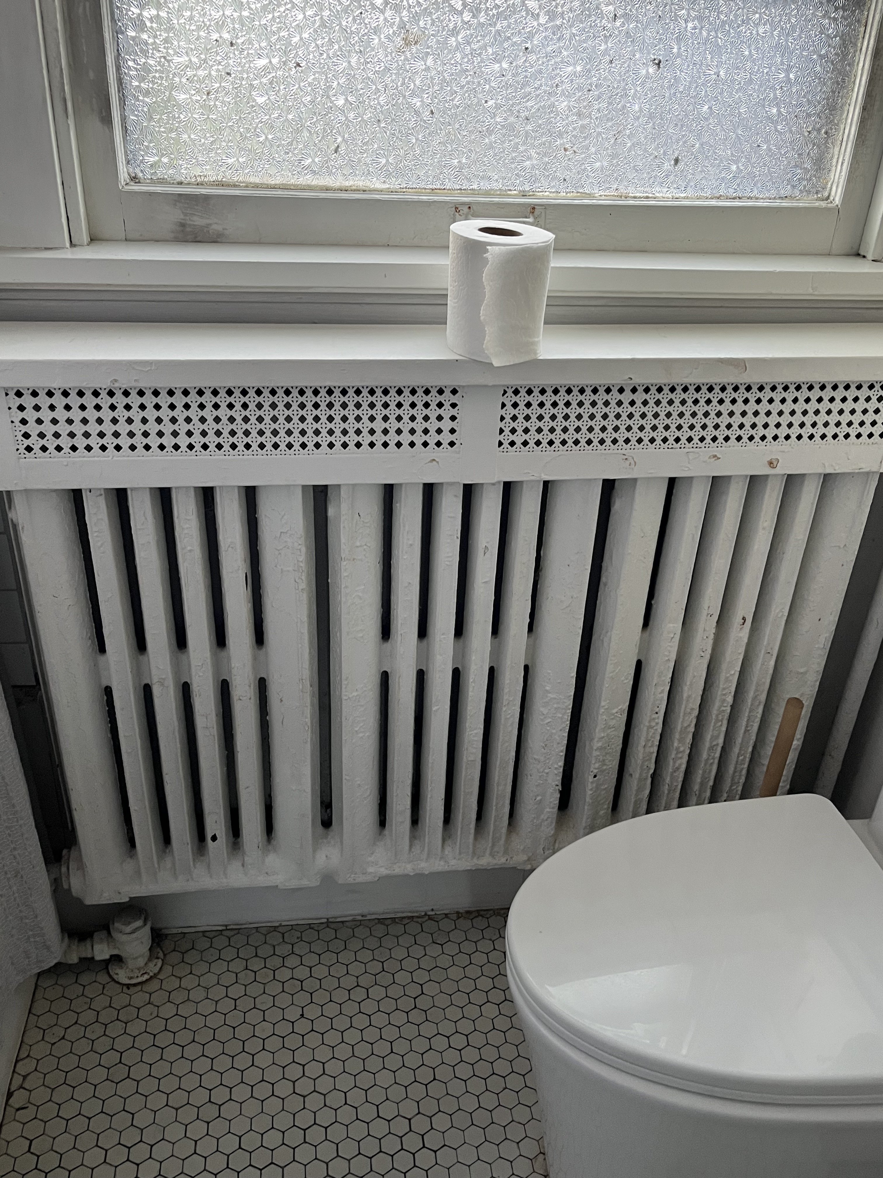

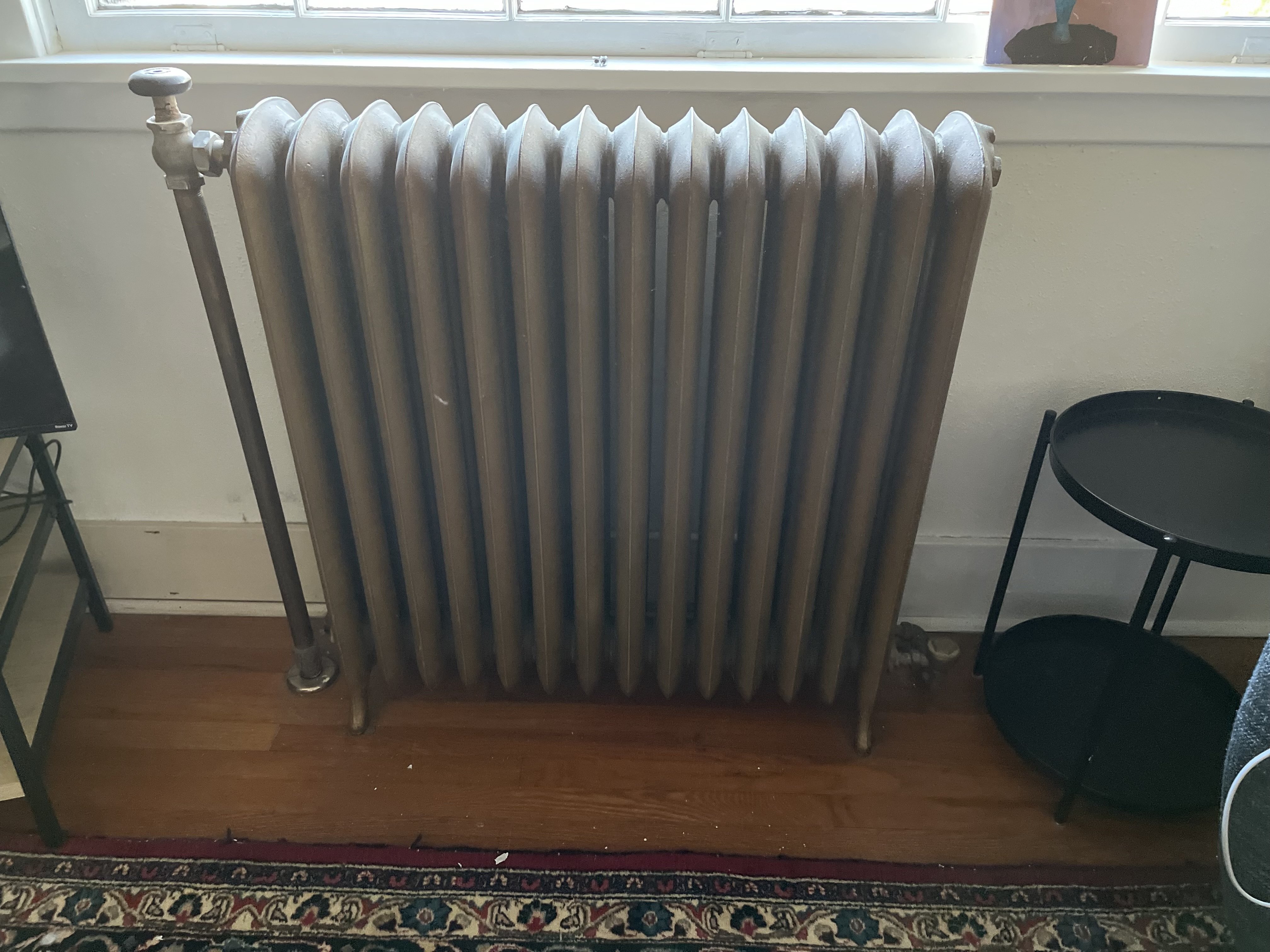

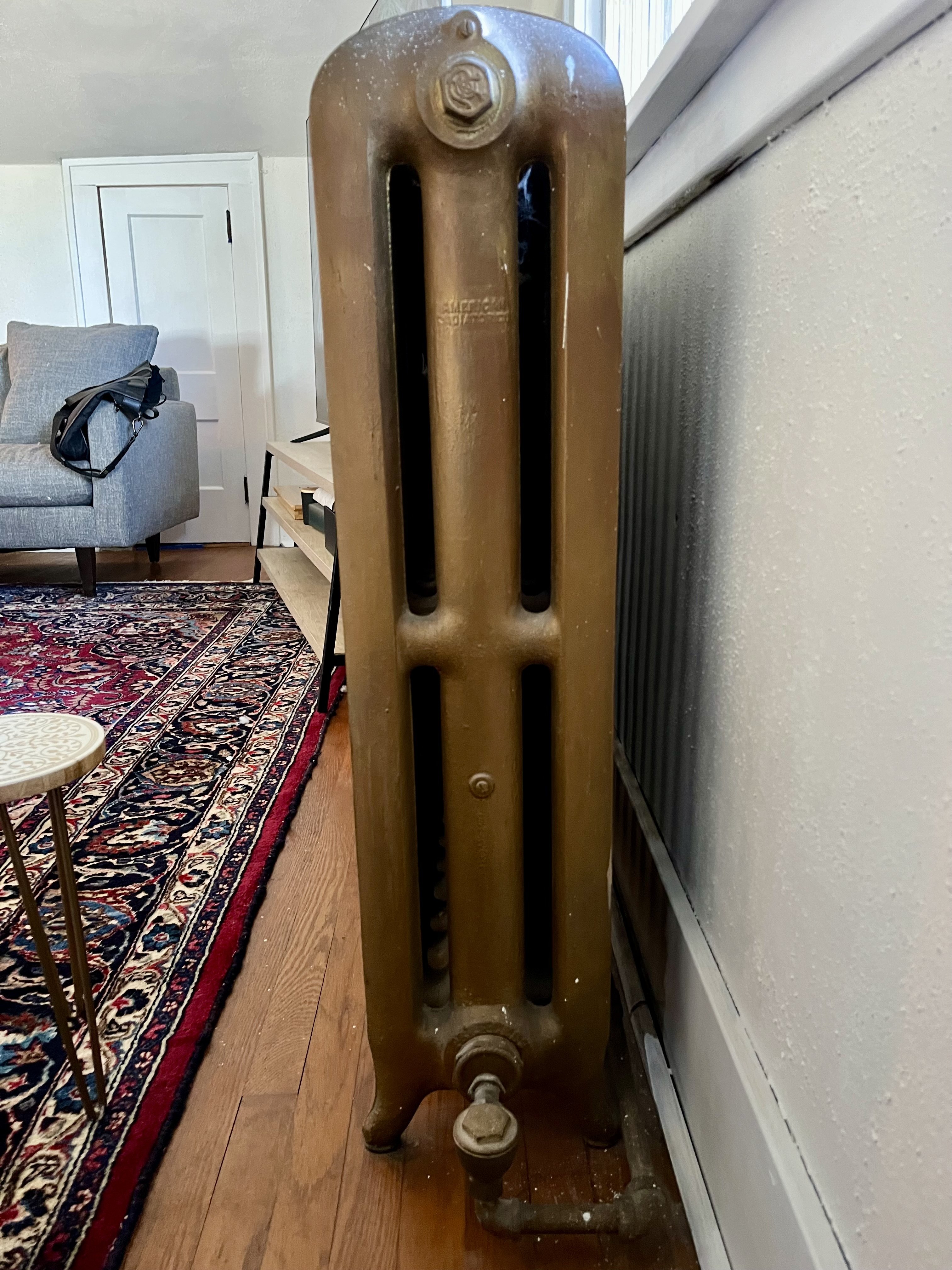

    Three photos. 10 radiators are similar design to first photo. The second photo is one of the two 3" wide radiators. Third photo shows the end of one of the 10 similar design radiators.

    That looks like a standard type of Vapor system. Vapor is ultra-low-pressure 2-pipe steam, and was the Cadillac of heating in its day. It's still one of the best systems out there.
    The trap on the bathroom radiator looks original, and might be a Webster 02H. The others look like Hoffman 17C units.
    Are there any cast-iron devices in the piping around the boiler? Any traps at the ends of the steam mains?

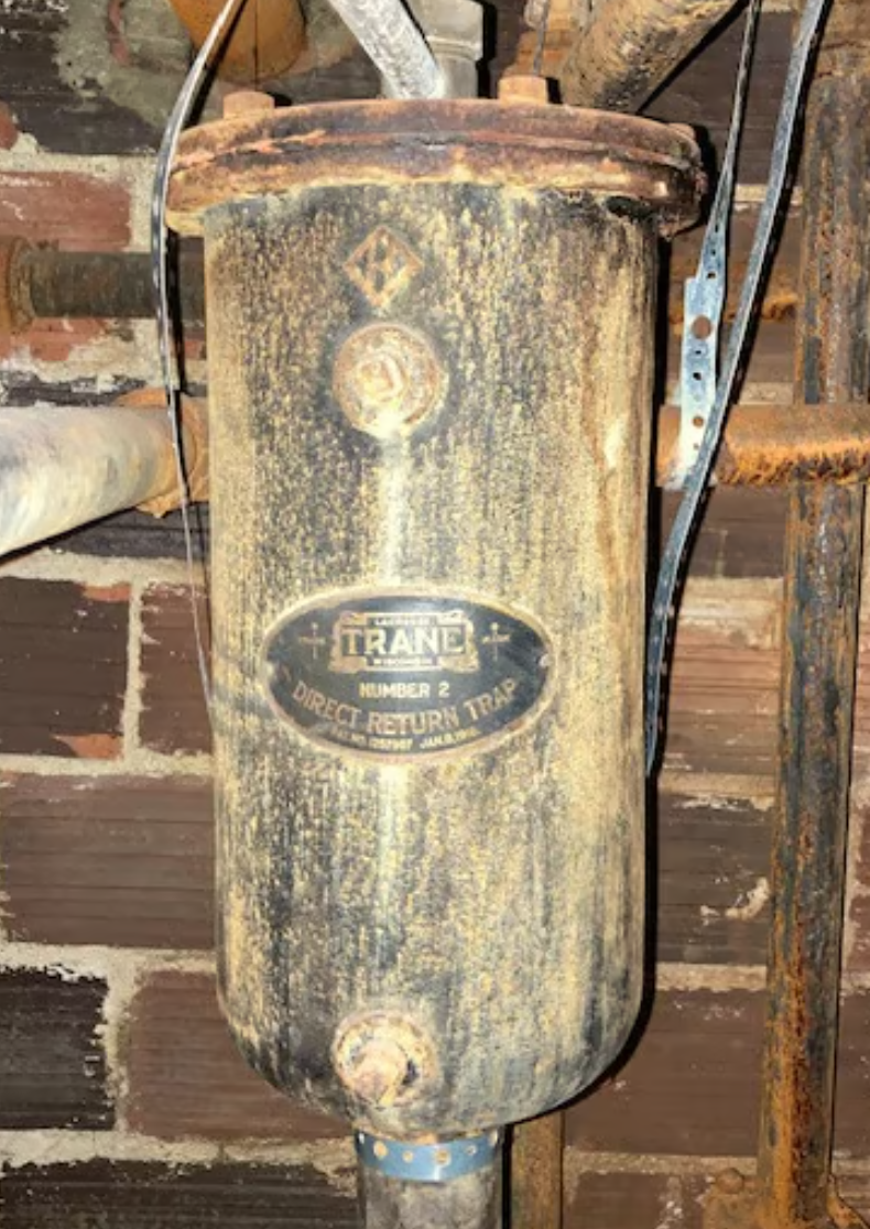

    @Steamhead, there are traps at the end of the steam mains. I replaced a defective one a couple years ago. And yes, those are Hoffman 17c steam traps. There is one more device near the boiler that's a Trane Direct Return trap in this photo.

    Great information, but what is really needed for length is the number of sections on each radiator. The wall hung radiators I found information on, but the floor standing ones we would need number of sections per radiator and I can plug it into my calculator and get you a system EDR.
    EDIT
    I'd also add, just for clarity, height is measured from the floor.
