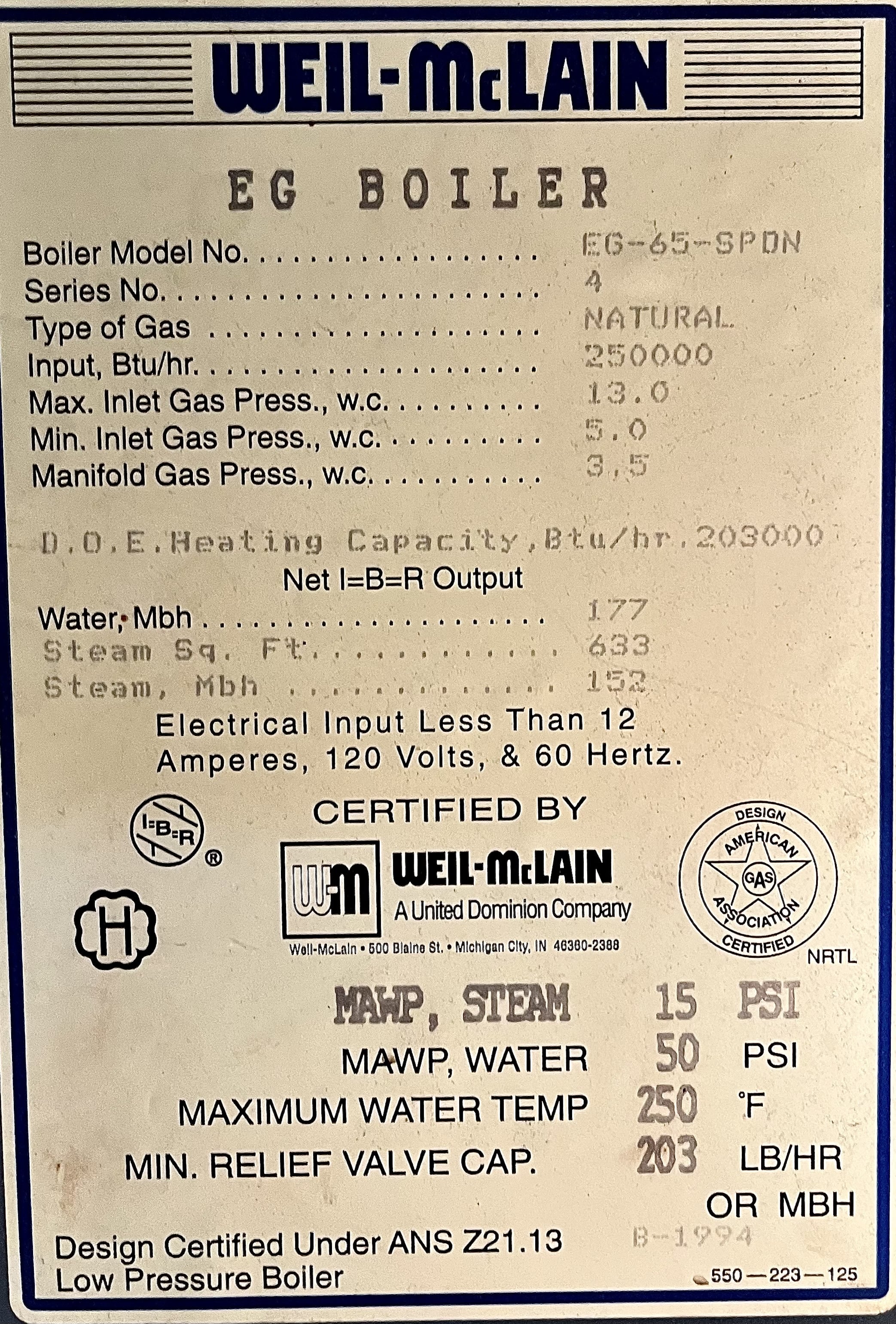

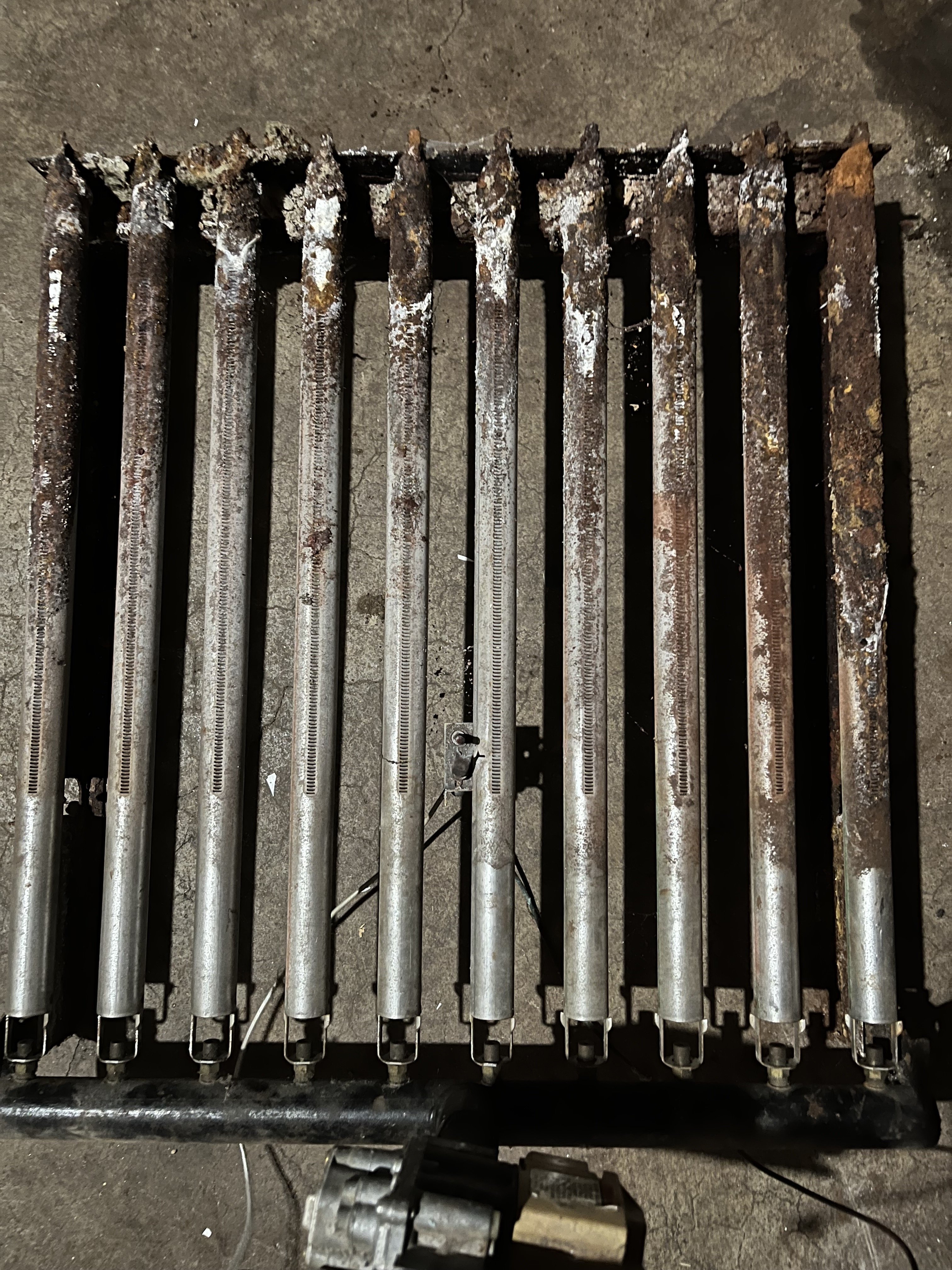

My steam boiler has developed a slow leak. I've talked with three local contractors regarding the best solution and have gotten three very different answers.
One contractor says we may be able to rebuild depending on if it's the seal that's leaking or one or two sections. He also gave me a price for putting in a new boiler.
Another contractor says rebuilding is never a good solution. So he gave me a price that was twice what the first contractor gave me for a new boiler.
The third contractor thinks I should convert to a hot water system.
I have attached photos of the burner and the boiler info. I have no idea what the cost of installing a new boiler should be or if it's a good idea to attempt a rebuild or a hot water conversion.
I live in a small town in the midwest. My house, radiators and piping are 100 urs. old. The boiler has worked fine since I acquired the house six yrs. ago. It's a 2 pipe steam system.
Any feedback appreciated.

    have number one and number two measure the EDR?
    If not you can throw them out also.
    250,000 BTU/h, 630 EDR is huge

    Based on the corrosion I see on that burner tray I'd say it's way more than a slow leak. I have the same boiler and when my original got a leak it dripped all winter to the tune of gallons per day and didn't corrode the burners that much. Either you've had a leak for years, or the leak is fairly bad.
    Based on that label it appears to be a 1994 vintage which is 32 years old. For me it makes no sense to try and rebuild a 32 year old boiler.
    Replacement of the steam boiler would be my vote. That said, you need to make sure they do it right, starting with sizing the boiler correctly. You have a fairly large boiler for a single family home and I'd guess it's oversized. I'd be taking measurements and working up the size myself first to verify they are doing it correctly. We are happy to help with this part, it's fairly easy to do. After that they need to make sure to follow the manual and pipe it correctly in black pipe. I would suggest you get that in writing so you have some accountability for them. We don't discuss pricing here, but it's going to be expensive no matter which choice you make.

    Obviously the water has been leaking down on to the burners and rusted them up. Weather the boiler can be fixed is something difficult to tell from here. Weil Mclain makes good boilers so there is that and that boiler is still made.
    That is a large boiler 250, 000 btus
    The first thing to do because a lot of boilers installed in the past are oversized (this isn't a good thing; more is not better) is to measure all of the radiators and determine the EDR capacity. This will point you to the correct boiler size. We can help with that. We need height, length and width and some pictures.
    This may seem like nonsense if your old boiler did the job, but trust me it is important.
    We also can't talk price on this forum so there is that.
    Once you have the total EDR load we can pick the boiler.
    The most important thing is the correct contractor that knows steam. He has to pipe the boiler in accordance with the instruction manual and skim the water when he is done. Again, I can't stress this enough. Some contractors are hacks (sad to say) and will not follow the instructions.
