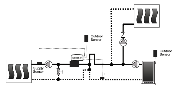

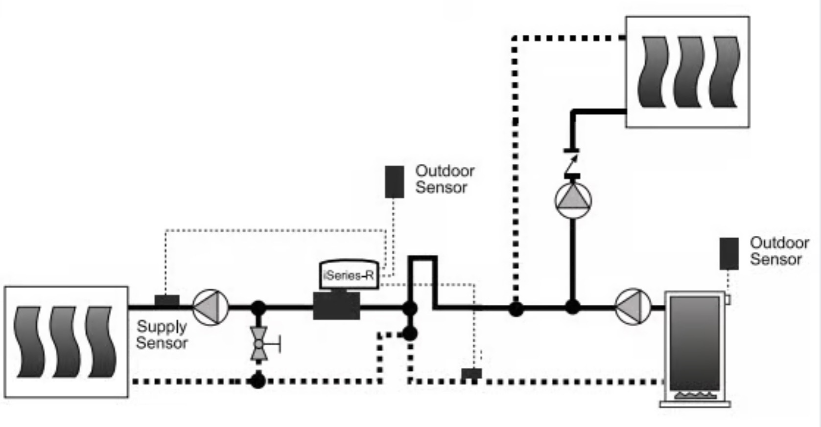

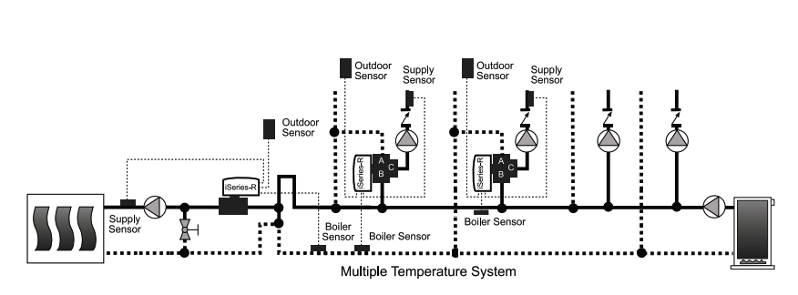

    I kind of like the Taco iSeries-R valves for this job. You can use the boiler’s outdoor-reset function to control the highest-temperature KickSpace loops.
    Then you can use an iSeries valve with its outdoor-reset control to essentially “reset the reset.” I think this is a great idea, and I hope this technology does not go away anytime soon.
    The idea is that the lower-temperature zones take the water temperature provided by the boiler and mix return water with it, adding or mixing in hotter boiler water as needed to produce the lower supply-water temperature required by that zone.
    The control uses its own outdoor sensor to automatically lower the water temperature supplied to the related zone as the outdoor temperature rises, while increasing it as the outdoor temperature falls. This allows each lower-temperature zone to receive only the water temperature needed to maintain the desired comfort level.
    In this above example there are 4 different temperatures. The highest temperatures come directly off of the hottest boiler water and can return to the supply with closely spaced tees or back to the return, both are acceptable depending on your design. The second and third zones temperatures are using a mixing valve with the iSeries-R actuator to obtain the desired temperature. the last zone is using the lowest temperature boiler water from the system and that is using an injection design to add just enough hot water to the loop(s) to get the desired floor temperature.
    Those valves are not inexpensive, but they eliminate the need for additional or separate valves and ODR controls to operate those valves. @hot_rod has more experience designing these systems and may have a different idea. But I think this might be your lowest cost design for what you are trying to accomplish.

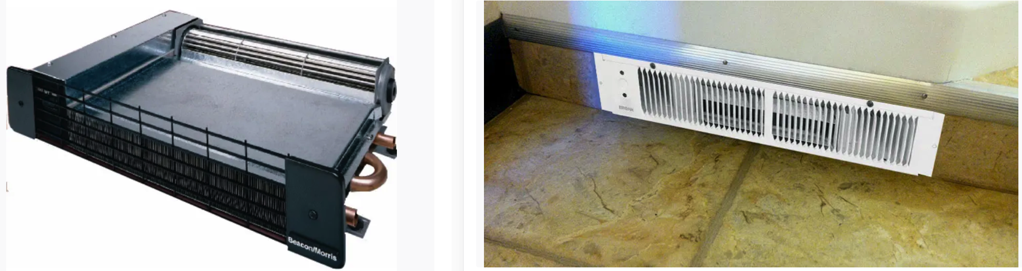

    Kick heaters are often used if the floor cannot cover the load. Of maybe it is a one, low temperature system and the kick adds some kick?
    If it is the fan type they are a bit noisy, suck and blow pet hair. Use them only when necessary.

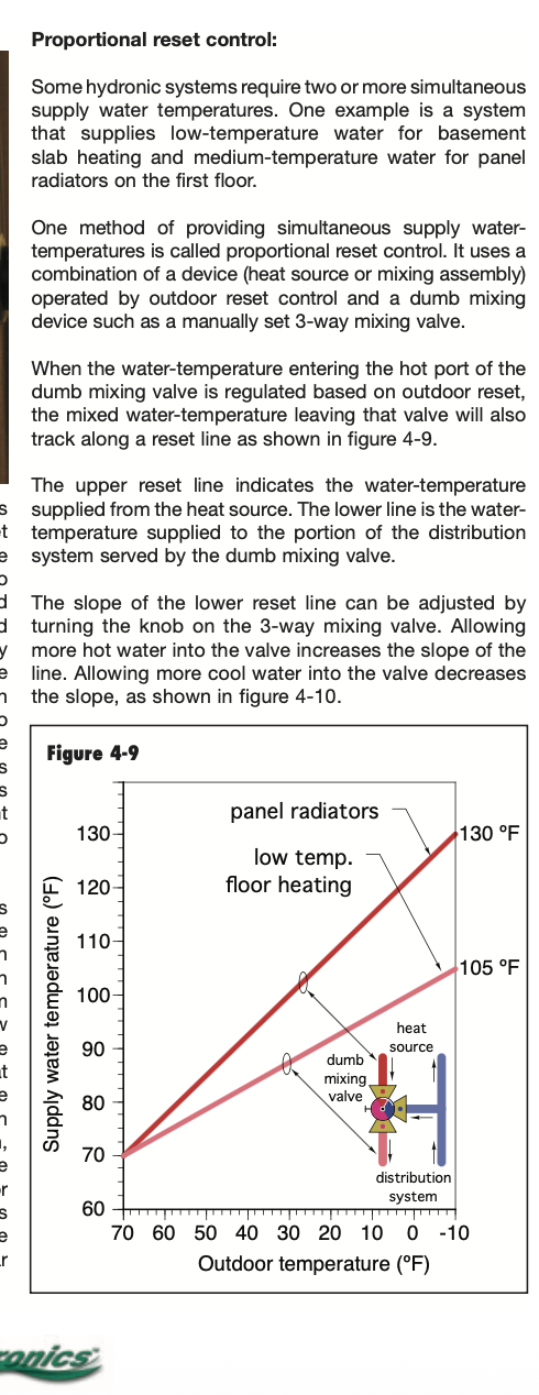

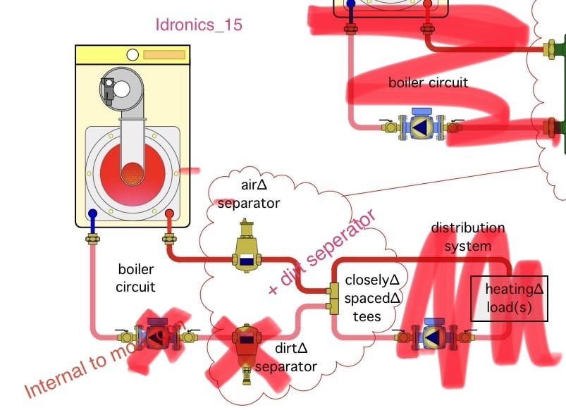

    An option I have used several times is proportional reset. From Idronics 7
    Run the boiler at the highest temperature required for the plates, lets say 130 on design day.
    Run the boiler on ODR.
    The low temperature zone is done with a manual 3 way mix valve. It tracks along with the boiler temperature.
    So set it at 100° on a design day for the slab zone. As the boiler temperature ramps down, so does the mix temperature.

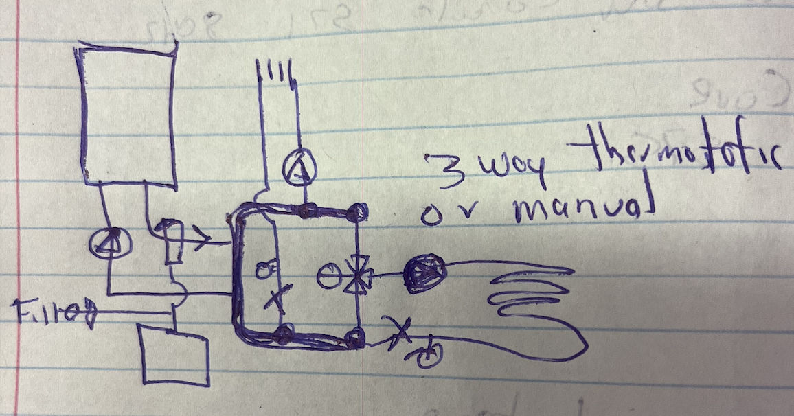

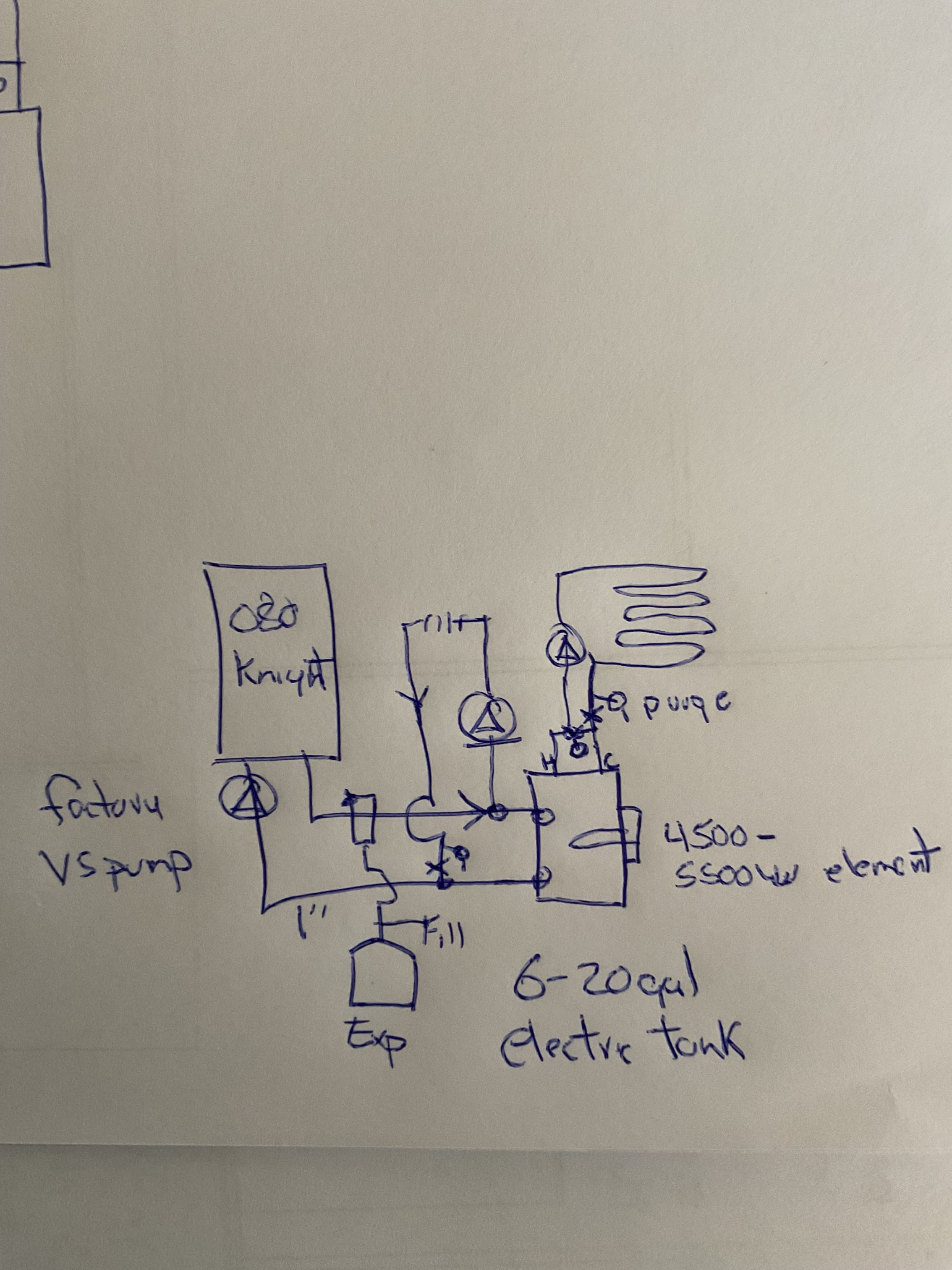

    Here is an examples.

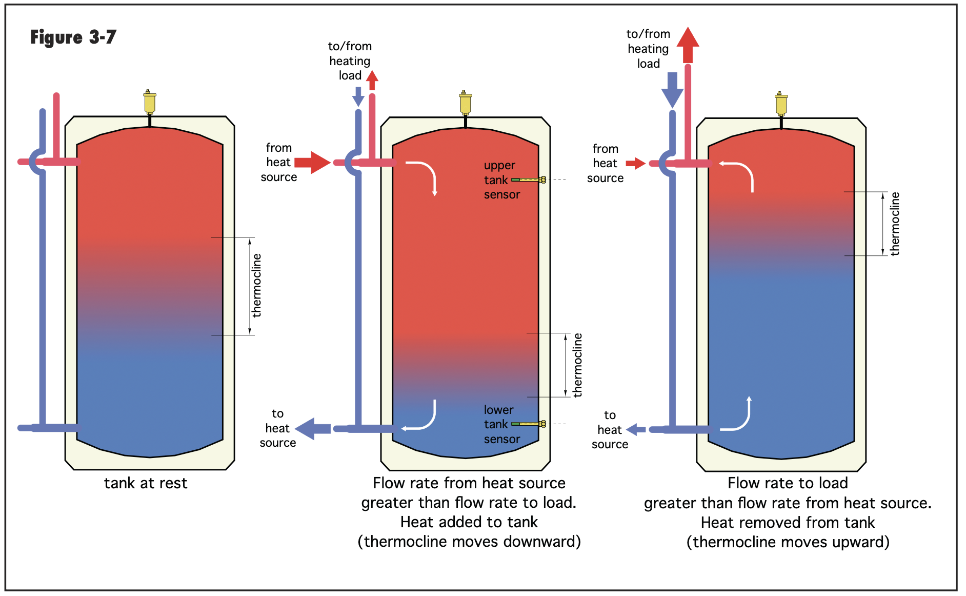

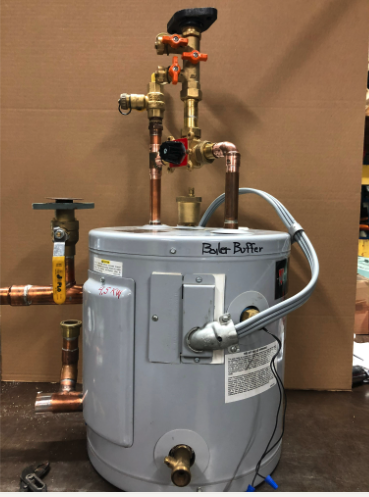

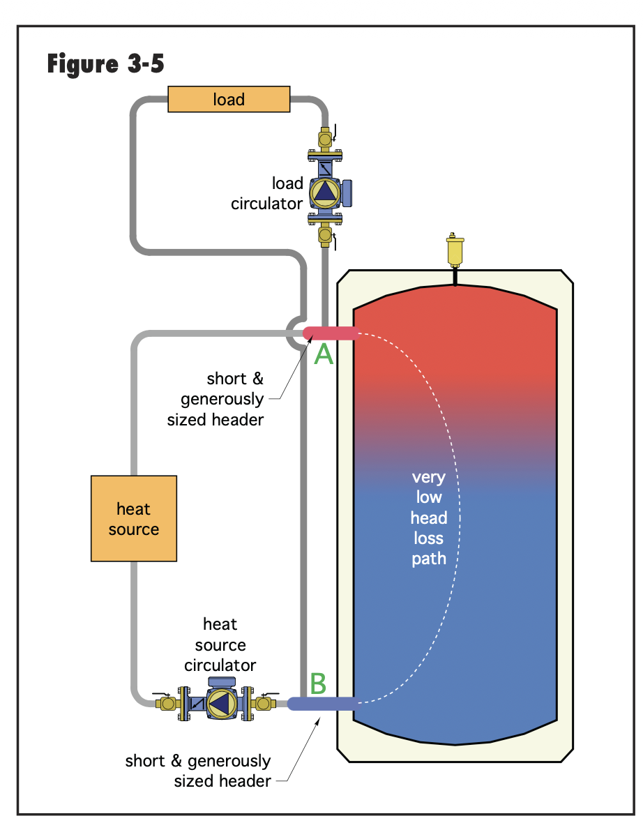

    If you have a buffer, better yet, it give you some capacity and a hydraulic separation.
    A small electric tank as a buffer.
    Boiler S&R on left. High temperature teed off that S&R as a 2 pipe buffer. 3 way mix valve on top.
    Boiler sensor in tank. The tank operates the boiler firing.
    A control and motor could be added to the 3 way for more temperature control, also.
    I also stuck a 4500 w element into it for 15, 300 back up (dual fuel) option. If the boiler fails, plug it into a 30A range receptacle

    Ed, Jamie, Bob, Yes, I am referring to this kick space heater; https://pexuniverse.com/beacon-morris-k42-kickspace-heater-twin-flo-iii?radiators&gad_source=1&gad_campaignid=23044661180&gbraid=0AAAAADM12gpQXJprUR5OhDbwCap2x37P5&gclid=EAIaIQobChMIj-3_pemTlgMVdERHAR2W_yMGEAQYAiABEgLTkvD_BwE . My reason for calling them a kick plate heater, is every time you see one on a job the plate is kicked in.There are two of these installed on the main level of the house.
    One is located in the bathroom on the south facing wall. It’s purpose? The wife wants it. is it needed probably not.  The one circuit of the under floor 1100 foot low mass zone , covered this area quite well.
    The second one is located in the Arctic entry, located in the north east corner. It’s purpose is mainly to dry off winter boots.

    The pic is a 6 gallon Lochinvar tank. I chose it because it had top and side connections. Most small tanks do as they are under counter use.
    It came with a 1500w element, 120v. It is a standard screw in element, you can get up to 5500w on a 240v 30a circuit 5500w = 17,270 btu/ hr.
    There are also 6000w elements but they tend to be too long for the small tanks.
    There are multiple ways to pipe a system like this, all have pros and cons. The manual 3 way is inexpensive and gives you ODR on both temperatures. It is limited to one zone however. Multiple loops are fine, on one zone. I used this system in two of my own places, so I know it works well.

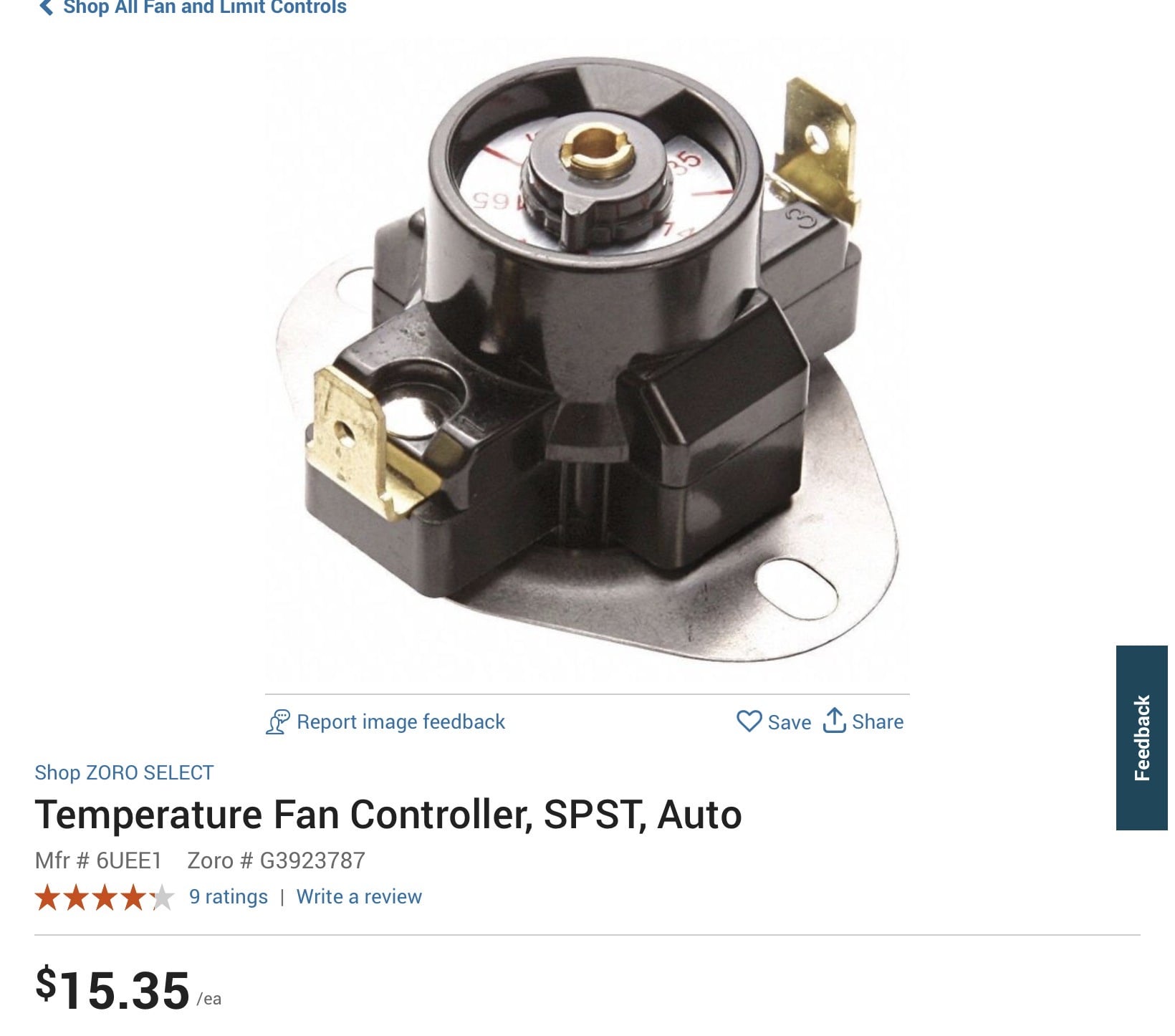

    Here is how I controlled kick space heaters on low radiant temperatures. This is adjustable down to 70f.
    Heat output will be limited at low SWT. But for a mud room or bath air movement, anything above 110-115 still feels warm. Just swap out the factory one that snaps on the heater piping.

    If you are looking at only 2 temperatures then you only need one Taco iSeries-R valve head. You can select the two port valve and use what I call the "injection method" to maintain the lower water temperature floor.
    The whole idea behind outdoor reset (ODR) is to provide the water temperature needed to match the building’s actual heat loss at any given outdoor temperature. As the outdoor temperature changes, the required supply-water temperature changes with it. Ideally, the boiler operates for longer cycles at the lowest practical water temperature while providing only the amount of heat the building needs.
    In a properly designed system, the thermostats should have very little work to do. They are still there to prevent overheating and compensate for things that outdoor reset cannot predict, such as solar gain, cooking, fireplaces, or a room full of people. The circulators can also be selected or controlled to provide only the flow required by the system, although outdoor reset itself does not reduce circulator electrical consumption unless variable-speed pumping or some other form of pump control is being used.
    With @hot_rod 's idea, you don't get the exact calculated water temperature for the lower-temperature zone, but you probably don't need to. This isn't rocket surgery. That's what thermostats are for. So, in your situation, I might be inclined to use the buffer tank and a simple “dumb” mixing valve.
    With the lower water temperature being supplied to the “kickplate” (LOL) heaters, you could easily control each one with a zone valve operated by its thermostat. The thermostat could call for the zone valve, and the zone-valve end switch could then operate the kickspace-heater fan directly.*
    You don't necessarily have to make those thermostats fire the boiler. You could allow the floor-heating system and buffer tank to control boiler operation and simply let the kickspace heaters use the heat that is available in the buffer tank.
    I would, however, add a temperature control or aquastat to the kickspace-heater fan circuit with a lower cut-in temperature and a smaller differential, so the fan cannot operate unless sufficiently warm water is actually available. Otherwise, sooner or later, somebody is going to get a blast of cold air and wonder who designed this crazy thing.
    Check the end-switch voltage and current ratings to be sure it can handle the 120-volt motor load. If you are using Taco 570 Series zone valves, you cannot switch 120 volts directly through the end switch because terminal #2 is common to both the end switch and the 24-volt motor circuit. In that case, an isolation relay is in order.

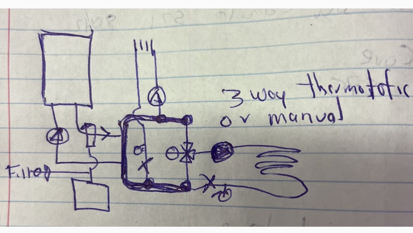

    Simpler yet, Harveys Horseshoe
    Boiler injects into u shape loop, high temp, and low temp via a 3 way thermostatic.
    If you zone the kickspace they would be your lowest load, but still a good match for a boiler that turns down to 8,000 BTU/ hr

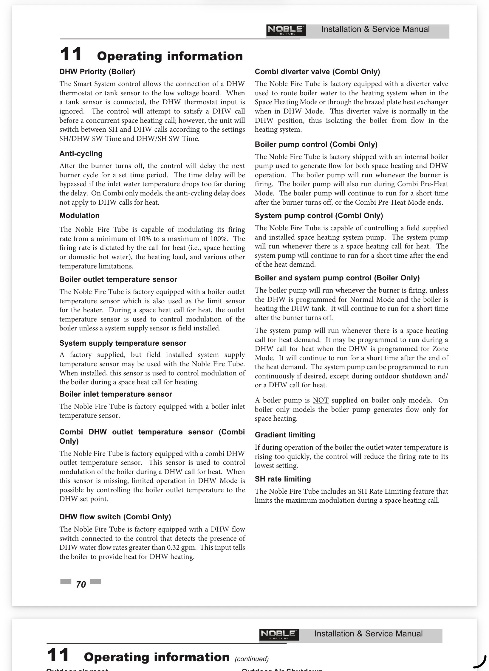

  •  Sorry for the delay. No access to a computer/Internet. Don’t know about you guys, but I can’t type on a phone!
    As both Bob and Ed have pointed out in the past a CO analyzer is required to set up a boiler. As I will only need this to set up and repair my installed equipment, will this device suffice? https://www.supplyhouse.com/UEi-Test-Instruments-C161-C161-Flue-Gas-Combustion-Analyzer
    After reviewing installation videos, it suggest  the Burnham Alta 080, CO calibration is performed in its onboard software. But the actual installation instructions do suggest a manual calibration.Whereas the Lochinvar WHB085N, requires manual CO calibration additional two dual port manometer. I will be purchasing a manometer for whole house make up air.

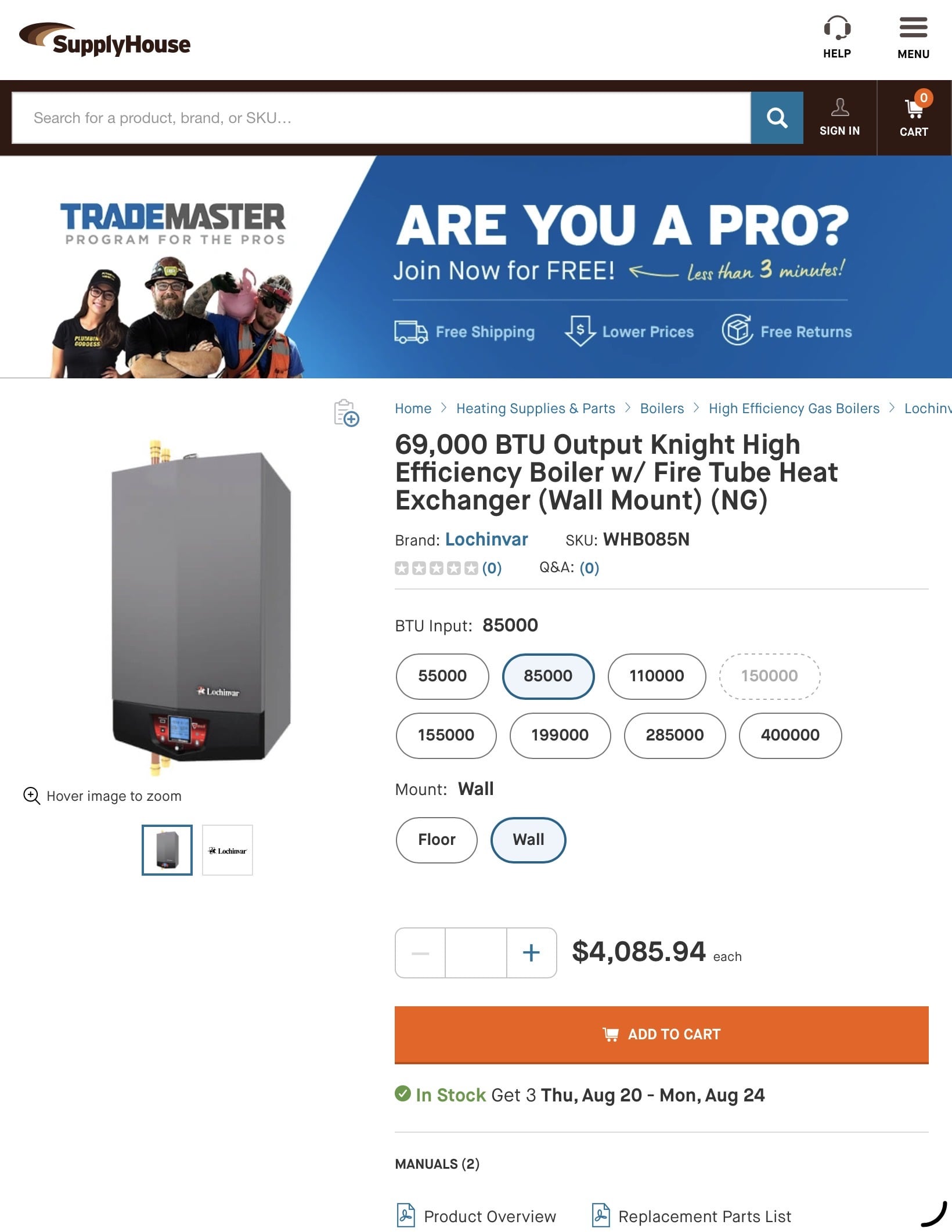

    I am struggling to determine if the Lochinvar WHB085N’s will surpass the Alta 080 in lifespan and reliability. It is about $1500 more expensive.

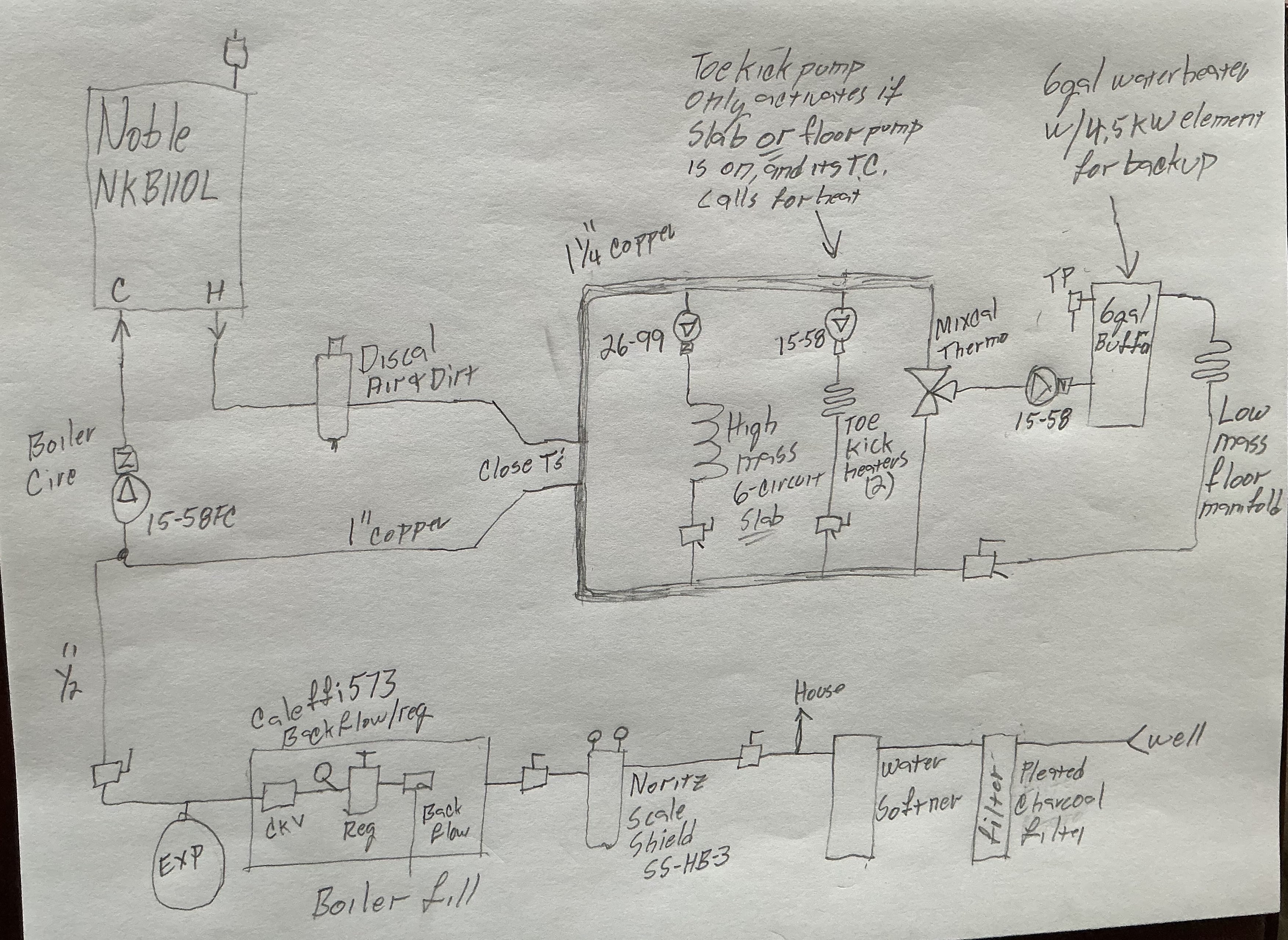

    Ed, after more research, I do think the Taco I-series is a superior alternative to a dumb three-way valve, and worth the investment. You make an excellent point with this statement: “Otherwise, sooner or later, somebody is going to get a blast of cold air and wonder who designed this crazy thing.”

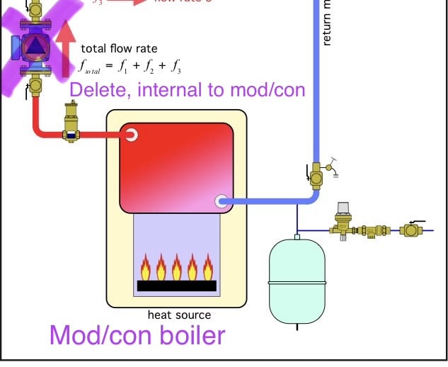

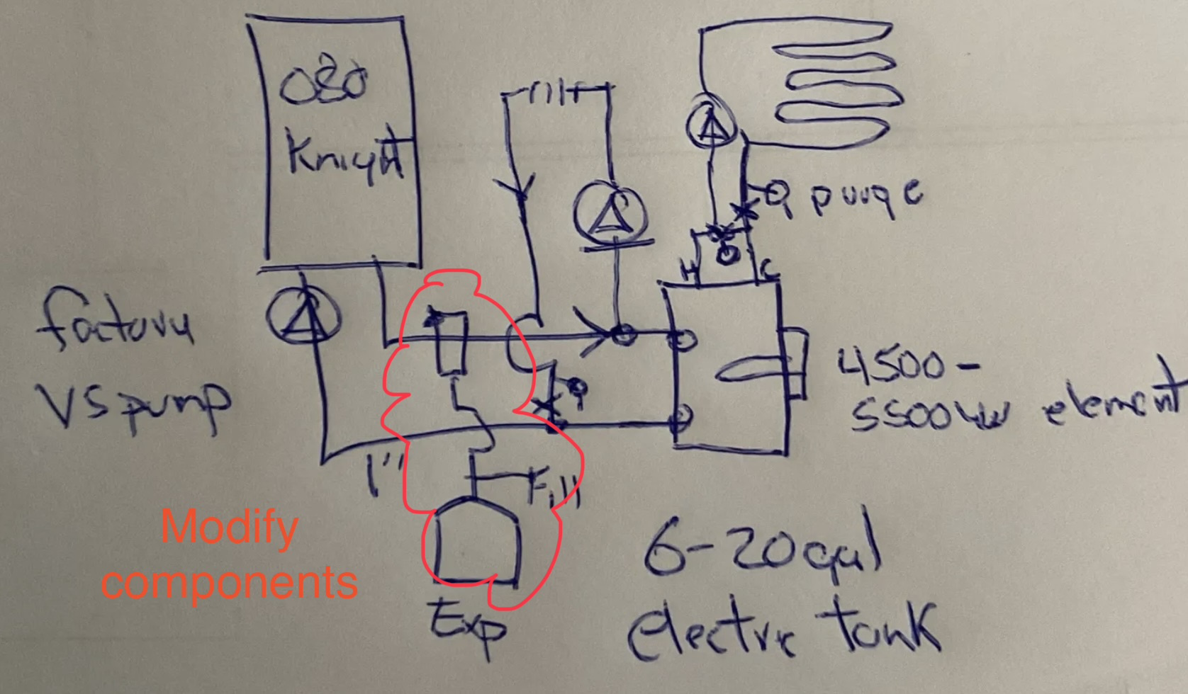

    your sketch:
     Appears in my mind, functionally similar (plus the smart valve) to Bob’s:
    This will be the configuration I plan to use, with the modifications I outlined below. I may still add a electric hot water, buffer tank.  I’ll sketch my planned system after you guys critique my comments.I currently have this air/magnetic dirt separator in my slab heater:
    I was hoping to use it in this configuration:

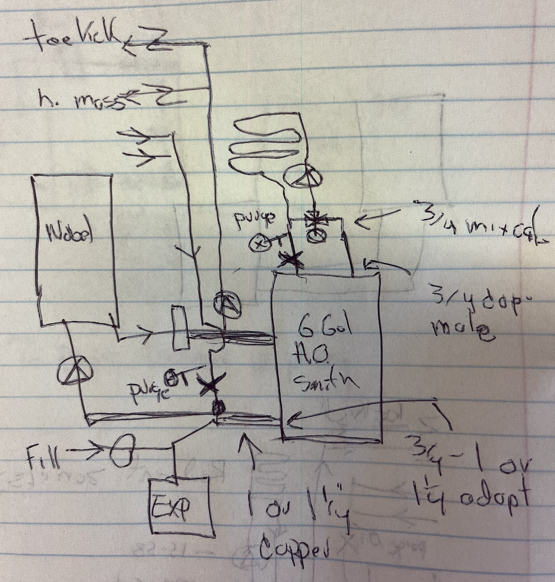

     In one of the “coffee with caleffi” videos, there was some confusion as to where to install it in the loop. What is the best practice in my application?
     For my fill/make up water I planned on this configuration:
     Does it really matter if you’re on the hot or cold side of the boiler? How does that affect the internal pump on a mod con, with best practice to push away from the expansion tank?
    Does this sketch contradict pump expansion tank placement?
    I really appreciate your years of talent and experience in assisting me setting up my system. Sorry for the long post, but that’s what happens when I think too much. Greg

    The Taco iSeries-R valve is pricey. I believe it is a little overkill for your small system. My own radiant-floor system, and others that I have installed for customers, all used the “dumb” mixing valve, and I believe that the idea @hot_rod alluded to will serve you just fine for less cost.
    Untitled Image
    That two temperature line shown in figure 4-9 ( and 4-10 if you happen to look up the article ) will be as accurate as you need it to be. It will just take some fine tuning/trial and error. The Valve actuator on the Taco valve will be less trial and error, but you will still need to make fine tuning adjustments for the first season and perhaps the second season.
    I would not spend the $$$ on the valve unless I found the dumb mixing valve to be too problematic. Truth be told, you may not even need two temperatures with those two different floors. I used the same temperature for a slab floor and a staple up system in a home I lived in for several years and was happy with the wall thermostat being the only control for each zone, while the ODR from the boiler did the temperature adjusting based on the weather. I thought the staple up was lagging behind most of the time, but that was just me being over-sensitive to the workings of my design.
    If I still lived there I may have tried the Taco iSeries-R to see if it made a difference, but alas, I never got the chance.
    hot_rodRoxieolddogcatPC7060
  • Well, then, I guess I’m getting the dumb valve. The smart valve would be an easy add-on. I’ll just put my money towards the Lochinvar Knight 08xx. There seems to be a whole lot of videos geared towards the install and maintenance of the Lochinvar Knight.

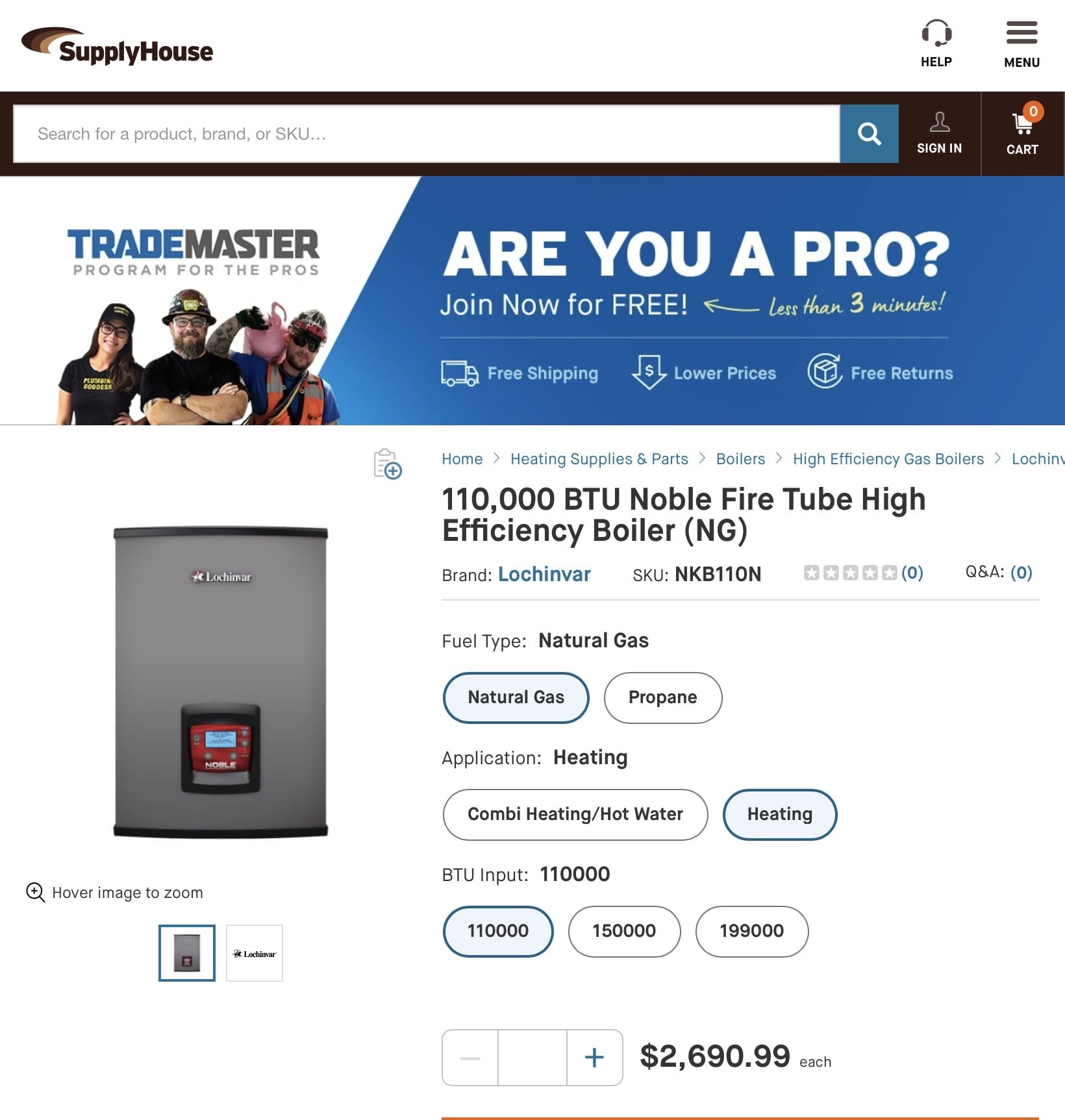

    The Lochinvar Nobel is a price point mod con. Smaller HX, less control function. Still plenty of features for what you need. It would be a 110,000.
  • OK Bob, you found my favorite long-term supplier! and I see they don’t supply the Noble in a 80 K range. They do, however, sell the 110 pre-configured for LP gas! Is the 110 a bit oversized for my application? Looks like it’s maximum turn down should be 11,000 BTU. Would this require me to have a 10 gallon or so buffer tank on the low mess floor radiant circuit?

    The 110 a little bit larger than what you need. The control has some nice features, you can limit the firing rate to say 68,000. It has an anti cycling function also, and gradient limiting. All these can be set up to limit excessive cycling.
    You still want to have some sort of hydraulic separation.
    This could be primary secondary piping, a hydraulic separators or a buffer tank.
    The cost difference between a separator and a small buffer is not that great. If you want the electric back up, which could be tied to a PV grid someday, for some additional RE input, then use a small electric tank s a buffer

    I’ve been working on a component sketch with your suggestions. Will post when I get back in town. I like the idea of a electric 6 gallon buffer tank. I’m planning on having the low mass floor and the toekick heaters running through the buffer tank through closely space T’s, based on some of the Caleffi setups.

    I plan on using the Lovinvar noble 110 propane mod/con boiler. Some of the components I already have. They were used with a tankless water heater to provide temporary heat to the slab last winter. I believe I’m following your “Harvey’s Horseshoe” layout.
    For the buffer tank, this AO smith 6 gallon water heater unit is standard single cold in, hot out, with 3/4” inch nipples. I believe this restricts the location to being used just for the low mass radiant floor heating. although I don’t know if this is the best location. Should the boiler fail, the water heater can act as a temporary heater.
    The low mass floor heat is 6 circuits totaling 1100 feet of PEX A,attached with aluminum reflector plates, between the Joist cavities,under 3/4” advantec subfloor plywood. Above the plywood is laminate flooring.The joist cavities will be insulated at a later date.
    Since the toe kick heaters are such a low btu load, their circulating pump will only be active when the basement slab pump or the floor pump is active, and only if there thermostat calls for heat. This is simple to achieve with a couple DPDT relays. Their 120° thermostat was replaced by the adjustable fan thermostat suggested above. other suggestions?
    I think the nortiz scale shield, is similar to most deionized filter filters. If you know of a better unit, let me know.
    Thanks, Greg

    It is a bit more complicated than need be. Since you are spending the time and % let the whole system leverage the buffer, not just the mixed down zone.
    Take the 6 gallon tank and remove those heat trapper nipples in the side ports. They all have flapper checks that restrict flow.

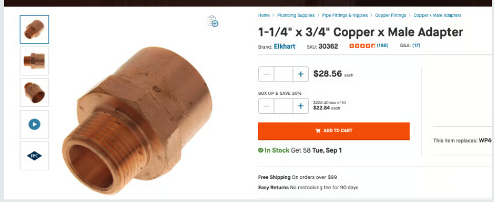

    For the boiler connection into those side taps, get two - 3/4 mip X 1 or 1-1/4 copper. sweat press, whatever.
    Screenshot 2026-08-26 at 2.05.07 PM.png Screenshot 2026-08-26 at 2.06.47 PM.png
    Now you have the increase and the LLH built. It is that piping right at the tank that becomes the "closely spaced tees"
    The high temperature zones take off that 1 or 1-1/4 " piping at the tank.
    Personally I would use one pump, two zone valves. Why the 29-99??
    So these two zones run at whatever the boiler operates at, ODR controlled ideally.
    The low temperature mix valve is fine with the 3/4 connections on the top, two - 3/4 mipX sweat adapters, screwed right into the tank.
    This low temp zone always runs at the mix valve temperature, regardless where the boiler or tank is set. Assuming the boiler is hotter than the mix valve setting :)
    Really no reason to use any 1-1/4 for the flow that boiler needs. But no harm if you want to spend the bucks.
    That small short reduction into the tank, just presents a small velocity increase in that section, it works just fine. Much the same as a reduced port ball valve.
    Screenshot 2026-08-26 at 2.01.27 PM.png Screenshot 2026-08-26 at 2.26.44 PM.png

    hot_rod Posts: 28,529
    That section of piping right at the tank is the hydraulic serparation. So increasing the size allows adequate flow for the multiple pumps. With your load numbers (gpm needed) 1 inch will work. Better yet increase the tank to 1-1/4" just for 12" of so where the multiple pumps connect. So a 3/4 male X 1-1/4" copper adapter.
    Idronics 17 goes into more detail.
    You will want check valves in the pumps, one in the boiler loop also.
    All the 6 gallon tanks I have bought have side and top taps, as they are designed for under counter installation options.
    Screenshot 2026-08-28 at 10.36.35 AM.png Screenshot 2026-08-28 at 10.37.22 AM.png

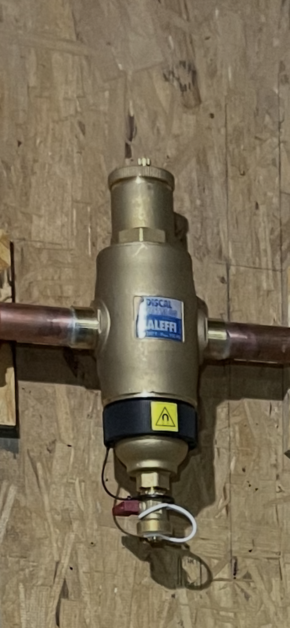

    I wouldn't hook my boiler system to a softened water feed line. look into installing a glycol feeder instead, and fill it with a controlled boiler fluid like DI water or a premix ready to use glycol blend if you are using glycol
