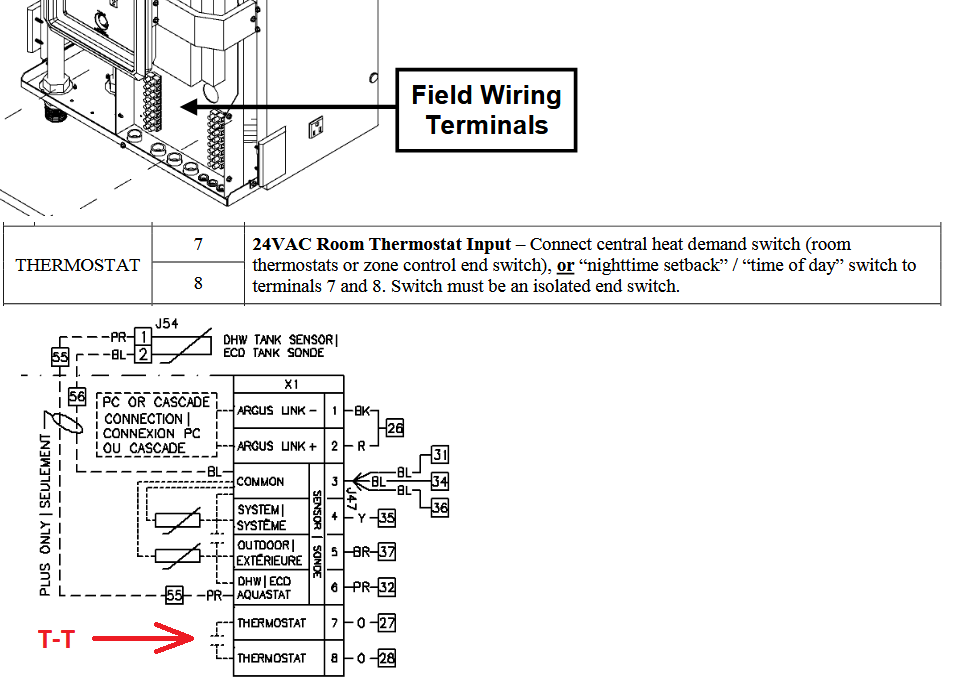

I've been looking through the honeywell HZ322 and HZ432 Schematics and I'm a bit confused… The unit is a NTI VM110 and does not have a fan center…

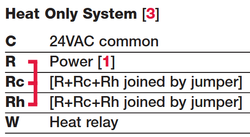

    the honeywell is labeled for force air, you need to translate from zone damper to zone valve.
    the fan center is t-t or x-x on your boiler, you only need w and r, g and y are for ac.
    you could also drive the heat call at the boiler off of the paralleled end switches instead of off of the wireless t-stat receiver/zone controller.

    Wire 24 volts (available on the control) to "C" and "R", "Rh" and "W" to T-T on the pump or zone valve control.

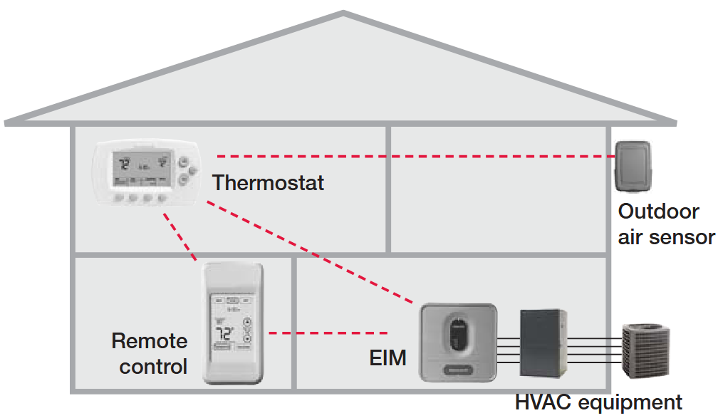

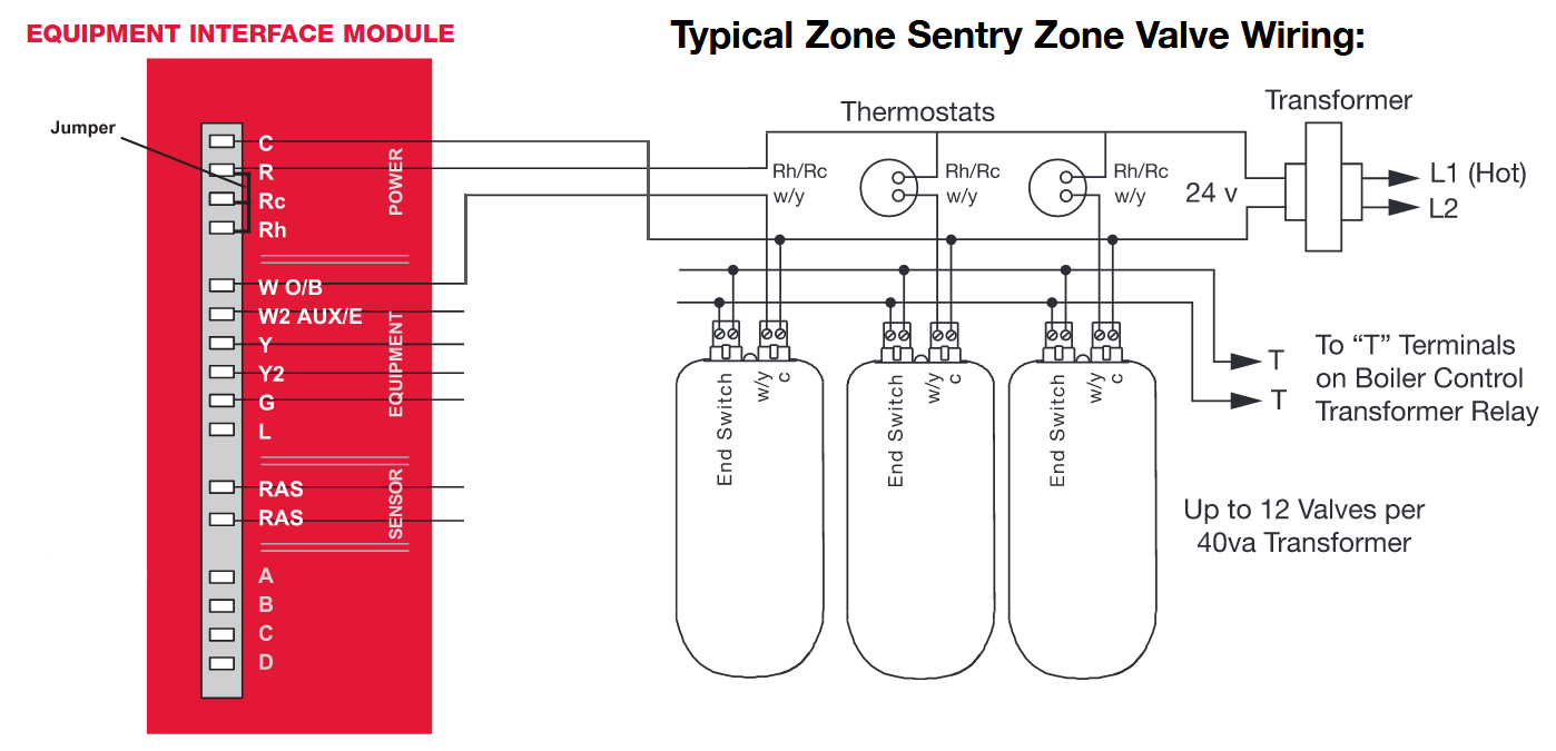

    Using the RedLINK Wireless FocusPro Programmable Thermostat Kit, YTH6320R1001 with the THM5320R EIM

    Can you tell me which wireless thermostat you already have? You showed a RedLINK wireless thermostat in your original post. Is that the thermostat you currently have?
    Can you take a picture of the thermostat and the subbase attached to the wall? Is there a model number on the thermostat?
    You also referenced Honeywell HZ322 and HZ432 schematics in your original post. Which components do you already have? Do you have the actual zone panel, the thermostat interface, and the thermostats? As I understand it, you need all three components for each wireless thermostat.

    I have worked with the HZ322 panels before, however I have never worked with the wireless thermostats, so this may not be accurate. This is the best guess for your situation if in fact you have the following components
    1. Two RedLink thermostats
    2. One HZ322 Panel
    3. One wireless interface THM4000R
    4. NTI Boiler
    • Upper Left is the HZ322 panel. (over-kill but workable)
    • Upper Right. Taco Zone Sentry Valves. End switch to the NTI boiler
    • Lower Right. NTI boiler. The end switch of the zone valve will connect to 7 & 8 on the boiler control panel
    • Lower Left. Add the wireless thermostats per the instructions
    If this does not work for you then we can look at other options. But I believe this is a good start based on what you have on hand.

    If you have not purchased anything yet two of @EBEBRATT-Ed's Braeburn 8500 (or the like) solution and a 120 to 24 VAC transformer may be the best cost effective method, the wiring is similar to what was posted above. You really don't need a zone valve controller but they do provide some nice features.

    If you have already purchased the components and connected wires to them, you probably cannot return them. That said, my four-part diagram above will work for your situation. You can use the modifications that @109A_5 suggested .
    Connect the zone-valve motor to M1 and M4, or to C and M4.
    I find that many terminals used to connect the various loads to the transformer’s C terminal are internally connected through the printed circuit board. Therefore, M1 and C on each zone may all be connected together and also connected to C on the 24 VAC transformer. kind of like this:
