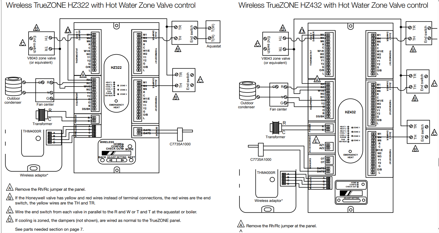

Hello,
I'm trying to find what set up to use for setting up wireless thermostats (2) to some sort of interface that would hook up to my 2 Taco Zone sentry's. There is no easy way of pulling wire or I would just do that.

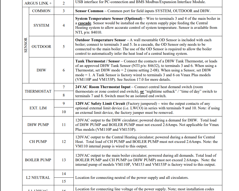

I've been looking through the honeywell HZ322 and HZ432 Schematics and I'm a bit confused… The unit is a NTI VM110 and does not have a fan center…
I called Honeywell the support was a bust…
I called Taco tech support for any recommendations and there was no clear answer.
Any suggestions would be extremely helpful, I have been down this rabbit hole on and off the last few days with no avail.
Thanks in advance

    the honeywell is labeled for force air, you need to translate from zone damper to zone valve.
    the fan center is t-t or x-x on your boiler, you only need w and r, g and y are for ac.
    you could also drive the heat call at the boiler off of the paralleled end switches instead of off of the wireless t-stat receiver/zone controller.

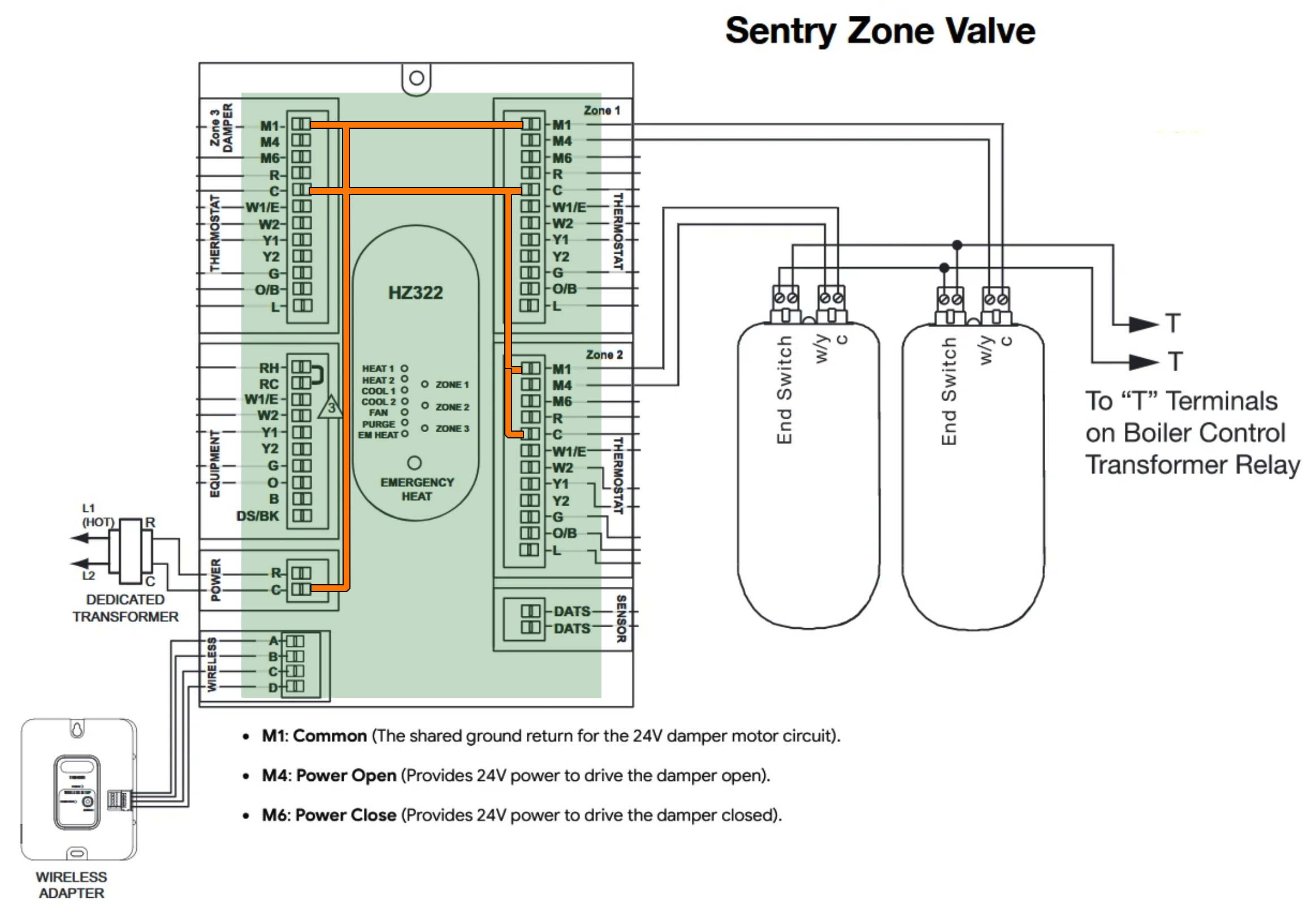

    I have worked with the HZ322 panels before, however I have never worked with the wireless thermostats, so this may not be accurate. This is the best guess for your situation if in fact you have the following components
    1. Two RedLink thermostats
    2. One HZ322 Panel
    3. One wireless interface THM4000R
    4. NTI Boiler
    • Upper Left is the HZ322 panel. (over-kill but workable)
    • Upper Right. Taco Zone Sentry Valves. End switch to the NTI boiler
    • Lower Right. NTI boiler. The end switch of the zone valve will connect to 7 & 8 on the boiler control panel
    • Lower Left. Add the wireless thermostats per the instructions
    If this does not work for you then we can look at other options. But I believe this is a good start based on what you have on hand.

    Similar to @EdTheHeaterMan solution. IMO Honeywell documentation can be a bit pathetic.

    If you have already purchased the components and connected wires to them, you probably cannot return them. That said, my four-part diagram above will work for your situation. You can use the modifications that @109A_5 suggested .
    Connect the zone-valve motor to M1 and M4, or to C and M4.
    I find that many terminals used to connect the various loads to the transformer’s C terminal are internally connected through the printed circuit board. Therefore, M1 and C on each zone may all be connected together and also connected to C on the 24 VAC transformer. kind of like this:
    This is not an exact representation of the printed circuit connecting the transformer’s C terminal to all of the common terminals. It is simply an illustration intended to clarify the statement.
