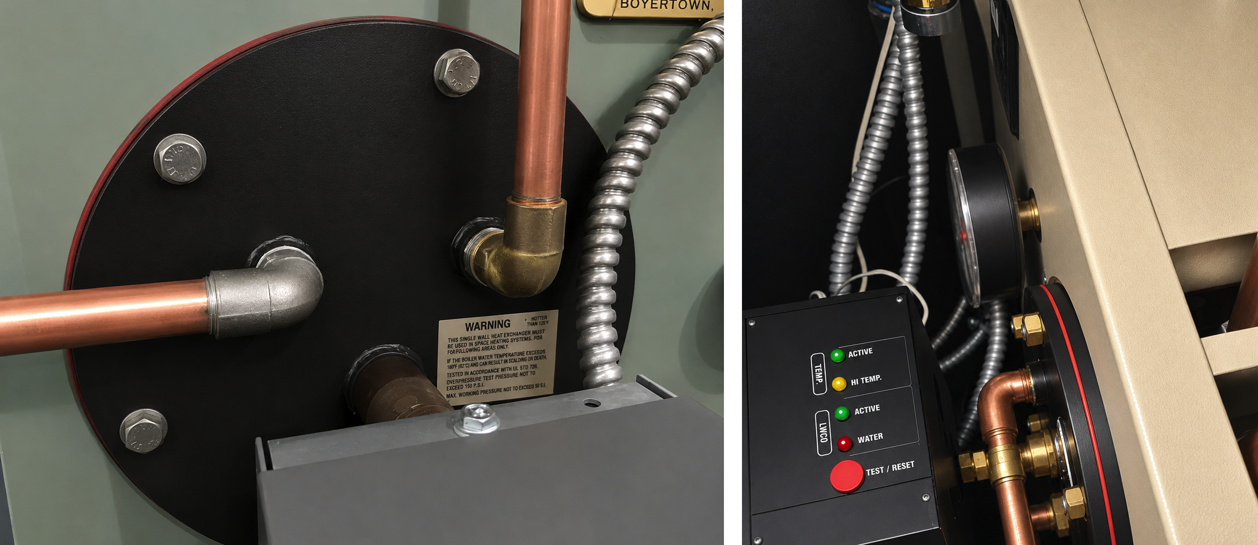

GotGot called and for another problem on this boiler. But noticed the evidence of leaking from the coil area. I was initially thinking that someone just didn't do the follow-up tightening, all these bolts seem to be tight. But looking at it it looks like the gaskets not installed but I can't imagine that water wouldn't be spraying out everywhere if the gasket wasn't installed. What do you think?
The nuts are tight.
That wouldn't surprise me. as you can see from the PEX they took a lot of short cuts. There are no isolation valves at all to do any supply side work I have to secure the house supply…
tighten the bolts?
like i said "The nuts are tight."
There should be some sort of gasket there, although it might be thin. Sort of off topic, but did they even use the correct bolts? I've always liked to have three threads visible — but that is automotive and aircraft, so maybe it's OK here?
I’m not a fan of that installer. Whoever connected the flexible tubing directly to a 90° adapter, without providing any practical way to service the coil, did a very poor job.
I doubt there is even a mixing valve of any type installed on that tankless coil. If you want to do right by the customer, you may want to show them the manufacturer’s instructions for connecting the domestic hot-water piping. You could then quote a price for replacing the gasket and reconnecting the piping properly, including the installation of a mixing valve.

Here are the photos of 2 boilers with a visible red rubber gasket. the factory often uses a black rubber gasket that is a little thinner.
I like it when the copper piping is connected directly to the tankless coil, with enough support for the mixing valve.
The problem I have with using a 90° male-to-copper adapter is that you may not be able to tighten the threads sufficiently while still having the copper leave the coil in the desired direction. That often leads to leakage at the threaded joint. It may not produce visible water droplets because the water evaporates, leaving behind a crusty mineral buildup.
You may need to use plenty of pipe dope and Teflon tape, and perhaps even some lampwick, to seal the joint while positioning the pipe in the proper direction. After you place the service valves and mixing valve in the proper orientation, you can connect flexible hot and cold water tubing away from the boiler.

Yes, It was pretty much a hack job. There is a mixing valve but its hanging on pex and no isolation valves.
so redo it properly
Yes, that's the plan. She's got a handful of problems in that basement and I'm taking care of them in order of seriousness and under the constraints of her budget.
Update,
TheThe homeowner agreed to me replacing the gasket and repiping the system correctly. And does anyone know why the replacement gasket is $91. It's a 7-in round gasket with a big hole in the middle and six bolt holes I can't imagine what they're making it out of to make it worth $91.

TFI does not sell direct to the consumer. You must buy from a wholesale supply of some kind. the part number is "GOW gasket" or "DHTGOW Gasket" TFI and or Everhot are brands of Diversified Heat Transfer. That gasket needs to be special ordered. To save on shipping you can have the supply company do a Drop Ship direct to your address. It should fit in a large envelope and go USPS
OR
You can always just grab a blank piece of gasket material and make one yourself with this stuff: Red Rubber Gasket
I have sucessfully done that more than once. Cuts easily woth large scissors. To make a hole for the bolt you can use a piece of 3/8" OD or 1/2" OD copper pipe and a hammer.
