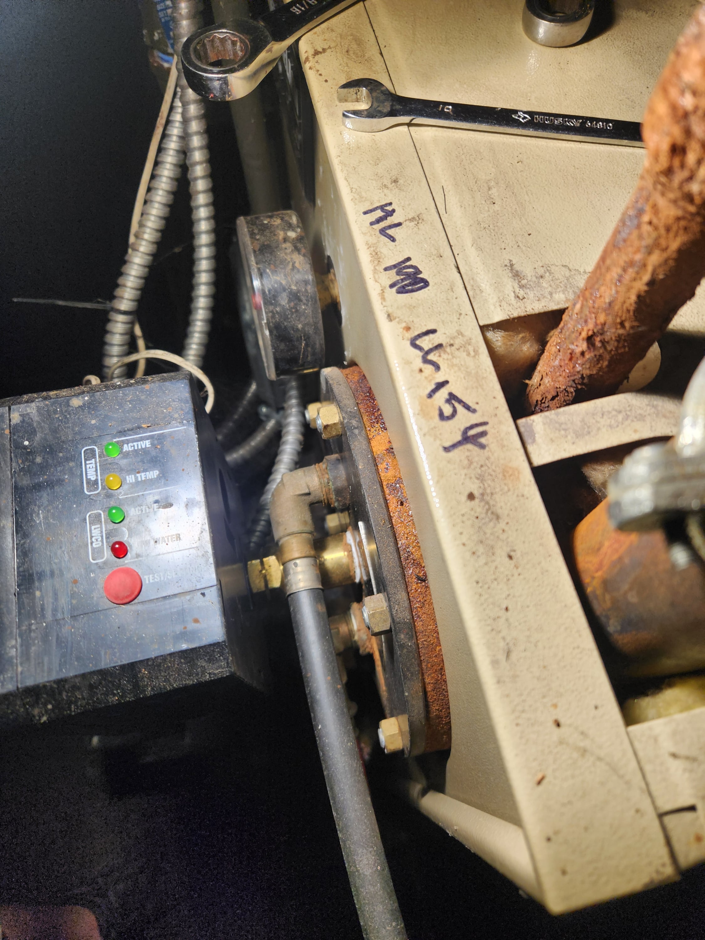

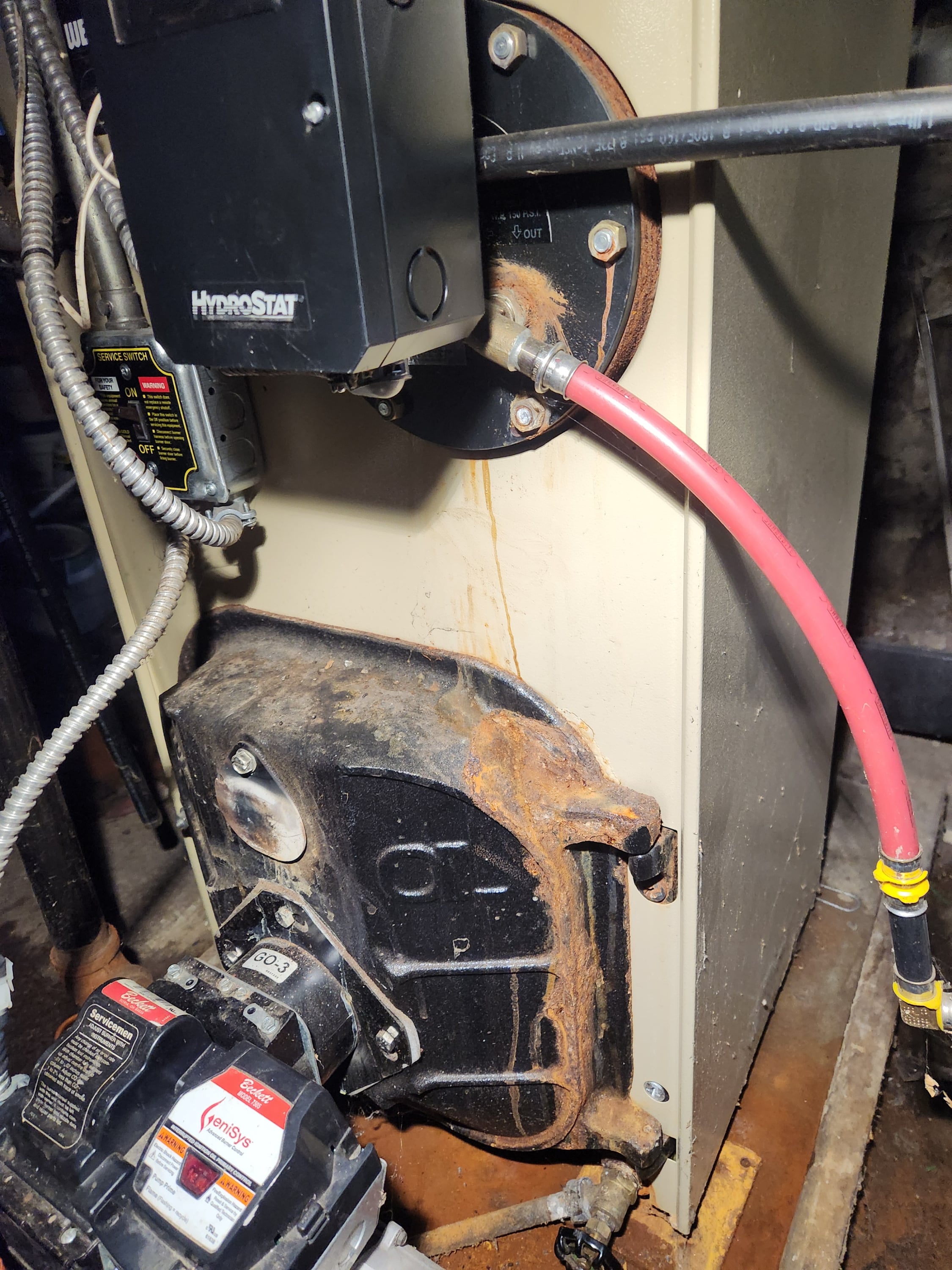

GotGot called and for another problem on this boiler. But noticed the evidence of leaking from the coil area. I was initially thinking that someone just didn't do the follow-up tightening, all these bolts seem to be tight. But looking at it it looks like the gaskets not installed but I can't imagine that water wouldn't be spraying out everywhere if the gasket wasn't installed. What do you think?
The nuts are tight.
    someone might have made their own gasket such that it doesn't stick out or used permatex or gasket shellac.

    That wouldn't surprise me. as you can see from the PEX they took a lot of short cuts. There are no isolation valves at all to do any supply side work I have to secure the house supply…
    pecmsg Posts: 7,634
    tighten the bolts?
    There should be some sort of gasket there, although it might be thin. Sort of off topic, but did they even use the correct bolts? I've always liked to have three threads visible — but that is automotive and aircraft, so maybe it's OK here?

    There is only one way to find out. Hopefully the face of the boiler casting is not damaged.

    I’m not a fan of that installer. Whoever connected the flexible tubing directly to a 90° adapter, without providing any practical way to service the coil, did a very poor job.
    I doubt there is even a mixing valve of any type installed on that tankless coil. If you want to do right by the customer, you may want to show them the manufacturer’s instructions for connecting the domestic hot-water piping. You could then quote a price for replacing the gasket and reconnecting the piping properly, including the installation of a mixing valve.

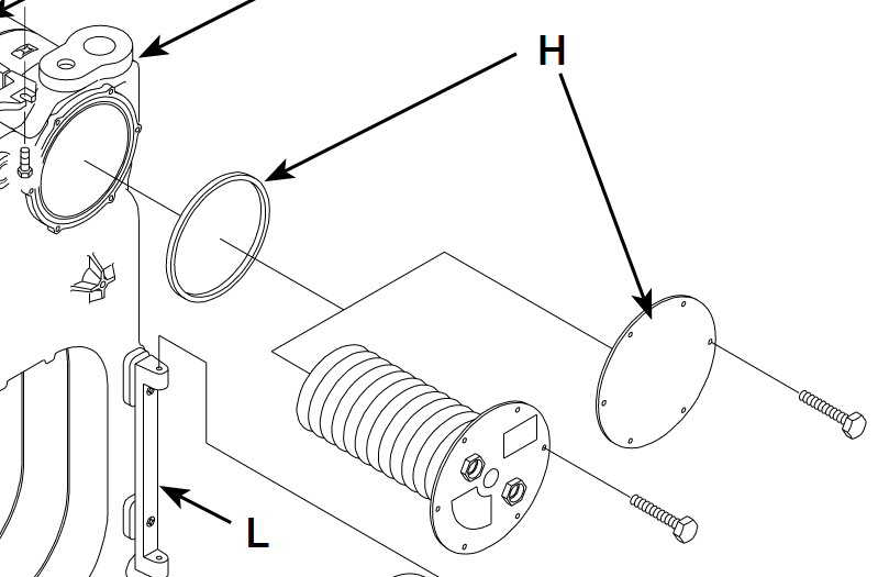

    This is from the instruction manual regarding how to connect the potable water piping. I have added some valves in color and also painted the mixing valve green in order to understand and see it easier. That part is not included with the boiler and must be purchased separately, and installed as indicated in the instruction manual.
    This information is on page 23 of this manual: Weil McLain WTGO boiler.
    Here are the photos of 2 boilers with a visible red rubber gasket. the factory often uses a black rubber gasket that is a little thinner.

    Then remove everything, clean the faces, install new gasket. Tighten a few times over several days weeks.
    Neverseize helps

    Yes, It was pretty much a hack job. There is a mixing valve but its hanging on pex and no isolation valves.
    pecmsg Posts: 7,634
    so redo it properly
  • Robert_H
    Robert_H Posts: 377
    Yes, that's the plan. She's got a handful of problems in that basement and I'm taking care of them in order of seriousness and under the constraints of her budget.
