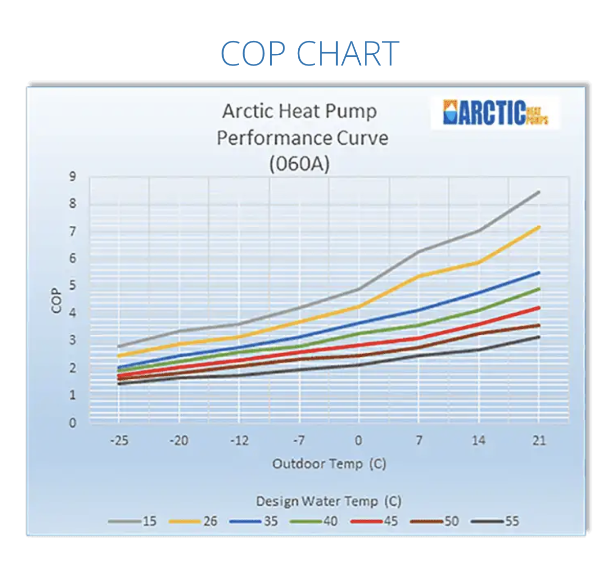

  • DCContrarian
    DCContrarian Member Posts: 1,488
    @hot_rod : "Data is available from manufacturers and independent testing on efficiency drop as outdoor temperatures drop. No guessing required. Same with performance at higher operating temperatures."
    Ironically, Arctic, who started this thread, does not make that information freely available on their website.
    hot_rod Member Posts: 27,782
    mattmia2 Member Posts: 17,351
    do you use that 15 c water to feed another heat pump?
