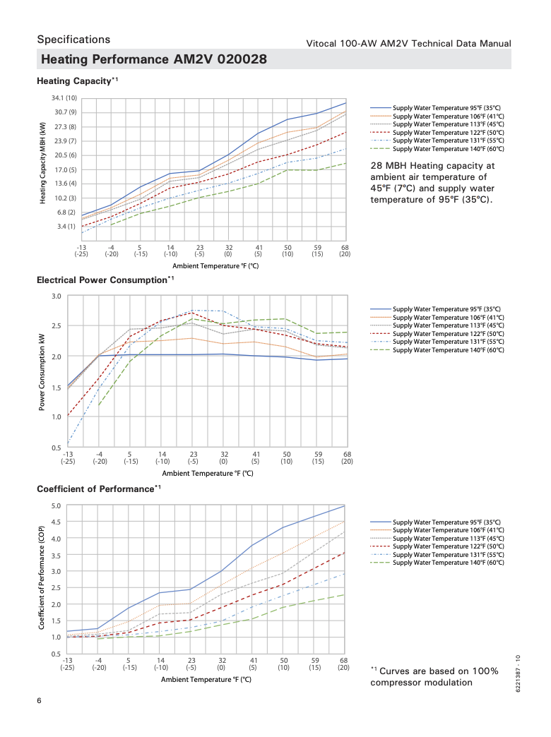

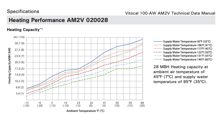

    hot_rod Posts: 28,699
    An example for the Viessmann

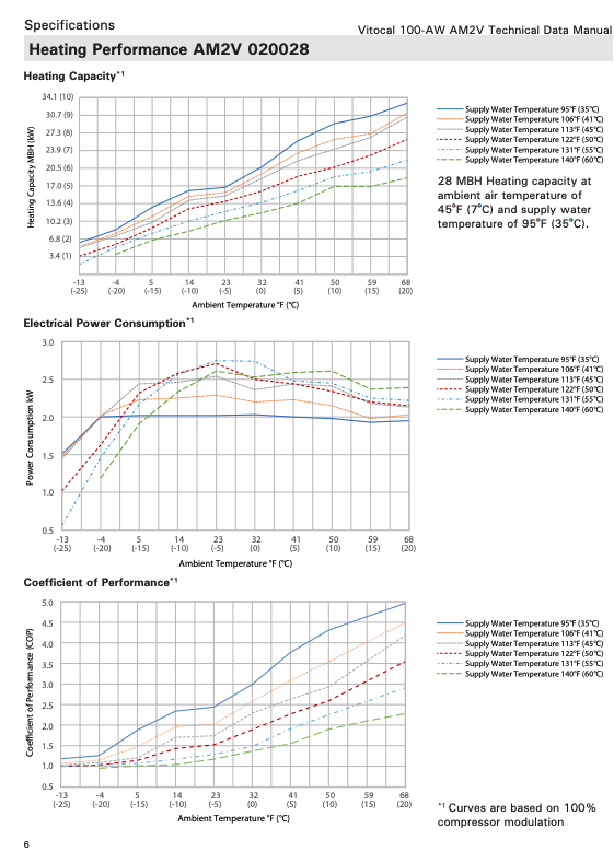

    The performance graphs are available for most brands. 120 and below is a good range to operate. Better yet a radiant floor with 100° SWT
    You take a capacity and efficiency hit as it gets colder outside. ODR helps keep the temperatures as low as possible. A small % of the year you will be at design condition.
    This is the Viessmann unit I have, 115 is the high SWT. ODR ramps it down from there.
    Screenshot 2026-10-08 at 11.11.07 AM.png Screenshot 2026-10-08 at 1.08.36 PM.png

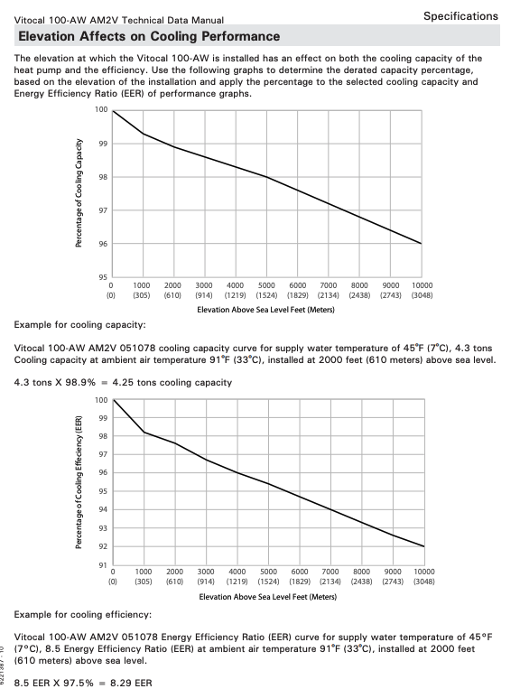

    Altitude takes a bite on the cooling side also.

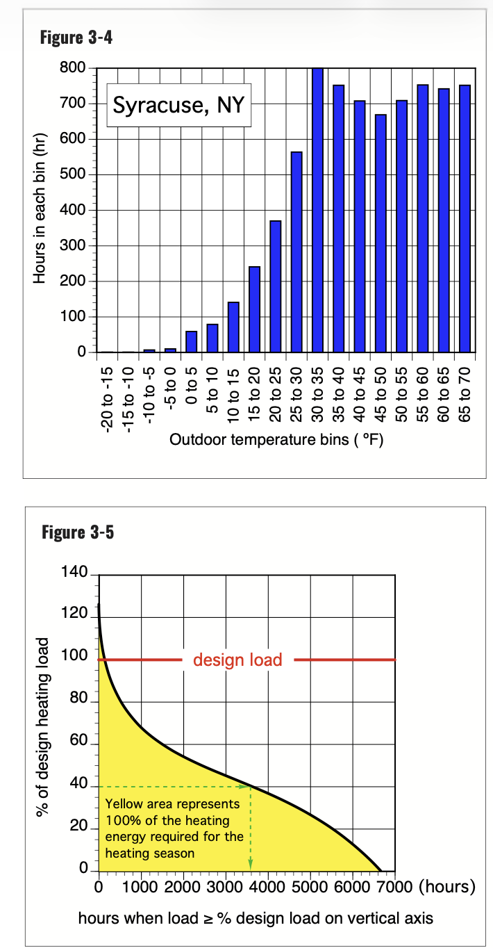

    You can find or compile data like this to see % of the year at various tempersture. Syracuse, NY spends less that 100 hours at 5°
    I think the Mitsubschi Ecoden has a bit better numbers compared to this Viessmann.
