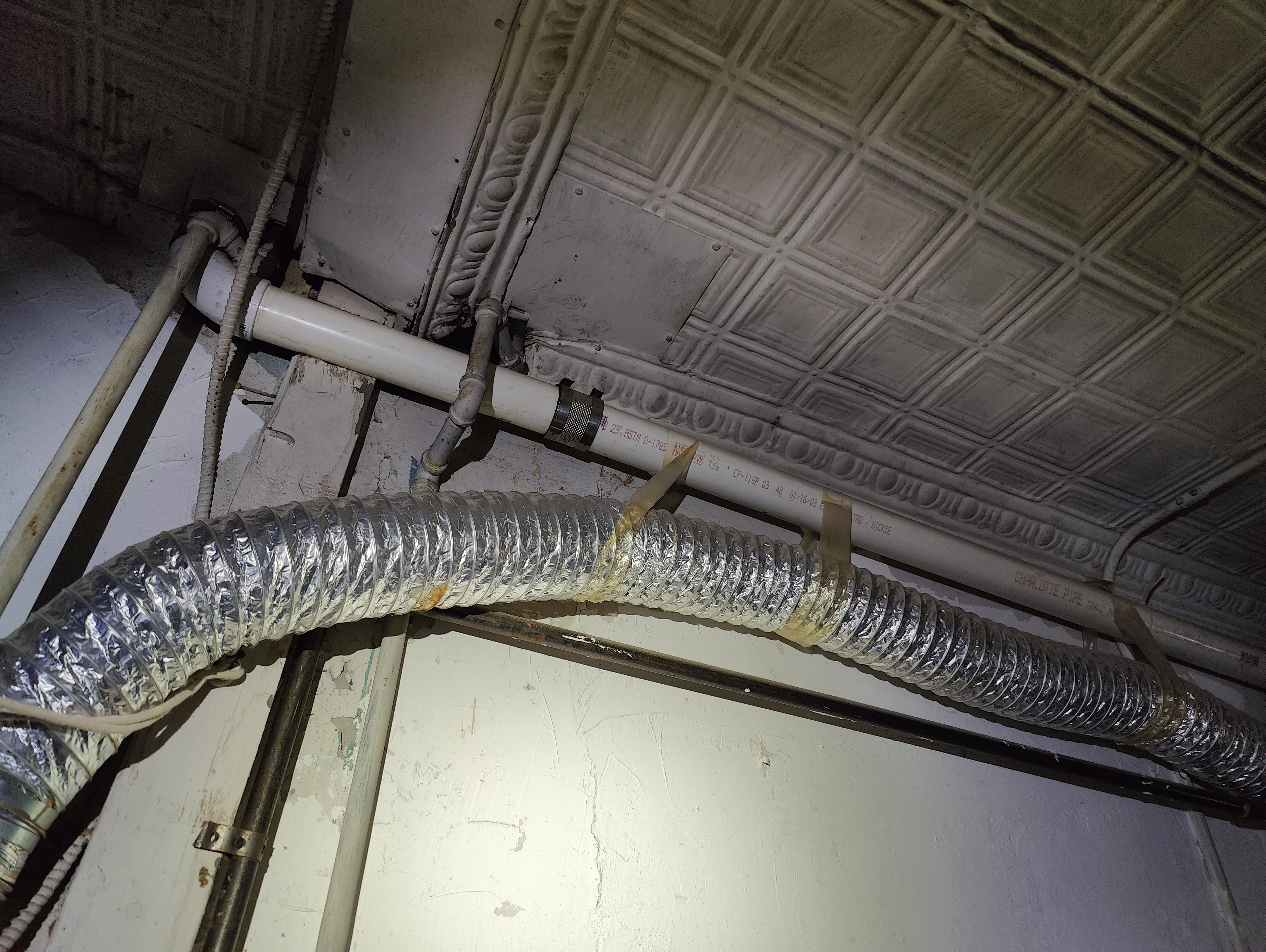

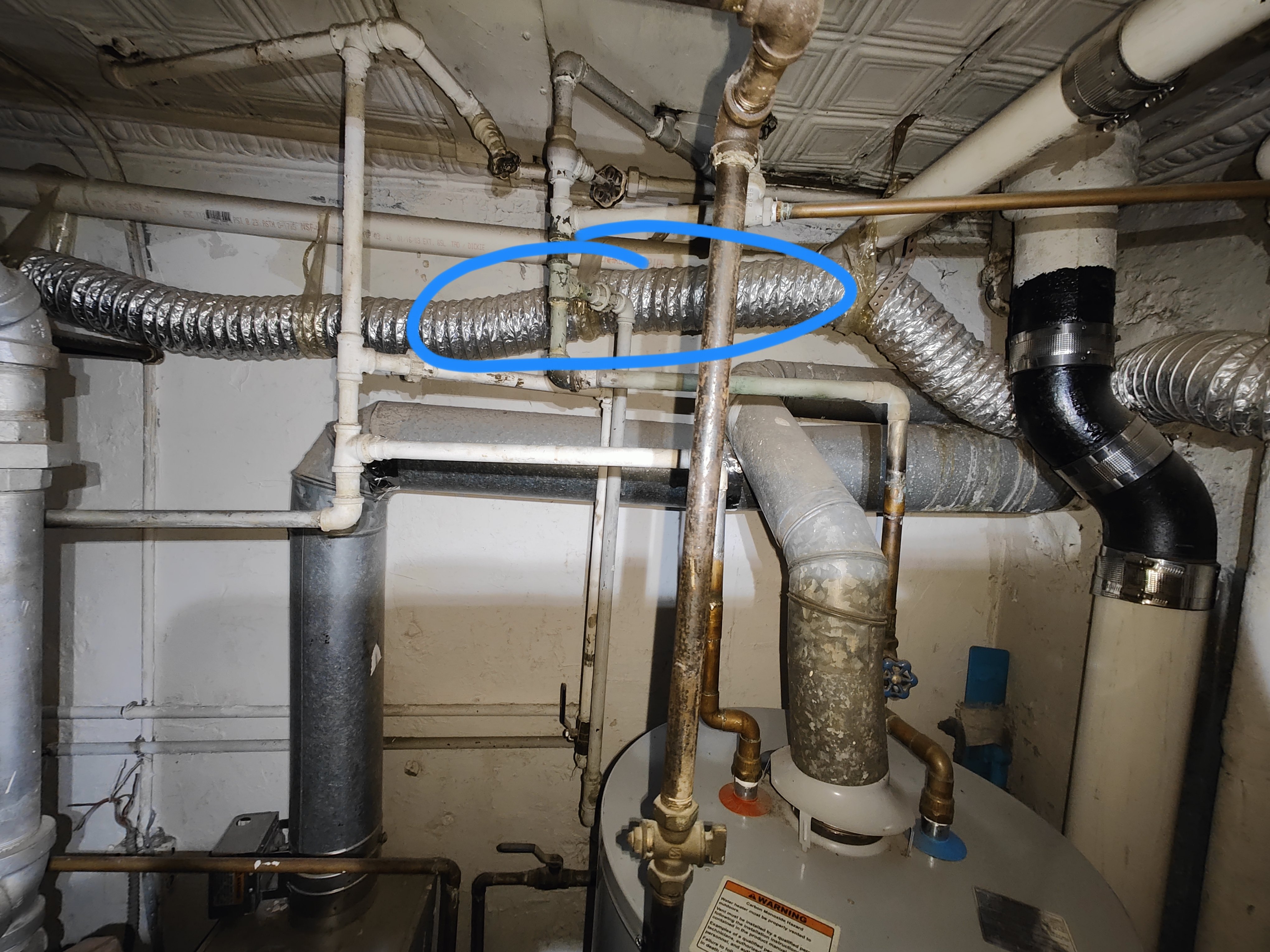

The dryer duct runs about 12' to an exit that is within 3' of the door.
The duct is aluminum foil, hung from some PVC drain pipe using tapes.

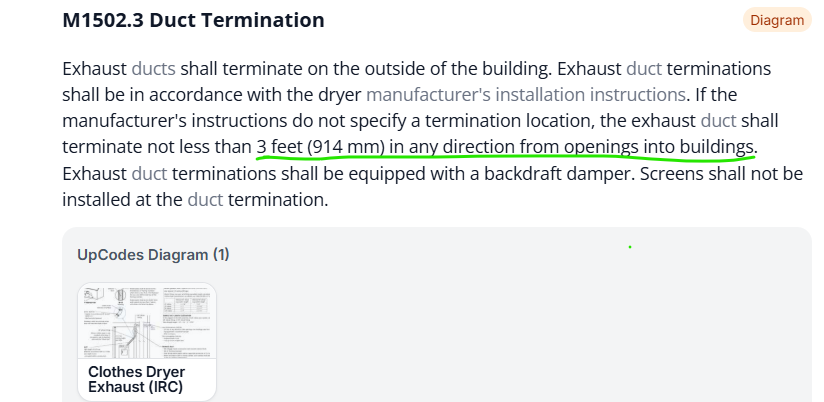

The code is, the exit needs to be more than 3' from the door, and the duct must be rigid metal with smooth inside surface.
If a New York City inspector comes to do gas pressure test and check gas related compliance, will this dryer duct be an issue?
Thanks.
    Jamie Hall Member Posts: 27,559
    Maybe. Depends on the inspector. If that's an electric drier, you may get away with it — but I wouldn't count on it. If it's a gas drier, they may not be real happy about it.
    Nor should they be. Electric or gas, that thing is a fire waiting to happen…

    The longest available from the store is 4" x 5' snap lock aluminum duct gauge 30. Two 5' ducts with two elbows and two 2' should bring it up to the code.
    Is there a max number of ducts allowed when joining ducts in series?
    Also, the min duct thickness is 0.016" in the code. Although gauge 30 alum is 0.012, does an inspector really check the gauge?
    mattmia2 Member Posts: 17,330

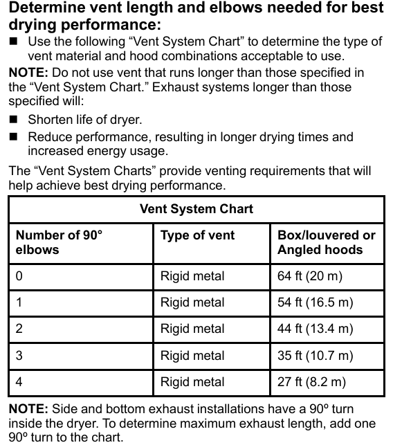

    the instructions for the appliance will tell you the maximum run. rigid galvanized or aluminum duct and elbows would get you the required gauge.

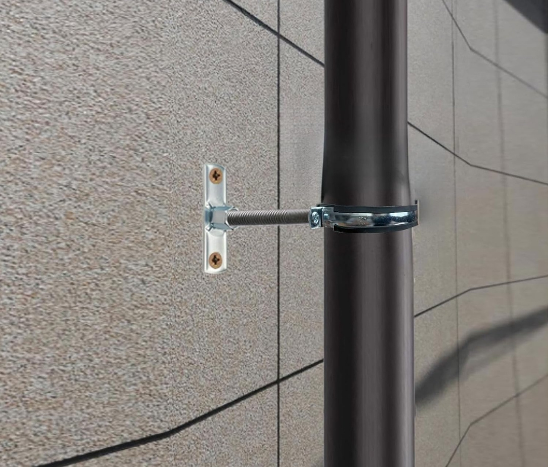

    For duct support, is there a commonly used spacing between neighboring brackets?
    Is nylon strap ok with the code? The duct will touch the wall if using nylon straps.
    Metal brackets are too expensive.

    no contact restriction I’m aware of. The joints can be oriented to 45 degrees which will reduce pressure drop.
    I’d bring it away from the wall and suspend from ceiling for a straight shot to exterior connection.
    the rules are in the mechanical code. the spacing will depend on the material. since it is a dryer duct it has to be seamed the proper foil tape so there are not screws in the duct to catch lint. hanger iron held together with a bolt is certainly one option for support.

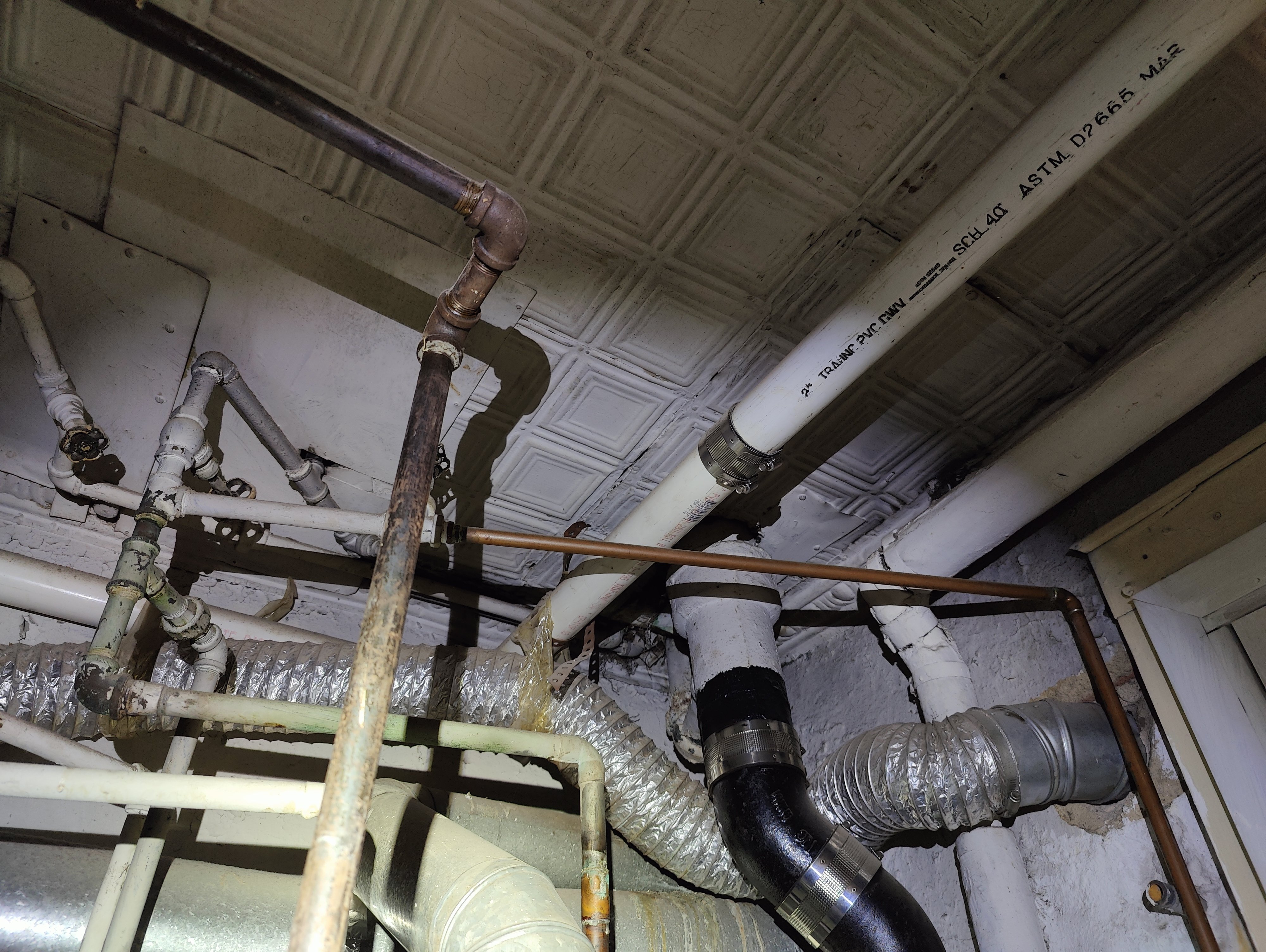

    This area needs a bracket but the access is blocked by a boiler and water heater. Access is needed to join the ducts and apply tape. Any way to do it?
    The more I look at it the less I like what you have. That is a major fire hazard. I just noticed that it is actually in contact with the breeching pipes from the water heater and boiler…
    Without looking at your basement, I can't tell you how to reroute that disaster — but there has to be a way. Use rigid duct and hangars.

    If you go in the plumbing Isle at a big box look for the Sheetmetal hangers used to hang 4" ABS or PVC drainpipe. They will hold a 4 1/2" OD pipe so they will be slightly larger than you need but you can make them work.
    Or you can use the roll of hanger strap with all the holes in it commonly called band iron.
    As far as how to connect the pipe use "gear clamps" otherwise known as hose clamps. They have those at the big box as well.
    Better than tape which doesn't last and it makes it easy to take the pipe apart and clean if need be.
    The hangers and clamps won't set ypu back much.

    Is it preferable that the duct goes behind the thick sanitary stack (see 2nd photo in post #1)? It's much easier to arrange a rigid duct in front of that stack.
    Also, it'd be more noticeable the duct is pivoting downwards from its straight run section to the exit on the wall. Does this downward pitch fly with the code?
    There's no reason the pipe can't go in front of the sanitary pipe.
    The min thing on the ducting is that the pitch should be consistent, if it's there at all No dips. No humps. I don't know what your local code says — different locations have different codes..
    hot_rod Member Posts: 27,777
    the flexible duct used for dryer connections is generally smooth inside, I doubt that stuff you have is even suitable for dryer venting, currently? It may exceed the maximum length also, the manual should have that info.
    Aluminum ridgid makes sense, but no duct screws! I think the aluminum foil tape is approved for vent assembly

    The vent run length is not a problem according to the manual -
    the block is how to install the 2nd support bracket, given the gas boiler and water heater blocking the access, I need a way to reach that area.
    someone managed to hang a transparent tape there, I assume they did so by stepping at least one foot on the water heater or boiler. it is a definite “No" from google.

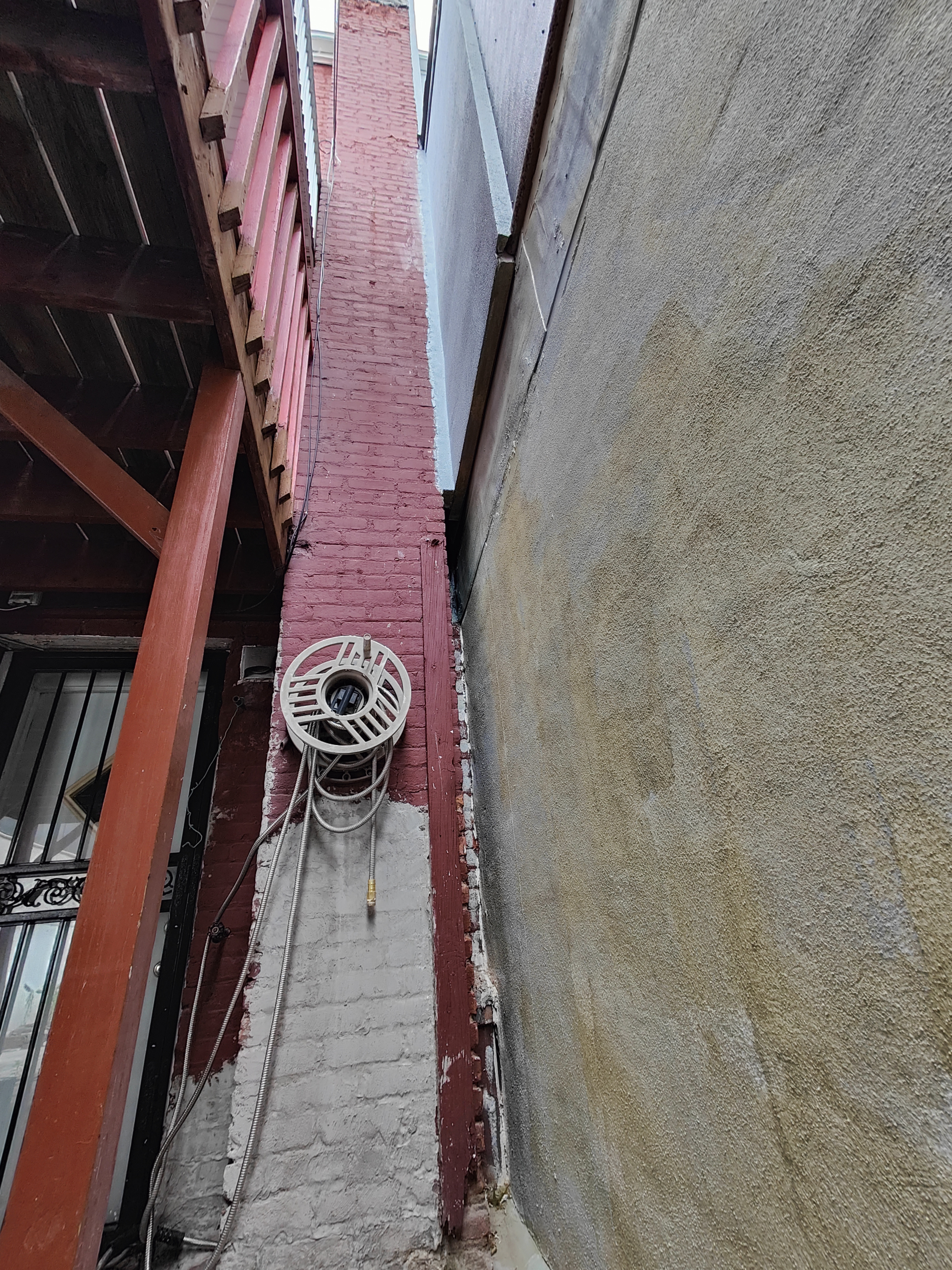

    now the concerns left are about exhaust.
    The dryer vent opens into the backyard, but the water heater and gas boiler both vent into a brick chimney. what aspects will the chimney be inspected on?
    According to the NY residential code (2020), the exit opening needs to be 3' away from an operable door or window. This dryer vent opening is right next to the door casing, so it does not comply with the current code. How often is this flagged in a city inspection?
  • bburd
    bburd Member Posts: 1,318
    You could extend the duct outdoors to terminate in an approved location. The code concern is not with where the duct exits the building, but where the exhaust exits the duct.

    The wall is pretty thick, made of brick. 3 ft left of the door is the brick chimney where the water heater and gas boiler vent to.
    Or until the trapped lint catches fire where it's touching the breeching…

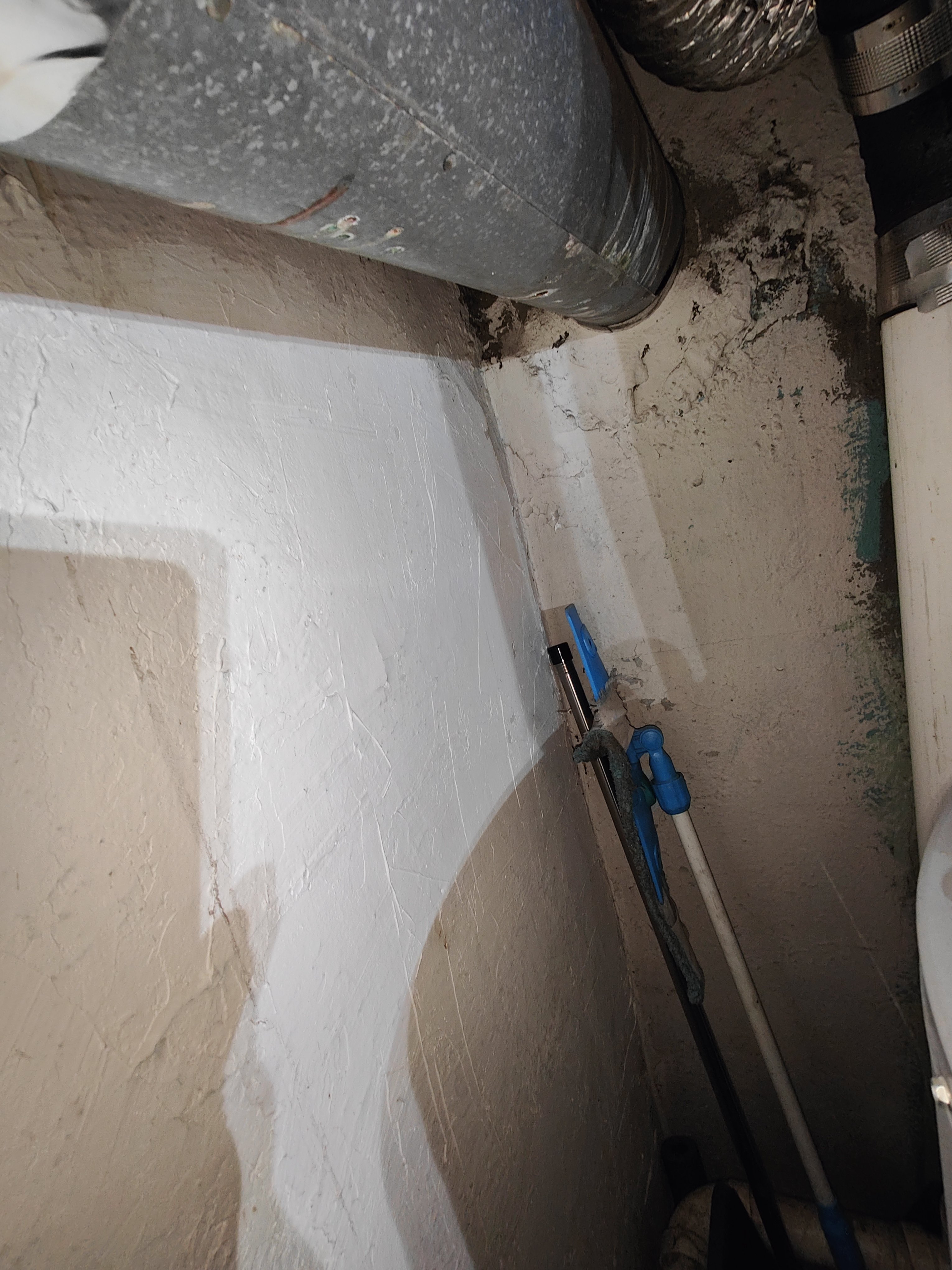

    The water heater and boiler vent into a chimney. The chimney does not have a clean out inside or outside. How will the inspector from the city inspect the chimney?
    EBEBRATT-Ed Member Posts: 20,442
    he is not going on the roof that's for sure.
    he may want you to get a chimney sweep to inspect it.
