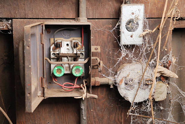

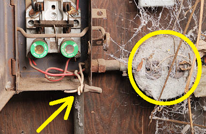

    Can't 100% tell, but the white neutral in the picture looks cut, maybe the receptacle to the right does not work. Maybe the wire loops under the box, it looks cut to me.
    Steamhead Member Posts: 18,664
    That thing looks scary.
    I once knew an old-timer electrician (this was back in the 1970s and he was an old-timer then) who told me that. I had run into an old fuse panel where the neutrals were fused as well as the hots. Back when electric wiring was first being installed, in order to get 120v you might have 60v on either side, just like today's 120/240v service where 120v on opposite sides makes 240v. It all depended on how the local grid was set up. In those days, you only had to break one side of a circuit like that to control a light or other load. Obviously Codes have come a long way since then.
