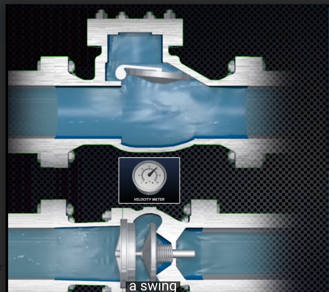

    What type of check valve?
    Swing checks with their long travel length are more prone to water hammering. A spring loaded check with a soft seat, 1/4- 1/2" travel lower pic small travel length may help. Notice the difference below between a swing and spring check.
    Another potential issue with a swing check is they need a full flow to push the gate all the way open, so they should be sized by their Cv number not connection size. Some checks, like pictured below have a space for the gate to swing up out of the flow. Lower designed checks like some Y pattern, the gate stays in the flow when fully open.
    Sizing is important especially with variable speed pumps that may not open the gate on lowest speed settings. You may have a gate floating mid point between open and close.
    You want to deal with the shock wave close to where it originates. Putting a water hammer arrester not as effective as right at the check.

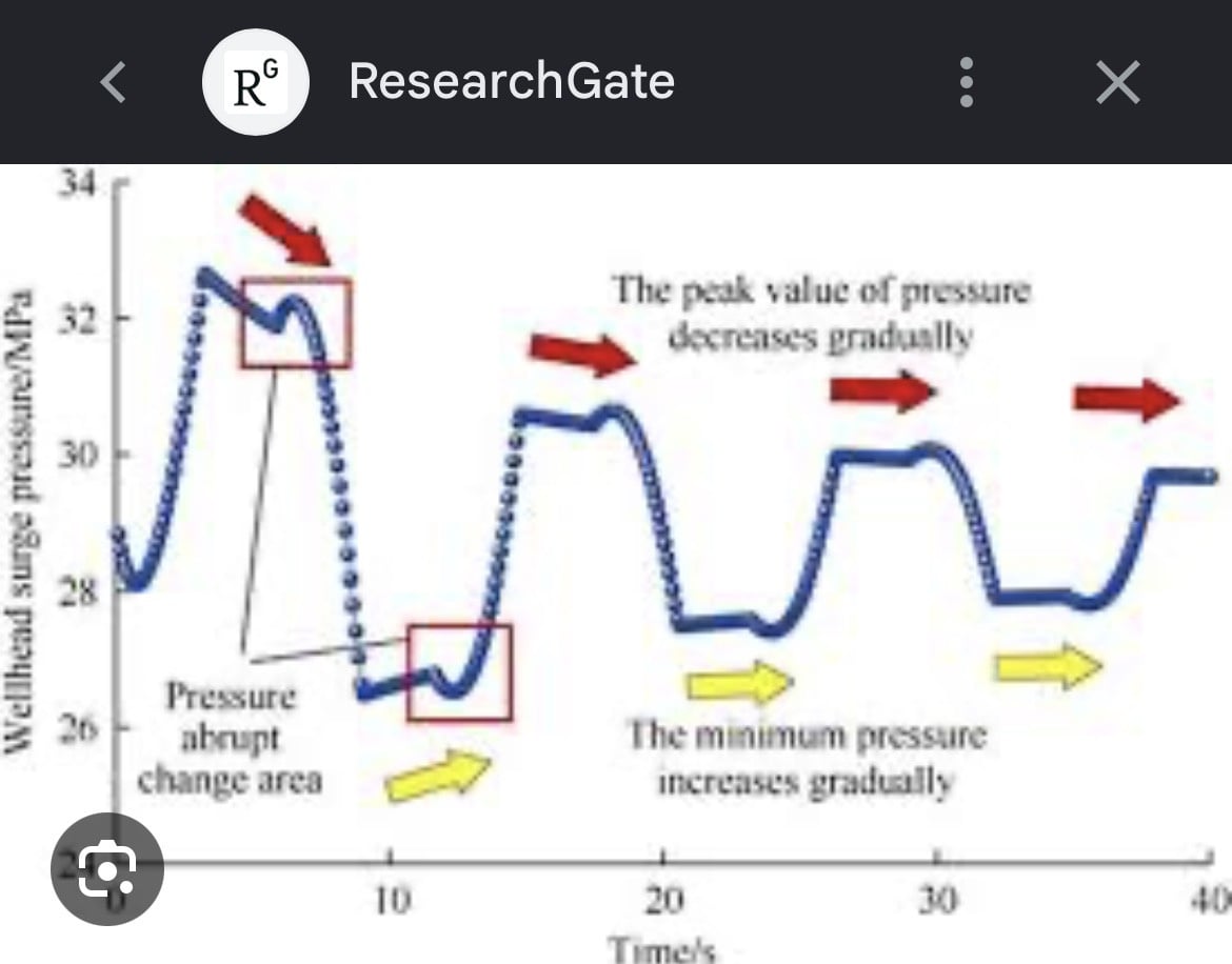

    It all comes down to the flow rate and how quickly you are stopping it. Best to eliminate the cause instead of trying to suck up the shock wave, it can pound components apart in the piping system
    There are some You Tube videos out there showing how pressure spikes when valve close quickly against high flows, this screen grab is from one of the videos
