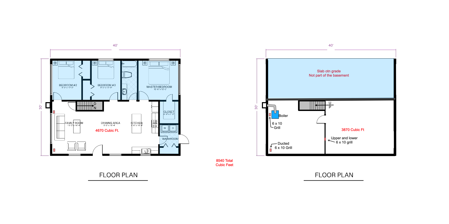

 I had my basement walls sealed with closed cell spray foam insulation and then finished the basement with a dividing wall between the gas furnace and main room. There are two doors along the wall in opposite ends so the furnace isn’t completely blocked. Though Once the insulation was complete and the walls finished the heat in the basement especially the furnace area went up dramatically since there was no more cold walls or open areas. My question is how can I help remove the trapped heat? I was thinking of cutting an open vent/grate that is basically just off center to the furnace that would let the heat rise into the dining room. Is this a good solution and how much heat will transfer? I don’t really have a way to have a vent fan go outside. The only way due to floor joists would direct the heat to a crawl space under a back room.

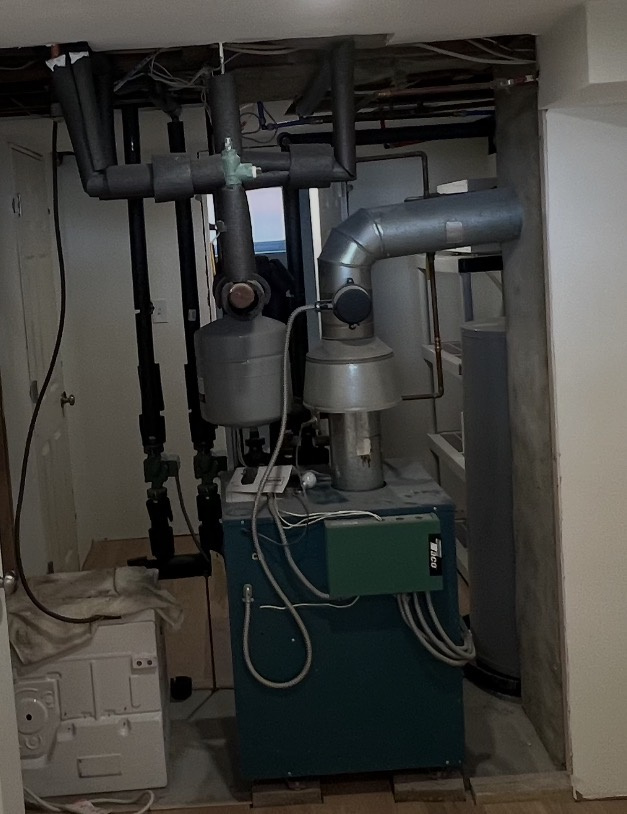

    I have a Burnham Series 2 furnace that is direct vented. This furnace was installed in that basement 18 years ago with the same sq footage and no outside vents. The ceiling was also open so all hot water pipes were exposed which kept the basement somewhat warm. I say that because the foundations were cold in the winter and I’m assuming some heat went up through the floorboards. Now that the basement is sealed that heat is more prevalent. The furnace ran well all winter just that the heat was a tad high and im looking for a way to move it.
  • DSurette01
    DSurette01 Posts: 7
    here’s a pic of the furnace

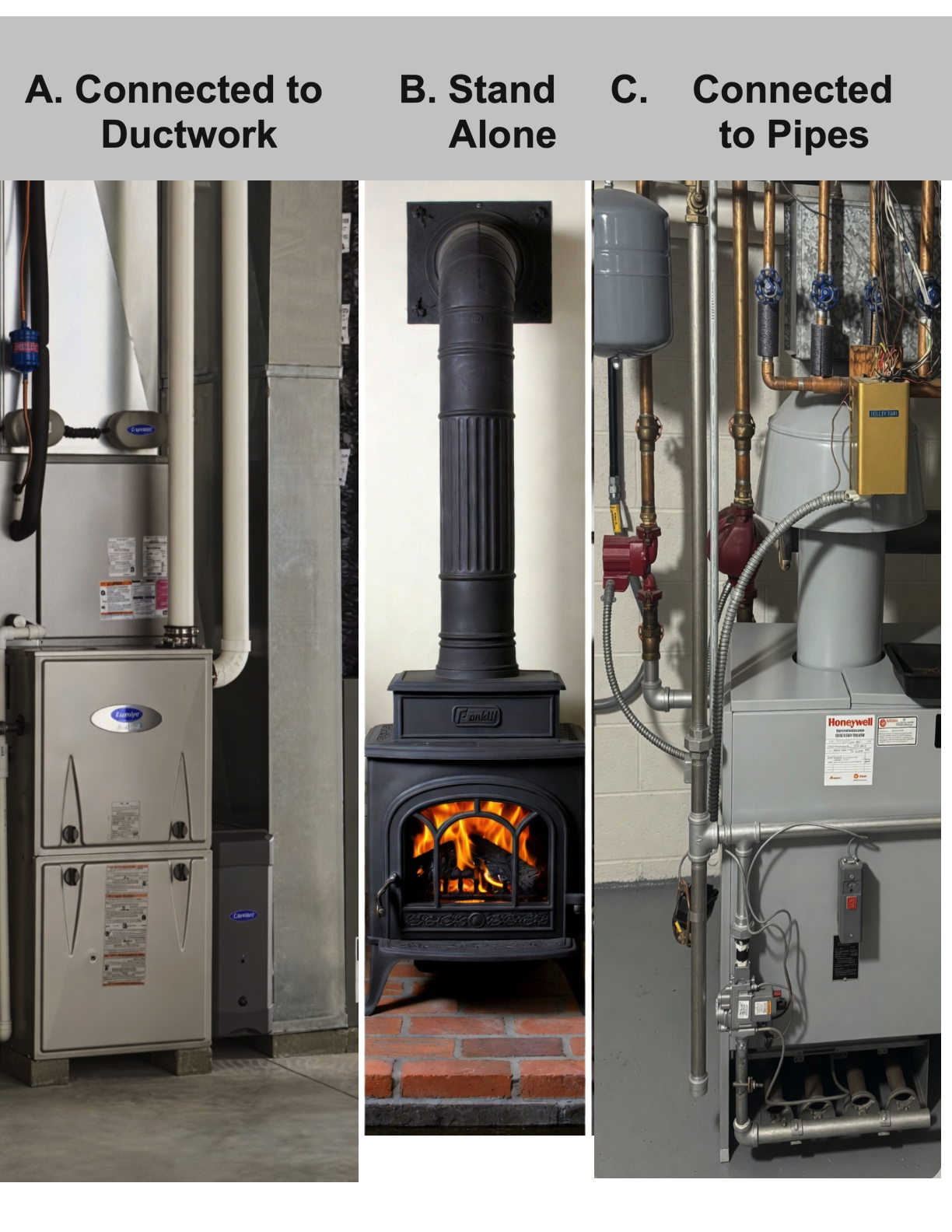

    OK I have to correct some misunderstandings that the Professionals may have assumed.
    1. You have a boiler and although some call it a furnace and others call it a stove, the correct term is a Boiler. In the "pixcture" below
      1. is a furnace
      2. is a stove
      3. is a boiler
    2. Your boiler is a hot water boiler and there is no steam chest. Only a steam boiler will have a steam chest.
    3. You have the type of boiler that needs combustion air from the boiler room space. Since the amount of gas you are burning (INPUT) is 164,000 BTUh than you need 8200 cubic feet of space in that boiler room. Since you don't have that much space, Your boiler is in a room that is considered a "confined space"
    A furnace is connected to ductwork A stove is a stand alone heating appliance and a boiler heats water, So pardon my misunderstanding as to your actual situation. This makes more sense now. One of the ways that you can solve the problem in the basement is to cut a hole in the floor and let the heat out into the room above it. But that will not solve your combustion air problem, and you may end up with a real mess one day in the future. As a matter of fact, you may never have a sooting problem in that boiler for three years or longer, but one day — I don’t know when, and I don’t know how — you may have the perfect storm of occurrences happen, and it only needs to happen once for you to regret not following code for your combustion air to the boiler room.

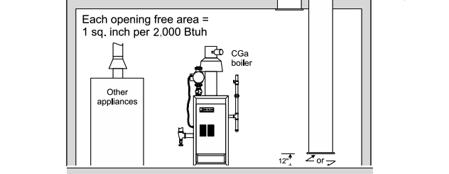

    The combustion air opening fix is to use two holes in the floor. One of the holes will be ducted to about 12 inches above the floor, and the other hole will have no duct. This will satisfy the combustion air requirement for your boiler room. This creates circulation since there is a low opening and a high opening. Gravity, or the concept of thermosiphoning, will take over. Air will move naturally, and you should not feel any draftiness from those holes.
    Both of those openings must have at least 1 square inch for every 2,000 BTU of heating input. That is because the air is coming from inside the home. (If the air was coming from outside the home, you can use 1 square inch for every 4,000 BTU of heating input.)
    The openings for your 164,000 BTU will be 6"x10". to account for free space. the area blocked by the metal grill does not count. So get two 6x10 vents and one piece of 8 x 10 duct about 7 foot long and you will be good to go. Make sure that you never cover those vents with a carpet or you must shut off the boiler power switch.

    The Burnham Series 2 boiler is an atmospheric boiler so it vents into a chimney. It is not a direct vented appliance. Which brings up back to the original issue that everyone has stated. By closing in the boiler room and tightening up the house you have less infiltration air that would normally help with combustion. With the lack of infiltration your fossil fuel burning appliances now have more of a chance of producing carbon monoxide in the area and if enough oxygen is depleted then you can have a back draft condition due to a negative basement. Unless air is allowed into the room to replace what was used then you don't have any dilution air to allow a draft. it becomes a standstill until spilling.
    My recommendation would be "A fan in a can" combustion air unit so you can have controlled combustion air entering the room.
    The openings for your 164,000 BTU will be 6"x10". to account for free space. the area blocked by the metal grill does not count. So get two 6x10 vents and one piece of 8" x 10" duct about 7 foot long and you will be good to go. Make sure that you never cover those vents with a carpet or you must shut OFF the boiler power switch.

    I also see a water heater peaking around the chimney. Since it is near the chimney I assume it could be gas fired.

    YES — and all that air will be from inside the home to inside the home. Fan in a can requires some wiring and will be that "Hole in the wall" that you might want to avoid.
    Just double check the math. The total Cubic Feet of the home that will communicate with those vents in the floor needs to be 8200 CF total not including any room with a door (like a bedroom or bathroom) So here is a mock up of what I am talking about:
    See on the left side of the home there are the two 6 x 10 register covers? One is ducted to within 12" of the floor As you can see from the first floor plan, any of the blue shaded area does not count for calculating the total Cubic feet since the bedrooms and bath have doors that can close. I also have used the existing 3870 Cubic foot of the basement since there are upper and lower 6 x 10 grills in the wall between the finished basement and the boiler room portion of the basement.
    Also someone mentioned the water heater. If it is an electric water heater, then you should switch it to gas when the time comes. You should account for an additional 40,000 BTU for that water heater in your calculations. So 164,000 + 40,000 = 204,000 BTU. And just for your Info… if you have a small 3 bedroom 1 story home with that small of a footprint (30ft x 40ft)-ish then your gas boiler is way too big. even if it 2 story, it is still too big. unless it was built in 1906 when no one insulated the walls of homes. But that is another discussion.
    Hope this helps
