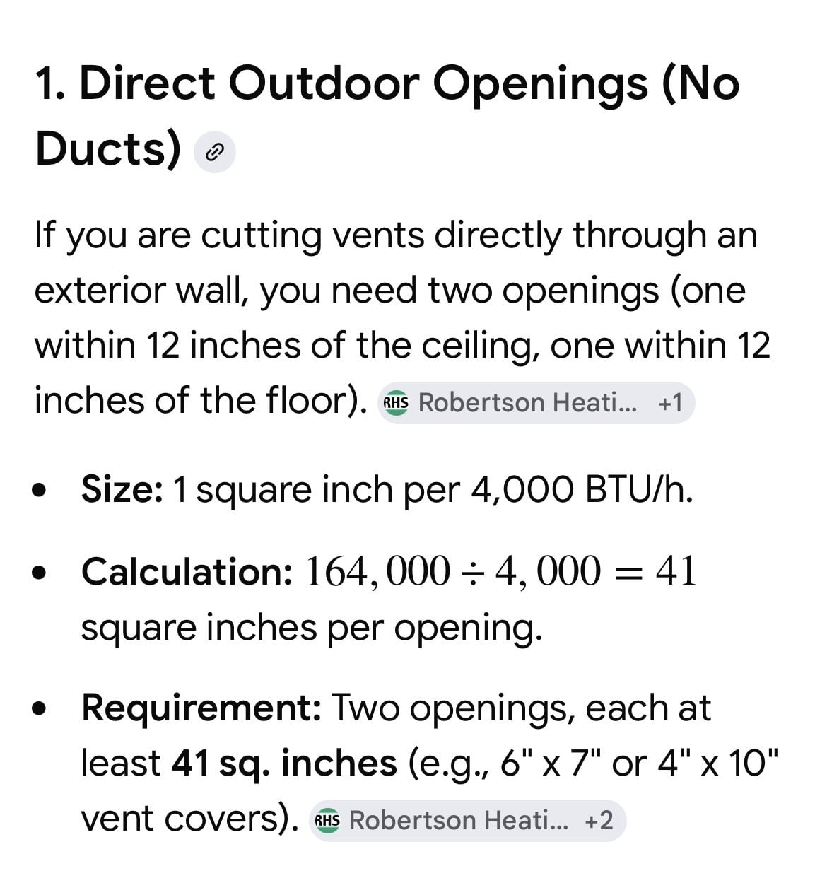

    The sq footage of the furnace area is 135 sq ft. There are 2 78x30 doors on either side and I’m going to install a wall vent infront of the furnace that goes into a 300 sq ft room. There’s also a half bath adjacent to the furnace area that’s 22 sq ft.
    the furnace BTU input is 164,000 with a HTG Cap of 136,000BTU per hr.

    This is the NFPA requirement for the amount of air you need into that 135 sq ft space. It is a little different for a ducted combustion air requirement
    Local code may vary a bit.

    OK I have to correct some misunderstandings that the Professionals may have assumed.
    1. You have a boiler and although some call it a furnace and others call it a stove, the correct term is a Boiler. In the "pixcture" below
      1. is a furnace
      2. is a stove
      3. is a boiler
    2. Your boiler is a hot water boiler and there is no steam chest. Only a steam boiler will have a steam chest.
    3. You have the type of boiler that needs combustion air from the boiler room space. Since the amount of gas you are burning (INPUT) is 164,000 BTUh than you need 8200 cubic feet of space in that boiler room. Since you don't have that much space, Your boiler is in a room that is considered a "confined space"
    A furnace is connected to ductwork A stove is a stand alone heating appliance and a boiler heats water, So pardon my misunderstanding as to your actual situation. This makes more sense now. One of the ways that you can solve the problem in the basement is to cut a hole in the floor and let the heat out into the room above it. But that will not solve your combustion air problem, and you may end up with a real mess one day in the future. As a matter of fact, you may never have a sooting problem in that boiler for three years or longer, but one day — I don’t know when, and I don’t know how — you may have the perfect storm of occurrences happen, and it only needs to happen once for you to regret not following code for your combustion air to the boiler room.
    The perfect storm is when the bathroom exhaust fan is on, the kitchen fan is on, and the clothes dryer is running. The gas furnace may also be operating. With all those automatic appliances and exhaust fans running at the same time in the winter, when all the windows are closed and your home is tightly sealed with new insulation, your home can become a negative pressure zone compared to the outside air pressure.
    That is because all those fans and appliances are blowing air out of the house. Your home becomes like a plastic milk jug. Try putting your vacuum cleaner hose on an empty milk jug. With no place to let air in, the milk jug develops negative pressure and collapses. Your house is stronger than the milk jug, but the same thing happens up to a point.
    Eventually, the furnace may not have enough air, and the flame will not get enough oxygen to burn cleanly. Then soot can form, clog the boiler flue passages, and potentially leak carbon monoxide into your home.
    The combustion air opening fix is to use two holes in the floor. One of the holes will be ducted to about 12 inches above the floor, and the other hole will have no duct. This will satisfy the combustion air requirement for your boiler room. This creates circulation since there is a low opening and a high opening. Gravity, or the concept of thermosiphoning, will take over. Air will move naturally, and you should not feel any draftiness from those holes.
    Both of those openings must have at least 1 square inch for every 2,000 BTU of heating input. That is because the air is coming from inside the home. (If the air was coming from outside the home, you can use 1 square inch for every 4,000 BTU of heating input.)
    The openings for your 164,000 BTU will be 6"x10". to account for free space. the area blocked by the metal grill does not count. So get two 6x10 vents and one piece of 8 x 10 duct about 7 foot long and you will be good to go. Make sure that you never cover those vents with a carpet or you must shut off the boiler power switch.
    The openings for your 164,000 BTU will be 6"x10". to account for free space. the area blocked by the metal grill does not count. So get two 6x10 vents and one piece of 8" x 10" duct about 7 foot long and you will be good to go. Make sure that you never cover those vents with a carpet or you must shut OFF the boiler power switch.
    Yes that is correct. If you like the carpet and don't want to cut a hole in it, and you place the carpet over the vent, then you MUST shut OFF the power top the boiler. After the people, you want to impress with your new carpet, leave… then you can remove the carpet from covering the vent and turn the heat back on.
    You can't use anything that can be considered temporary like: "I'll leave the basement door open so the air from upstairs can communicate with the basement air". That is considered temporary because when you are not home someone can do you "a favor" and close that door for you. Then when you get back from your 3 week skiing vacation in Aspen, you may end up coming home to a sooty mess of a home. Leaving a window open does not count either. It must be a permanent opening

    @DSurette01
    We are not trying to give you a hard time.
    But the facts are if your existing boiler was installed today under the conditions that now exist it wouldn't pass inspection.
    It's about potential carbon monoxide issues.
