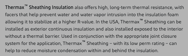

    hot_rod Posts: 28,343
    It is good to check with the manufacturer also. Thermax foil faced claims to be able to be installed exposed. If it has a code listing the building department should accept it?

    I somewhat over-simplified my comment. Not all foam board is created equal. Expanded ploystyrene (R-Tech) and extruded polystyrene (pink and blue boards) are the only types available in our local box stores and that's what I was addressing in my example.
    "THERMAX™ Sheathing is a high-performance, rigid polyiso insulation board with a glass-fiber-reinforced foam core and reflective aluminum facers."
