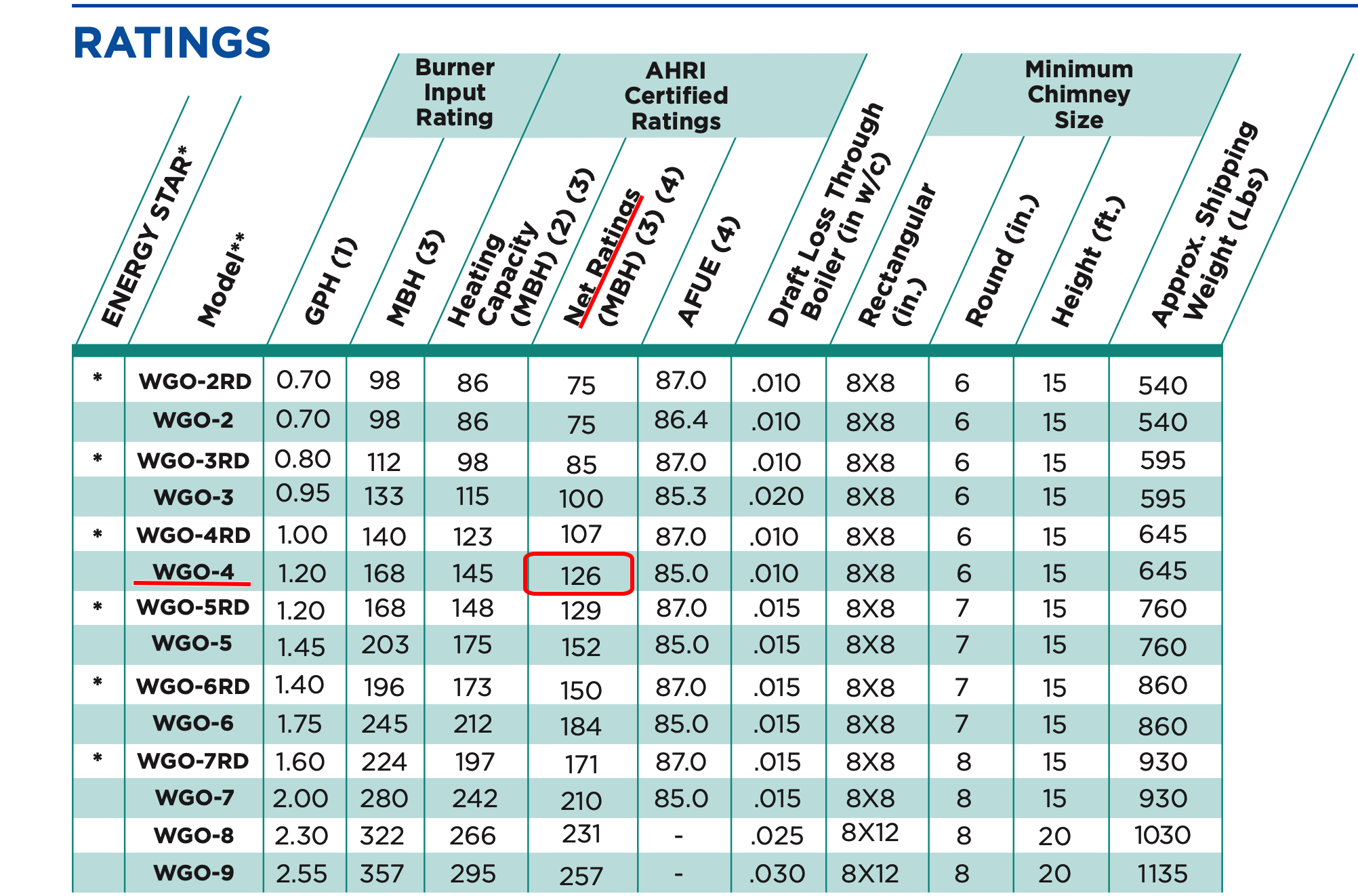

    You can down fire the WGO-4 to the WGO-3 firing rate. The 3 section actually has a higher water volume than the 4 section. 14.9 gallons in the 3 section vs 13.4 gallons in the 4 section.
    Output on 80 ft of fin tube is only about 44K BTU's. If it provided comfy heat this past winter, then you got enough. As long as the aquastat wasn't set to 210°.

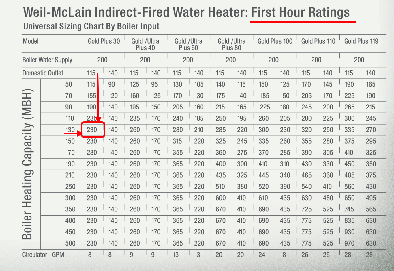

    I am very familliar with the Weil McLain P-WGO-4. that means that you DO NOT have a tankless water heater inside the boiler so the tank next to the heater is an indirect.
    27 Gallons is an odd size tank. I have a feeling that you have a 30 gallon indirect that has 27 potable water capacity with a heat exchanger that holds about 3 gallons of water. Total 30. Can you post a photo of your boiler and your water tank so we can help you better understand your system.
    Now there is a possibility that a 30 gallon tank may not keep up with your DHW demand with your family of four.  But there also is a possibility that with a very low cost set of adjustments you can have a system that provides more than enough DHW for your needs and you don't need to purchase any new, expensive equipment.  Or at the worst case, purchase less than half of the cost of an entire new LP gas heating system and get where you need to be with lower operating costs.
    If I were to make an educated guess, that 27-gallon tank and the P-WGO-4 were likely installed at the same time years ago. You most likely have a Weil-McLain PLUS-30 indirect tank, similar to the one illustrated in the first column of the sizing guide.
    With proper setup, you can achieve a first-hour rating of up to 230 gallons of hot water.
    The first step is to set the P-WGO-4 high limit to 200°F. Next, make sure the water heater zone is set to priority. This means the boiler will temporarily stop space heating whenever there is a call for domestic hot water (DHW), allowing all available heat to be directed to the indirect tank.
    Once that is verified, the remaining step is to ensure you are not exceeding approximately 3.8 gallons per minute when taking back-to-back showers. At that flow rate, it is not possible to exceed 230 gallons of hot water within a given hour. The math says so!
    The reason I know this is possible is because the P-WGO-4, when set up for peak performance, can deliver a NET output of approximately 126,000 BTU per hour. This rating already accounts for a 15% piping and pickup factor based on an average heating system.
    Since your water heater is located very close to the boiler, the actual piping losses are significantly less than 15%. As a result, you are effectively delivering more than 130,000 BTU from the boiler to the water heater.
    The numbers support this. All that’s needed is a properly set up oil burner—one that operates with smooth, quiet starts and clean, soot-free combustion. This requires the use of a combustion analyzer and skilled workmanship to ensure the system is operating at its full potential.
