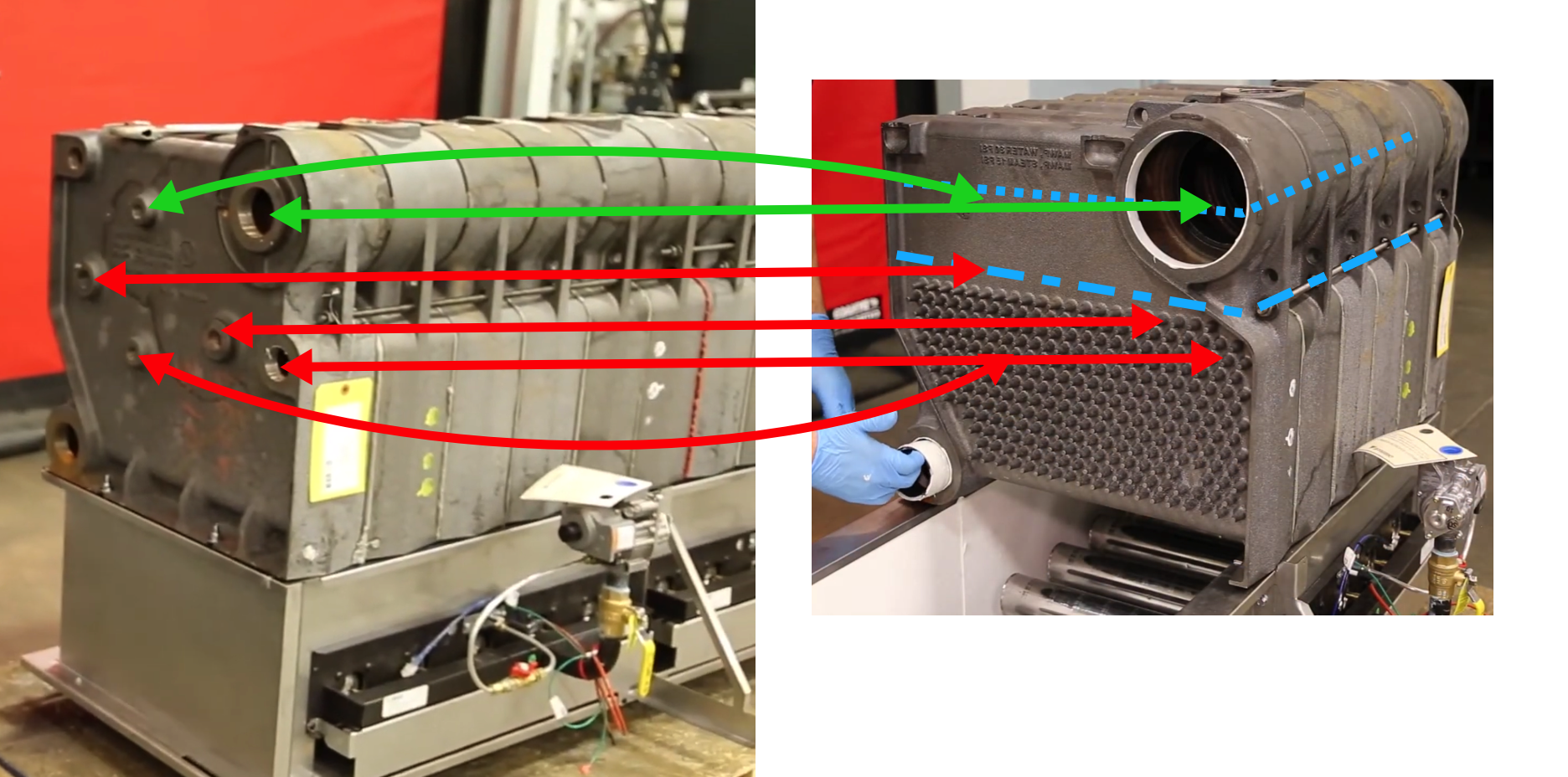

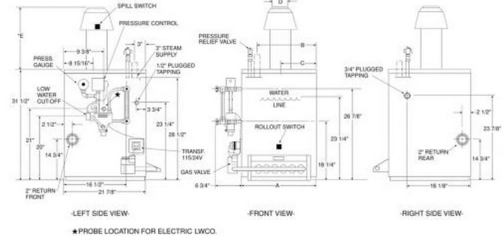

    It appears that your HB Smith boiler does not have a dedicated Skim tapping according to the manual. The closest thing that manual shows is what appears tp be a 3/4" plug that has no access thru the boiler jacket in your photo.
    That plug is not even labeled in the diagram on page 24. The skim tapping should be centered over the boiler’s widest top openings where the push nipples or gaskets connect the sections. This allows the water level during skimming to be positioned at the widest part of the top section connection. In the diagram you can see the location of the top opening gasket (17).
    If your boiler repair technician is not referencing that opening, then you should not have them perform the skimming. They do not understand the purpose of the skimming process. Otherwise, you may end up paying someone to skim only the end section of the boiler rather than properly skimming all six boiler sections.
    EDIT:
    Your skim tapping is behind this knock out on the boiler jacket:
    RED ARROW indicated skim tapping location. I might even consider getting a machinist in there to drill and tap a larger hole for 1" or -1/4" pipe and a cap for future use.

    That may skim the section with the gauge glass, but the water level at that point is not connected to the other sections at the surface—only at the bottom. There would be no skimming from the second section through to the other end.
    Take a look at any intermediate section of a boiler and you will see that the only place where the water surface of the entire boiler is connected is when the water level is at the height of the push nipples or gasketted openings. Any location above or below that point will not allow proper skimming.
    Just look at any steam boiler intermediant section and match it up to the end section and you can see that the lowest gauge glass port is well below the common area for the rest of the sections. For skimming to work, it must be at the proper water level or you may as well not even waste your time.
    The only tappings on this boiler (not the boiler in this post) are indicated in with green arrows. All the other tappings on the end section (including the bottom gauge glass tapping) will only skim the end section.

    Since the upper site glass port seems the highest tapping on the side (either side) of the boiler I would try the @ChrisJ method. It may be slower than normal skimming, but it may get the job done. The plug the plumber was attacking could have been drilled out enough to slice it as @mattmia2 suggests.

    I was going by the drawing you posted earlier that looked like the top of the gauge glass was tapped right under the relief valve. It seemed to be where it would skim all of the sections unless that drawing is incorrect.
