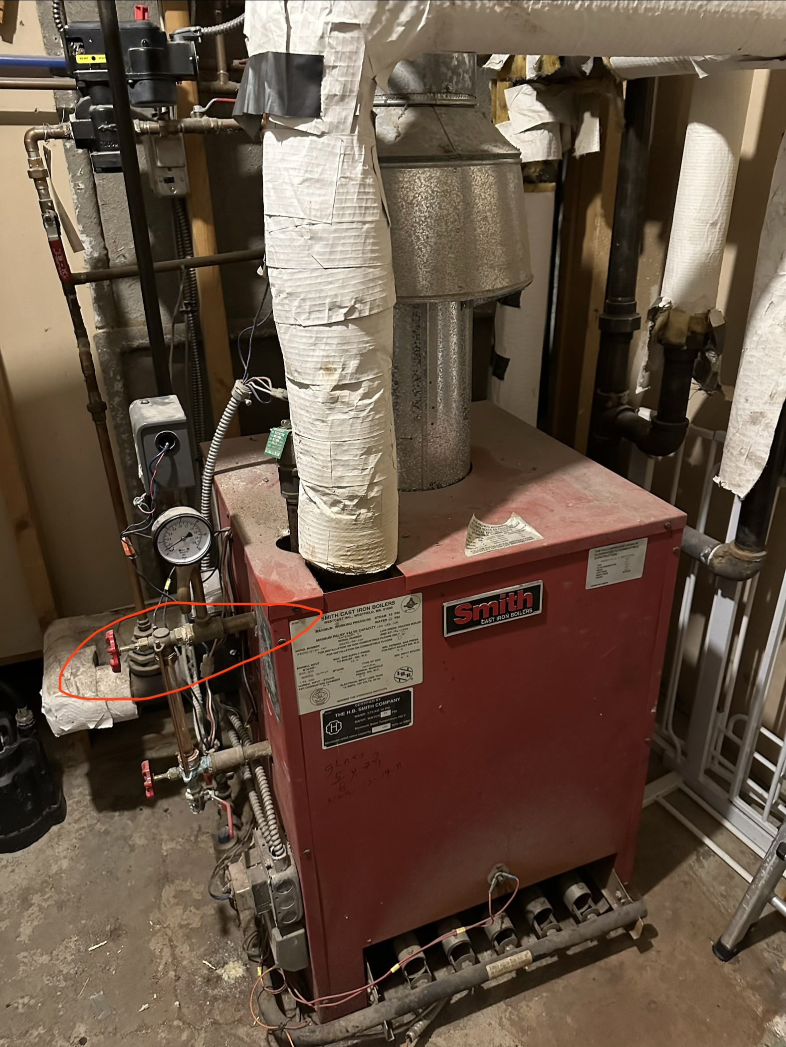

Technician was unable to remove the slim port plug today (without risking damage to heat exchanger). Is there another port on the boiler I could use for skimming?:
I was thinking maybe the top site glass port, remove the knob while skimming then replace?
Technician asked me to apply penetrating oil every other day to the skim port plug and then try again in a month to remove the plug. Thoughts?

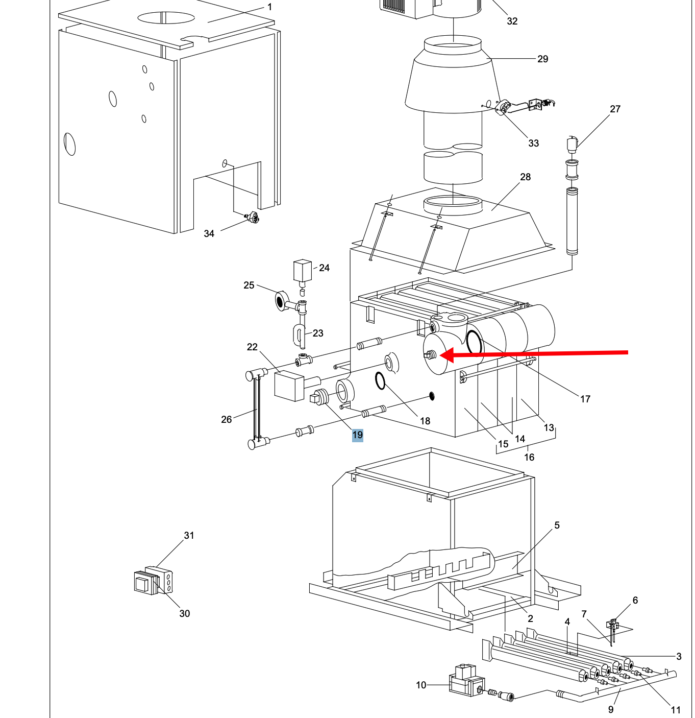

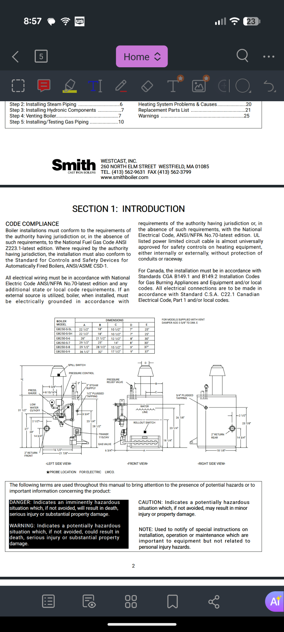

    It appears that your HB Smith boiler does not have a dedicated Skim tapping according to the manual. The closest thing that manual shows is what appears tp be a 3/4" plug that has no access thru the boiler jacket in your photo.
    That plug is not even labeled in the diagram on page 24. The skim tapping should be centered over the boiler’s widest top openings where the push nipples or gaskets connect the sections. This allows the water level during skimming to be positioned at the widest part of the top section connection. In the diagram you can see the location of the top opening gasket (17).
    If your boiler repair technician is not referencing that opening, then you should not have them perform the skimming. They do not understand the purpose of the skimming process. Otherwise, you may end up paying someone to skim only the end section of the boiler rather than properly skimming all six boiler sections.
    EDIT:

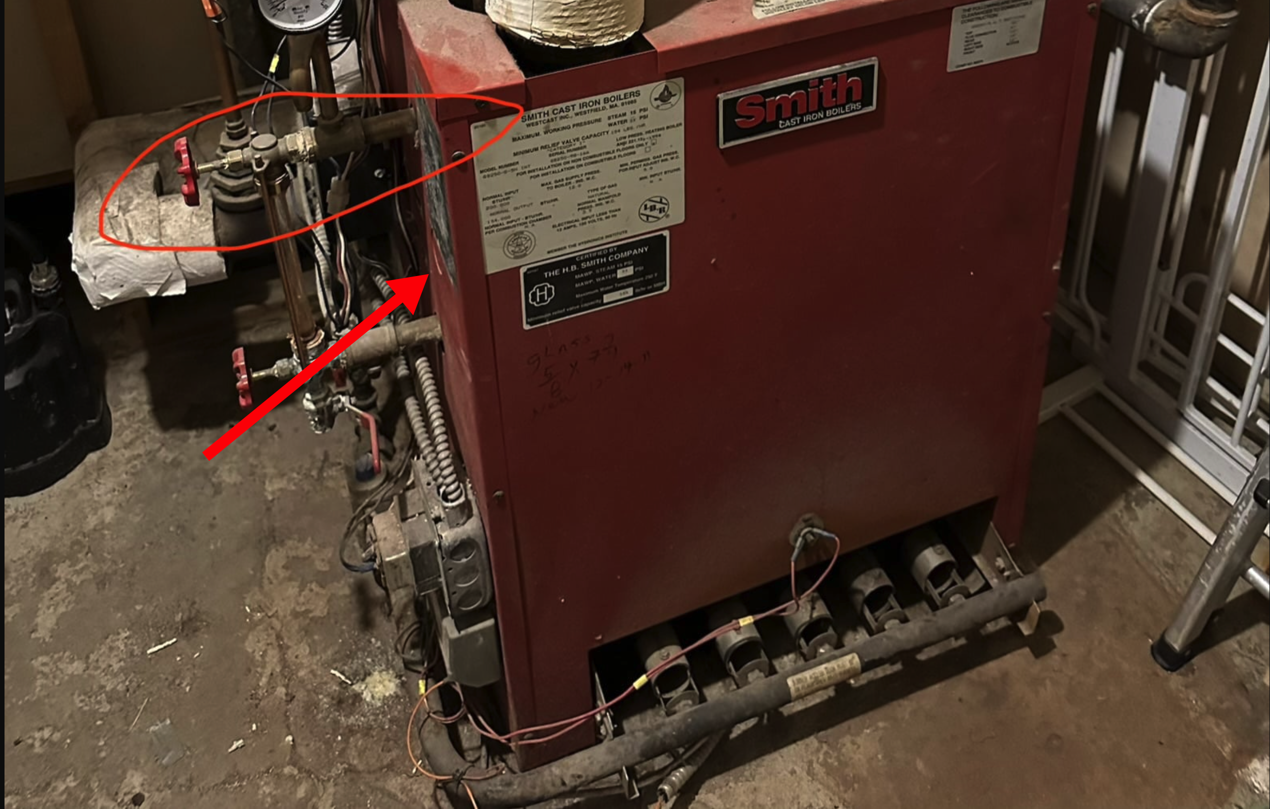

    Your skim tapping is behind this knock out on the boiler jacket:
    RED ARROW indicated skim tapping location. I might even consider getting a machinist in there to drill and tap a larger hole for 1" or -1/4" pipe and a cap for future use.

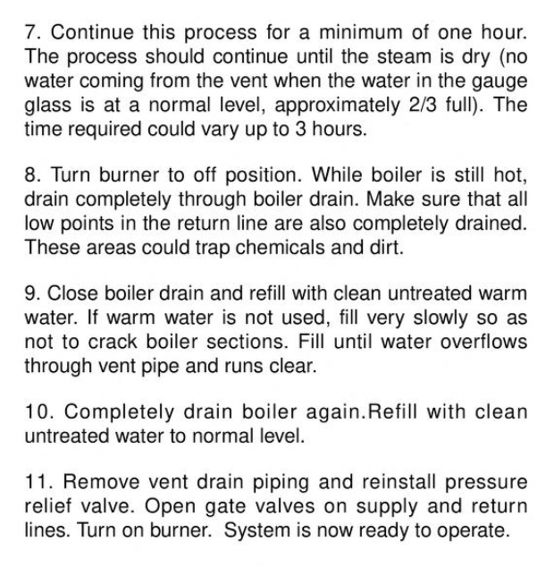

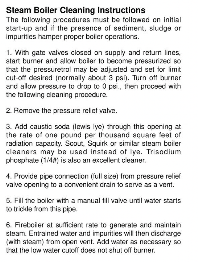

    These cleaning instructions are wild. They want you to blow the oil out the top via the PRV port along with water and steam until the water is clean.

    i don't know that the firing is doing anything other than mixing up what is in the boiler and splashing the detergent on the sections above the water line. sounds like they are trying to emulsify the oil and drain it with the water.
    ethicalpaul Posts: 9,076
    The firing/steam generation is basically forcing steam, water, and oil out the top PRV port until the water is clean enough that this sort-of "carryover" no longer occurs, then they say you can stop (might take 3 hours they say and I believe them). It's a lot of effort just to save them machining a real skim port.

    The knockout was removed and the plug made accessible however the plug would not budge with heat, impact and even crayon tricks. Going to try using the top site glass valve removal route and see how it goes.
    The 1/2 inch knockout of the left side was removed however no plug was present sadly.

    It seems HB Smith didn't feel that skimming was necessary and their radical cleaning instructions that involve removal of the pressure relief valve are 'the way'. This boiler was made in 1998 and is now working better than it ever has since I bought the house in 2015.
