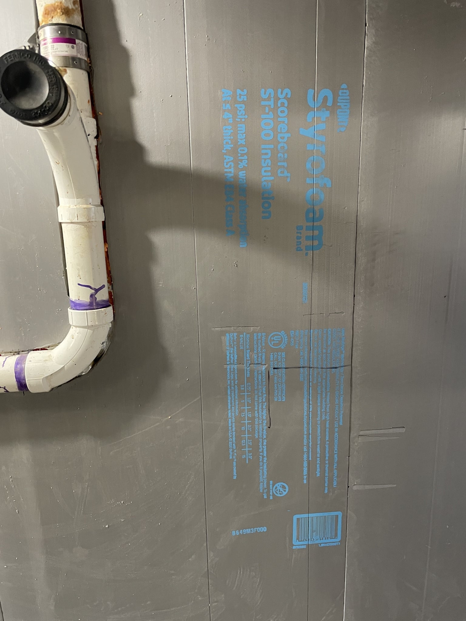

    I used 2” XPS screwed to top plate with foam adhesive to attach to foundation. It’s important to plan ahead on how to the transition from foam to the siding, especially the flashing

    @ethicalpaul - if the exterior insulation doesn’t pan out with the GC, you can always apply to interior walls. I used exposure rated DuPont gray board on the interior of the original basement. Went up quickly and made significant difference.
    The FLIR image give good before (left) and after (right) of the 1.5” R7.5 panel
