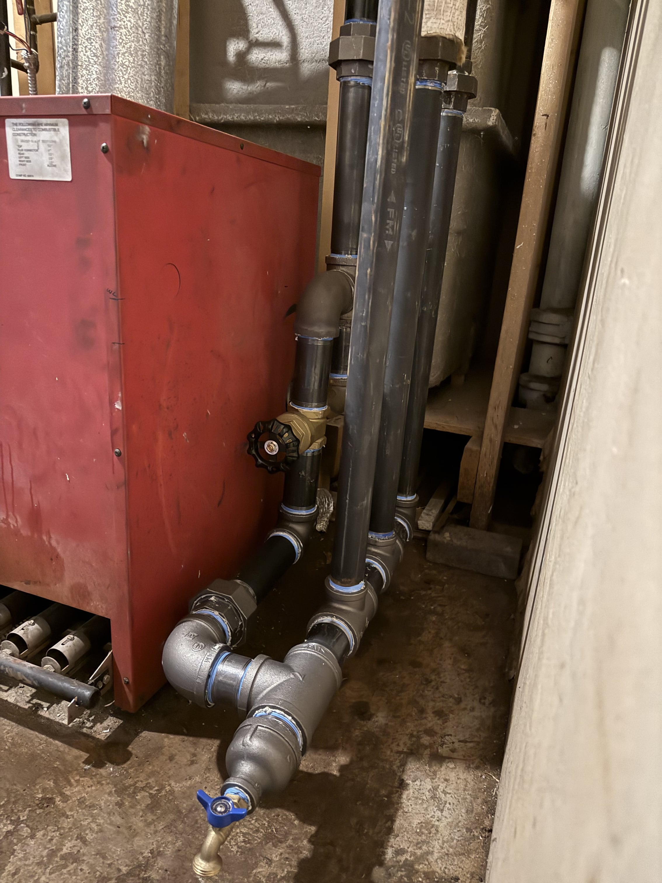

    Is the ideal skim to have a nipple then full port ball valve then nipple then a tee to see water level in pipe then nipple and elbow as needed?
    My goal is to have a skim line made such that it passes the vertical drops in pic above then an elbow and another nipple to drop nicely into a 5 gallon bucket on the floor.
    Like this:

    I would do a short nipple thru the jacket, and ball valve, then have the extension nipple and drop El removeable(loose ish), so you don't have much leverage hanging out there, a plug in the valve when not in use,

    Ahh yes, will make the post valve nipple, ell and down nipple removable.

    I would forget the "down elbow", there's no need to aim the water down toward the bucket, since gravity will do that for you. If you leave it horizontal at the end, it's easier to see any oil sheen coming out.
    You can look at mine in many of my videos linked below if you want. I have a tee on mine with the middle part facing upward so I can see down into the flowing water to even easier see any oil sheen before it drops out the end.

    I purchased a full port ball valve and tee based on your videos :)
    I'm going to use a funnel and hose hung off the end of the horizontal to direct flow to the bucket given that the process should be few and far between.
