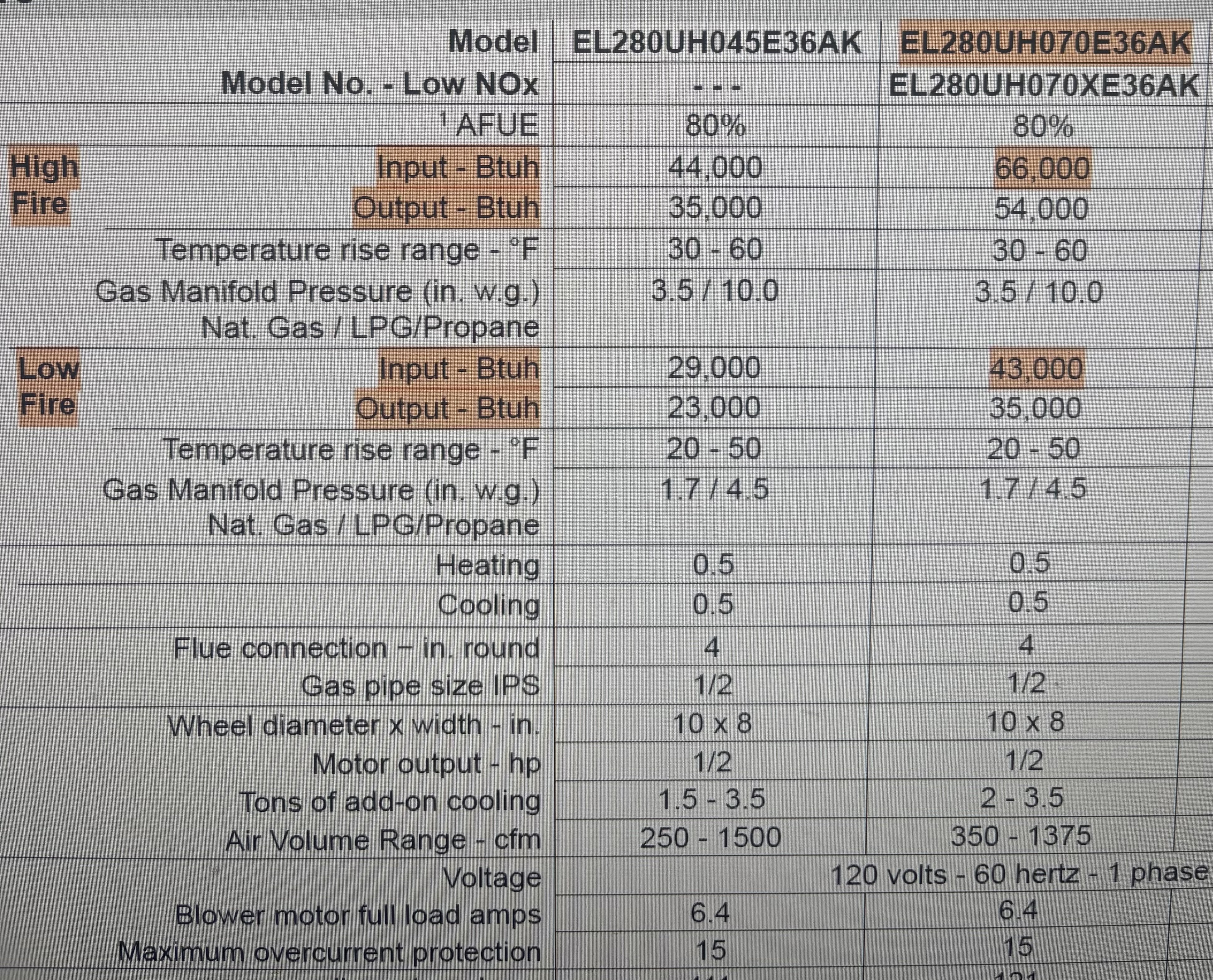

    You might be better served by the EL280E070, which has a high fire of about 66,000 BTU input and a low fire of about 50,000 BTU input. It can run on the 50,000 BTU stage for most of the winter and only go to 66,000 BTU when you need the extra kick. That should make the cycles longer.
    Low fire on this one looks to be input of 43,000 and output of only 35,000 - that seems insufficient. Unless I’m reading the chart wrong.
    EdTheHeaterMan Posts: 12,946
    EXACTLY RIGHT: That 43,000 BTU stage is insufficient for a very cold day. If you were in New Jersey, where I used to work, those coldest days could be below 0°F, and keeping the indoor temperature at 72°F was the job of the high fire stage. But we only saw temperatures below 0°F about once every four years or so, not every day of the winter. So to get the home to 72°F when the outdoor temperature is 0°F, you might need 66,000 BTU/h for about three or four hours every three or four years. Other than that, you don’t need 66,000 BTU/h.
    The 43,000 BTU burner is not for those extreme days. That burner is for most of the rest of the winter.
    For example, when it is 40°F outside, the house might only need about 22,000 BTU/h, and the 43,000 BTU stage is almost double what you need. When it is 30°F outside, you might need about 35,000 BTU/h, which is still less than 43,000 BTU/h.
    Now when the temperature gets down to 20°F, that 43,000 BTU stage is too small. But guess what happens? The additional 23,000 BTU burners come on, and suddenly you have a furnace producing about 66,000 BTU/h, even though the house might only need about 48,000 BTU/h. So what happens? the 43,000 burner never shuts off, the most efficient use of fuel, no OFF and ON cycling. The additional 23,000 BTU burner cycles ON to make up the difference then cycles OFF when the temperature at the thermostat gets higher that the set point. The over sized 66,000 BTU burner does not shut off completely, only the 23,000 burner shuts off so the 43,000 burner can keep you comfortable. Much more efficient operation.

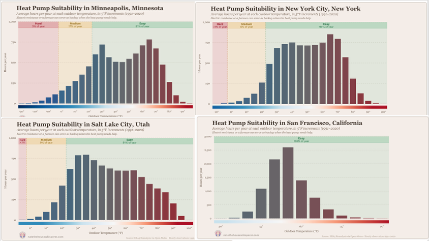

    hot_rod Posts: 28,704
    Most homes are at design condition a small % of the year, less than 10%, you can look up temperature info for your location. As such a single stage is mostly oversized. The closer the furnace to the actual load the more efficient and comfortable the home. Below are some examples of temperature data for various cities.
    Any air sealing upgrades will lower the load also. A load calc and blower door test can shed a lot of info on your needs. Most furnaces get over-sized.
